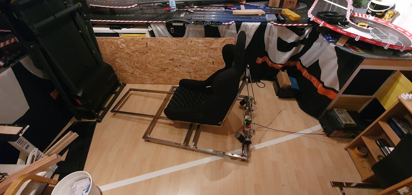

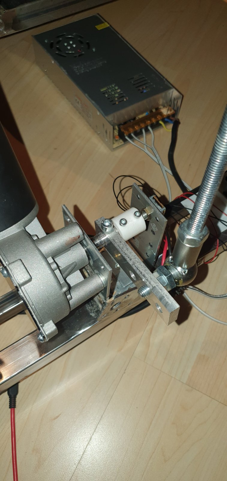

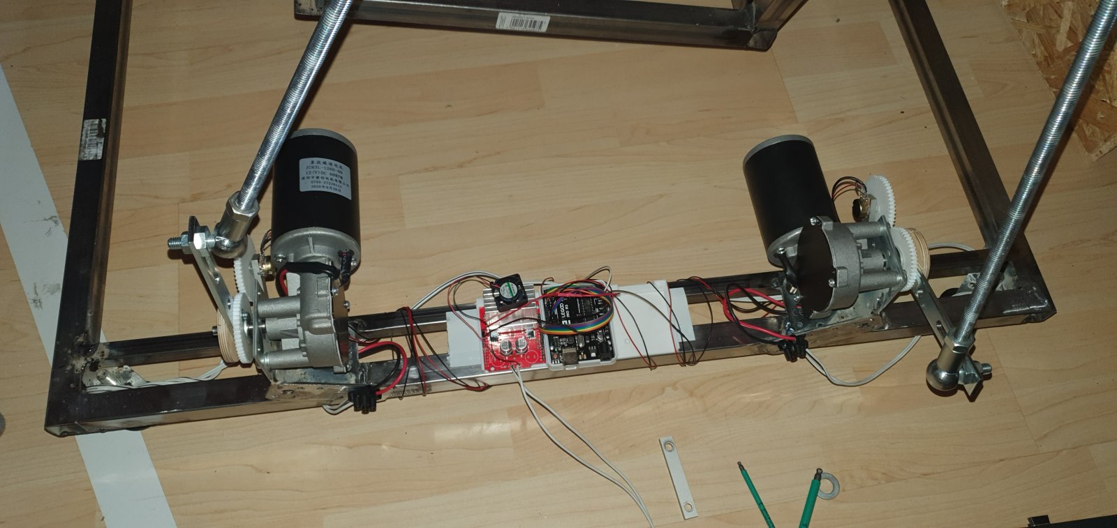

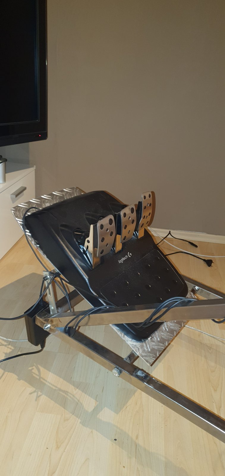

    Update!!
    Hi guys, a pandemic weekend later I made some progress!
    First of all, LFS still isn't delivering any Telemetry data which is killing me but as I am a console player (PS4), testing LFS from Laptop was only planned as minor milestone which should be easier to achive than starting with a network connection to PS4.
    As LFS is still making trouble I decided to test the connectivity of my PS4 with Project Cars 2. Therefore I used @vthinsel Plugin https://www.xsimulator.net/communit...ew-udp-format-manual-plugin-start.197/updates. hug:
    I unplugged PS4 LAN cable, inserted a network switch and connected Laptop with SimTools and PS4 to the switch. What should I say... IT WORKS!! :thumbs
    Project Cars on Console delivered Telemetry data and I could see a lot moving bars in the virtual axis testing tag in game engine.
    This made me enthusiastic and I started completing mechanical work the very next day as there where no pedal and wheel support until this moment. I was focusing on design from @Halloween2go which is shown in this thread https://www.xsimulator.net/community/threads/full-frame-2-dof-traction-loss-new-build.14740/
    Unfortunatly I was so motivated that I forgot to take picture during the day, but I will make them when I unmount the rig for painting and add them later. Here is a picture of the completed rig after the day:
    After remounting everything I was able to get my first impressions how the movement feels by testing it by driving --> very much fun!:)
    So I started with setting up Axis Assignments in SimTools and found that I wasn't able to eliminate motor struggeling and down movemenet behavior (as mentioned in a previous post the motor is going down with lower speed than up) which I expected to be adjustable by modifying K values in SCMutils but it wasn't.
    So i started suspecting the MotoMonster as, let's say as questionable. So I ordered 2 IBTs and removed the MotoMonster. Result: Left side --> GOOD :), right side --> no movement :confused:, but found a wiring fault by myself and after fixing this (and parameter change in SMCutils) both motors move smooth and with same speed up and down. So I would add mysels to tzhe long list of people in this forum who have doubts with the MotoMonster Shield, so if you want to stay more cheap than with the sabertooth I'd recommend the IBT2s instead of the MotoMonster :thumbs.
    I also made 2 or 3 steps to modify the pot mounting to the motor to the actual version with a coupling which seems to perform well.
    Now I have something like a working motiom rig :cheers as you can see here in the video:
    hug:to all the supporters here in the forum to get me to this point. Now I can start debugging, optimization and so on.
    BR
    Chris

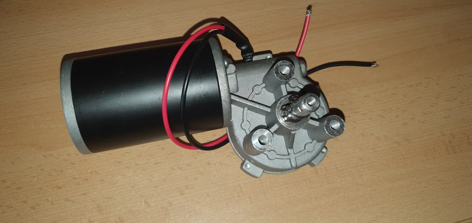

    What has to be mentioned are the motors I used, after the period of testing I feel they are little bit too slow and maybe also little big to weak.
    20201024_124326.jpg 60W, 60rpm, 50:1 wormgear motor
    So I decided to change them before optimizing and finalizing the "moving" holding fixtures. Again I followed @Halloween2go and ordered the crab pot puller motors in 50:1 with 280W and ~80rpm, hope this will be a significant improvement.
    I'm going to share pics of the new pot setup and the electronics later.

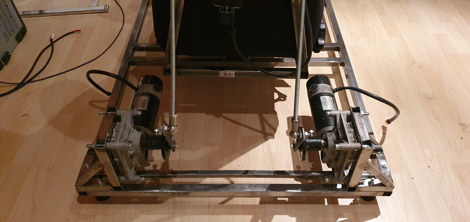

    Hi fellows,
    after some minor optimizations on my rig and some hours of racing I had to determine that my chosen motors are junk :(. These chinese worm gear motors I bought from china (via ebay) are too slow and a bit too weak but mainly the fact is they started getting leeway which makes the movement always bumpy.
    So finally the decision was made to make an upgrade on motor side. I found a set of used wheelchair motors on ebay which is 140rpm instead of 60 before and 240W instead of 60 before :). Little topic: they are 24V which also makes an upgrade on PSU necessary, So I bought a second HP server PSU, so now I have 2 times 1200W HP 12V PSU which I connected following this tutorial: https://blog.seidel-philipp.de/hp-dps-1200fb-netzteil-umbauen-fuer-ein-lipo-ladegeraet/.
    When the motors arrived I was some kind of shocked because of the wheight and the size :grin.

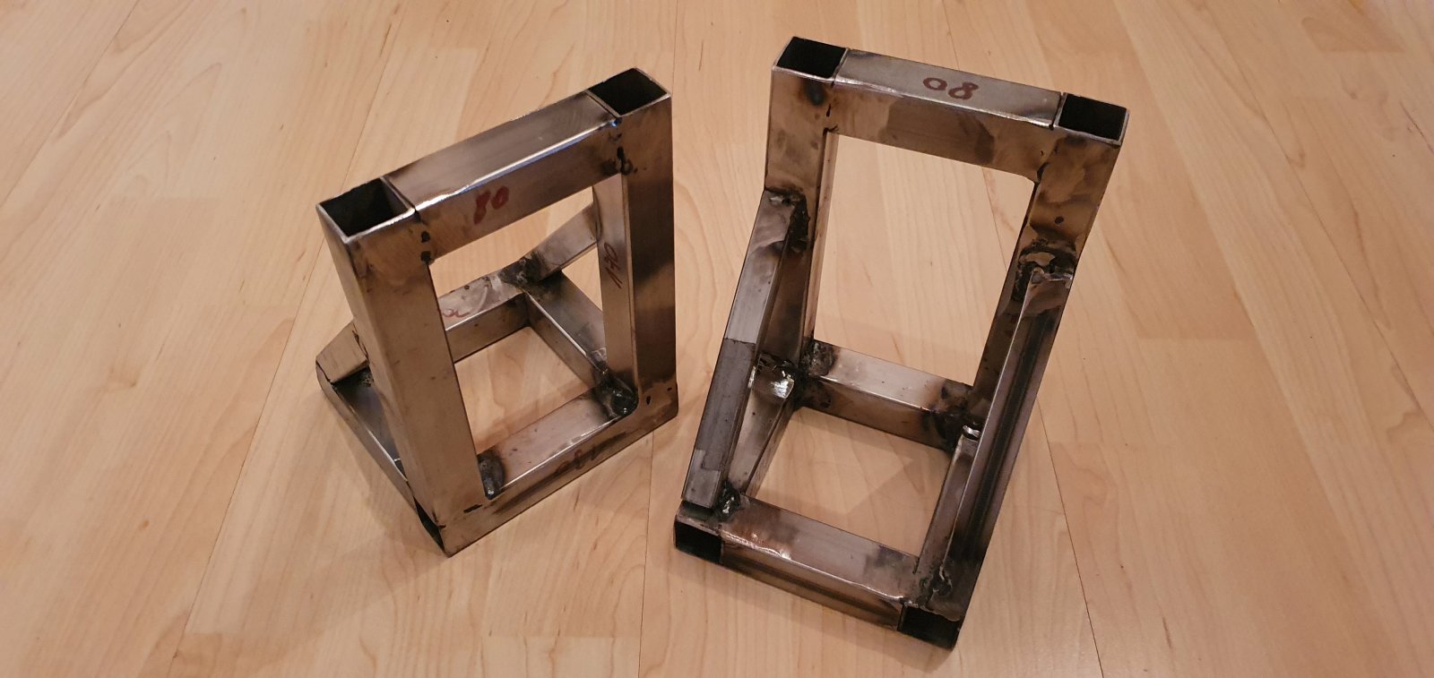

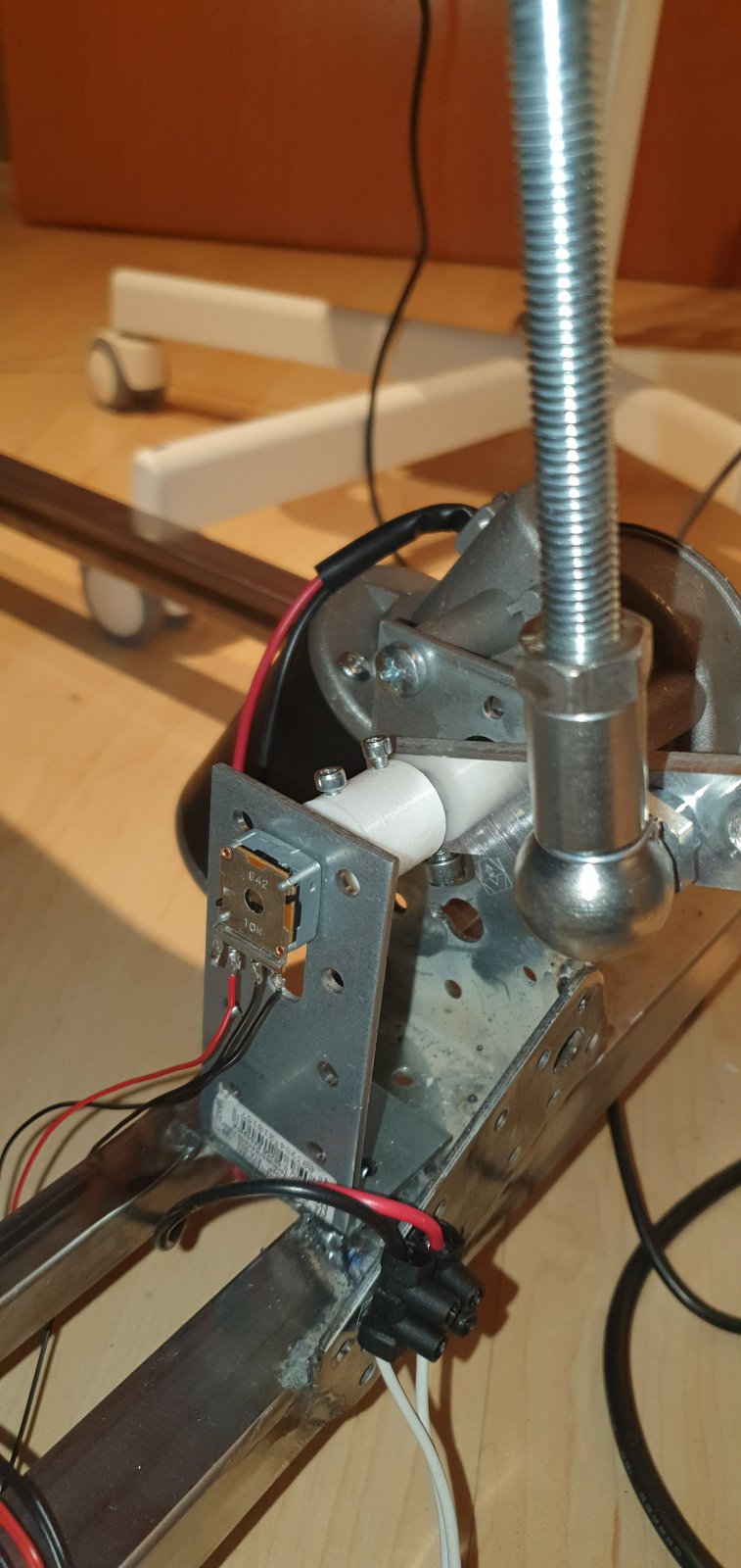

    To take them to the rig I welded mounts that should be stiff enough to fix them sufficient.
    Actually I rebuilding the electronics with new PSU and designed mounts for the pots, they are already on their way on my 3D printer.
    I will update my progress soon as I'm hoping to get the rig back to work within this week.

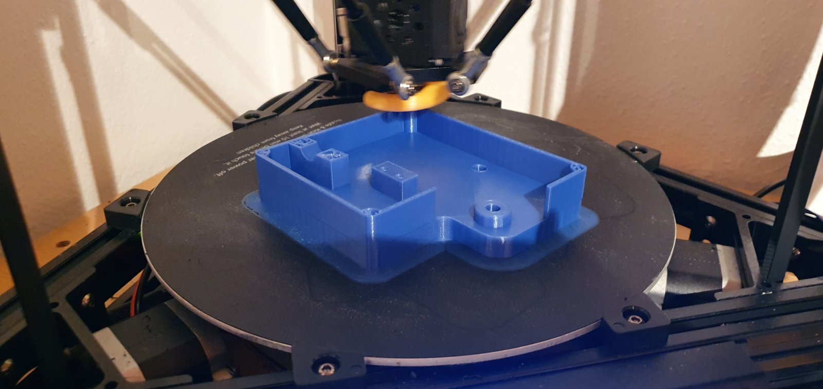

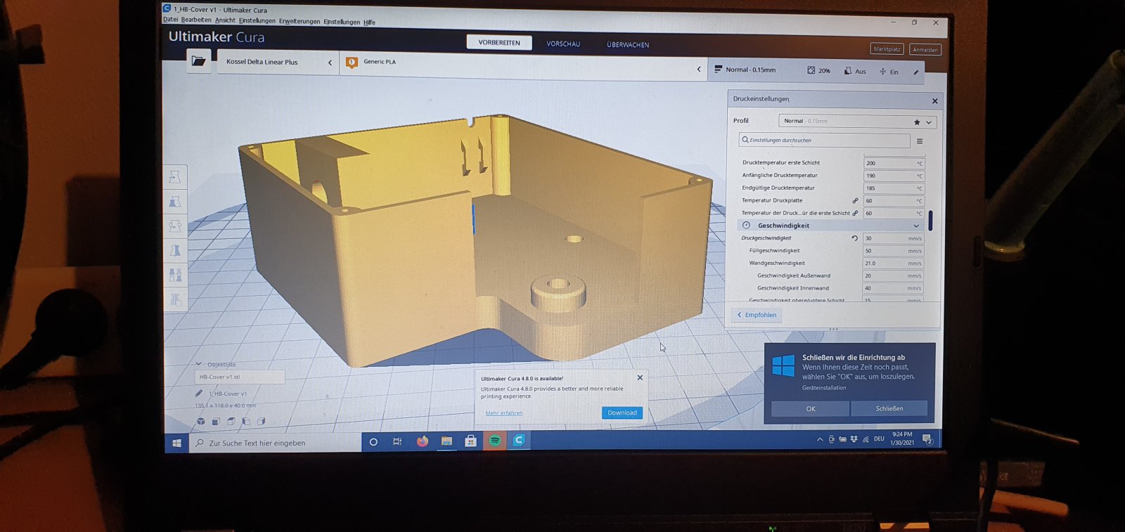

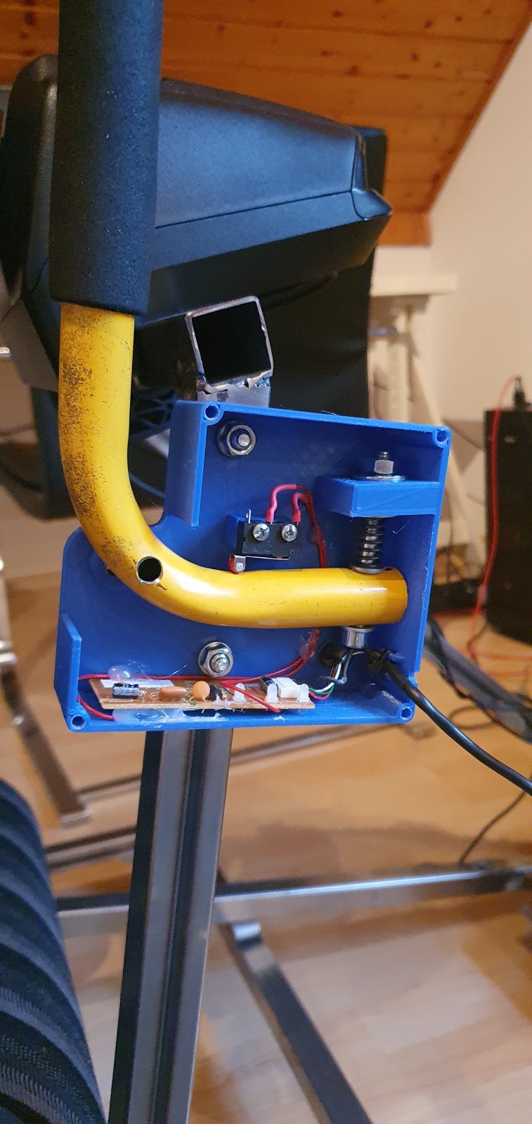

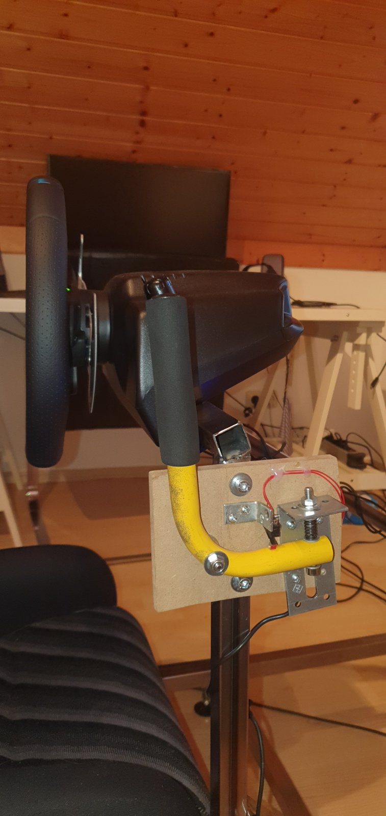

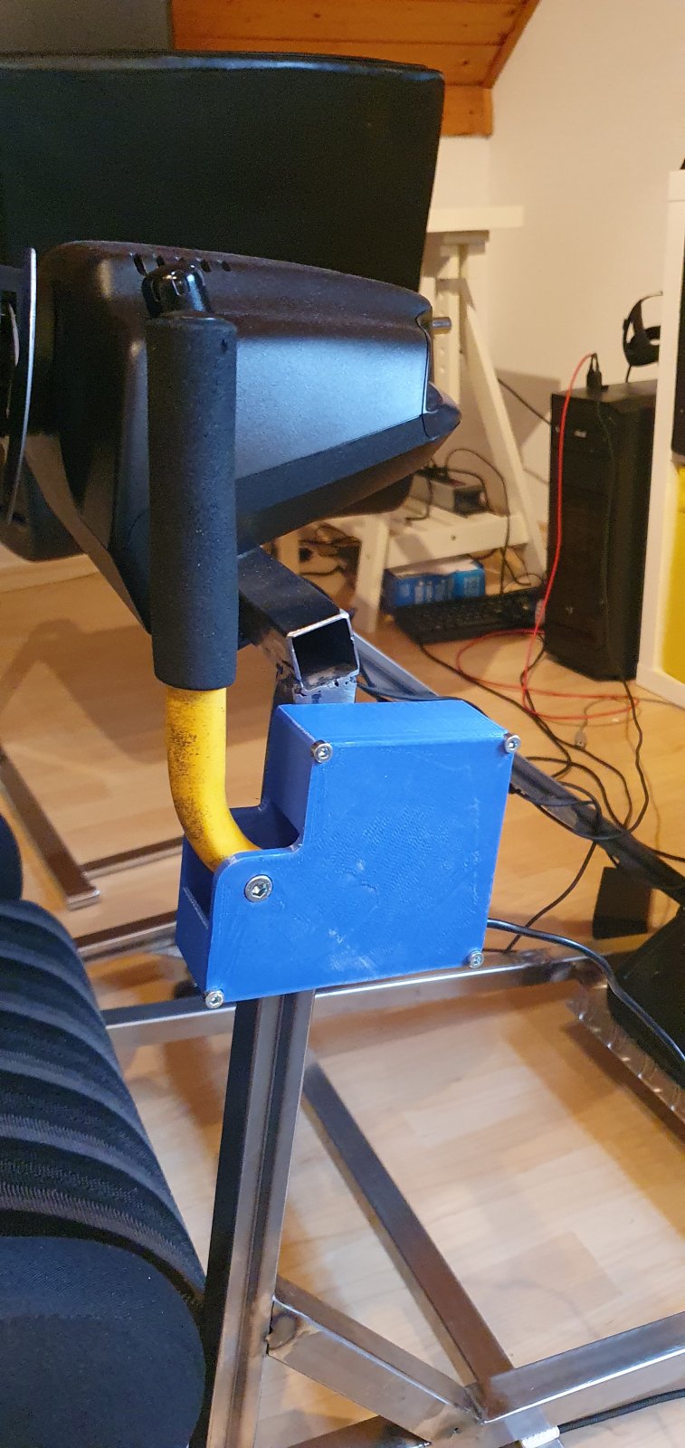

    A little bit off topic, in the meantime I built a usb (only digital) handbrake (mainly for Dirt 2.0).
    I found a youtube tutorial and decided to copy this, what should I say, really easy and it works.
    The switch is connected to a spare pcb out of an old USB keyboard. I removed the pcb, connectet it to my computer, opened a texteditor and used a piece of wire to shortcut pins from block 1 and block 2 of the pcb connector. After I found a connection that delivers a letter (in my case its j) I soldered the switch to these 2 pins. So now it's a USB handbrake :).
    After some testing and found it's good I designed a housing for 3D printer to make it look a bit less tinker look.
    BR Chris

    Some progress with the handbrake :).

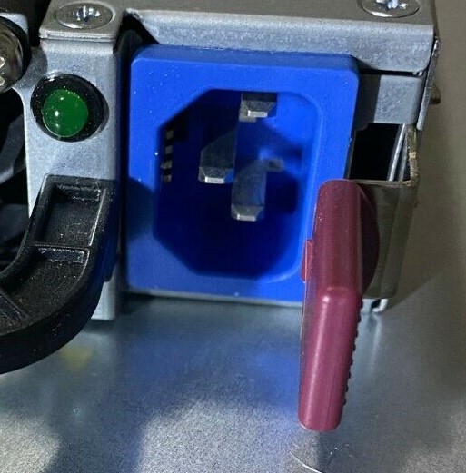

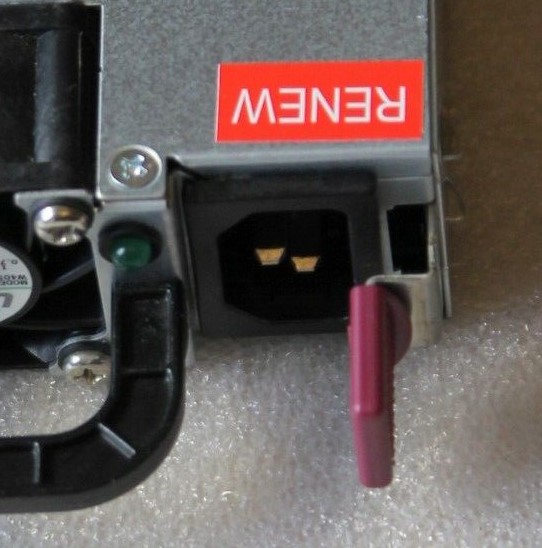

    Unfortunately the motors still are out of order. I modified my electronics box with new power supply (chosen 2x HP DPS-1200FB server psu) and after testing the setup with SMC3 evrything looked good. Started testing with AC and after some minutes one of the psu was switching of. Now it starts when plugged and after some seconds the Power LED turns off.
    I imagine the fan of the psu was not working correctly. I bought the 2 psu seperatly and found that I got 1x DPS-1200FB-1 A and 1x DPS-1200FB A. The one that is not working anymore was with some additional contacts inside the socket for the main power supply,
    the other one seems to be "normal".
    I guess modifying the psu with resistor to simulate its placed inside a rack is not enough for getting the fan to work. The information to be found in the internet is not that clear on that point.
    I ordered a second one with the "normal" socket to give it a try.
    However the first (very short) try with the new motors was very promising :thumbs.
    BR
    Chris

    Need some Help!!

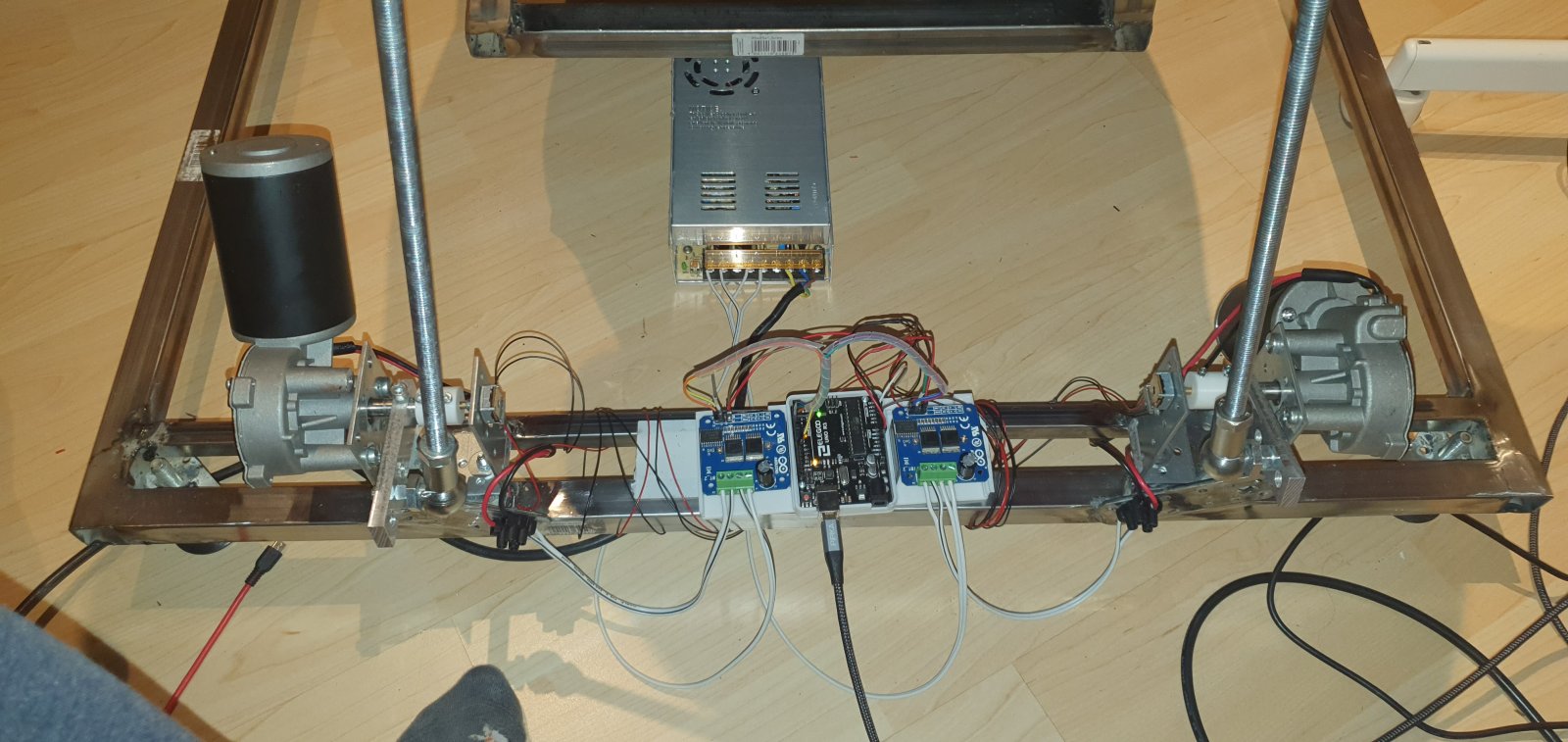

    After a lot pf Ups and Downs in the last few weeks, I finalized the rebuild with wheelchair motors. What have I done:
    - switched from the china wormgear motors (12V/60W) to german wheelchair (wormgear as well) motors (24V/240W)
    - switched from 12V/360W LED PSU to 2x HP 1200W server PSUs and again to 2x 24V/360W LED PSUs (modified server PSUs caused a highly flickering PWM signal which leads to stuttering motors in groundposition
    - switched from 10k china pots to 10k pots with unlimited turns and 270°
    I still use the Arduino Uno and the 2x IBT2 H-Bridges from the former setup. What is the problem now:
    I can setup a smooth movement in SMC3 and let the motors run in Sine minutes, even Motion is doing well most of the time. From time to time during motion one of the motors (it happens to both) stops moving with the target line within the limits. Nothing strange happened before, motor just stops and it needs a restart of SMC3 to put it back to motion.
    Starting SimTools similar bahaviour. It starts, centers the rig. I have setup a new profile for AC with less movement and the rig is moving like expected until, again, one of the motors stops moving. If so only closing SimTools and starting SMC3 or closing SimTools und unplugging USB can reset the Rig and bring it back to work. My feeling tells me that the motors (again, it happens to motor one or motor two) stop moving after more aggressive moves (like bumps or curbs).
    Is it possible that both IBT2 are defect? As explained they worked with the old setup but had to drive 5 amps max. Now they have to drive 10 amps but should be no problem as they can drive up to 42 amps, right?
    I tried a lot but as the errors can be reset by restarting Arduino it has to be caused by the electronics. I think PSUs can be eliminated as it is the same with the 2 modified server PSUs.
    I would also eliminate the pots as in SMC3 you can see clearly the motors stop moving within the Clipping lines, so the pots are still delivering voltage within the limits.
    Someone got an idea?
    BR
    Chris
  19. noorbeast
    21,723
    152,051Coins
    +11,063 / 56 / -2
    If it happens in both SMC3 and SimTools it may be USB related, have you tried different USB ports and cables?
  20. Christian Doehl
    Christian Doehl Member Gold Contributor
    Oct 6, 2020
    63
    Germany - Bavaria
    677Coins
    +35 / 1 / -0
    Not yet, but sounds comprehensible. But the problem wasn't present with tho old motors and old PSU. I will give it a try this evening.
    The USB is connected via a USB Hub, I'll try to use direct connection and maybe also different port or cable, lets see.
    Thanks and regards
    Chris
