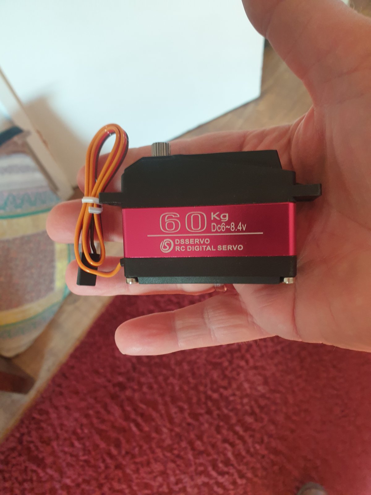

    First servo arrived today
    My plan is to use one servo to squeeze 4 small bladders from one paddle on a hinge .
    2 small ones connected by an air line to one large one ,ie when the servo moves the paddle all 4 small bladders send air to the large blue ones behind my back .

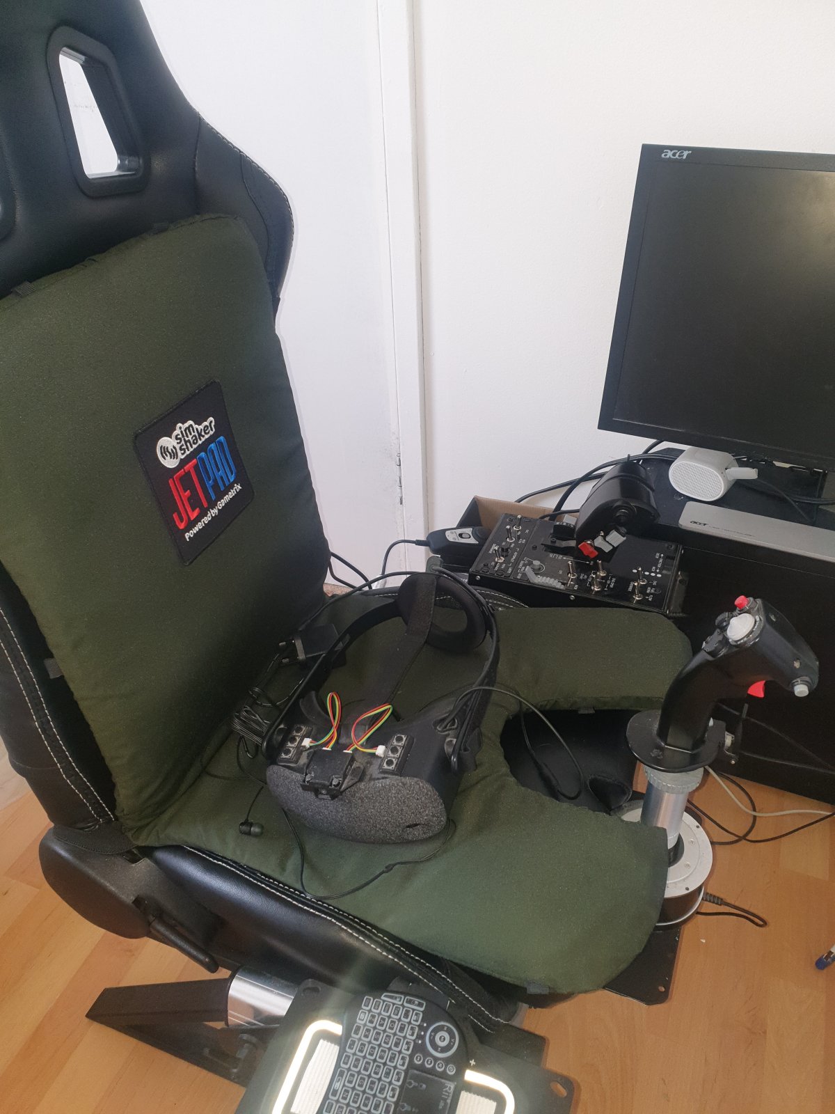

    A picture of the seat base for the setuo ,its a playseat airforce model with the warthog stick and throttle ,there will be a link from the throttle to the sliding potentiometer which will move the servo .

    Once the parts are installed for the seat back bladders then im looking at fitting some hall effect sensors around the outside of the base on the warthog stick for pitch and roll senses to the seat sides and bottom bladders using simtools .
