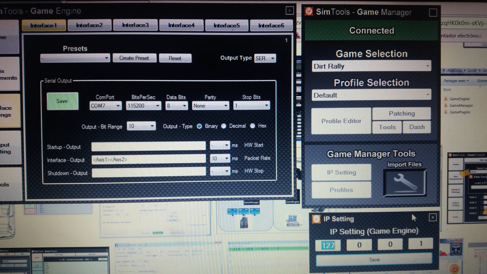

    It would help if you posted pictures of all of your settings.

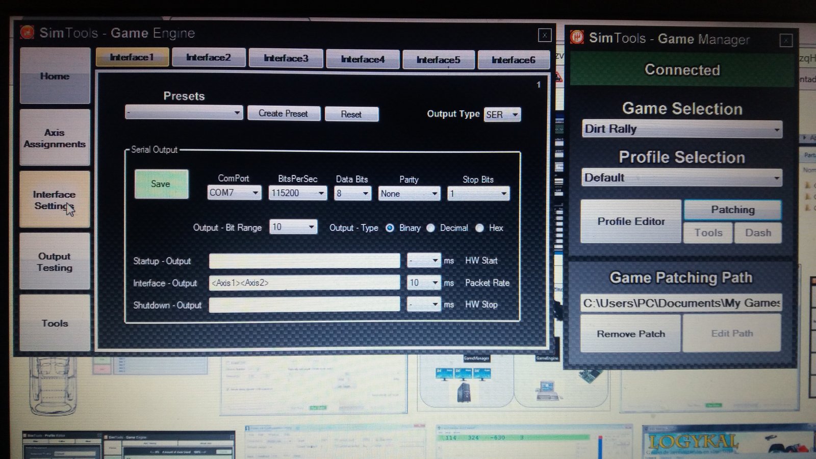

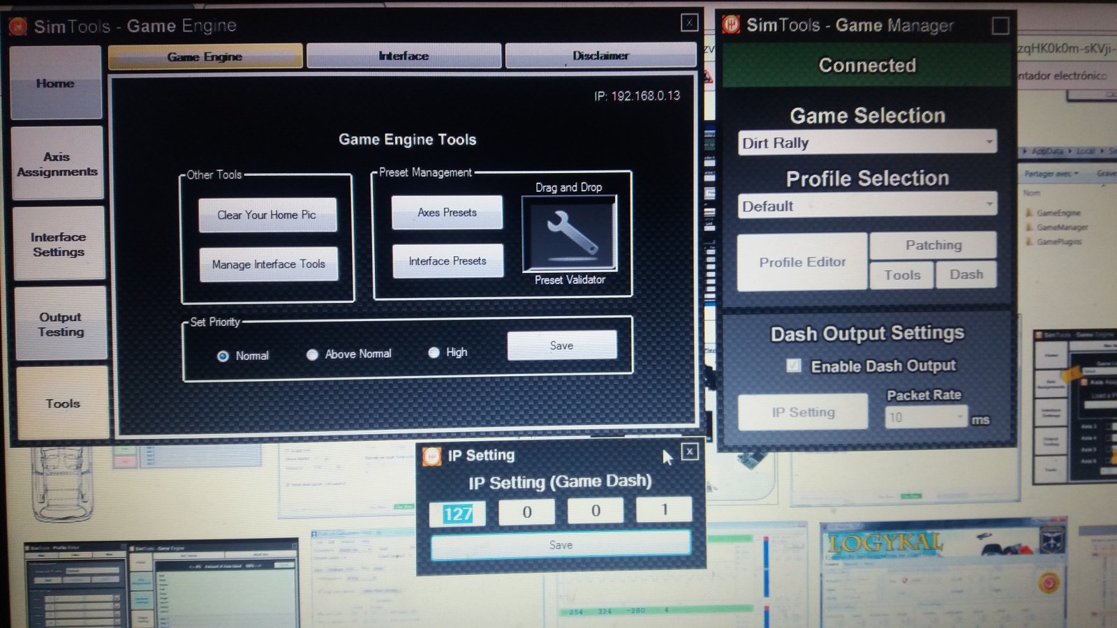

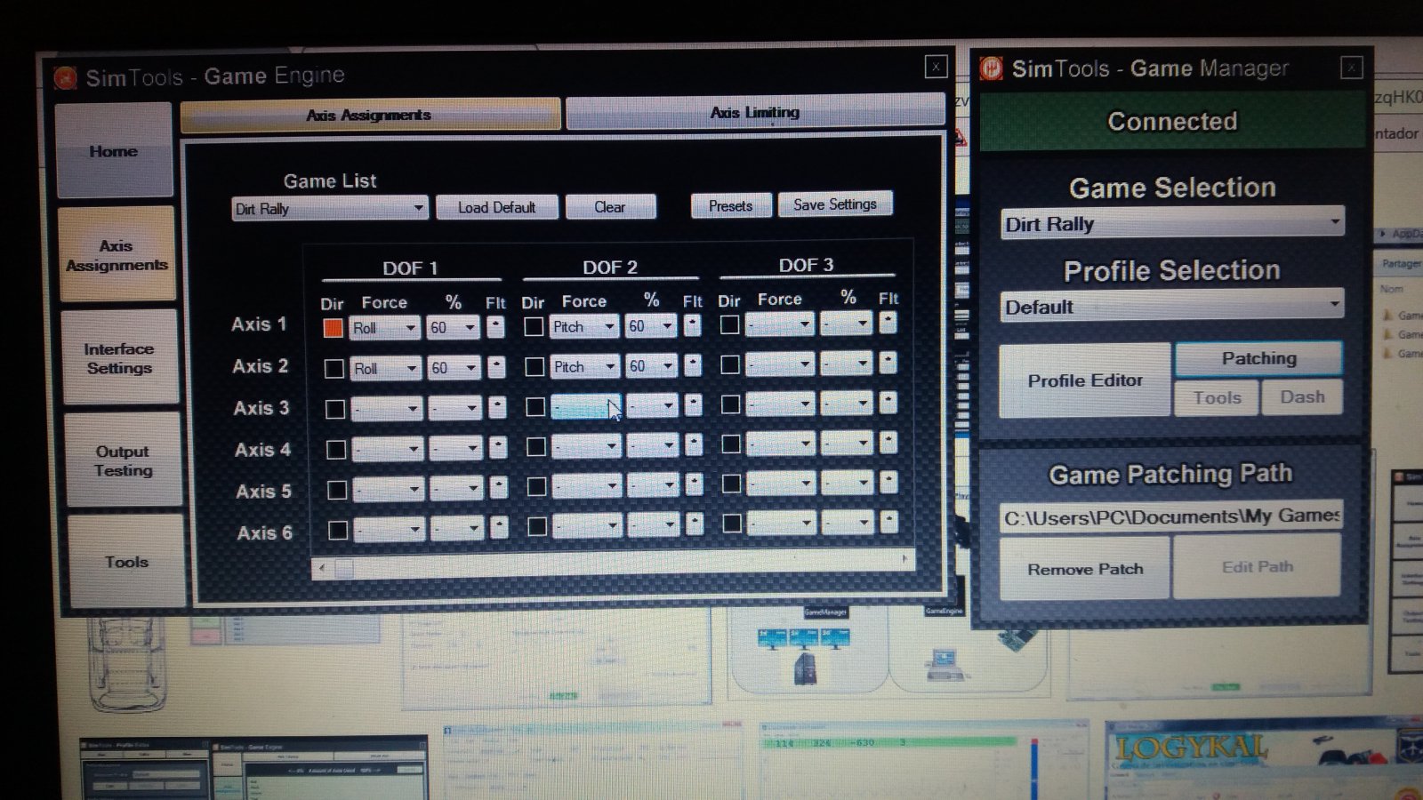

    correct the bridge h l298n is only for testing and sim start.
    attached configuration images made without having simtools action
    20171002_164601.jpg 20171002_164611.jpg 20171002_164741.jpg 20171002_164803.jpg

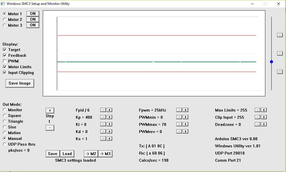

    Hi guys.

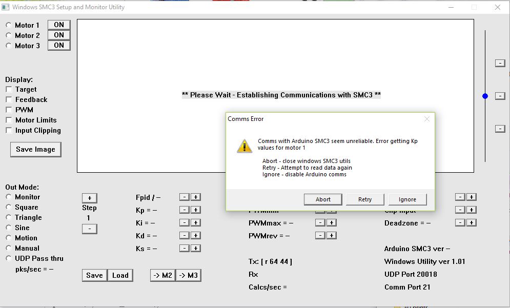

    I have just got my new controller box up to the point where I can try setting up SMC3 and I am having trouble getting the Sabertooth's to respond.
    I uploaded the SMC3 SPS script to the Arduinos fine and it communicates with the Arduinos. The pots are working fine because if I move them by hand I can see them move on screen but I can't get the motors to move at all.
    When I apply power to the Sabertooth I just get the status light coming on. nothing else. I am using a brand new Sabertooth 2x60 and a Syren 50 and I am having the same problem on both of them. I have tried doing the jumpers to autobaud but still nothing
    I have checked the input voltage to the Sabertooth is fine at 12V but there is 0V on all of the motor outputs when I try to move the motors.
    I followed the steps in the first post and here are my initial setting, I'm sure I am just doing something dumb.
    Here is a link to my build thread if you want to see how I have wired everything.
    https://www.xsimulator.net/communit...t-mover-gs-4-simvibe.5596/page-25#post-143435

    If I change the last instance of 115200 then I get this error in SMC

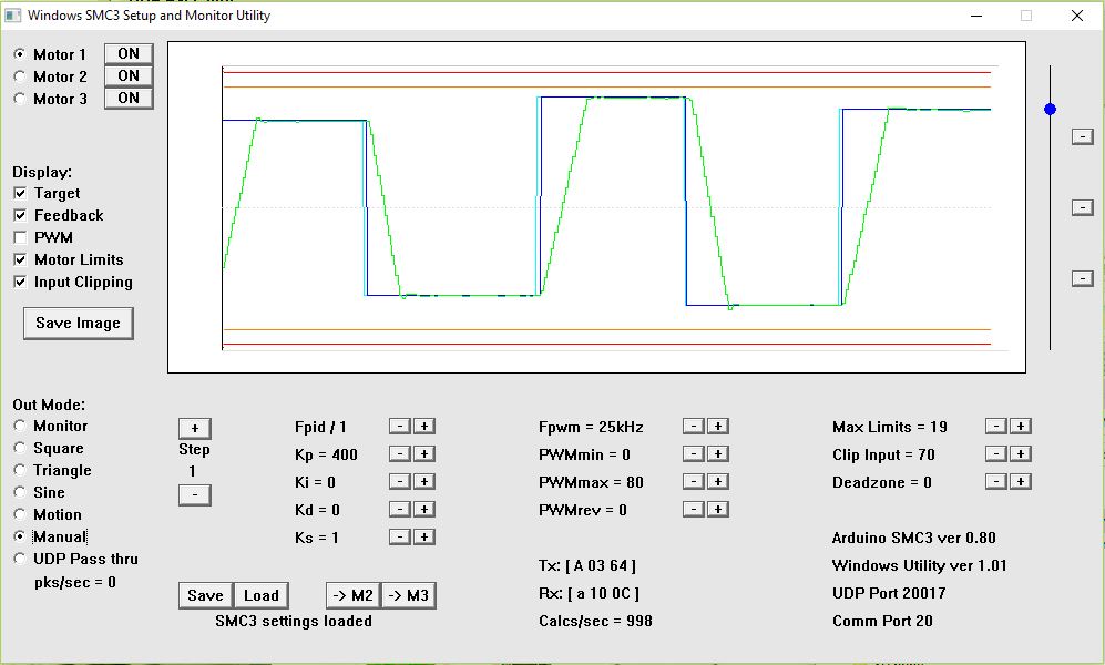

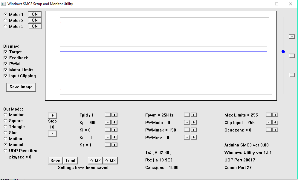

    Another quick question.
    The POT I use is a 1 turn pot and my range of motion is only about quarter of a turn. This means I can adjust the motor and clip limits enough. If I put them all the way up to 255 then they are still ages away from where the limits of my motion is. Is there a way to change this or do I need to swap the pots for half turn ones?

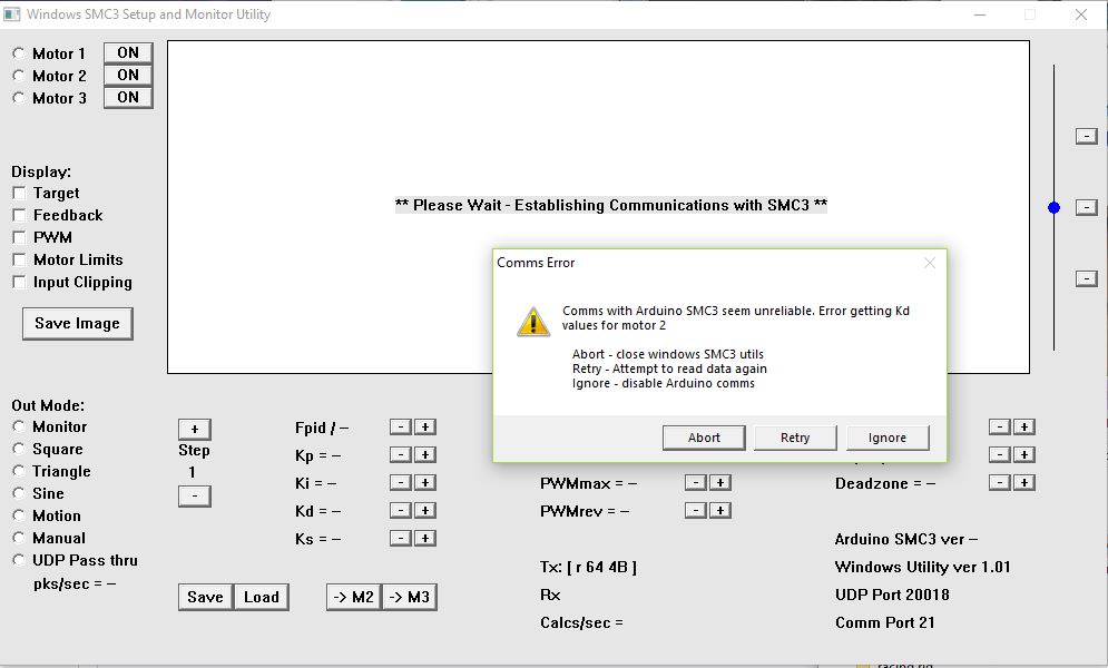

    Although now that it is set to 38400 then I can just run the standard sketch and just change the mySerial.begin(115200); to mySerial.begin(38400);
    I still do get this error, but if I click ignore then switch from motor 1 to motor 2 then back again then it starts working okay, so I can live with that.
