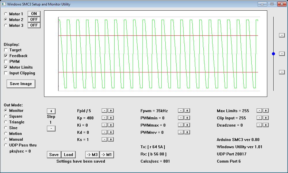

    OK. So I did a search on pot settings and got https://www.xsimulator.net/communit...tor-driver-and-windows-utilities.4957/page-27 so I reset the pots as per the instructions and Motor 1 when tried turning up the PWMax I got nothing
    So I then tried Motor 2 and it started to move and it went beyond the red limits so I backed it right down to zero and it kept on going even if I re selected Motor 1 , so I turned off the power and it stopped
    BTW my pots are 180 degree Hall Effect Pots powered from the Arduino 5V output
    This is doing my head in :mad::mad: :sos
    Does this make any sense to anyone
    The top screen capture is M1
    This is M2 that started but did not stop when I turned back the PWMax to Zero

    My head is starting to feel a little bit like yours now but I'm not quite out of ideas to try yet. Don't forget you are attempting to use an unsupported controller though so some issues are to be expected. With that said the 2x25 appears to be compatible with the sketch with the exception of not doing 115200. That's important however because the sketch has been optimized to run at that rate so it doesn't have much overhead. I therefore suggest you increase fpid to around 7 to give you some and then try again.
    Its been a couple of years now since I studied the original smc3 sketch in order to add sabertooth packet serial support but I believe PWMmax and PWMmin still apply even though a sabertooth is not controlled with pwm. But setting Kp back to zero should definitely stop a motor if Ki and Kd are also zero.
    And I'm not positive of what I'm seeing in you last photos but it looks like M2 may be wired backwards? And I don't know why M1 isn't running now. One thing I would do though is to test that the serial timeout is working on your 2x25. Redo your M2 test and as the motor runs disconnect the S1 wire on the 2x25. If its working the motor will stop. If it doesn't though be ready to remove power. This will at least tell us that smc3 is still sending out new data packets and that the 2x25 is not just continuing to run on the last command it received.

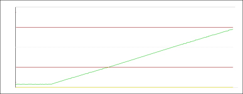

    I have been playing with the pots and I have probably rotated both through 360 degree.
    When I test either motor and it fails, to reset the Motor ON/OFF back to OFF I have to rotate the pot past the limit and back to the center and if I keep going to the next limit the trace goes from a smooth
    slope to a square wave type trace for a certain amount and then it becomes a smooth slope trace again.
    I did try upping the FPID to 5 after reading some posts but that had no effect
    The other thing which I think is pot related is when I reset the Motors after they go over limit or whatever and return the green trace to the center It only moves to target line only and no further regardless of how much I up the PWMax.
    The confusion for me comes from the fact that the green trace is meant to head towards the target line if the motor is wired correctly, but how is that so as I thought it would have to start near the limit and travel towards the target line and presumably pass the target , head towards the limit then crack a left and head back up to the blue target line again like a sine wave does I think ?
    Does any of that make sense.:think

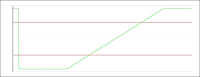

    I tested the pots with the voltmeter and yeas getting the 4.8V and then set them by the SMC utility checked voltage and at about mid point 2.5V
    Tested again and M1 did not move nor did green tace.
    Tested M2 and same. re did this few times and the same, same.
    Thought I'd reverse wires on motors and redid test.
    M1 moved and went out of limits, so I quickly removed the S1 wire from the Arduino and the motor kept running, so I then disconnected the Arduino's USB and the motor still kept going
    WTF batman, so I turned off the power to the motor and that stopped it.
    So now I am totally confused as to what is happening .
    BTW the motors were only being powered by my power supply and not with the separate battery connected for the regenerative current if that makes any difference. :sos
    I should have done a screen capture but I did hit the save image button and this was the trace

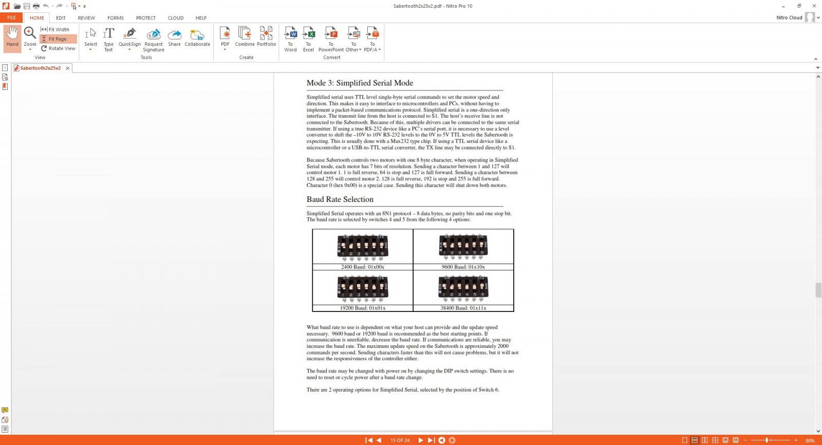

    Maybe I wasn't clear. Did you read the 2x25 manual to learn about simple serial? You don't use or need describe with simple serial you just set the dip switches on the 2x25. Set 1-6 as follows; on, off, on, off, off, on to set simple serial mode @38400.
    Is that what you did?
    Btw, since simple serial doesn't use a checksum and needs just one byte for control of a motor it will move with any byte sent; good or bad data. So it's best to have motor levers disconnected until things are sorted.
    Most people that use supported controllers with smc3-sps though don't usually have many issues other than a motor wired backwards of feedback so I can only think it has something to do with using a 2x25 @38400 if you have it all wired properly.

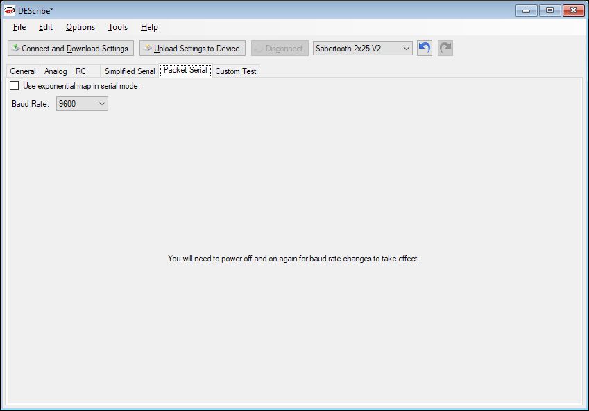

    I set the dip switches to Mode 3 as per the manual, ON-1,3.5,6 OFF - 2, 4
    The manual for 2X25 V 2 says that it will only go to 38400
    All the tests that I have done have all been done with levers disconnected.
    Even when I think that I've got it but the motor needs polarity change and I do that and then reset the pots to get the On/Off back to off and recenter the pots, then it must only drive a few clicks
    before it reaches the target line and can't go past that line for whatever.
    All I can do now is try dropping the baud rate to 9600 by the dip switches.

    I don't know what information your reading because this is how the manual shows to set to simple serial mode @ 38400 and that's what the Test sketch uses.
    Its the same as how I told you to set it earlier but I guess you don't want to believe me anymore.o_O

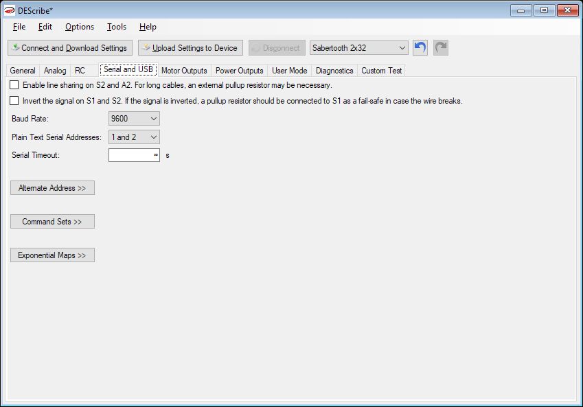

    I have been trying to do more reading of the manual to see if I have stuffed up somewhere which might be causing my problem
    I remember You said If you wish to use serial timeouts on a 2x32 you must set them to 100ms
    Now I think that my runaway motors are related to timeouts ?
    But I could not find a setting in Describe in any of the tabs in the latest version of V3.7
    So how or who is controlling timeouts, is it some code in the Soft_Start sketch ?
    Can I use Describe as a 2x32 rather than a 2x25 V2 - Answer is No. It recognizes it as a 2X25 V.2
    Only the RC tab has a timeout function in 2X25 mode, so I have tried uploading that set as 0.10 which I hope is right and it uploaded OK, so no to see if it makes any difference.
    I'm a pessimist by nature so $20 says Nope. But I am crossing my fingers anyhow.
    This is my Describe pic.
    Screen capture of Describe with Sabertooth 2x32 selected from drop down menu which does have the timeout function SerialUSB2x32t.jpg

    So I thought that the routine that you said would reset the Sabertooth's memory but that doesn't seem to be doing anything.
    For good measure I reloaded the SoftStart sketch and edited the baud rate to 38400
    So I hooked the Sabertooth up to my laptop and did a reset from the file menu, then I re-did and checked the settings which are Baud 38400, Packet Serial and timeout 0.1
    Dip switches have been set for 38400
    With that done I hoped it would at least be back to square one, but no sir, the Sabertooth I assume is running on the last command, how and why I just don't know.
    Or is the Arduino doing weird things ?
