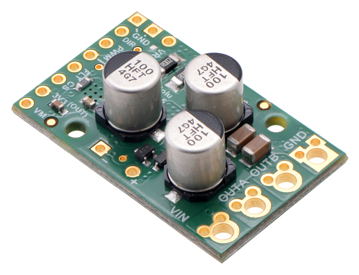

    That driver is not supported and completely inadequate for a motion sim anyway. It would use mode 2 if anything but that was made to drive the ibt-2 driver and it uses a non-standard wiring setup for it.

    Thanks for the feedback. What driver then do you suggest for 24V DC motors?

    An ibt-2 will do 24v but they're not reliable so I can't recommend them. Sabertooth controllers are good and recommended but more expensive.

    Thanks. I'll try them out

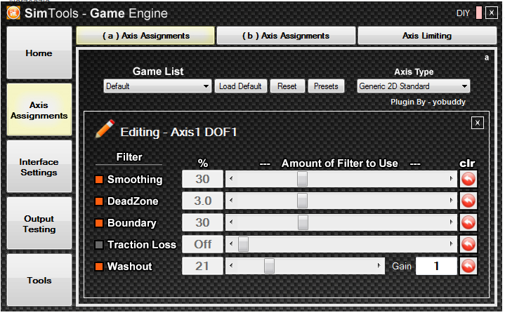

    Hi
    I have a problem
    with the settings in the Sim Tools Game Engine
    I have a feeling
    that most of the settings in
    Axis Assigments
    -Filter doesn't work
    best regards

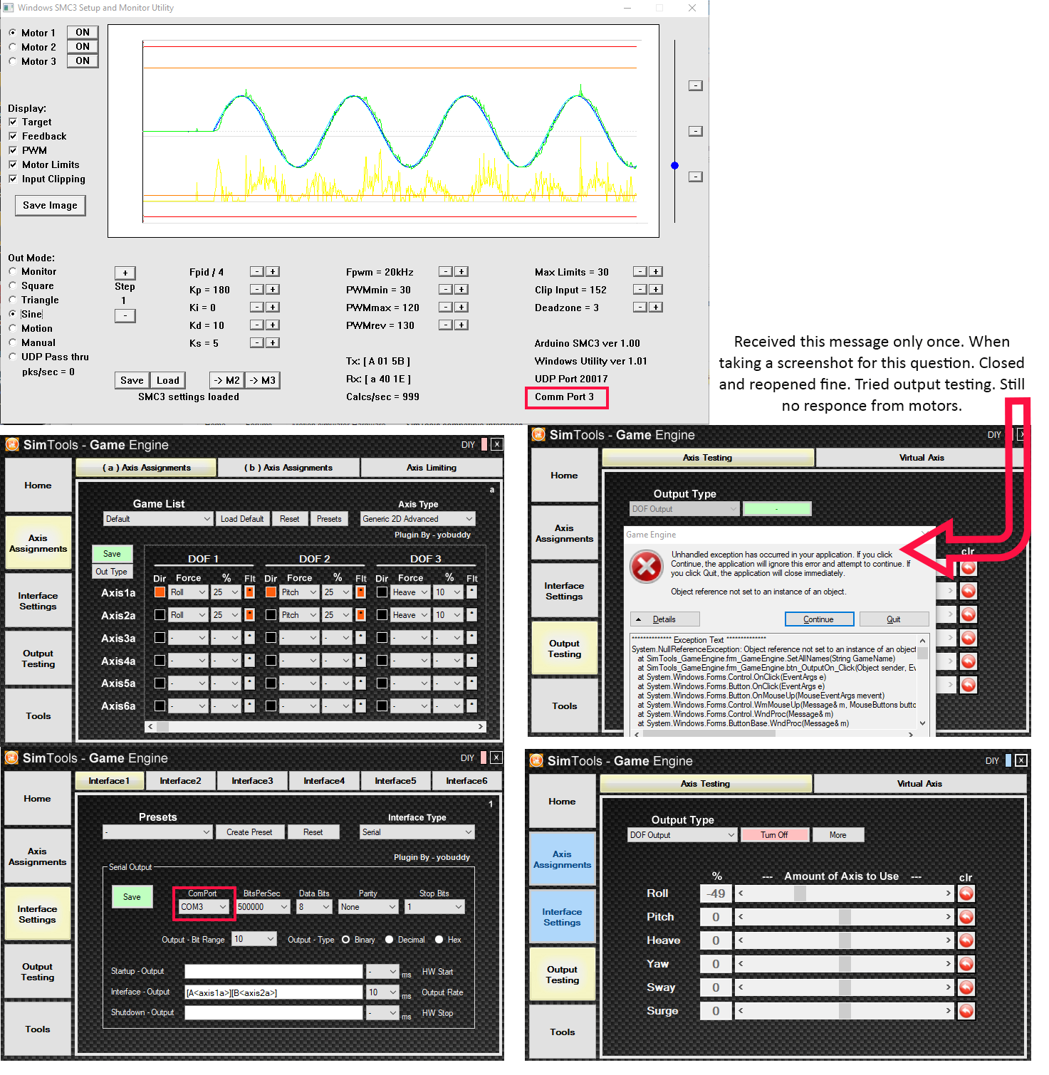

    Please help - I haven't used my seat mover for a few months. Was working fine, now it's not - I cannot figure this out. Not sure if Windows updates have caused an issue. Motors run fine through SMC3 - however, game engine output testing - no response? Everything still seems to be configured correctly. I'm really stumped. See screenshot of my config. And I did close SMC3 util before running game engine. I have the exceptions for game engine configured in my Windows Defender firewall settings. I really don't know what's wrong.

    @Andrew Eccles Did you closed SMC and then started GameEngine? I made that mistake a few days ago. Going to go crazy but then i get helped here. I did not know that smc has to be closed before GameEngine start!

    Yes - made that mistake a few months ago :) It's closed. I've uninstalled simtools and resintalled. Still nothing from output testing :(

    I tried uninstalling and reinstalling to the latest 2.5.1. and checked my .net framework - everything seems to be in order. When I start output testing - the motors start chattering i.e. some comms are going through. But the sliders do nothing. When Running PC2 the same thing when starting a race - the motors make a little noise. but no movement. As stated when running SMC3 - the motors run fine. At the point of nearly giving up on this now - I've read the manual about three times. Done everything textbook and still no joy. I work in IT and am tech savvy - this really has me stumped. Invested a lot of time and money into the setup - I just can't get it to work like it should :(

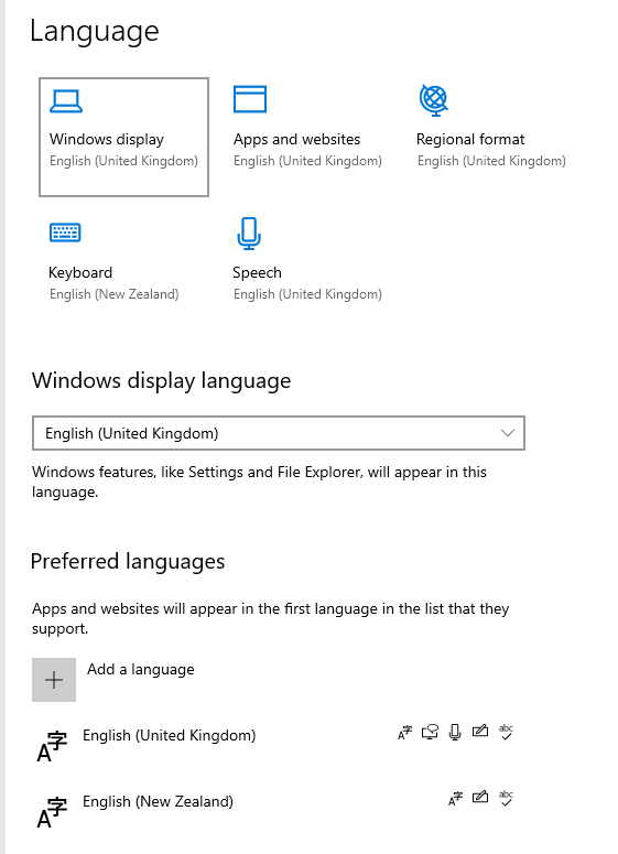

    Is the computer set to English Local, or something else: https://www.xsimulator.net/community/faq/simtools-language-setting-bug-change-to-english-local.233/
