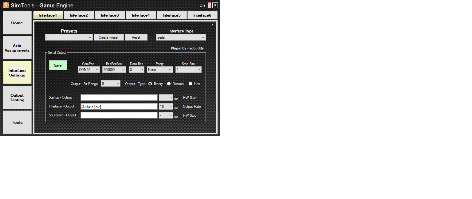

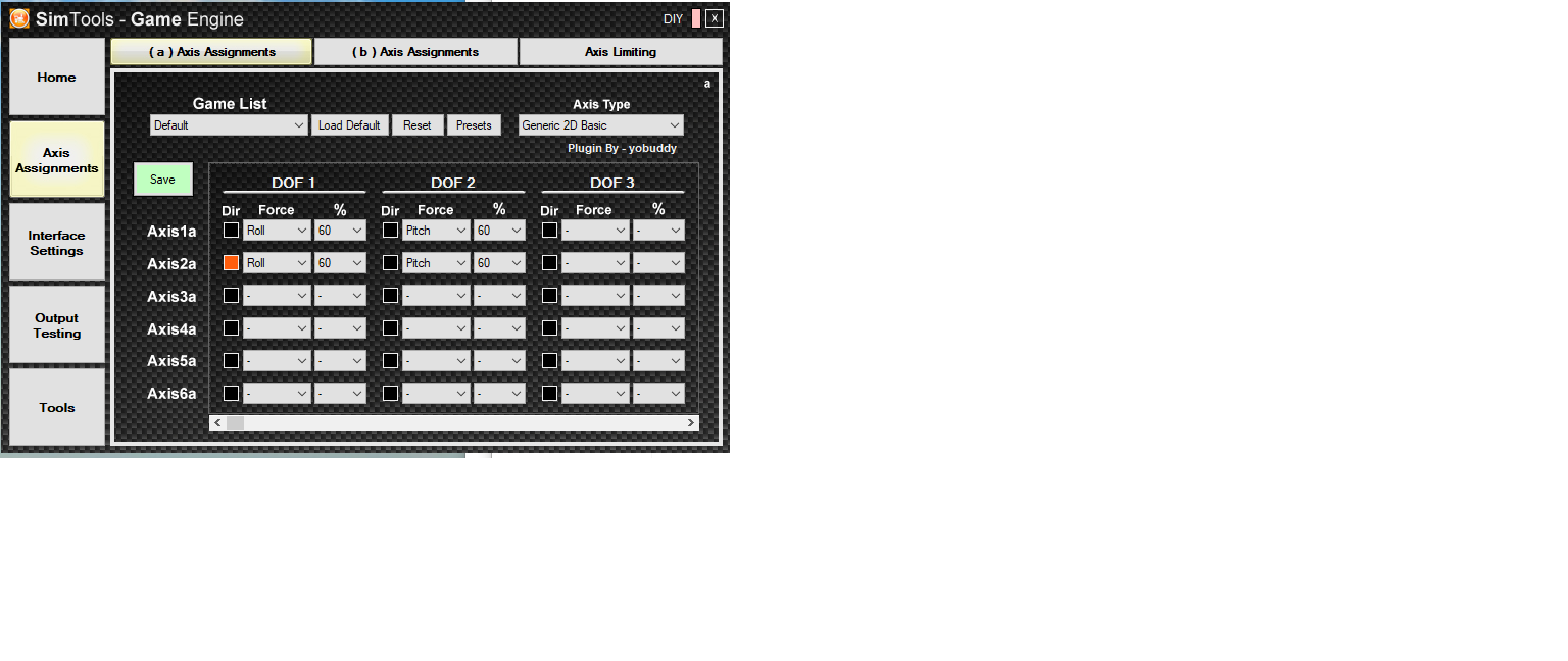

    [Quote = "noorbeast, post: 185.415, člen: 10786"]. Můžete mi prosím post fotografie vašich nastavení a hardwaru [/ quote]
    Je to IBT2. Arduino kod mode 2. motor stěrače 12 voltu, v smc3 utilitě běží vše perfektne. jakmile se přepnu do simtools tak motor začne být nestabilní, a při posuvu osy meni polohu
  5. Jan Havranek
    Jan Havranek New Member
    Sep 13, 2019
    7
    36Coins
    Na obrazku je output bit range 9, používám samozřejmě 10, pouze zkouška

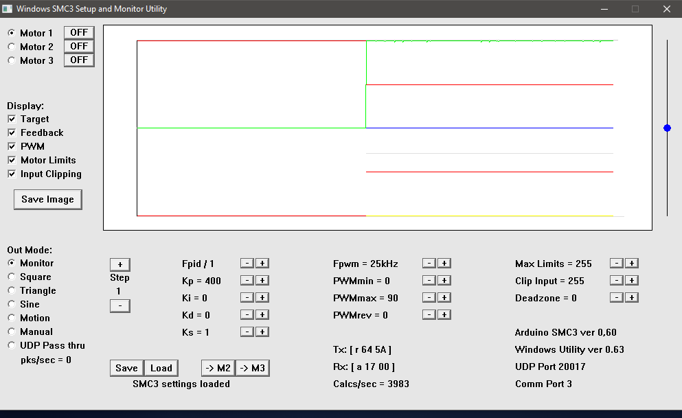

    You first need to provide pictures of SMC3 settings and verify that everything works as expected in SMC3, is that the case?
    Next please post pictures of your SimTools Interface Settings.
    win 10, pot 10K, motor wiper 12v, IBT2.
    I've tried all the settings in both simtolls and smc3. without success. it only changes the smoothness of the engine. The movements remain the same. at a certain position it changes the direction of rotation. I'll try it for 4 full days. Including reading this forum. I changed arduino, ibt 2, motor ...Thank you

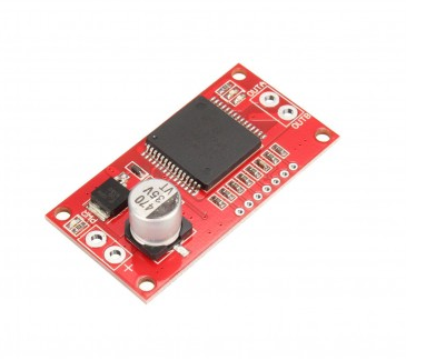

    I'm using two MM Single-Channel VNH2SP30 (I’ve test them and they work) such as this:
    I've done all the steps of "Initial Setup" but nothing happens when I increase the value of PWMmax.

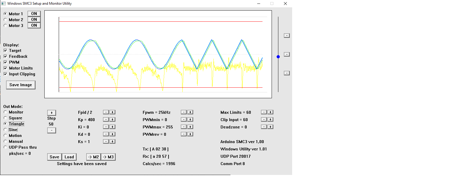

    When communication begins, I don't understand why the green feedback line goes to the top and stays there.
    This is what I see when I increase the value of PWMmax.
    As you know, the MM Single-Channel VNH2SP30 has a pin for enable (EN)
    So I tried to put them in HIGH but nothing happened either.
    Can you help me?
