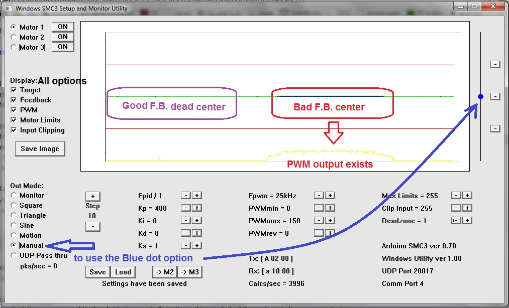

    Great work with the SMC3.
    I'm working with the smc3 in mode 1 and now I can move my motors using the smc3tool.
    What must be the value for "Kp, Ki, Kd, PWMmin, PWMmax, PWMrev, and the others configs"?
    Do you have a manual or tutorial to calibrate or find the perfect value?

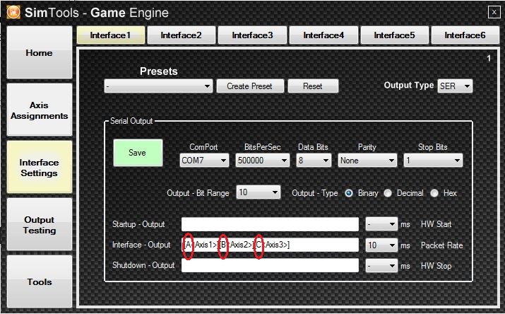

    A last question: I can move the motors using SimTools. Do you have a standard values for this previous settings in SimTools?

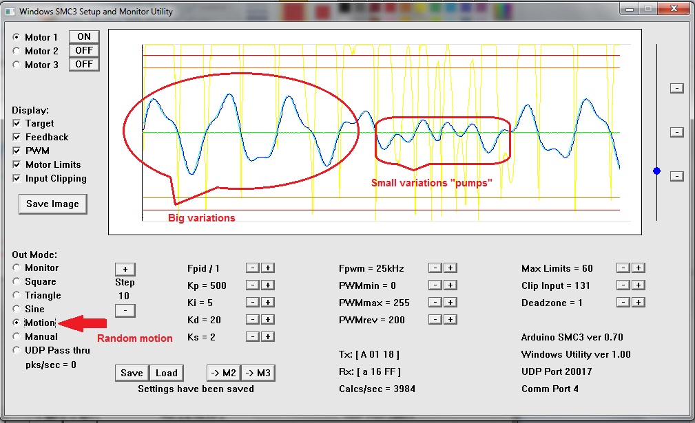

    Why does not KD affect one of my engines? the one on the right does affect him and I have managed not to bounce but the one on the left does not affect KD, I have reached 1000 and KS at 100 and remains the same, does that have a solution?

    Are you using smc3 v1.0?
    Kd will have greater effect when Ks is 0.

    I use the latest version, I tested ks to 0 and KD has no effect from 0 to 1000

    If somebody has an idea please help me....I've been struggling with PID settings for a long time. I can not get smooth at all with my rig, however I tried all kind of settings... Its almost good when kp under 80, but I lost speed and lots of detail of movement.

    If you can't get smooth motion using Kp only with PWMmax at 255 then your issues are likely not PID related. Could be noisy pots, under-powered, bad geometry, etc.

    I had a similar problem and I didnt find a configuration,but when I put some weight(one person) on the structures the platform worked smoothly(with the same speed), that indicated me that I must adjust the geometry in my platform.

    I have my simtools sending the payload to the SMC using serial port, but I know that is possible send the commands using network. I made this and put the out mode in the SMC3 tool in UPD Pass thru.
    Now the simtools is sending the data to SMC3tool(using network) and the SMC3Tool sends the data to the platform and it works and I can see if the target and feedback are aligned.
    My question is: With this configuration(network) is the performance equal to simtools using serial?
