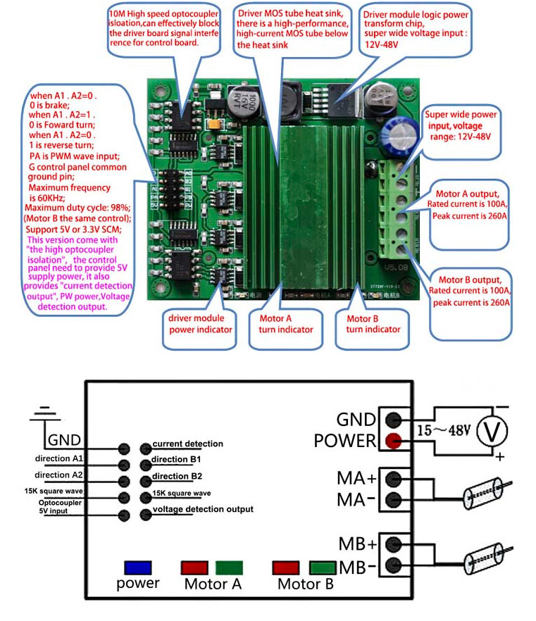

    Since I created a path of destroyed IMS-2 and IMS-1 driver boards I wanted to try one of these now:
    However I am a bit confused with the connection :-/ Does this even work with SMC3 ?
    I connected:
    ground to GND,
    5V to 5V Input
    And then it got experimental so I connected:
    Arduino [2] to -> direction A1
    Arduino [3] to -> direction A2
    Arduion [9] to -> 15K square wave
    Sinus Test in SMC3 moved the motor to one direction until limit and stopped.
    Usually I´d just start juggling with the wires but I burned too many drivers already so I became a bit nervous lately ;-)
    Swappig 9 and 3 would make most sense to me, but what do I know...

    @xytras, yes the wiring you suggest looks correct.
    If the motor takes off in one direction until the limits check the POT is connected the correct way (ie +5V and GND correct) You will see this in SMC3 utils as the green line will go in the opposite direction to the blue line in the chart. If that's the case swap the POT +/- wires (assuming it is not a hall effect).
    EDIT: Use MODE1 (and don't swap the 9 and 3 pins)

    @RufusDufus, hmm the wiring of the pots is correct, I did use this before with the IMS-1 drivers. So I need to change some wires because everything else is set up as before :D

    @RufusDufus, sorry my fault I had Mode1 for the chinese stuff in mind but it actually is for motomonster and alike. So I am going to try this, because I had it set to Mode2.
    To clear things up, the new (green) driver with no name did run the motor in one direction until limit in Mode 2. All I did was replacing the IMS-2 with the new green driver without doing anything to SMC3 except for resetting the values of course.
