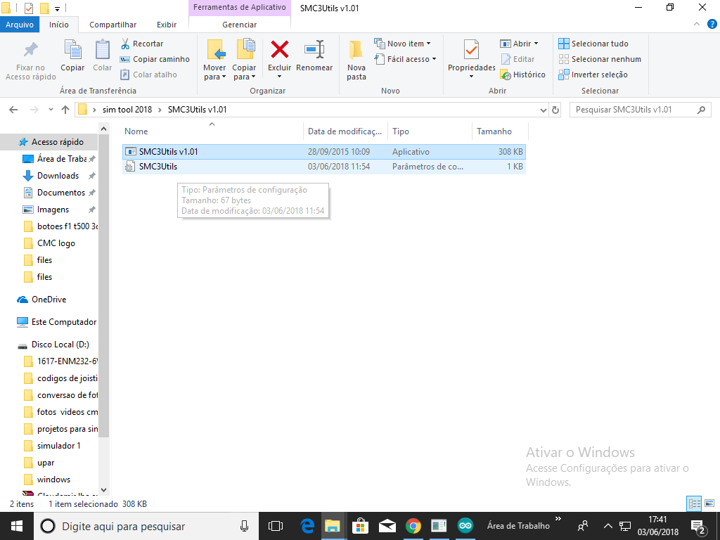

    Hello friends !
    I need an urgent help :(
    I'm having problems with the SMC3 program and with the simtools.

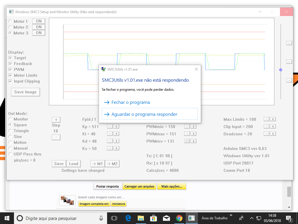

    When I open the program with the power source turned off everything works, but as soon as I turn the power on within 30 seconds the program stops responding.
    I have refit all the wiring, deactivated the antiviros, and the windows defend and nothing solved.
    I'm using an adu3 uno r3 with the ibt2 7960
    The same problem occurs with the simtools.
    please help me solve this problem!

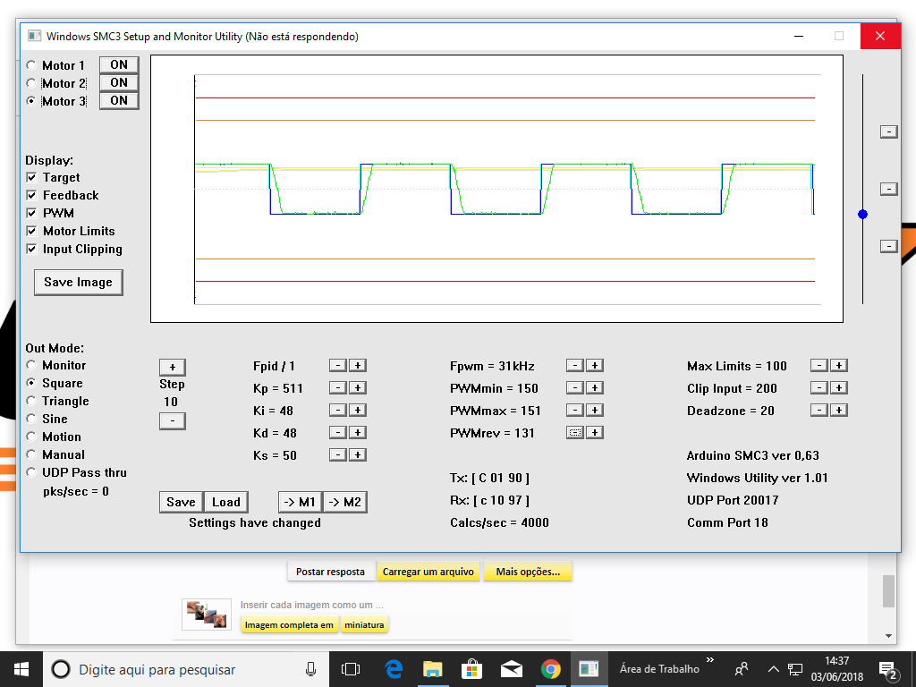

    I've already connected to another pc and the same problem occurs!
    I open the SMC3 and everything works correctly even with the power supply on.
    But when I click on square, so I can check the progress of the motors, they work correctly for just a few seconds and the TX of the arduino board that stays on blinks and then the SMC3 hangs :(

    I thought the problem was with my H bridge drivers.
    But as the motors are responding as they should, I believe it's not a spinning problem!
    The motors move in all directions correctly until the arduino flashes the TX led.
    So at this point, smc3 crashes and stops working. and this is happening with the simtools as well

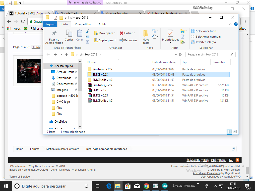

    3DOF, DC motor, Arduino, Motion platform, 4DOF, 6DOF
    I don't know if it makes a difference but I notice you have a different version of arduino smc3 to Windows utility

    I'm using these versions

    Really doubtful but have you tried opening the 0.63 utility?
