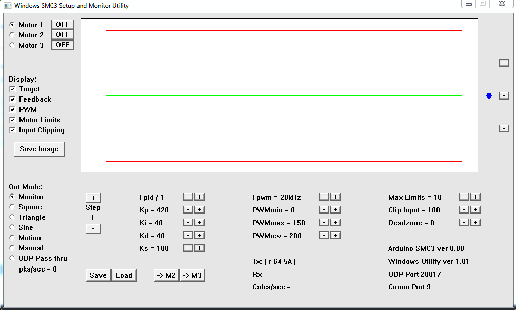

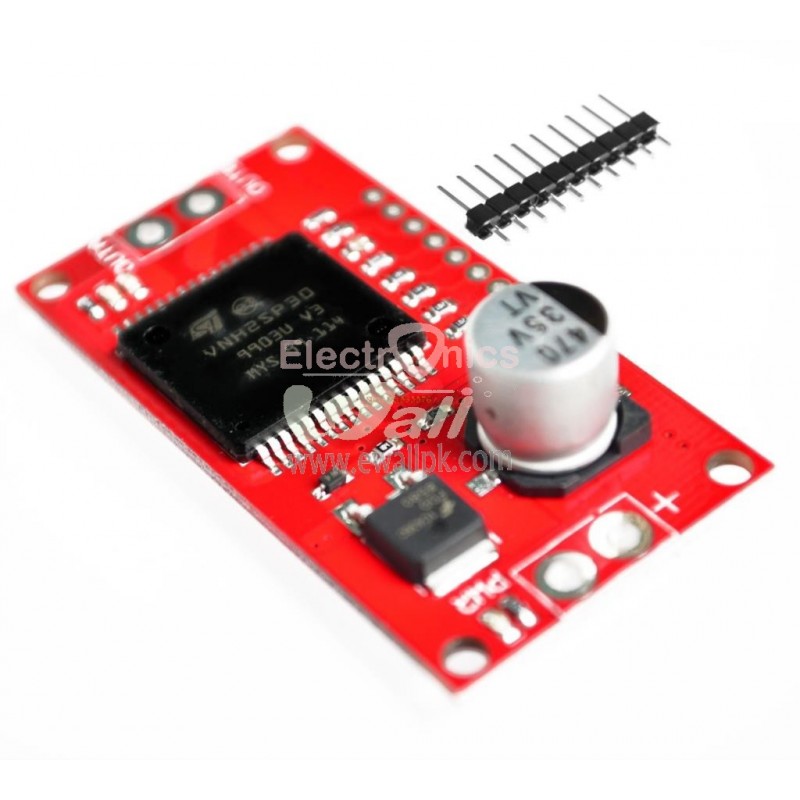

    I'm using the SMC3 (mode 1) with Arduino Uno (with SMC3 code) and 4 vnh2sp30 shields (picture below). I'm using two motors to each axis (this is why I'm using 4 shields). They rotate an excentric axis and are in the back of the chair (like the picture I posted).
    My connection is working well, it's just the axis configuration that is not working properly. Picture of Interface Settings below.
    About the Dir box, I configured exactly like you said, but the blue line always goes to the same direction in SMC3 graphic. It should go to the same direction in one of them and different directions to the other (for roll and pitch), correct? And just to confirm, is that right to test Roll and Pitch separately like this?

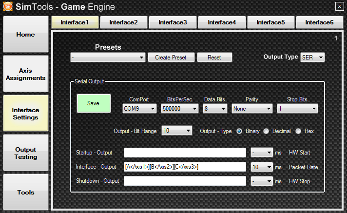

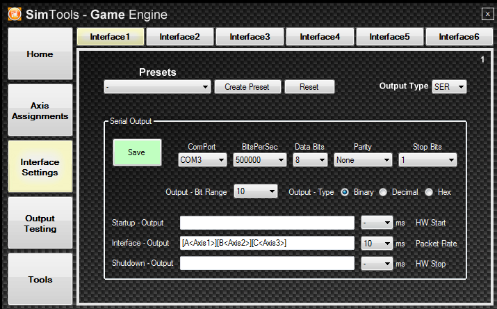

    I don't use the code but my understanding is that it would normally be configured for Ser interface, like this: https://www.xsimulator.net/communit...-and-windows-utilities.4957/page-5#post-50249
    Have you completed the SMC3 Initial Setup steps for each motor?

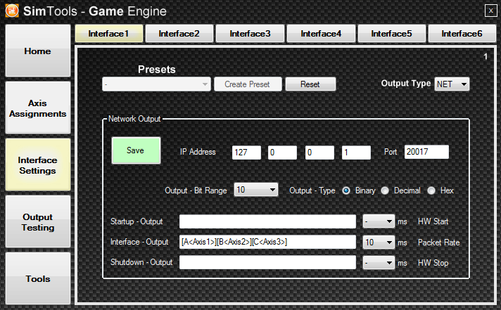

    @LuisBranco - UDP is a valid mode for SMC3 Windows Utils but requires a bit more setup and you have to run Windows SMC3Utils at all times with this mode as Simtools talks to SMC3Utils which then talks to the Arduino SMC3. Windows SMC3Utils needs the "UDP pass through" radio button checked.
    Also make sure you have edited the SMC3Utils.ini file to select the correct comm port for your Arduino.
    If you use a Serial interface from Simtools then you have to shutdown Windows SMC3Utils as Simtools talks directly to Arduino SMC3 and they cant both access the same comm port at the same time.
    If you say the motors are moving when you move the Simtools sliders then I would guess you have it connected correctly.
    If Simtools is moving the motors just in the wrong direction then I still think your problem is you need to be changing the "Default" profile in Simtools to see changes when using Simtools Output testing sliders. You appear to be changing the profile for a game which has no effect on the output testing. Think of output testing as another game that needs configuring.

    @RufusDufus @noorbeast
    Aboust the "Default" configuration, RufusDufus, I've already tested that using SMC3 graphics, but I'm gonna try using the actuators right now!
    And abot the connection, I'll change to "Ser" and test, then I tell you the results!
    Thank you guys!

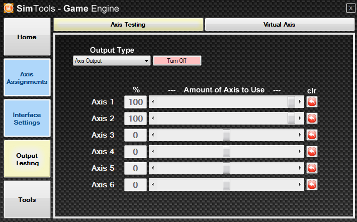

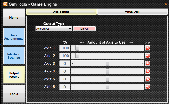

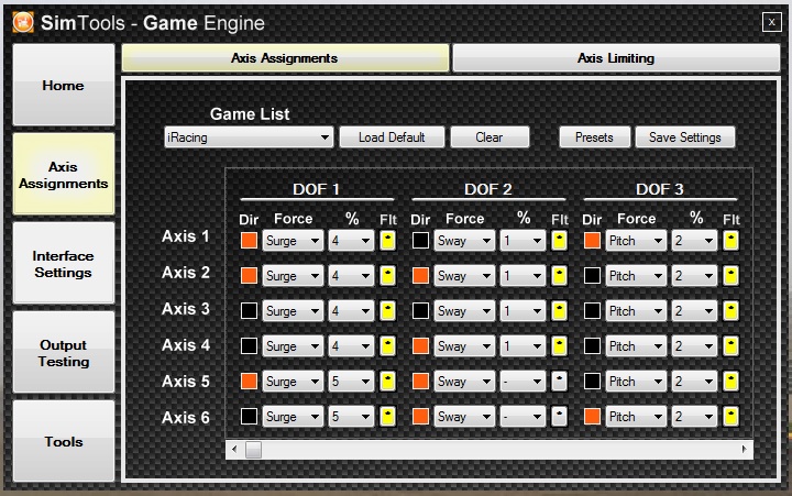

    So guys, I tried what you said.
    I changed the connection to "Ser" and used the "Default" configuration

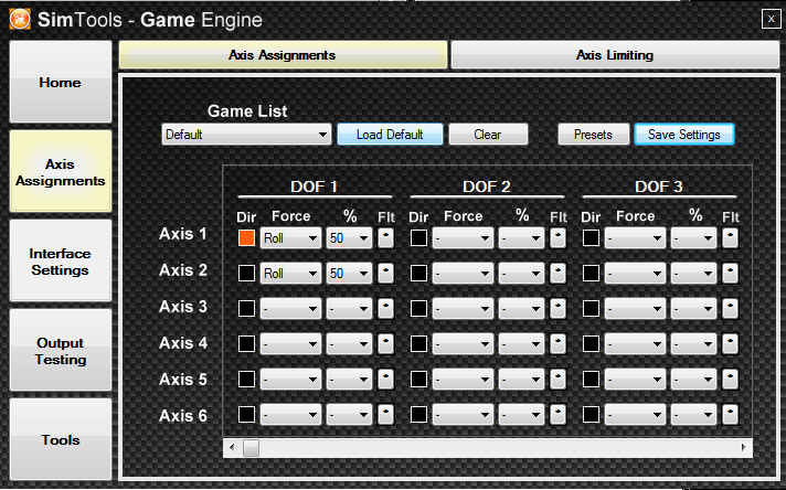

    First I tested the Roll (configured as pic "Roll" and tested the axis like pics "Roll2" and "Roll3"), and the result (pics "Simulator1" and "Simulator2" of my simulator) was right (as it already was for Roll)
    Then I changed the default settings to test the Pitch (configured as pic "Pitch" and tested the axis like pics "Pitch1" and "Pitch2"), but the result was absolutely the same as before (left and right instead of foward and backward).
    I also tried some different configurations of the "Dir" checkbox, but the result was always the same. It looks like this checkbox is not making any difference.
    Do you guys have any ideia of why?
    Thank you!

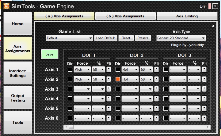

  8. bruce stephen
    Jun 7, 2015
    1,286
    general contractor
    michigan
    9,115Coins
    +1,243 / 9 / -0

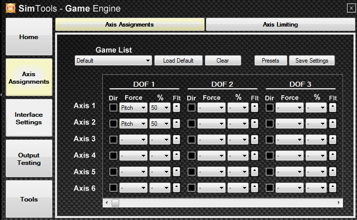

    set each effect you want in the of columns for axis 1 and 2. Example: dof 1=pitch, dof 2=roll etc. Then use "dof output" for testing. Also be sure to hit save after changing settings.
  9. bruce stephen
    Jun 7, 2015
    1,286
    general contractor
    michigan
    9,115Coins
    +1,243 / 9 / -0
    like this but just use axis 1 and 2

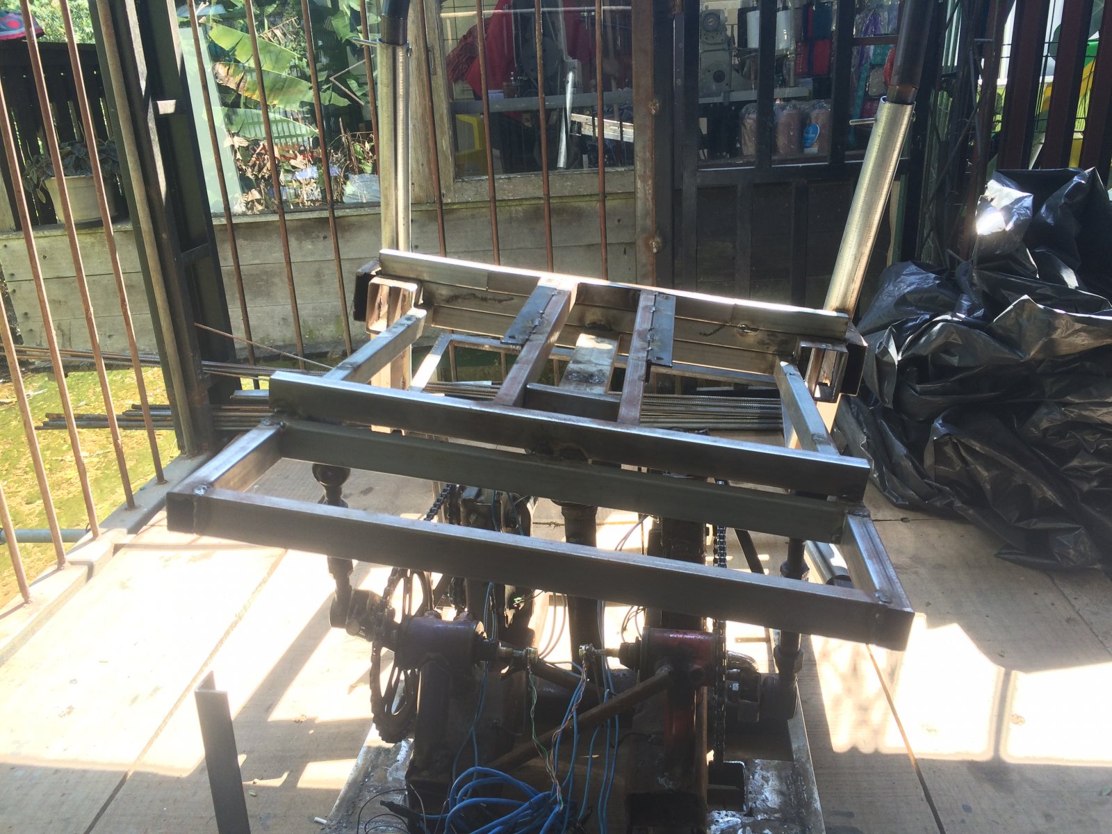

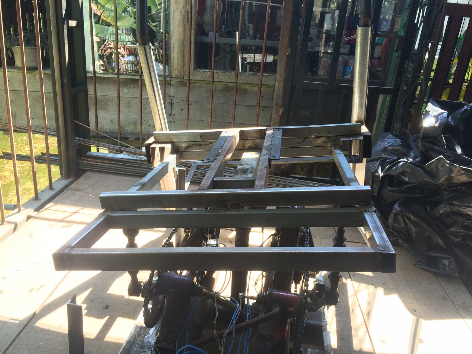

    @LuisBranco ... you stated before that one of the motors will be pich and the second will be roll ... where from your sim pictures they are both mounted to the same equivalent opposite points of the sides ... that changes everything .
    And by that now ... they both should do the same axis assignment job for pitch with the same direction PLUS the same axis assignment job with a REVERSED direction for roll .
    A different angle of view for your motors mounting points would be better please .

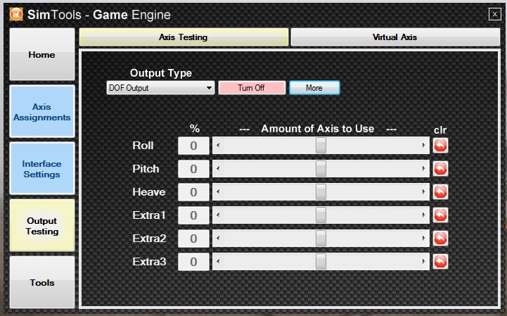

    @LuisBranco your latest screenshots show that output testing is in "Axis mode". In this mode the slider directly moves the axis motor, the profile has no effect. Have you tested in DOF mode? (change the dropdown box in Output testing mode)
  12. bruce stephen
    Jun 7, 2015
    1,286
    general contractor
    michigan
    9,115Coins
    +1,243 / 9 / -0
    this is where you test each effect.

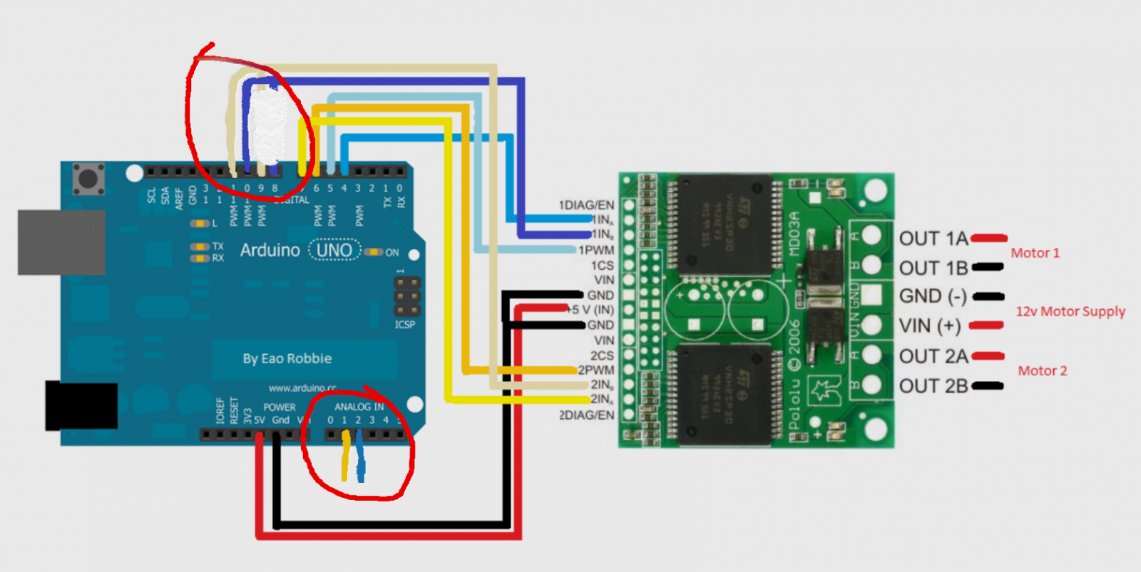

    If Motor 1 moves when driving Motor 2 then it is probably a wiring issue. Make sure there is a POT connected to both inputs or the unconnected input will pickup noise from the adjacent one.

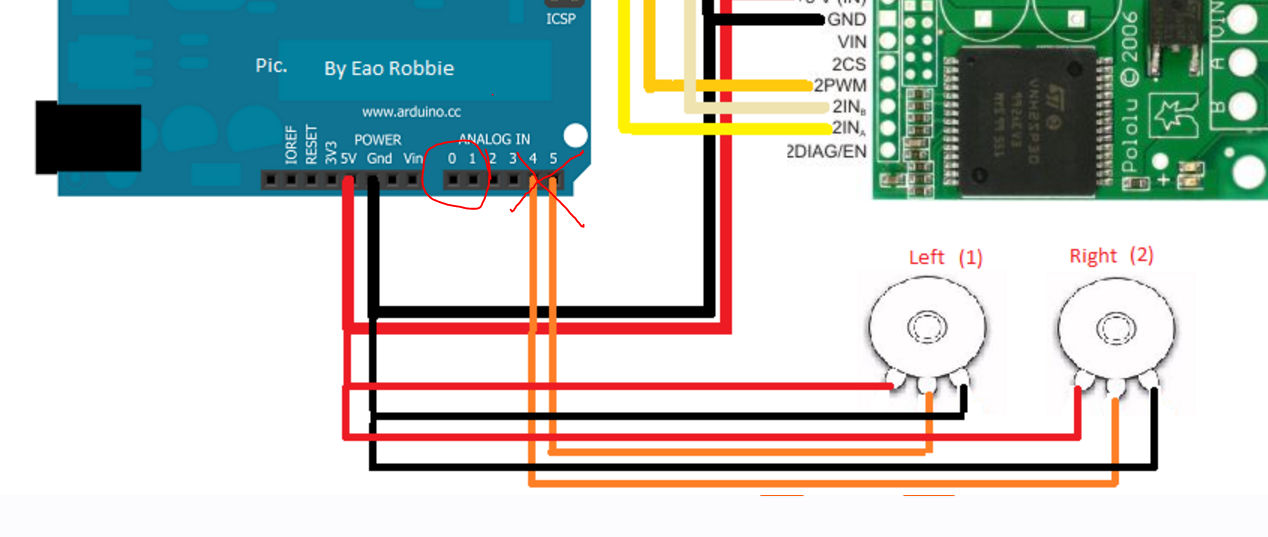

    so then the pots still goes to A0=motor 1, A1=motor 2 on the ard
    EDIT: analog inputs

    @moaale Your diagram has the POTs wired wrong. They should be on A0 and A1. You have them on A4 and A5.

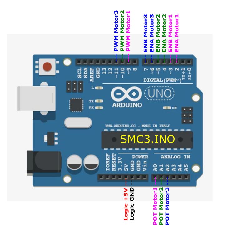

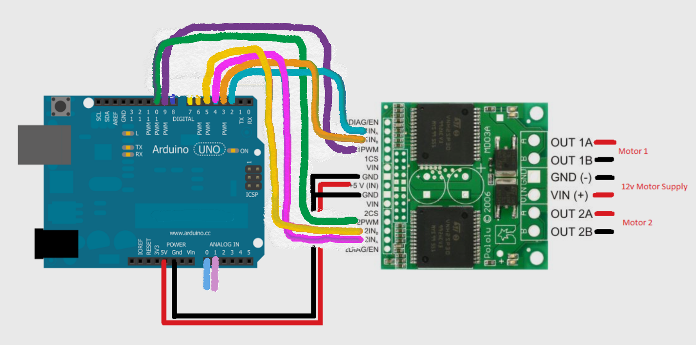

    Yes that motor driver is supported and will work - use default MODE1.
    You have the wiring a bit mixed up. You have connected to the motor 2 and 3 on the arduino and your PWM signals are wrong. You would need to connect POTs to motor 2 and 3.
    If you want to use as motor 1 and 2:
