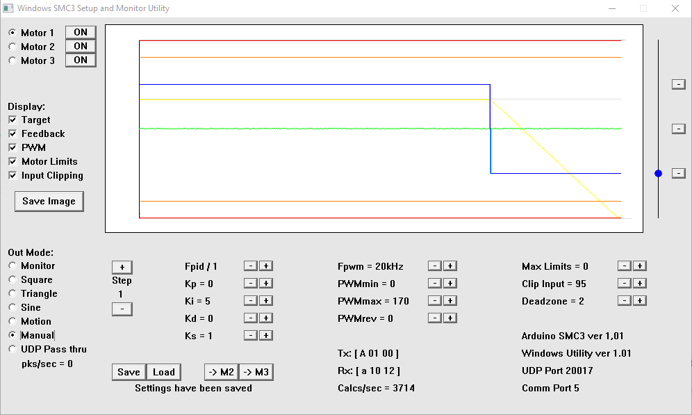

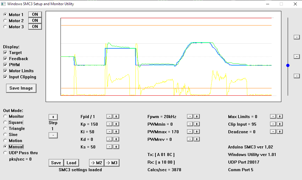

    I noticed that the I and D component of the PID regulator of SMC3 are not really working and implemented a fix.
    The attached picture "I_not_working.png" shows the step response after configuring SMC3 v1.0 as a pure I regulator (Kp=0 and Kd=0). The I regulator doesn't do a thing, it just plays dead - even though I ramped Ki up to max. It's also not working at all on lower levels of Ki.
    I expected the PWM signal to gradually change. The attached picture "I_fixed.png" shows the desired behavior.
    The attached picture "D_not_working.png" shows the response of SMC3 v1.0 configured as a pure D regulator (Kp=0 and Ki=0) to a sine curve. The regulator hardly does anything, there's just some noise visible. Checking the code, I found a rather odd implementation of a D regulator. It's response is calculated based on the change in position, while it's usually based on change in error. So the noise we see in the regulator's output is just the noise it's getting on it's input.
    I expected the regulator's answer to a sine wave to be the same wave but 180° degree phase shifted. The attached picture "D_fixed.png" shows the desired behavior.
    I also attached a zip file containing arduino code with the I and D fixes I wrote. There are 2 versions.

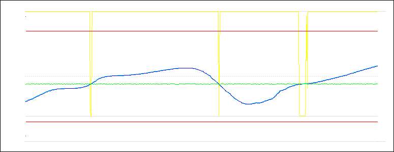

    I also used to drive my rig with SMC3 set as a pure P regulator (Ki=0 and Kd=0). If I increased Ki above 2 I got a lot of erratic movement on the motors that didn't make any sense. Similar with Kd.
    Check out the attached picture "UnModdedPID_PureP_Motion.png". It was recorded using the vanilla SMC3 PID implementation with Ki=0 and Kd=0. To me it looks ok.
    I also attached the picture "UnmoddedPID_PureP_StepResponse.png". Both the "pure" step response at the beginning as well as the manually softended step at the end show a permanent control deviation on the downward slope of the diagram (which shows my rig going up). The deviation remains constant at the end, where the desired position remains constant. This is typical for pure P regulators. Working against gravity, the motors would need more power to get to their desired position, but the pure P regulator is "too stupid" to realize that.

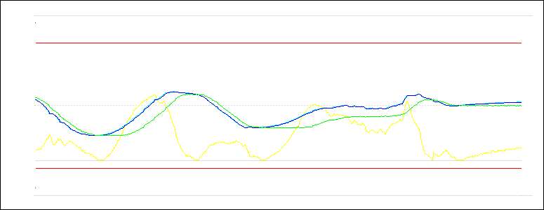

    Now lets check out how my fixed regulator code works out. Instead of Kp=200, Ki=0 and Kd=0, I used Kp=150, Ki=50 and Kd=0. The attached picture "ModdedPID_PI_Motion.png" looks quite similar to the first version. If you take a closer look at the long down-slopes in the middle of the picture (where the rig is going up), you see that the deviation gets smaller the longer the movement lasts.
    Finally, the attached picture "ModdedPID_PI_StepResponse" shows that there is no permanent control deviation anymore. This is expected of a (working) PI regulator.
    But how does it feel?
    I think my modded PID feels better than the original implementation. Doing slow up/downwards movement I used to feel a distinct torque ripple. It wasn't one smooth motion but like a fast series of mini-bumps that moved me around. I thought this was caused by imperfections on the motor gearing or cogging torque from the motor magnets. But I think this torque ripple is noticably reduced now that the regulator has a actually working I component. This makes sense as the I component of the regulator provides torque that doesn't change as wildly as the P component.
    I don't want to oversell it, though. Maybe it's all just in my head. I'd be happy if other people gave it a try and reported their findings.

    Independent of the code discussion, I just wanted point out there are under and, in particular, overshoots, with these setting that indicate further refinement is possible, and ask why Max Limits is set to zero, given its intended function: https://www.xsimulator.net/communit...driver-and-windows-utilities.4957/#post-48121
    Max Limits Used to create a band at either limit of the feedback range beyond which if the motors move (typically through inertia) the SMC3 will automatically shutdown the drivers and keep them disabled until reset. This is essentially a safety mechanism if something goes wrong. The value can be between 0-255 (however can’t be greater than the current clip setting).

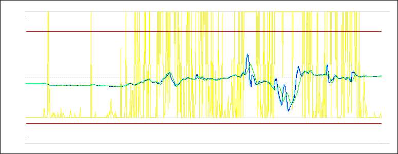

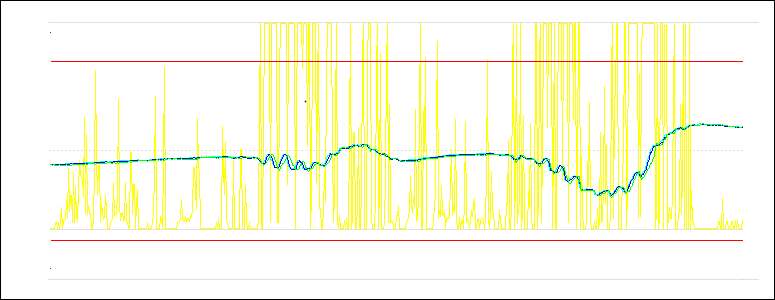

    For my testing, I hooked up a laptop between my game computer and my rig. This process is loosely described in the general description on page 1 or 2. SMCUtils runs on the laptop and passes data from the game system to the Arduino. SimTools sends the data via UDP via an interface I set up for this purpose.
    Using the built-in waveforms in SMCUtils is not the same as what happens in agame. I tried those first and everything looked fine. With this setup, I can observe the same displays but driven by the game instead. I’ve confirmed in my own mind that the integral term (Ki) is working appropriately. I can pull the motor into the correct position with low gain and a low PWMmin value. The Kd term is harder to test.
    My first test was with Richard Burns Rally (RBR). This game is harsh and sharp so much so that with high gain, it tends to become unstable. Using the Ki term can provide a very stable result, even when set to relatively high values. So, if you want games like RBR to feel harsher than they already are, these two terms can accomplish that without instability.This is driving off the road. Kp = 300 Ki = 50 Kd = 10. Its not that sensitive to values.
    The next test was with Microsoft Flight Simulator 2024. This is a very tough application to tune for. I use a sport plane Extra 330 LT which is very sensitive.
    I don’t know what the issue is. If you watch the data coming out of the game, it’s smooth as silk possibly because I have filters applied.
    Still, the position term needs to be set to a minimal value, like 200, to get reasonable performance. In this case, even minimal values (less than 10) for the integral or derivative terms cause undesirable results.
    This should be smooth slow motion. The "ringing" s NOT comfortable like hit the estop uncomfortable.
    The smoothest motion I can achieve is with the position term set to 200 and the other terms at 0.
    You can see it is quite laggy but also very comforable ride unlike RBR.
    So, unfortunately I don't see a net functional gain on the MSFS side.
