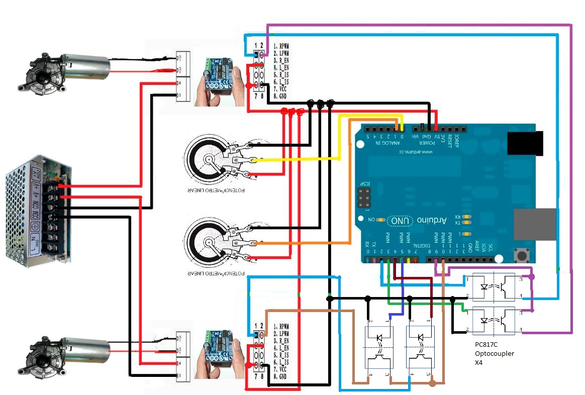

    This is how to Connect IBT-2 H-bridges to SMC3 and run in Mode 1.
    For me the motion was more controlled, the motors were quieter and the H-bridges stopped failing.
    (Did this whilst building my first motion sim so it's entirely possible my issues were my own doing)

    Thanks for the wiring diagram.
    I'm still playing with this sound, h-bridges and motors are almost not heated. And nothing breaks. So for now I will use it like this, and in the future I may use your scheme.

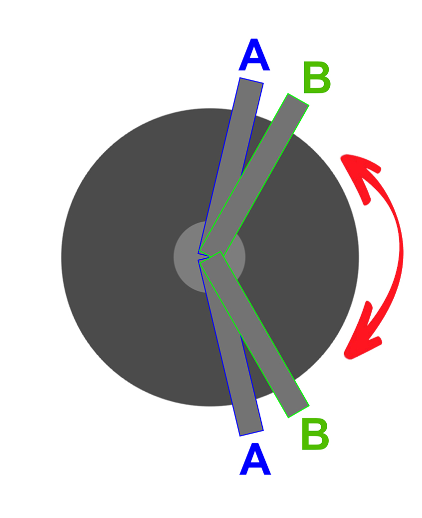

    3) For example, if I decide to decrease the maximum angular space (see image) and I want the motor arm not to arrive in position "A", but I want it to arrive in position "B", which parameter should I modify?

    2) Using those parameters you can set the range and behavior to control that range:
