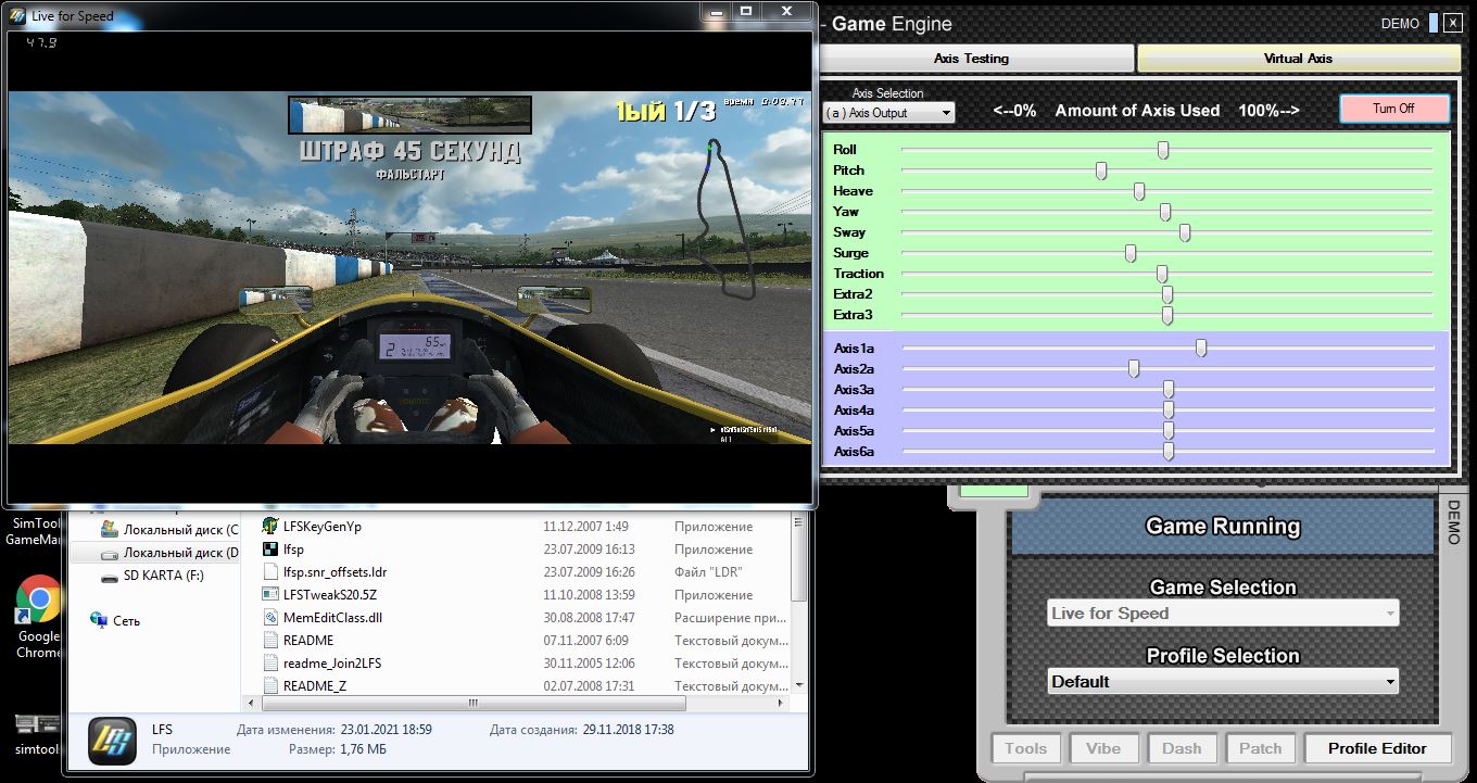

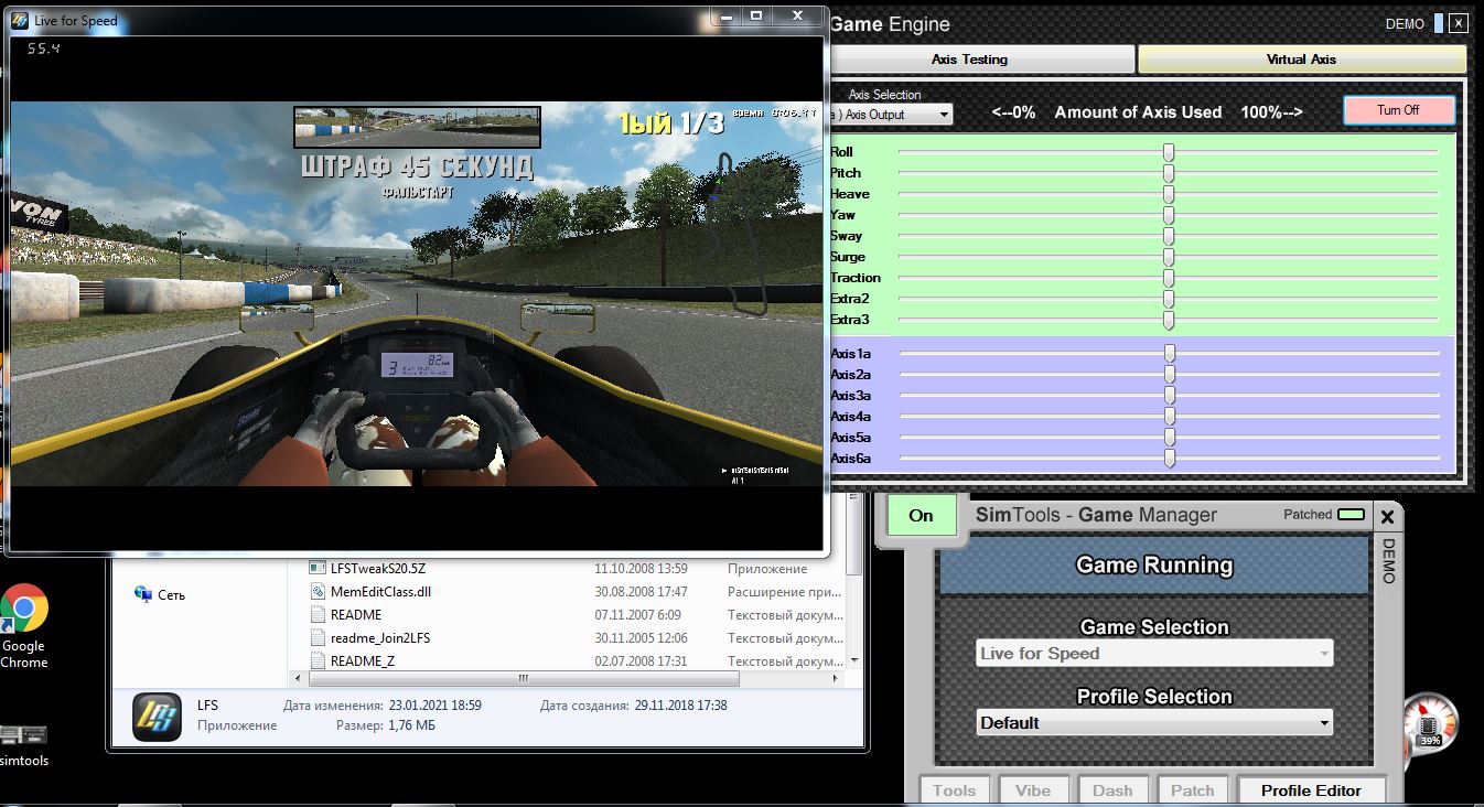

    Thank you for your prompt response. Would you like to know if simtools and simhab will work together? the simulator chair is tied to simtools, and the shakers are tied to simhab (two different ports and two arduino uno).

    Hi @yura999
    I think it will work for memory mapped and memory hooked games, but udp output games will probably send the data to either of the two apps, but not both.
    But its worth a try!
    Take care,
    21,907
    153,053Coins
    +11,117 / 56 / -2
    You can have a port conflict but get around that with the SimHub port forward setting.
    You could just use SimTools GameVibe companion app instead of SimHub.

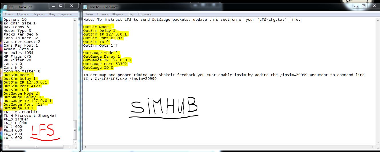

    Hello friends. I decided to try to connect the simtools program and the Slim Hub program at the same time. Unfortunately I didn't succeed because the Slim Hub requires changing the file to transmit telemetry cfg.txt in the LFS game. When the file cfg.txt SimHub was changed, and the telemetry was received in the SimHub program (the blowers worked), but the telemetry is not received in simtools, although simtools connects to the LFS game (lit in blue, you can run tests and settings in the menu). If the LFS game is patched again, SimHub stops connecting to the game, but simtools is now working properly. (I currently have two Arduino Uno R3s connected to two different ports). How can this be solved?

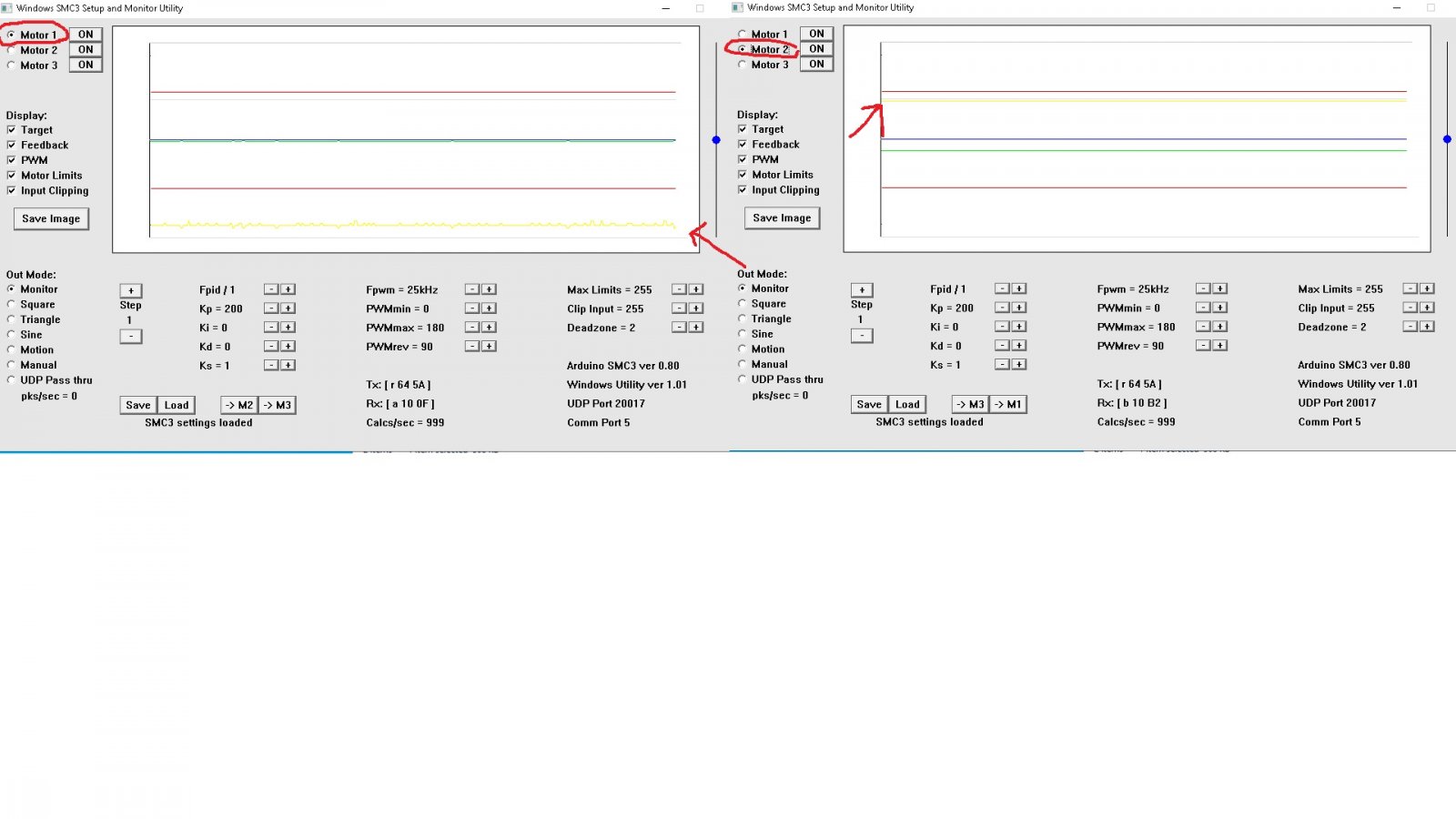

    why.jpg 83902 hey a year after build my 6dof.
    i am using a sabertooth and arduino uno combo powering 2 motors.
    i am looking at the SMC3 utility.
    and i see that on Motor 1, the yellow line is closer to the top red line..
    but on Motor 2, the yellow line is closer to the bottom...but both have the same settings on SMC3..
    I have no idea why this is..
    need your help
    @noorbeast @SilentChill @BlazinH @Pierre Lalancette @wannabeaflyer2

    If I remember correctly, the green line is the position feedback that tries to go to the middle. So since it is below, it gives power to the motor to bring it back to the center. The other one is there, so, no need to send power to the motor.
    Correct me if I am wrong people.

    when i did was closing up the build of the power and driver parts and putting it online back then.. i noticed i had to reverse the wires between the ampflow motor #2 into the sabertooth motor 2 terminals, in order to make the the green line move as desired... i wired the pots for motor one and two the same..maybe i have to reverse them? or maybe i have something else wired wrong? followed sixdegreesofflight and @wannabeaflyer2 's build...

    Do you have problems with your rig? If they were connected upside down, you would know it.

    everything is working now.. i associated wrong comm port with SMC3 utility....
