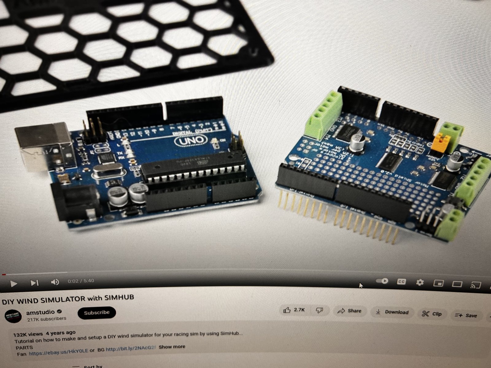

    You can check the wind section of the SimHub site: https://www.simhubdash.com/
    But there are also easy to follow build videos, such as this one:

    done, followed instructions in simhub wiki, helped by the discussion about the simwind kit here .....
    helped by wonderful @Keith
    i have uploaded a sketch in arduino.
    working perfectly... wind till real 80kmh on my face and ocuculs.
    thx a lot to everyone.

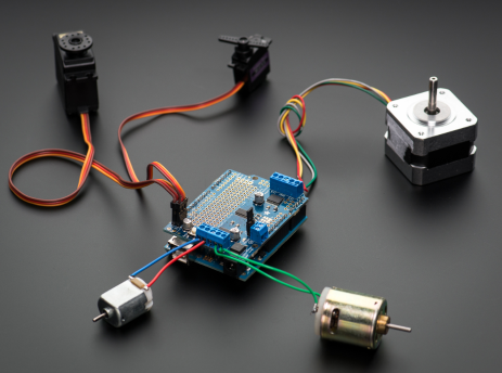

    Based on your advice I made a sketch for the Adafruit Motor Shield V2 (AMSv2) using all the hard work of sallerding, Zed, SilentChill, Avenga76, and others. It's an option for people who do not have a Monster Moto or who may have started with a wind sim built for SimHub using the AMSV2 and wish to use their existing hardware with SimTools. The procedures and settings in GameDash remain the same, you just need to load this sketch and it should work with AMSV2. I tested the sketch using the EZDIY 120mm 200CFM 1.3A fans that are recommended in the DIY video tutorials for SimHub like this one:
    You should change the Idlespeed setting in the sketch to what you prefer for your rig after you get it running. I left a small Idlespeed value in the sketch so that the fans come on when you load it. That may help with determining if your fans and hardware are wired/working properly without having to load a game. If anyone has any questions I will try to help. The attached file is .txt extension you can change the extension to .ino or copy and paste it into IDE and save. Here is the sketch text in case the file does not work for you:
    // Arduino code to achieve wind simulation with the Adafruit Motor Shield V2 instead of the Monster Moto
    // Based on the work of sallerding, Zed, SilentChill, Avenga76, and others with inspiration from noorbeast
    // Supports right,left and traditional serial speed output from GameDash (R000, L000, S000)
    // Adafruit Motor Shield V2 library is required to be added to Arduino IDE interface prior to uploading sketch
    // Please wire your two fans to motor ports M1 and M3 on the adafruit Motor Shield V2 (Not M1 and M2)
    // This will utilize both mosfets on the board and reduce the potential for overheating with 1.3 Amp fans
    // Version Date 01_28_2023

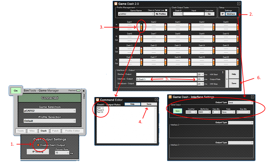

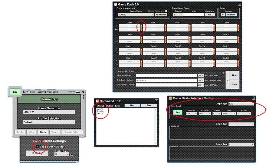

    Stanley, I am using SimTools V2, but from what I can tell the process is about the same but easier. Enable GameDash output (it comes standard in V3), configure an arduino interface with the standard settings pointed to your com port, and edit the config file with the data seen in the image below. Maybe you can provide a post on the specifics of V3 when you get it running. I tested mine in LFS first as its the easiest to test in. Good luck!

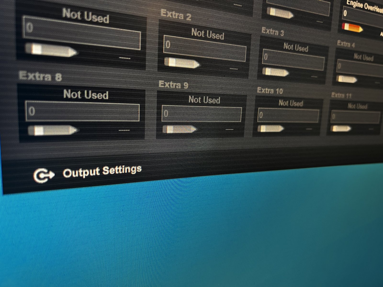

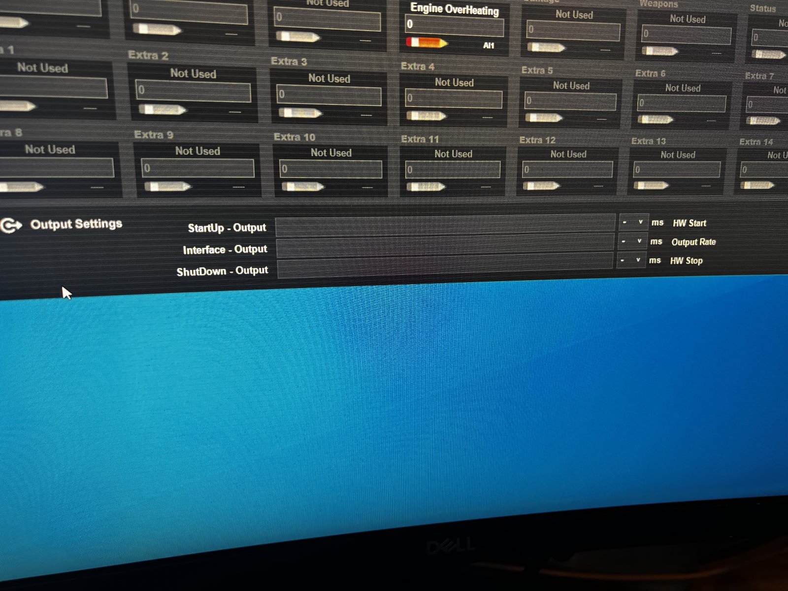

  17. Chipless
    Chipless Member
    Nov 28, 2019
    84
    152Coins
    +26 / 0 / -0

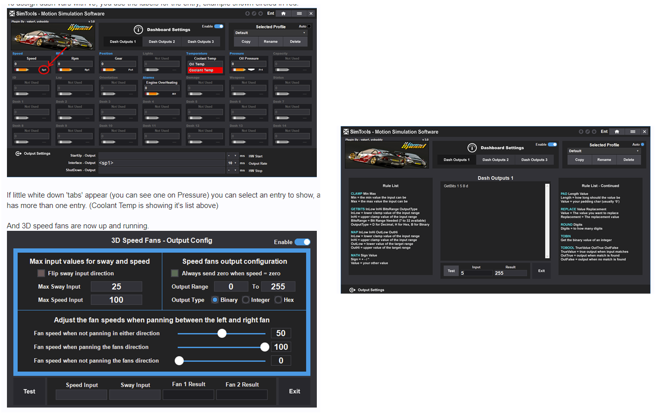

    Great summary! Thanks for posting. Unfortunately, I cannot locate the place in SimTools V3 where I would enter the "S<Dash1>" line in Interface - Output. Also in SimTools V3, I cannot find where I actually enter the Output Rules like I would in the Command Editor. Can anyone assist?

  19. stanley johnson
    stanley johnson Active Member
    Sep 14, 2022
    117
    Diesel tech
    Nashville
    82Coins
    +40 / 0 / -0

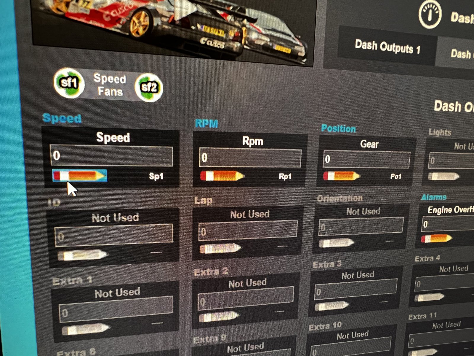

    @Chipless If you click on the pencil I guess under speed it will take you to the next screen where you can type in math*1 Round0 and pad30. but still have not got the fans to work
  20. Richard Ortengren
    Richard Ortengren Florida Racing Fan Gold Contributor
    May 14, 2022
    49
    Builder
    Florida
    283Coins
    +17 / 0 / -0
    I'm not on V3, but just looking at the overview it seems pretty easy. Do you have the licensed version? You should see Dashboard Settings. Here as a screen grab showing where you would input the data for wind simulation, under speed click the little pencil and input the same 3 lines in Dash Outputs 1.
