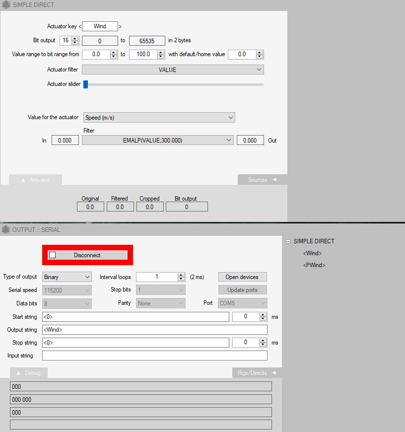

    I'm having some trouble adding a wind sim via FLYPT. I have managed to get it going via SIMHUB so I know its not hardware related. SIMHUB doesn't do flying sims however so I am adding via FLYPT. I've added the simple direct and Serial Output per instructions and uploaded the Arduino code to the Arduino Uno. I'm just trying to test using the actuator slider for now. Whilst the serial port is connected, there is no movement of the fan actuator.
    Probably my lack of arduino ability. I am using an adafruit shield v2 with the arduino but have ensured the serial speed in the code is the same as in the serial output. Most people seem to use Monster Moto boards. Not sure if that makes any difference to the sketch code. I've used the same as FLYPT's above so I haven't copied it here.(*other than adding the adafruit motor shield library at the top of the code)
    Given its a shield, I'm not sure if I need to assign specific pin outputs that are different from the standard ones in FLYPT's sketch code. Any help pointing in the right direction would be great.

    @sallerding did you use the sketch from post #6, that one works?

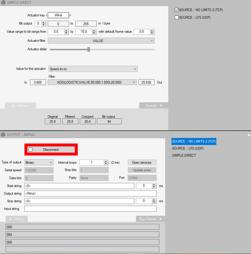

    OK I thought I would write up my experience of trying to get the wind sim to work with FLYPT using an adafruit v2 shield. I just couldn't get it to work with the code provided above no matter what settings I changed.
    Thx to ChatGPT I was able to have it create a new sketch for me which I'll attach below specifically for adafruit shield if it helps others who also use that shield. I didn't think it worthy of a separate topic so have just added it here under wind sim.
    To make it work properly I also had to add some filters using the add and logistic function per below image, which was similar to the solution from FLYPT for another user in the community to solve what was essentially a hardware problem to do with the cheap fans. I have no coding ability, and I was amazed that I could create the code so easily with ChatGPT. But it also means its probably not perfect for those experienced with arduino code. But it worked for me :). Hope this helps others

    Here is the code that worked for me for the adafruit shield v2

    I took the code that flypt added above and asked if it could convert this code to be used with an adafruit version 2 shield.
    I then had to refine it because the first version was just fan on and fan off. So I asked for it to modify the code to base motor speed with serial input. With a couple of minor tweeks and questions it produced what I uploaded. I also asked for it to prepare a version for two motors. I was happily stunned by what it produced.
    Also and separately in the code I left threshold to zero, because the need for that depends on peoples hardware. I now have mine set to 50 and so it is working perfectly. I am just playing with filter settings now. The 50 isn't a percentage, it is a bit value, so roughly 20%.
    I also don't have the toggle switch issues that other members seem to have, the fan only turns on when serial data from the sim is running through it

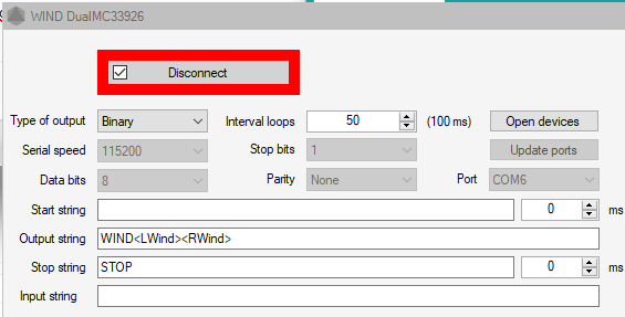

    I'm building a version of this using Pololu's arduino clone and their motor shield. So far its working, except for disconnecting from Mover. ONCE after clicking disconnect, it made it to "Stopping". But now it remains at "Disconnecting 0%" with a yellow border and completely hangs Mover until i unplug the usb. After that, Mover cannot reconnect to it after plugging back in, i have to quit the program. I am using the code from Example 2 on https://www.flyptmover.com/outputs/the-binary-output-string (changed to use the pololu DualMC33926 library)
    Is there some command i could listen for to disconnect it gracefully? would this go in the serial output Stop box?

    I got it working! Interval loop too low and something with the byte stream was goofy.
    Working sketch: https://pastebin.com/N1aZehrN
    This is for a Pololu A-Star 32U4 with their 3A DualMC33926 controller. Using 24V 3A SEAFLO 4" fans.
    I use a SPDT switch to go from manual mode to serial reader mode. Center is off.
    A potentiometer controls speed directly in manual mode, and sets the top speed for serial mode.
    in FlyPT, set as follows:
