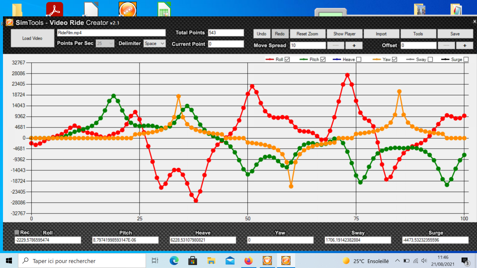

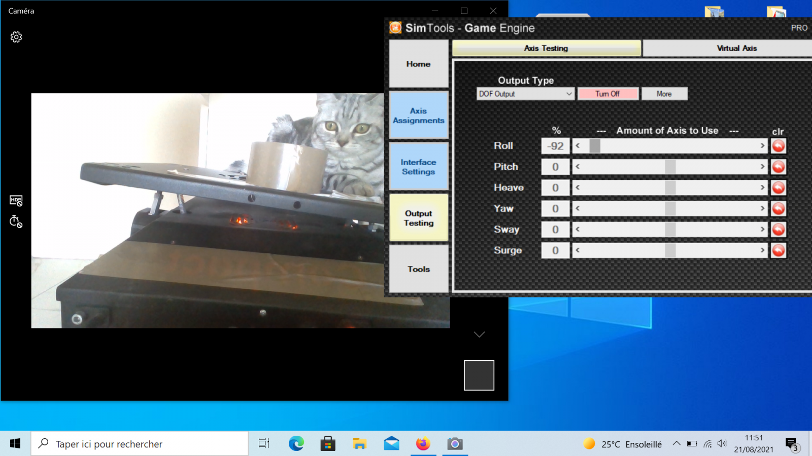

    as you can see the cat doesn't like the platform is moving !! so OUtput testing is working perfectly Capture d’écran (5).png
    this a an example of telemetry data that is flowing in the roll pitch.......labels

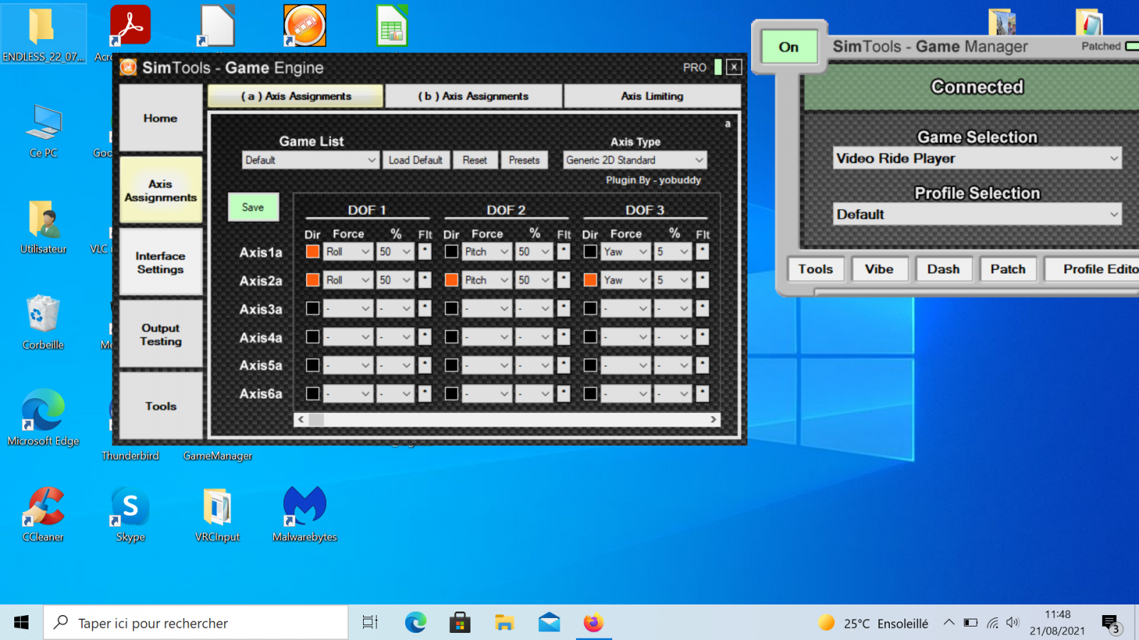

    these are the Axis assignments for Default and VideoRidePlayer
    thanks

    Even cats like simulators :thumbs

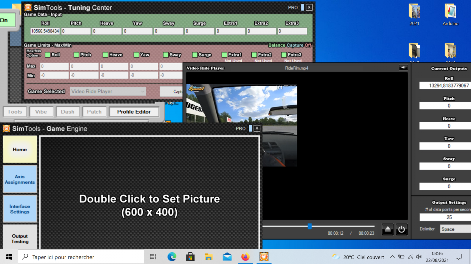

    May I have a pic of the VideoRidePlayer running the video.
    (With the game engine's 'tuning center' window open please.)
    here we are
    thanks
    Got it....................
    1 play your video in VideoRidePlayer after opening Tuning Center in Game Engine,
    2 capture Max and Min of your Telemetry data in Tuning center
    3 save those Max and Min in Tuning Center.
    You are now able to read the video and move the simulator simultaneously.
    the cat is very happy now :grin

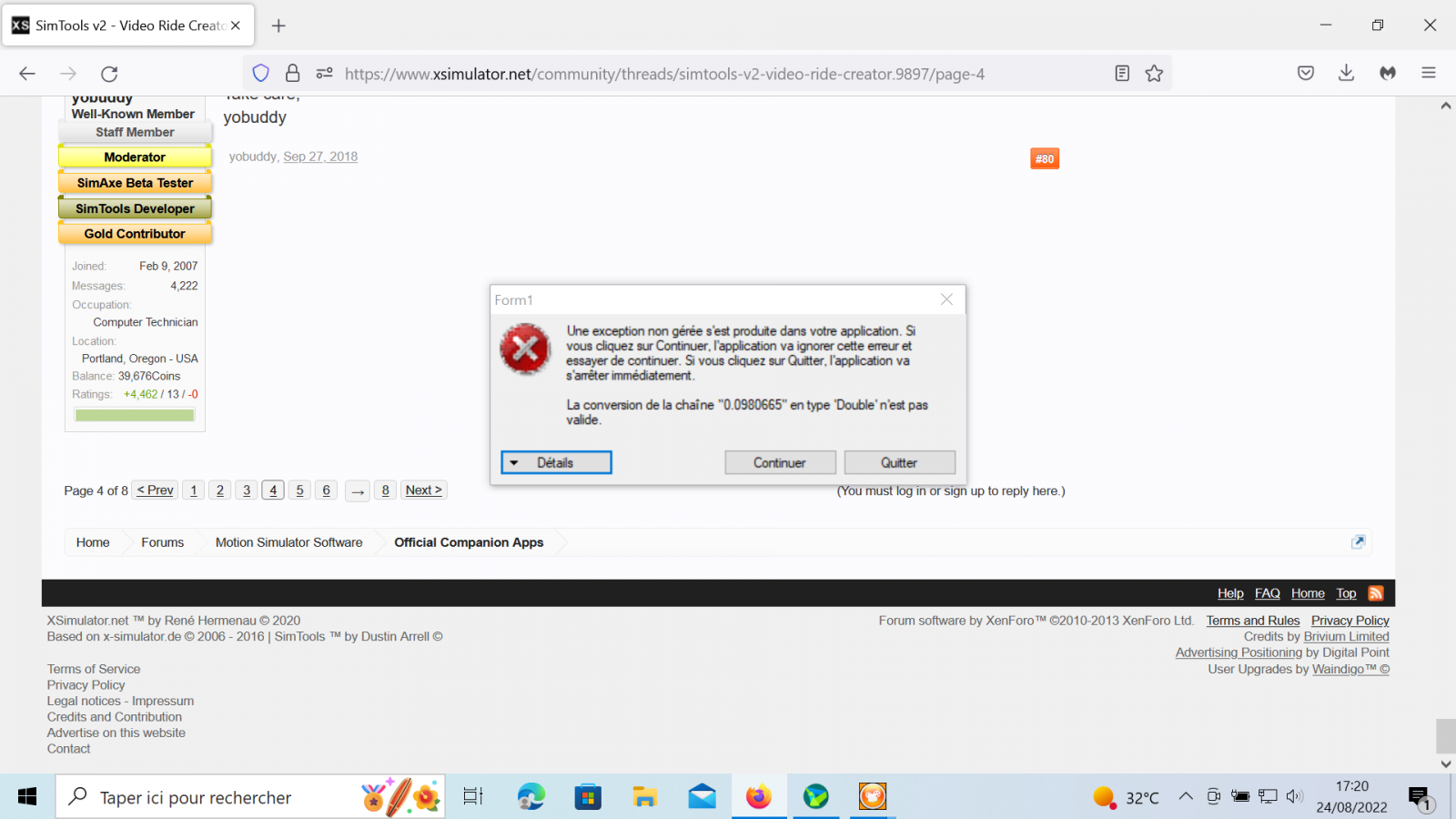

    Hi guys I have found an app that can record a video plus its related accelerometer and gyro data from my smart phone .
    I tried to create a video in Video ride creator to play it on Simmtools and move my platform.
    Unfortunatly i got a message that is not very clear to me. Capture d’écran (34).png
    any advice?
  5. accelero
    accelero Member
    Jun 30, 2015
    64
    france
    293Coins
    +12 / 0 / -0
    2DOF, AC motor, Arduino
    Its in french but means
    Conversion from string "0.0900098" ( which is one of the data ) to double is not valid ......... bla bla bla bla

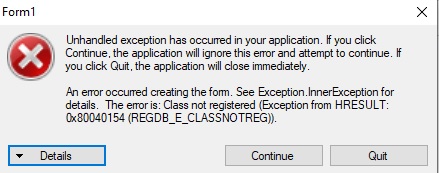

    hello, i need help i have an error message when starting video ride creator. my pc is up to date, framework, visual studio,...
    22,208
    154,711Coins
    +11,212 / 57 / -2
    Can yo please expand the Details button of that error message, then copy and past the full error here.

    the message says.
    Unhandled exception has occurred in your application. If you click Continue. the application will ignore this error and attempt to continue. If you click quit, the application will close immediately.
    An error occurred creating the from. See Exception . InnerException for details. The error is : Class not registered (Exception from HRESULT: 0x80040154 (REGDB_E_CLASSNOTREG)).

  14. yobuddy
    51,748Coins
    +5,205 / 19 / -0
    Permission problem maybe?
    Try running the app as admin.

    I put everything in U.S English, the time synchronize U.S
    . and the exe in admin. I still have the error.
  16. yobuddy
    51,748Coins
    +5,205 / 19 / -0
    Unfortunately the error code '0x80040154' is a pretty general problem code, and there is not a lot to go on here.
    It may be worth white listing VRC just to be sure its not antivirus interfering.
    What antivirus are you running buddy?
