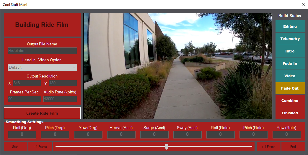

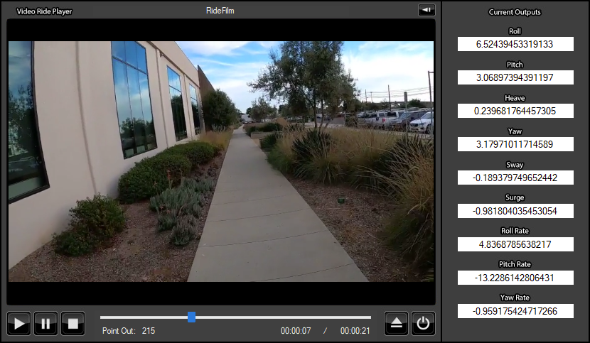

    Wouldn't it be awesome if we could make ride films, directly from captured GoPro videos for our simulators?
    Me too! And after a week of decoding the gpmf telemetry file, used in gopro's and looks like some other cameras too, I was able to make sense of the data I needed.
    It should work for any gopro version 8 and above. I still have a lot of testing to do, but I'm 99% sure I will have this in the v3 Video Ride package when I get there.
    Test app shown here... (We can adjust the smoothing value of each output once we know what works well)
    And then..
    Anyway, back to v3 this weekend! :thumbs

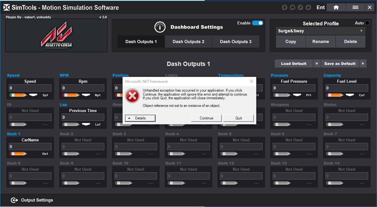

    @yobuddy
    got this when trying to save a dash profile as global bud
  13. yobuddy
    51,372Coins
    +5,202 / 19 / -0
    If you get the error again, please click details and the first few lines will tell me whats going on.
    Thanks so much for testing!!

    Yeah sorry, I forgot to do that before closing it down. I restarted simtools and then had no issues when I tried it again

    Update Posted! :thumbs
    Fixed - Manual setting a games launch-link. (thx early_m)
    Fixed - Dash outputs now correctly decodes wanted ascii chars <221><0> (and now works up to 32 bit too).
    Fixed - Dash now pauses output when the game is not active.
    Fixed - Dash global save error.
    Added - "Content Manager" as a ProcessName to the ac plugin.
    (To use Content Manager, Drag-Drop Content Manager's exe over the ac plugin banner in v3 to set the shortcut for AC to content manager.)
