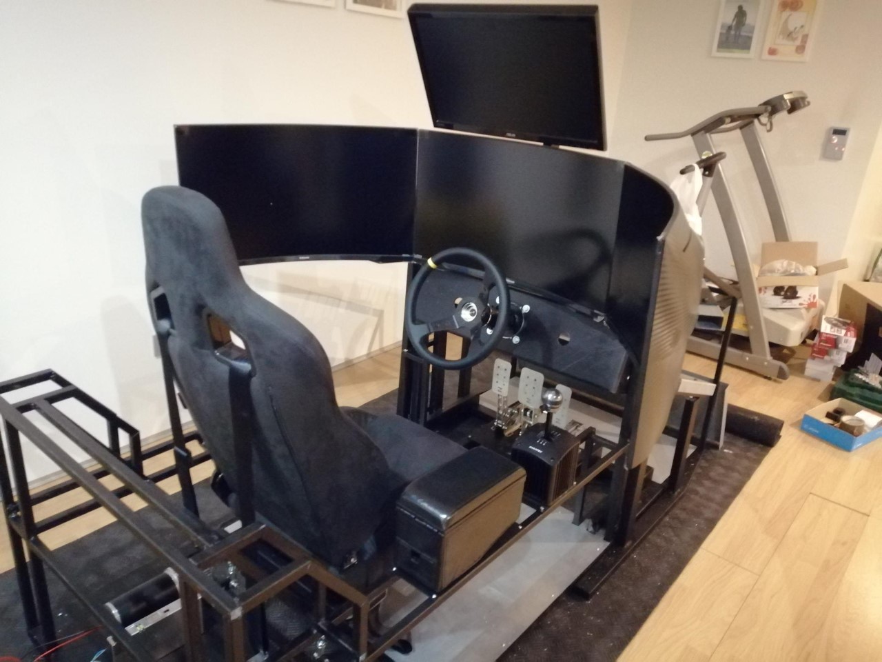

    Hi everyone.
    I am coming from this thread:
    https://www.xsimulator.net/community/threads/newbie-starting-my-rig.15004/
    Now that I have the basic knowledge and all the required hardware, I am ready to start the building phase.
    If all goes well...it should be up and running in 1 or 2 months (saturday is the only day I can work on this).
    I will be posting pictures of the building process.
    Please note that it is my very first build. No experience in sim racing or this kind of builds.
    So... I think I may need some help from you to configure/tune the motors.
    My first question is:
    - I have a Fanatec SQ Shifter. I was thinking in mounting it over 4 vibration isolators and attach a bass shaker directly to the shifter. My only concern is that if so much shaking will eventually tear the shaker apart :)
    What do you think?
    Regards,
    Mike

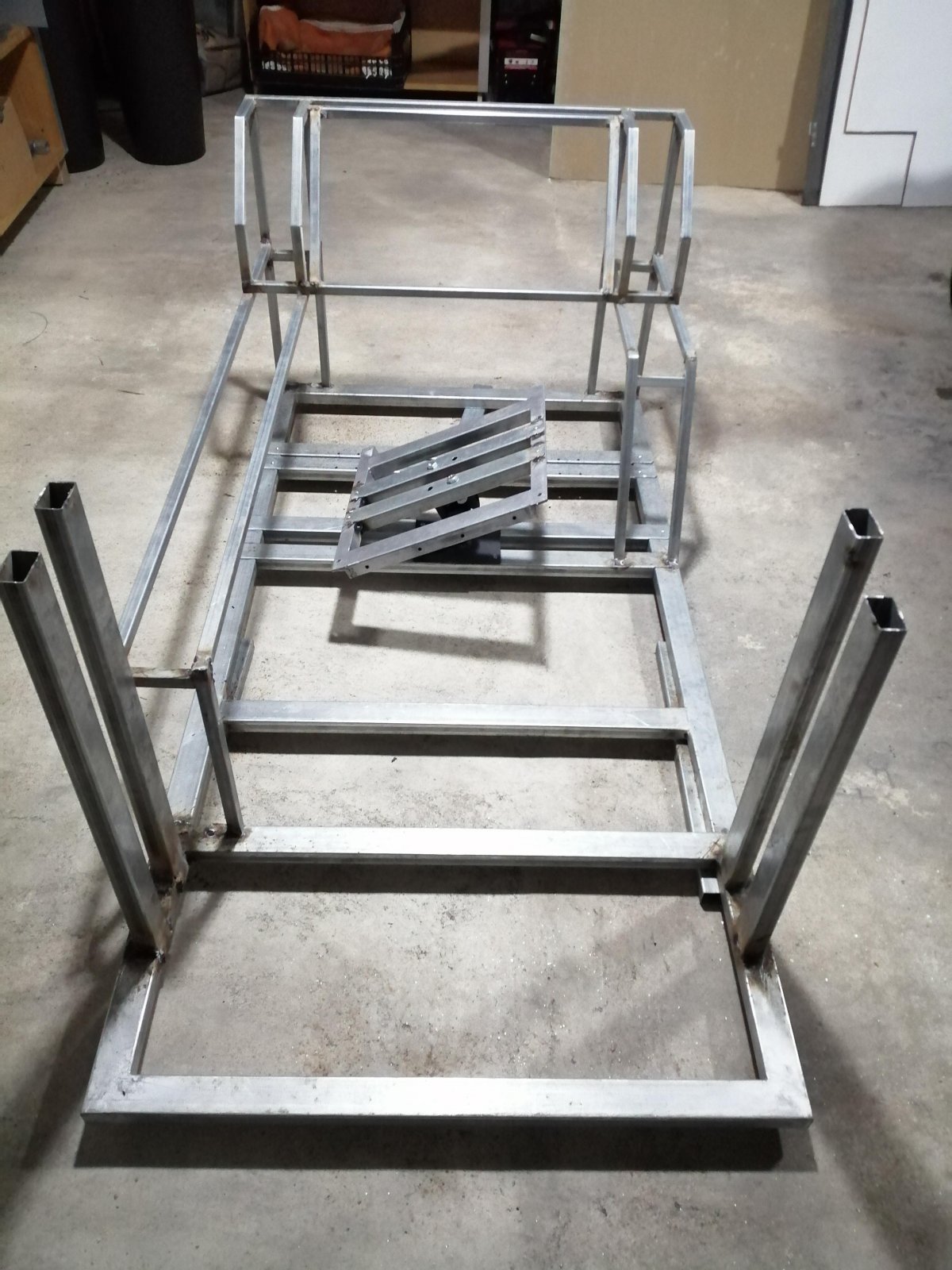

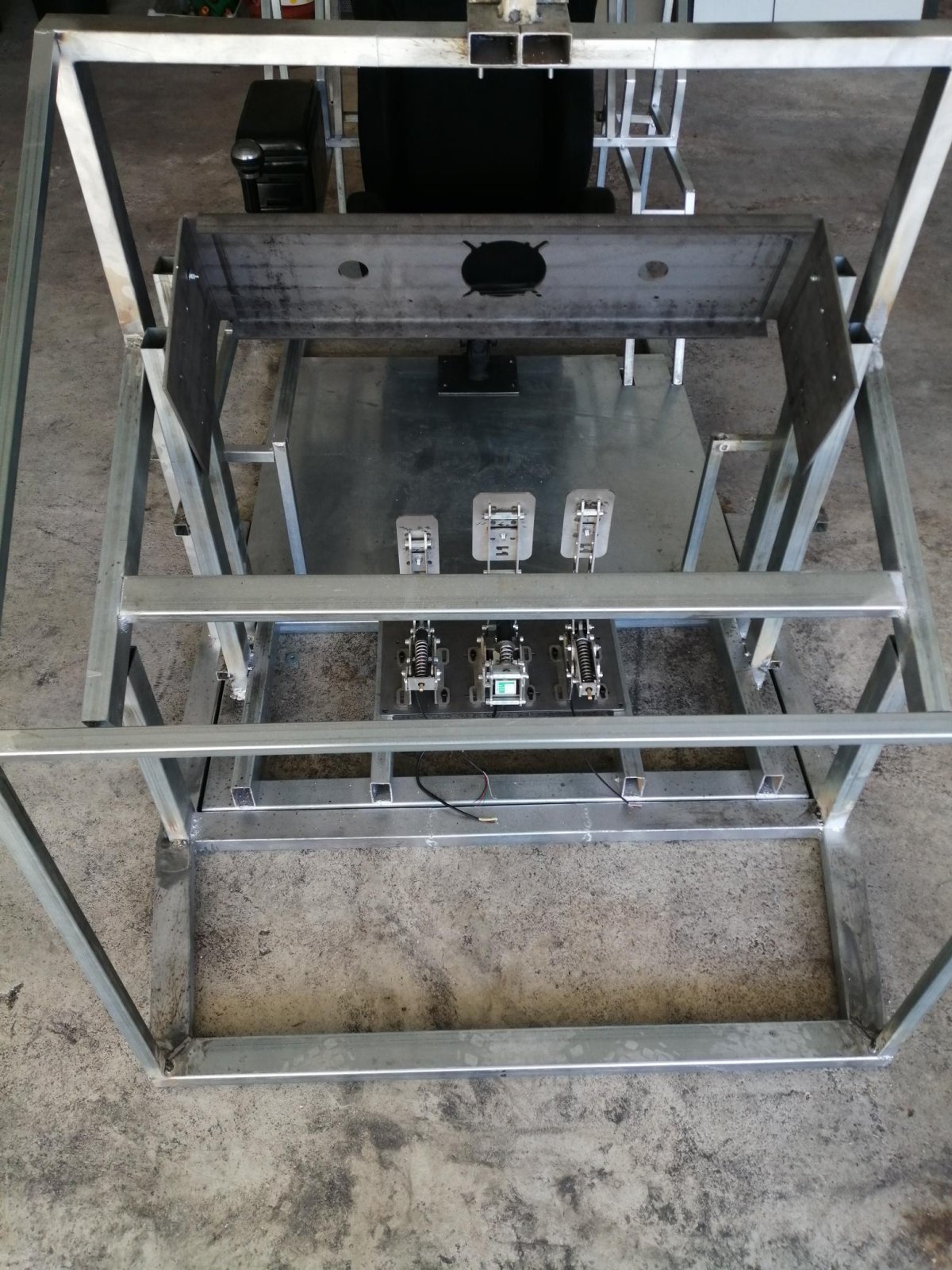

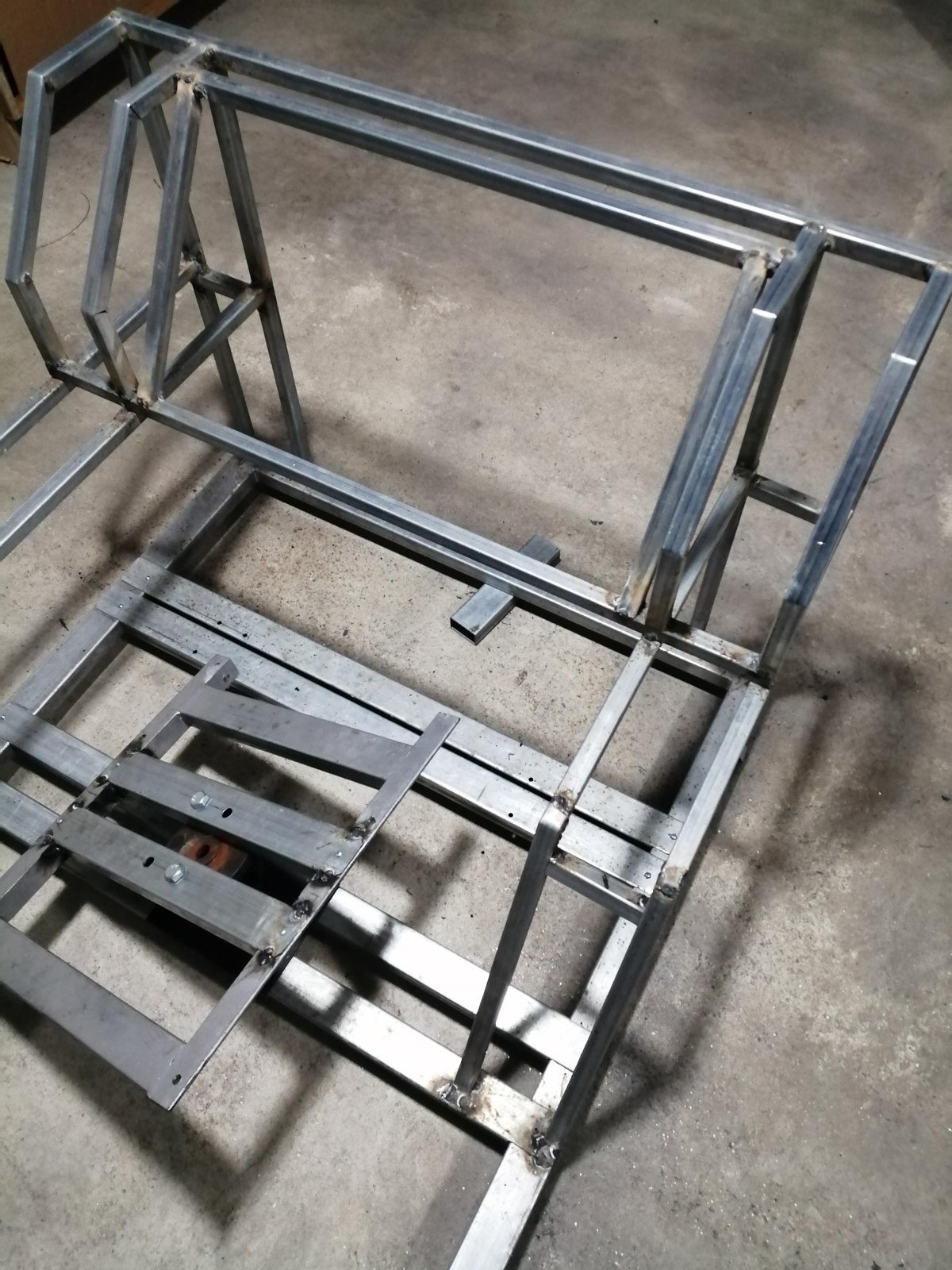

    First stage of welding. Some parts just for measuring.
    Next saturday: pedal area and monitor mounts.
  3. Mike Melga
    Mike Melga Member
    Jun 22, 2020
    87
    IT
    Portugal
    662Coins
    +25 / 1 / -0

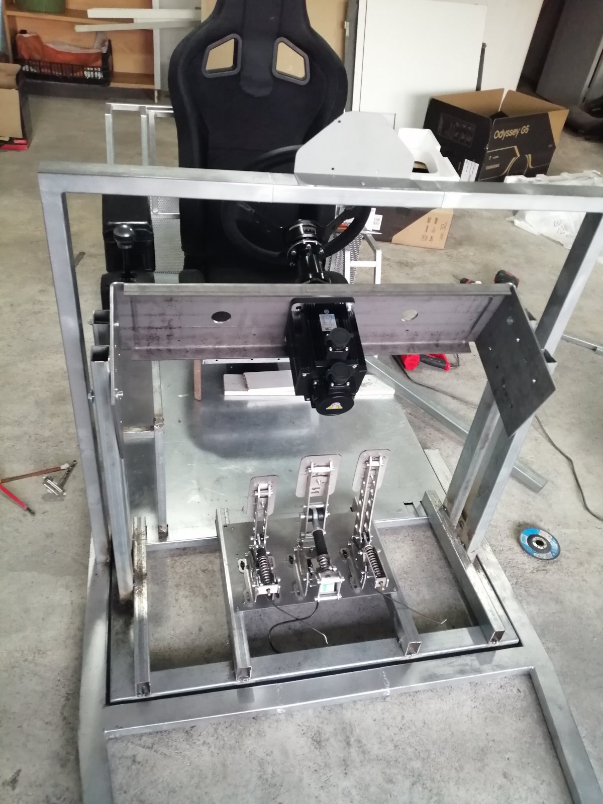

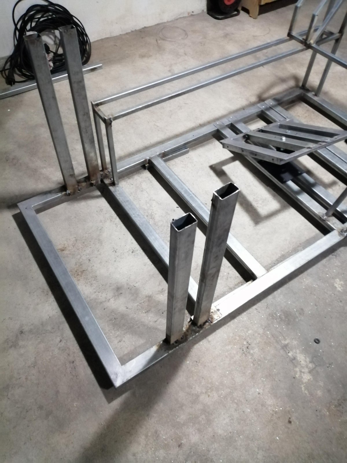

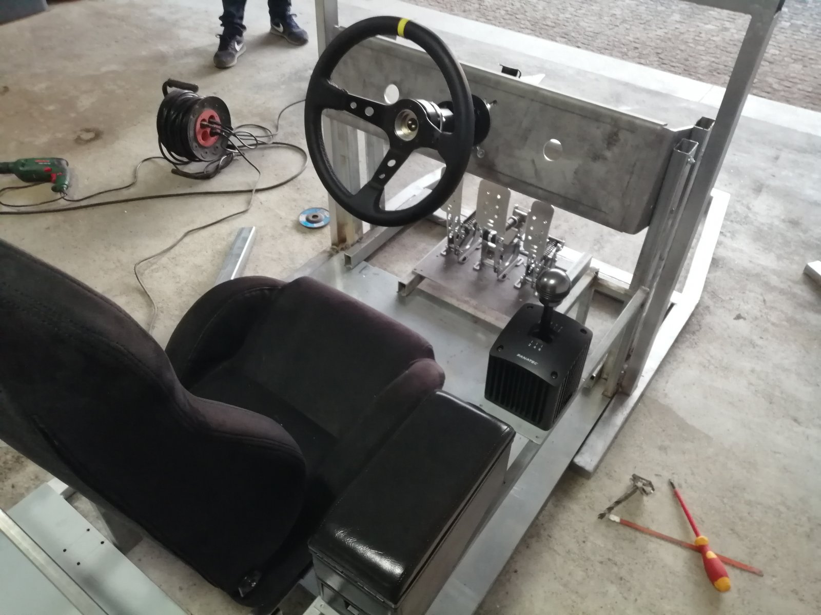

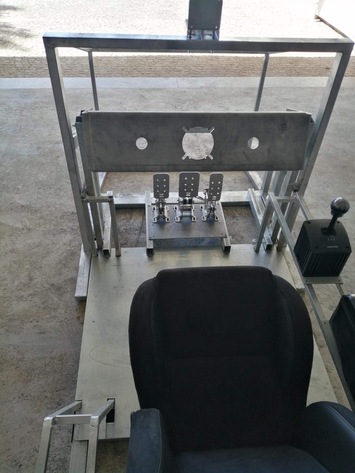

    Another saturday of welding.
  4. Mike Melga
    Mike Melga Member
    Jun 22, 2020
    87
    IT
    Portugal
    662Coins
    +25 / 1 / -0

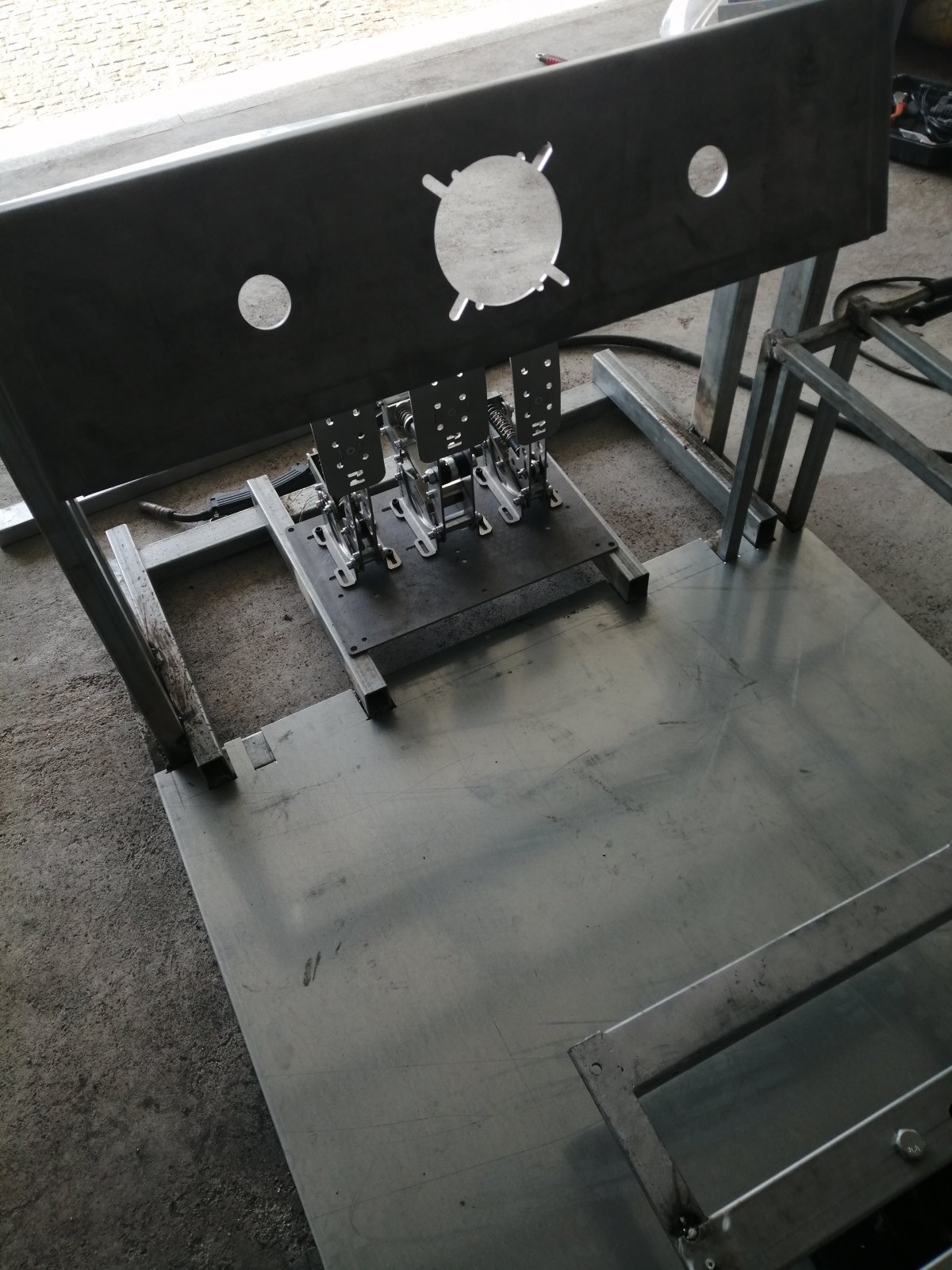

    Welding stage complete.
    Next step: painting

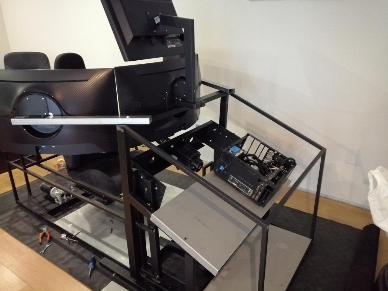

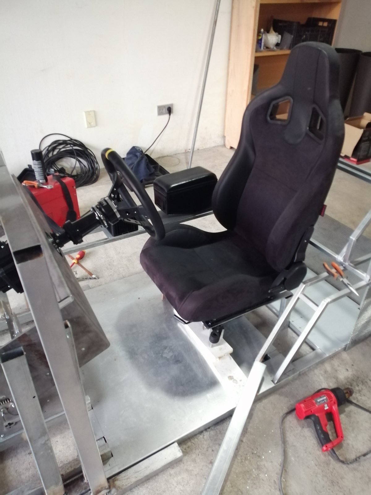

    Structure painting done. Only small additional steel sheets need paiting.
    Started the final assembly inside the house.
    Next phase is electronics and cabling. Then sound and cable management.
    Final phase is paneling.
    I guess I'll need an addicional 2-3 weeks to get everything going.
    I am counting on your help for the motor configuration :)

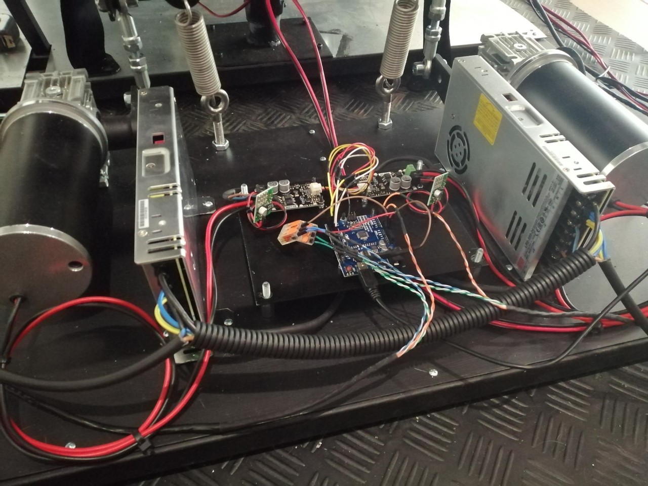

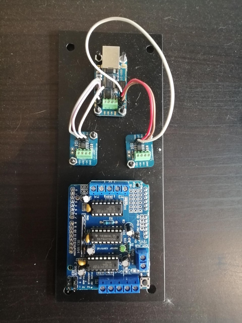

    So....I made all connections, uploaded SMC3 to the arduino and followed this:
    1. Run the Windows SMC3 Utility software and make sure it communicates with the Arduino (There is no need to set baud rates, they are not configurable)
    2. Set the Kp, Ki, Kd, PWMmin, PWMmax, PWMrev to 0 for ALL motors (This will make sure the motors don’t move)
    3. Set Clip to 255 (you need to do this first) and Limit to 255 (This will give you plenty of margin if something goes wrong while setting up)
    4. Turn on the power to your motors – nothing should move at this stage!
    5. Set Kp to about 400
    6. Now slowly, increase PWMmax… at some point the motor should start to move. When it does check the “Green” feedback line is moving toward the “Blue” target position.
    I've set all of those. Worked my way up to 255 on PWMmax but nothing moves. Also can't get to put motor 1 and 2 into ON position. What am I doing wrong?

    BTW....motors move if I press the +/- button on the Cytron MD13S.

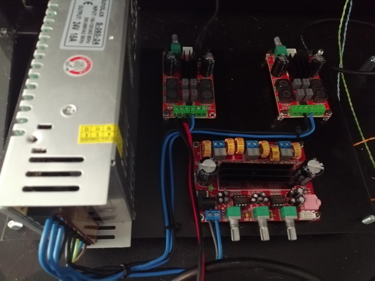

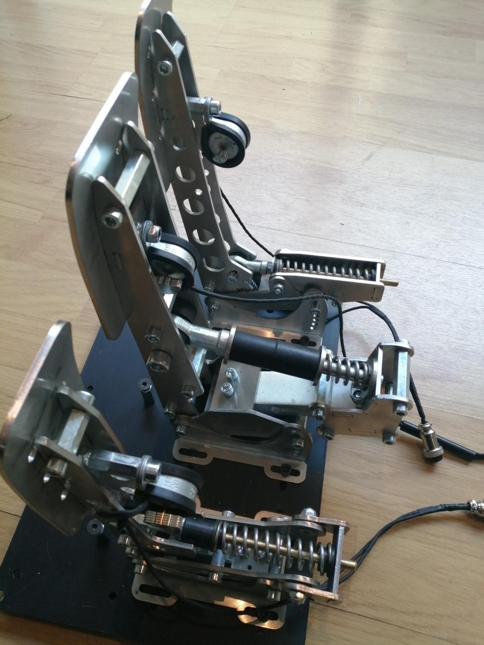

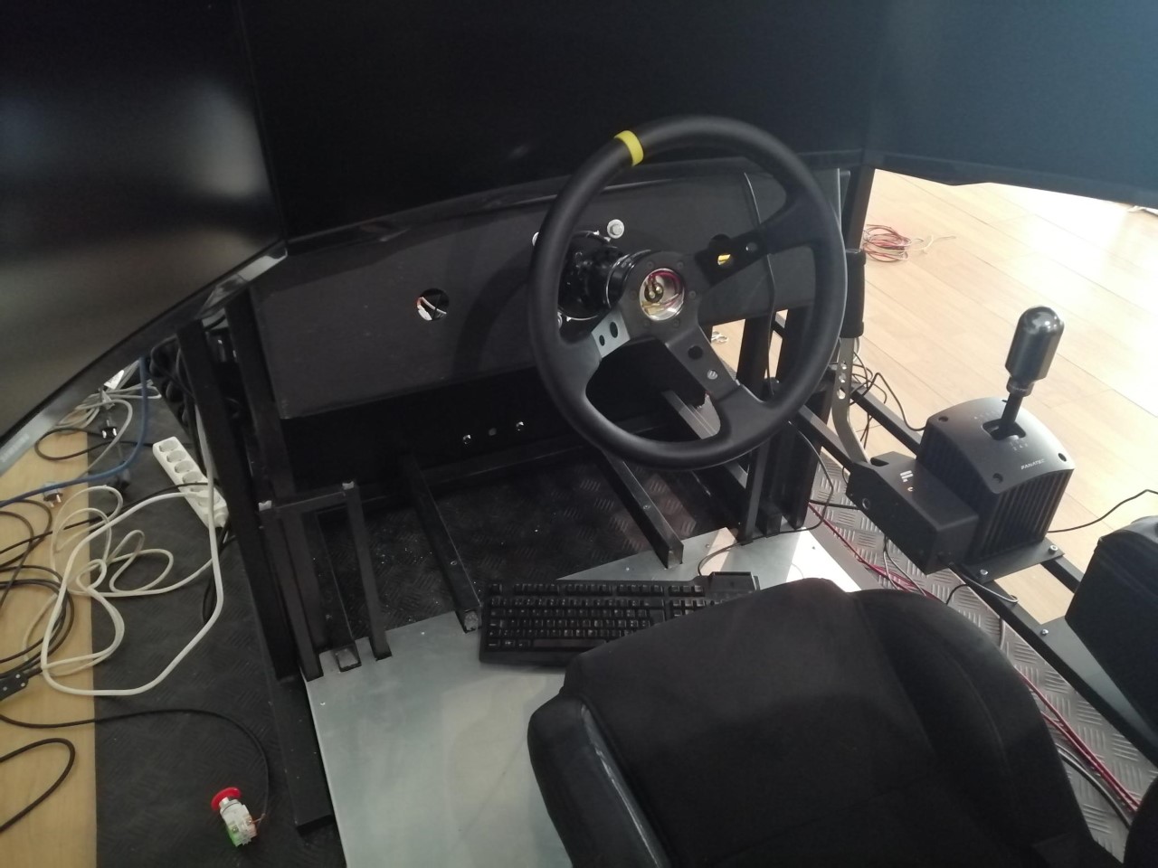

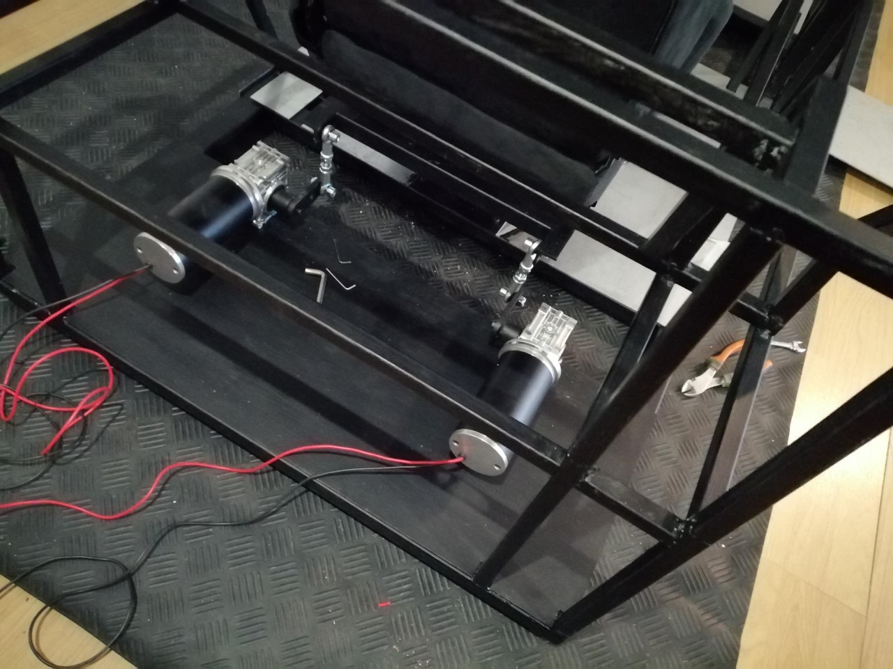

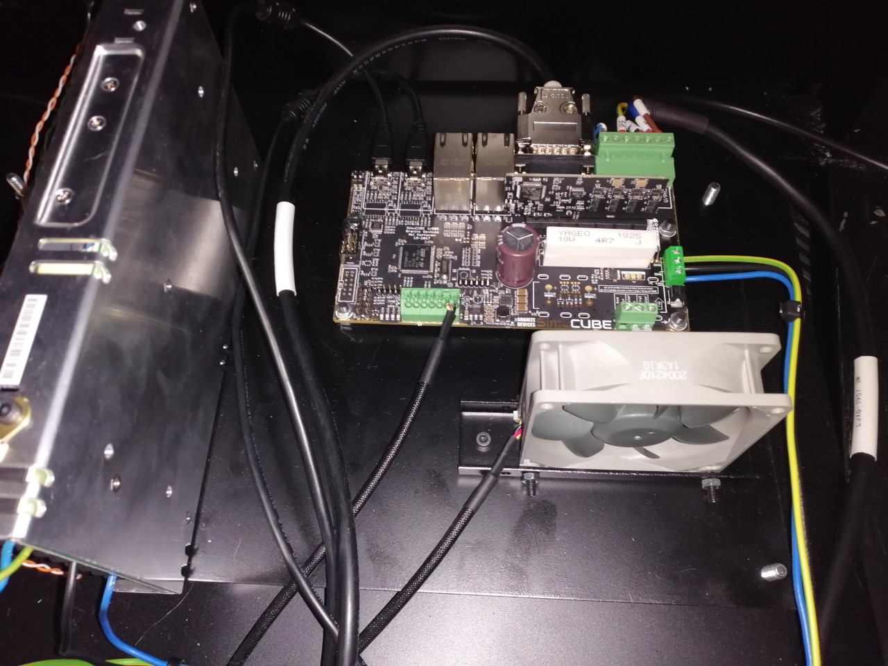

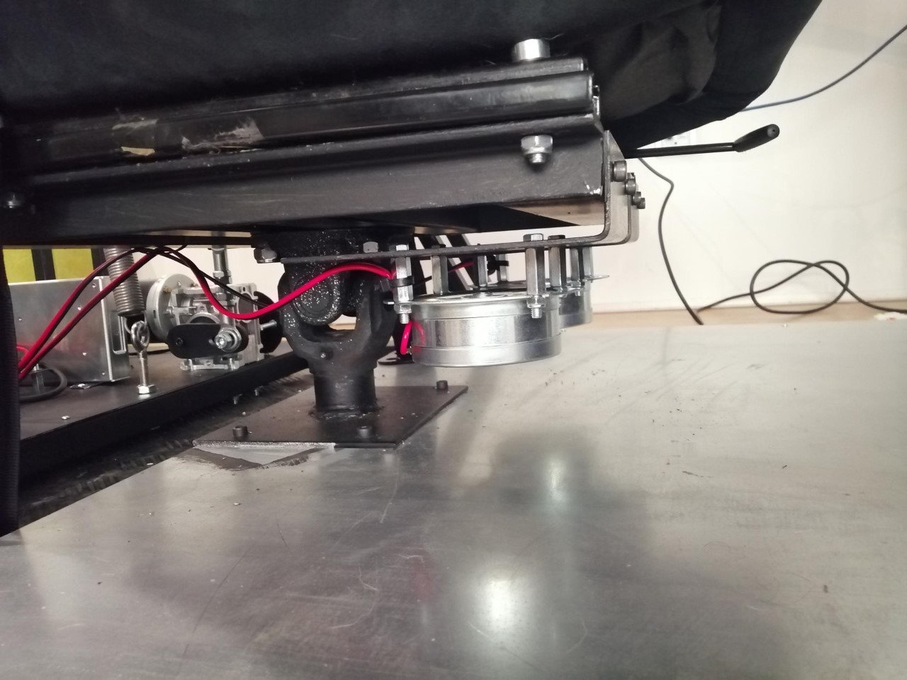

    This weekend I made my final mountings: bass shakers, simucube board, pedal set boards, pedals, audio amplifiers and motor control.
    All tests were successful except for the motor movement :(
  18. Mike Melga
    Mike Melga Member
    Jun 22, 2020
    87
    IT
    Portugal
    662Coins
    +25 / 1 / -0
    Ok...so I decided to take this afternoon off to check on the motors.
    I already figured out why SMC3 didn't allow them to turn on: the pots feedback signal was way off so it thought the motor was out of position.
    So...I manually put the green line of both motors inside the 'max limits' area and SMC already allows to turn them ON.
    What now? Having the motors in the default (center) position should I align the green line in the center?
    What exactly sets the boundaries in the motor travel? Is it SMC or Simtools? Are these 'max limits' that I set in SMC saved to the arduino? Don't think they are...
