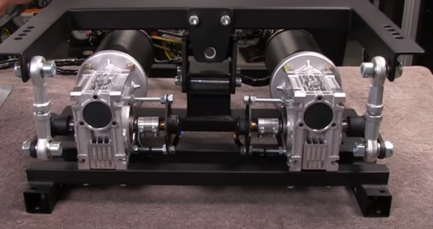

    I would prefer that the seat were flat when unpowered. What should I look for in a motor for that to happen?
    I also can't buy those motion dynamics motor. The shipping is very high and I would have to pay taxes on top of the whole value. So... I need to shop here in Europe. Any advices?
    I saw a comercial motion platform that had the motor UNDER the seat (see image). To acomplish that I suppose you have to use much stronger motors, right? I really liked not having those shoulder bars behind the seat.
    21,581
    151,100Coins
    The layout you want is a compact design, which require plenty of torque, do a search of existing member projects, here is mine and I use 200w motors with 60:1s and they cant be back driven when not powered: https://www.xsimulator.net/community/threads/dx-compact-simulator.5866/
    Now you have an idea of motor specs for a chosen design you can start to search locally, it is likely wheelchair motors would suit, which also gives a second hand option.

    I guess I do want a compact design but my fear is getting motors that are not powerful enough to drive my 90kg+seat. Would yours be enough?
    I emailed motiondynamics for a shipping quote. Let's see if it is reasonable or not.
    What specs should I look in a motor? Torque 20nm or more? Wattage? Rpm?
    21,581
    151,100Coins
    I am using the 200W motors with 60:1 gearboxes on my compact rig.
    Wheelchair motors would be another option, even second hand ones.
