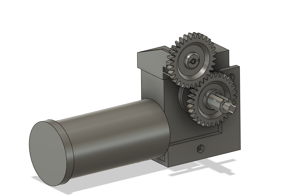

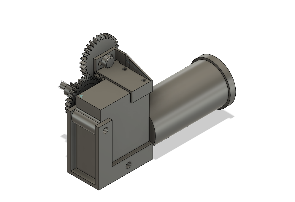

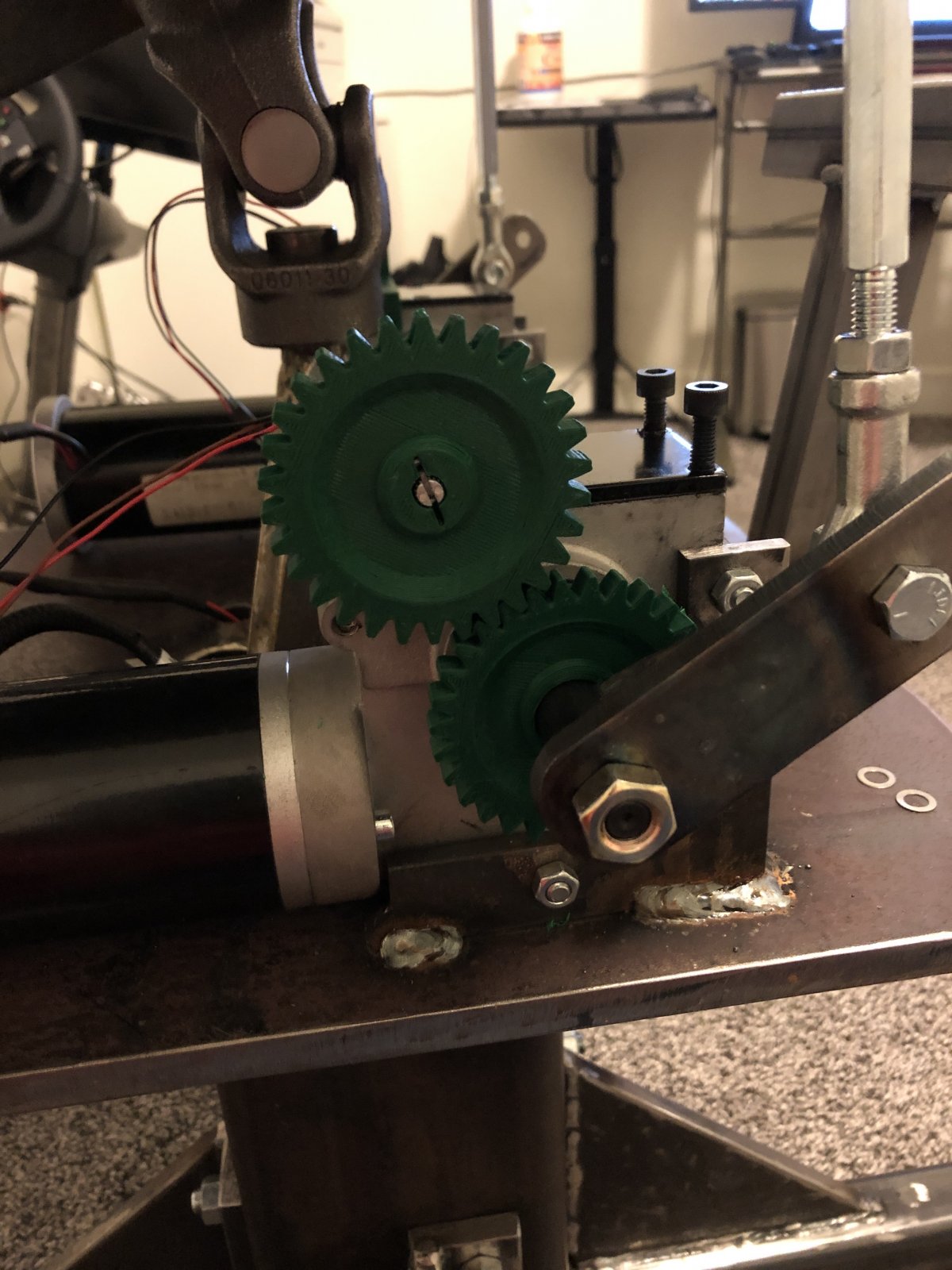

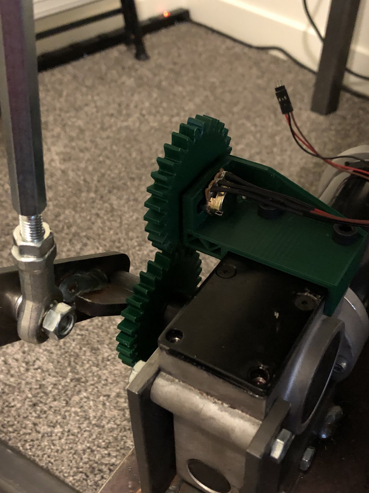

    I was trying to figure out a way to connect my potentiometers, since I don't have any more thread left at the ends of my motor shafts. I looked at possibilities of using couplers or tubing with cable clamps, but none of those options seemed good for my setup. I modeled some proportional gears and a mounting bracket to fit to my motor with pre-tapped holes in order to track shaft position using the potentiometers. Pictures below

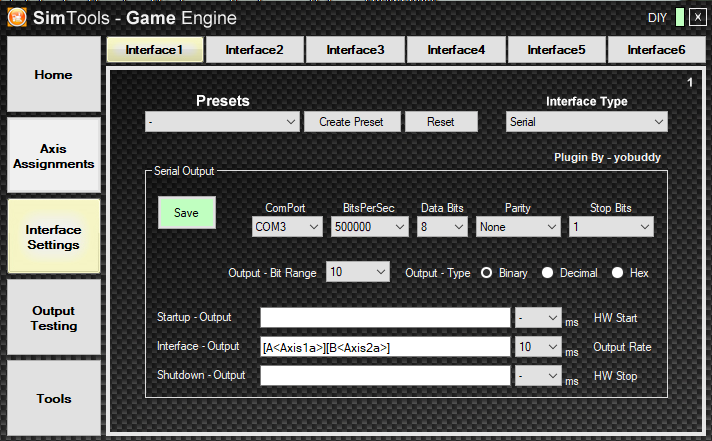

    I was able to get both of my motors to work with the SMC3Utils software (https://www.xsimulator.net/communit...ket-serial-pid-motor-driver-w-softstart.9277/) but when I try to test the motors from the SimTools Game Engine, I can't get them to work. I need to work on it some more. I've tried messing with different com ports but changing the port for the Arduino hasn't worked yet. It's probably something simple but I'm not sure what to try next. If anyone else knows how to fix this let me know!

    I made sure that the com port is correct and the settings are the same as in the tutorial but I can't get it to do anything in sim tools. The SMC utility works fine.
    I also tried removing the "a" at the end of each axis with no luck. What other settings should I post?
    22,183
    154,720Coins
    +11,193 / 57 / -2

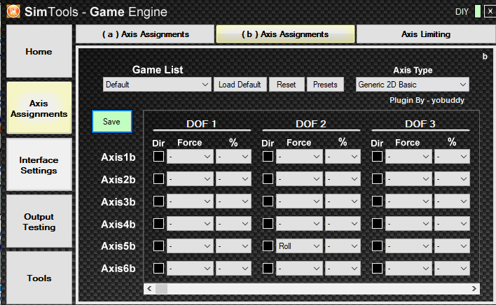

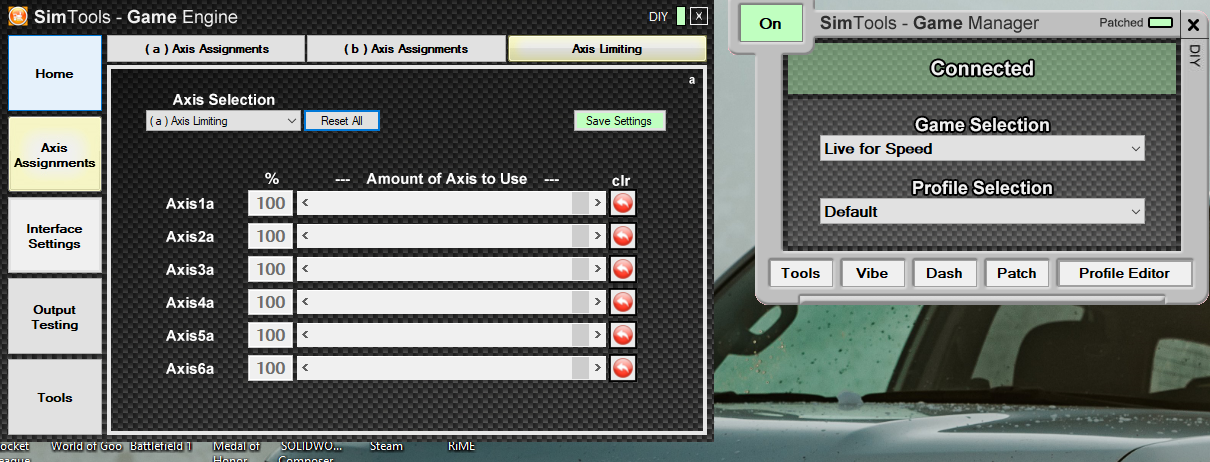

    Have you created a Default profile in Axis Assignment, as that is what is used in Output Testing to check SimTools, prior to trying it out with games. We really need to see pictures of all of your settings.
  7. Garrick H. Woods
    Garrick H. Woods Simulator Noob
    Jan 7, 2020
    27
    194Coins
    +22 / 0 / -0
    22,183
    154,720Coins
    +11,193 / 57 / -2
    You can grab the SimTools manual from here: https://www.xsimulator.net/community/threads/official-simtools-user-manual.12424/

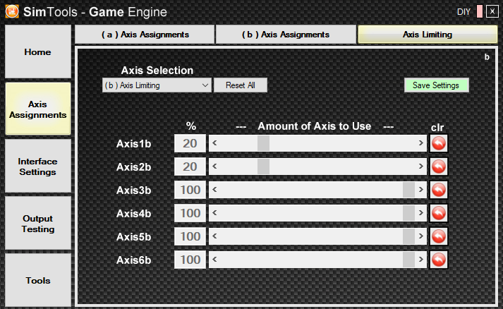

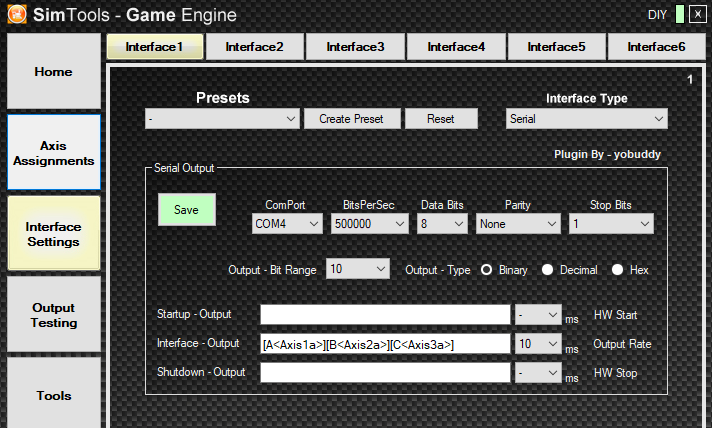

    At this early stage why are you using Axis Limiting? I would suggest that only if using something that can break, like an SCN.
    If you are only using 2 motors then your Interface Settings should be like this: [A<Axis1a>][B<Axis2a>]
    You do not need Axis Assignments for b, as you are only using a.
    The pink indicator top right of Game Engine indicates that Game Manager is not connected, was it running at the time?
    You don't need it just yet but I would suggest you swap the Axis Type to 2D Generic Advanced, as once you get the basics sorted you may want to have the filters exposed for fine tuning.

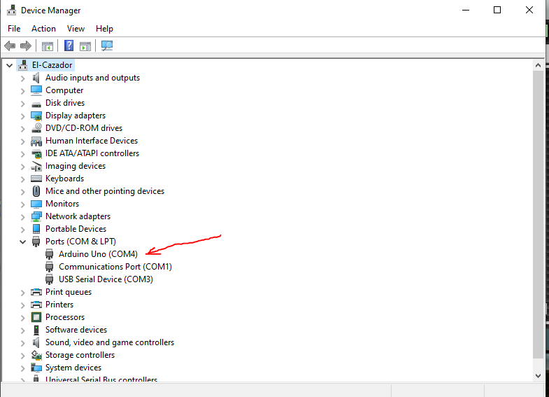

    I just want to confirm that you are not running SMC3 and SimTools at the same time, as that will cause a port conflict, and that the Arduino is on Comm Port 4 in Windows Device Manager.

    The Arduino being connected is not an issue, it is the SMC3 utility used to configure SMC3 that will cause a port conflict if running at the same time as SimTools.

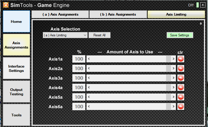

    Just to confirm, you have corrected Axis Limiting?
    If SMC3 works as expected temporarily disable anti-virus and firewall and reinstall SimTools, check configuration and Default Profile, then try Output Testing.

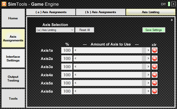

    Yes, I removed the axis limiting. I also tried uninstalling simtools and re-downloading it, but it didn't seem to change anything.
    Is there anything I possibly forgot to configure when setting up simtools? I've read the manual 2 or 3 times to try to find what I'm missing but I haven't been able to find anything.
