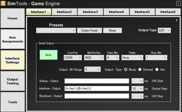

    I am basically building a small rig with hobby servos (just to start off with) and am hoping to do it as a project in my school to encourage students into an engineering career.
    I am using the code at the bottom of this thread.
    I have the servos connected to pin 4 and 3. The arduino and servos have been tested and work.
    When running the game the virtual axis all move fine.
    however the arduino does not seam to be getting any signal. if i put a serial.println in anywhere in the code it does not print to the serial monitor, unless i place it in the void loop. this makes me think that the data is not being sent to the arduio and it is just constantly looping in the loop.
    i have tried every combination of Interface-output, bit rates and axis assignments that i could find on the forums but noting works. I have also tried other codes i have seen people share but that does not work for me ether.

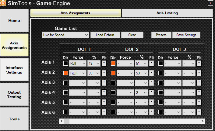

    Thanks guys, its starting to make much more seance to me now :) One more question however, what should i set in my axis assignments for this set up? i have a left and right servo.
    R<Axis1>~L<Axis2>~

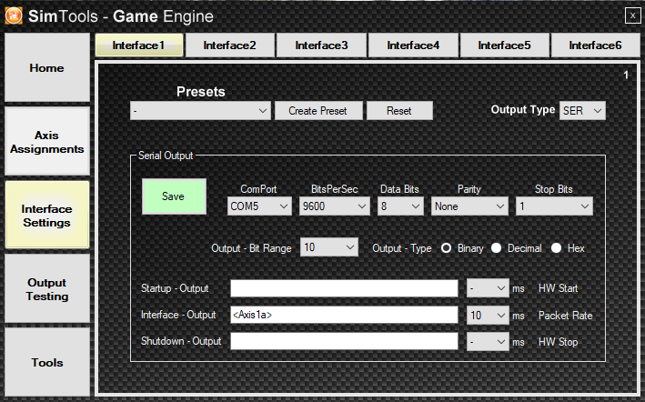

    It should be:
    R<Axis1a>~L<Axis2a>~
    As per my earlier comment.

    Thank you, all working :) just needs some fine tuning.
