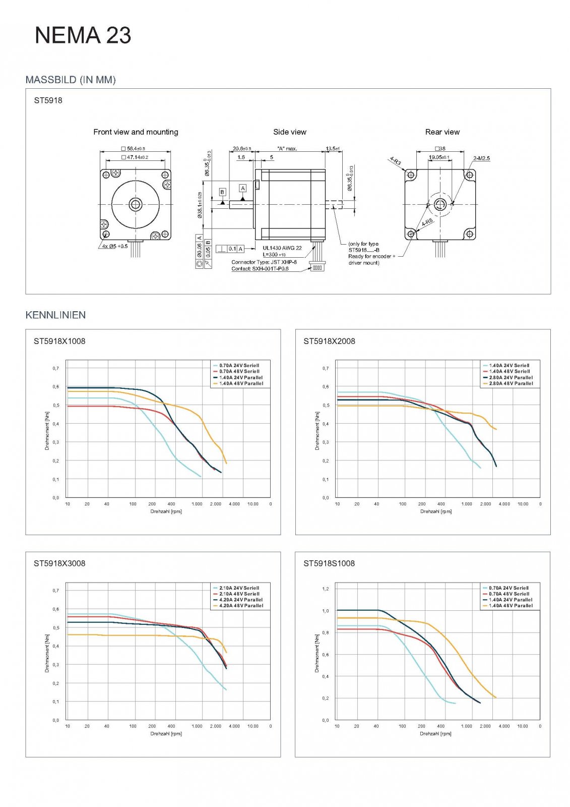

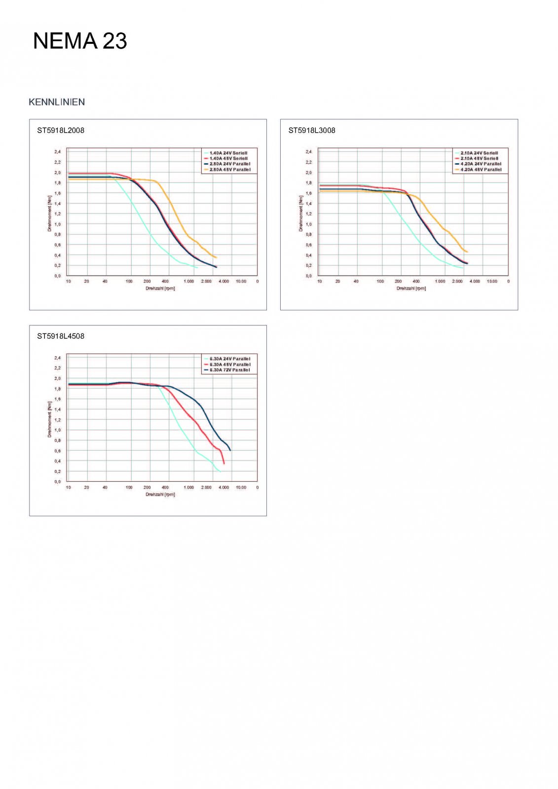

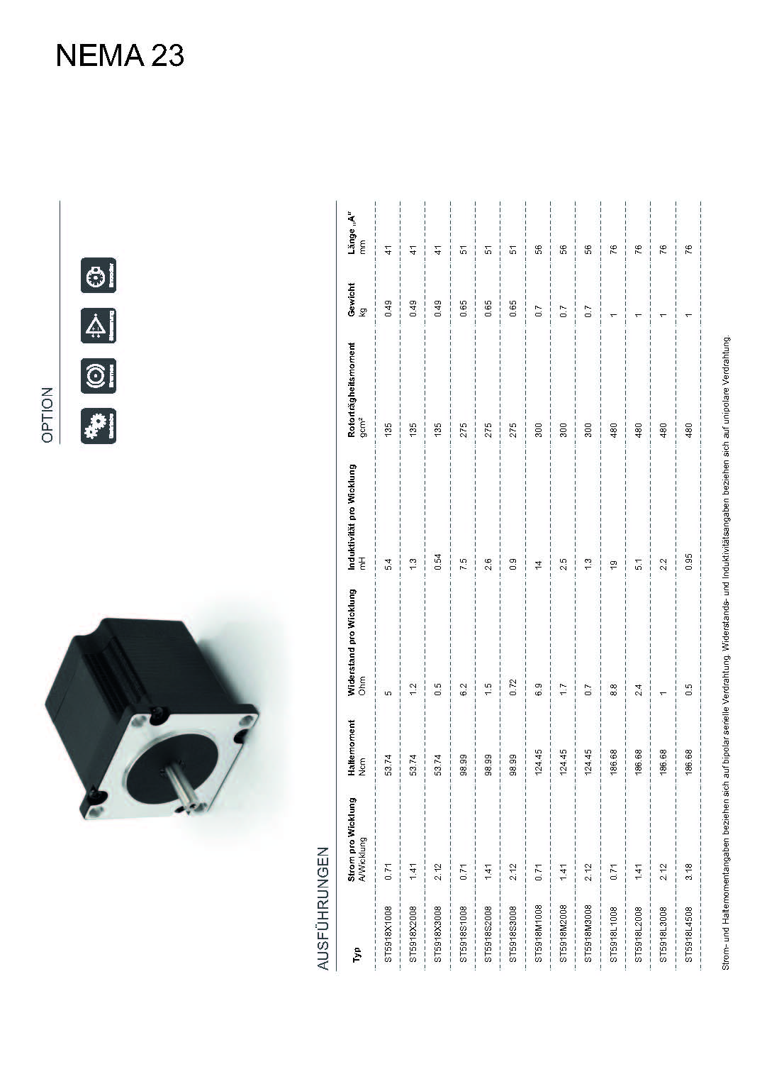

    Hello Bordiin,

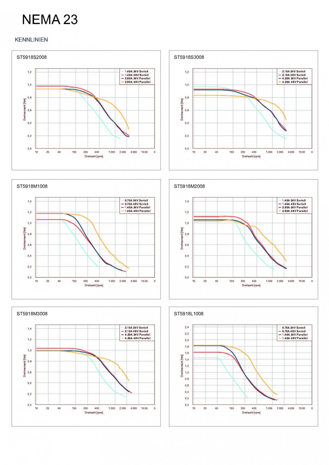

    I don't know which nema23 is used in the SCN6.
    On this site are many of them available, even up to 3Nm.
    http://www.omc-stepperonline.com/stepper-motors-nema-23-stepper-motors-c-1_22.html
    Here are 4 pictures of a data sheet from another provider showing some torque curves. There are models for lower or higher speed.
    nema 23_Seite_1.jpg nema 23_Seite_2.jpg nema 23_Seite_3.jpg nema 23_Seite_4.jpg
    Have you thought about moving as well the pivot point as the motors closer to the balance point of the rig.
    So you need less movement (speed) of the actuators to reach the same swing amplitude of your rig.

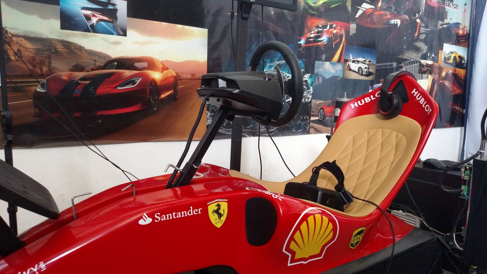

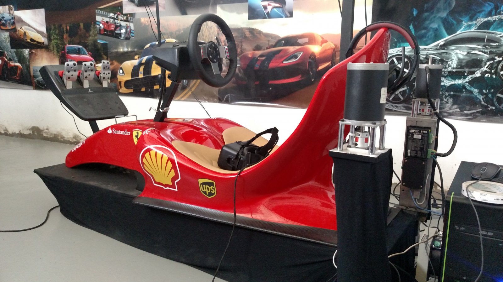

    After a while here it's my final project :D

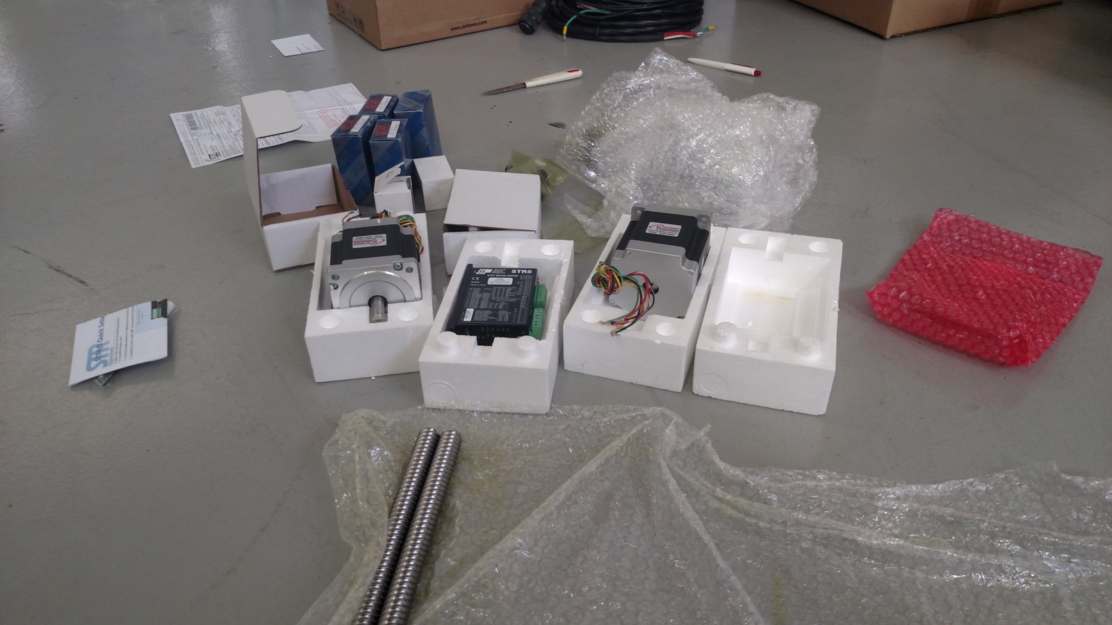

    testing the strength of the motors. with 135kg. and my new toys to improve my simulator :D

    Hello @xytras, I'm using a 3Nm steppers I paid 60 EUR (http://www.kalatec.com.br/motor-de-passo-5034-349) the specification of the motor and the drive the company recommend this one (http://www.kalatec.com.br/drive-de-motor-de-passo-str8) I paid 200 EUR. STR8 is for 8A, it's a little bit expensive but is one of the best drive here in brazil.
    You need to check the current of the motor. And with you use the motor only to move de seat not all frame like me you can build with a nema 23 and use this TB6600 board
