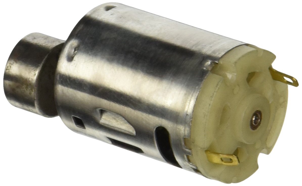

    so it will be possible to transmit the movement to these small motors through an amplifier operated by simvibe release contained in simtools 2.0? Instead the buttkicker transducer it will possible to connect some micro motors like this one?

    DC 12-24V 4700RPM High Torque Magnet Massager Vibration Motor
    21,597
    151,245Coins
    SimTools GameVibe will be aimed at transducers.

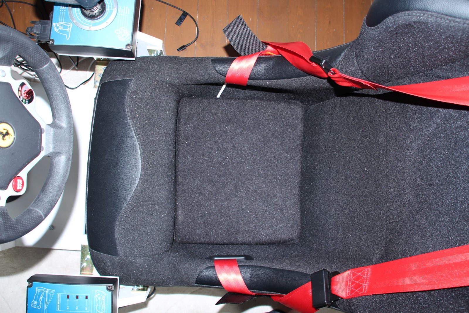

    Hey @gigi,
    unfortunately I cannot access the page on the AssettoCorsa forum, although I have signed up. Don't have the permission, it says.
    Anyway, I also got the idea of using such massage vibration motors, and it works really well. I just put two of them onto my seat:
    Of course I put the seat pad back onto the seat:
    You can find some more details in my thread:
    https://www.xsimulator.net/communit...ation-for-oculus-rift.7684/page-3#post-114278
    Now about how to trigger the motors: You don't need any amplifier, simvibe, etc. Just make a setup as explained in @SilentChill's excellent thread:
    https://www.xsimulator.net/community/threads/simulated-wind-using-monstermoto-and-arduinouno.6876/
    @SilentChill uses his setup for getting airstream by connecting fans, but you can connect the vibration motors in the very same way as these fans.
    In fact, I connected vibration motors plus fans in parallel to the same controller board.
    In his thread, you can also see how to do the software configuration with GameDash.
    Since I am using JRK boards, my setup was different, but with some geniuses of this forum (credits in my thread) it finally worked.
