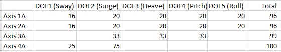

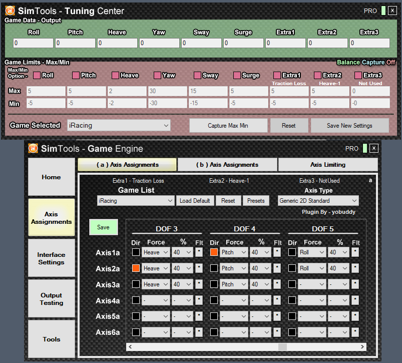

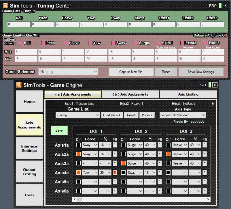

    Please could you recommend settings for my Race cube (4DOF)
    I use the Race cube for Iracing, I race in the Porsche Iracing Cup/Ruf GT3 Challenge and later I will move onto the VRS GT Sprint Series, Iracing Le Mans Series
    The current settings feel ok however I would like to get some advice and feedback on whether more experienced members feel that with some adjustments it could improve the overall experience, I would like to try and replicate how it would feel in real life or as close as possible,
    I have to limit amount of Yaw due to the cables running from the RC to the PC for now, this is set to 25 - 25
    Here's a link so can see how it moving with the below settings.
    Here are my Current settings,
    21,511
    150,686Coins
    +11,018 / 55 / -2
    My best advice is follow these steps and learn how to refine a motion profile, doing each axis in turn: https://www.xsimulator.net/community/faq/steps-to-create-a-motion-profile.228/
    At the moment your total axis allocation is 216%, which will result in clipping, it really should be around half that total: https://www.xsimulator.net/community/faq/axis-assignment-percentage-totals.120/
    If you refine your profile properly I suspect you will find it likely that your current sway allocation is too low and your heave allocation too high.

    Would this work better?
    21,511
    150,686Coins
    +11,018 / 55 / -2
    What works for one design of rig does not mean it works well on other rigs.
    Taking a guess at values will result in motion, but not necessarily a good motion profile. Axis allocations are only part of the process, the Tuning Center values are equally important. Even different cars or tracks need some tweaking of a generic profile in Game Manager profiles.
    I appreciate spending time experimenting and learning how to create motion profiles is not glamorous, but it is the key to getting the best out of your rig.
