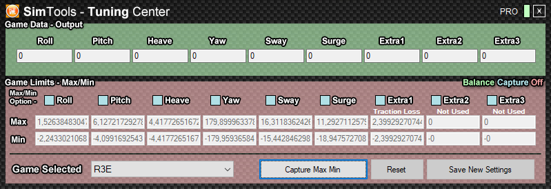

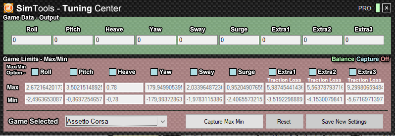

    I did some tuning of with the tuning center and general movement are ok. However, now I have another issue (of course :) ), which i couldn't figure out: When shifting up while accelerating or shifting down under braking I get a bouncing surge interruption movement, that fades (like a ball bouncing on the floor). I have this with all cars. I also tried the same car in Assetto Corse where it feels right. It's this cut in surge when shifiting. Usually its just one interruption in the surge, but in R3E its a boucing and fading interruption.
    I can do a video of the axis/DOF if it's hard to understand what i mean. Just let me know. Anyone here who can share their config or has idea is much appreciated!

    Thanks for the reply. ok, will do a video when back from work. I tried the faq you linked. While my gear change is already snappy enough, of course I can also use this technique to make it less snappy, which i did. The movement becomes less intense, but it's still this echoing, fading movement in surge after each shift. It feels like the hood of my car is doing several hops after each shift. Other pitch/roll movements, like when going over bumpers/curbs feel ok, but the shifting surge feels to intense compared to the other movents and the echoing is irritating. :(

    It sounds like your rig is oscillating, but the video should help clarify that.
    When you shoot the video position the camera where the movement of the rig and the screen can both be clearly seen.
    Also post pictures of all of your settings, that way members can make suggestions about what to try.
    When refining a motion profile you should do each axis individually and it would be worth just running surge by itself to tweak it: https://www.xsimulator.net/community/faq/steps-to-create-a-motion-profile.228/

    :) Thank you for your patience. I mentioned about, that I did the procedure from the "snappy gear change tutorial". I did it again... while the UI is not the same anymore and there are now three options. Off and capture are clear. Not really sure what balance does?!
    I've attached my settings and values from the tuning center and as a reference the values from assetto corsa, but it looks like the values are plugin specific, as they are totally different.
    So I've also manually tested different values. If I increase the values, obviously I get less movement for accelerating and breaking, the bouncing when shifting becomes less, but it's still there, still noticable...
    21,497
    150,602Coins
    +11,017 / 55 / -2
    You do need to do a motion profile for each game as the values will be different when each one is dialed in for your sim.
    Your Axis Allocations are way too high at 260%, while you can go a little over you should aim for a total around 100%: https://www.xsimulator.net/community/faq/axis-assignment-percentage-totals.120/
    So follow the steps in my earlier link, do each axis/force one at at time, use lower Axis Allocations and lower Tuning Center values.

    Hey Guys,
    I was planning on creating a "T1000 Profile sharing thread", when i have time... :think
    To give A short answer until I have done this:
    • Was I able to get rid of the "gear-change-osciallation"? -> Yes, somewhat. You really have to invest some time and play with the tuning center.
    Longer answer: By nature (SCN6 facing the ground), the t1000 is very good at simulating every little crack and stone on the surface. So heave easily becomes the predominant DOF you feel, making sway/roll (cornering) and pitch (accerlation/braking) less senseable. You basically feel like you're sitting on your washing machine while its spinning at high speed.
    I want to feel the surface, but I also want to feel (simulated) G-Forces. So For Assetto Corsa I already managed (with SimTools Tuning Center) to get a motion profile that fits my taste (except for traction loss). I still need to do it for RaceRoom Experience and other Sims. Since I race RRE a lot too, might certainly do it some time soon.
    How do I tune? I have a standard car/track combination I might probably find in most sims (for me Mercedes AMG GT3 & Red Bull Ring).
    1. I let tuning center CAPTURE MIN MAX and race 1-2 rounds at 80-90% race speed, so I always stay on track (run offs will falsify the recording). Then I Save the new settings in tuning center
    2. Now I race again 1-2 rounds at 80-90% race speed and use OBS (open source screen recording software) to record my game screen /VR mirror AND Virtual Axis (In SimTools Game Engine -> Output Testing -> Virtual Axis). I also take not of how the driving feels.
    3. I look at the recording (sometimes at slowmotion) to understand which DOF occupies which axis how much at different track situations. With these insights I change the tuning center values, e.g. like stated above: tone down heave and surge, turn up pitch, roll and sway.
    4. Repeat steps 2&3 until it feels better
    In the end I guess it's a question of taste, but by default the design of the T1000 emphasizes heave and surge too much and needs some correction. I will @-tag you guys once I have something to share. :cool:
