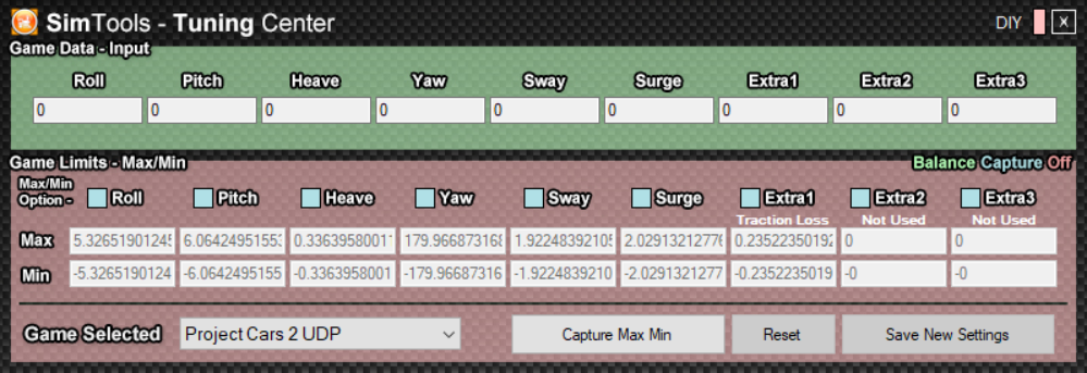

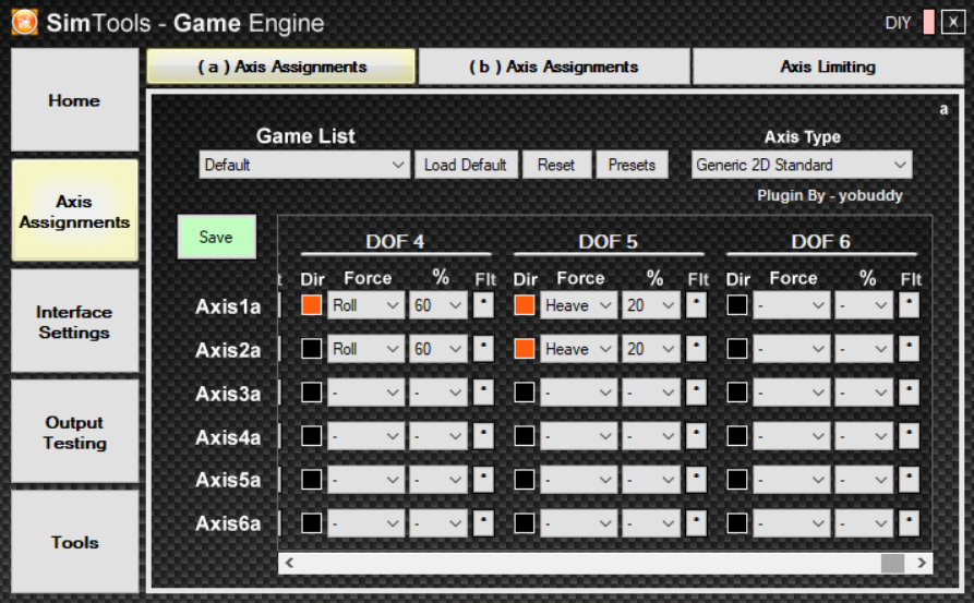

    thanks very much for the plugin.
    I do have a weird case of reversed pitch/heave while running it but funny enough, if I reverse those in axis setup then there is no pitch/heave feeling anymore.
    I captured my own min/max values unbalanced to see if it makes a difference.
    any hints are appreciated.
    here are my settings:
    E38D0594-4DF2-4566-8C56-EBB355AD0224.png D30DD6CD-A3D1-4A2C-AE2E-508F5A1A4BBA.png 4C31C31E-F172-4F6F-BC02-A4531195266E.png
    21,740
    152,213Coins
    +11,065 / 56 / -2
    With an Axis Assignment total of 260% you are going to get clipping and some weird behavior: https://www.xsimulator.net/community/faq/axis-assignment-percentage-totals.120/
    Try the tuning tips here, in particular stick with sensible allocations, initially do each axis individually, then turn them all on and tweak from there: https://www.xsimulator.net/community/faq/steps-to-create-a-motion-profile.228/

    thanks for the tips. I will do it step by step.
    this is the default I use and it seems to work well otherwise.
    in this particular case I feel the pitch/heave well, except that they are reversed (upon acceleration the platform dips, upon braking it lifts).
    cheers
  11. mirel lazar
    mirel lazar New Member
    Aug 31, 2018
    9
    - 203Coins
    2DOF, 3DOF, SCN6, Arduino, Motion platform
    it turns out it was not the pitch/heave that was causing the problem, but surge.
    anyway, all 3 had to be inverted.
    and yes, testing them one by one was the way to do it, so thanks.
