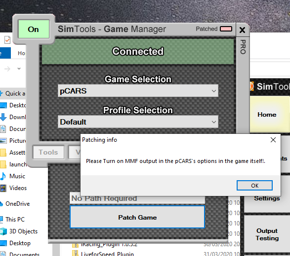

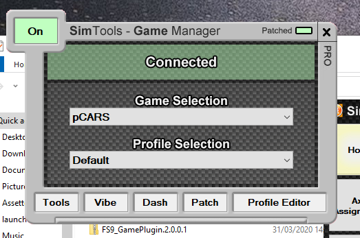

    Hi All. I just bought Project cars 2 and I have problems to get it going with the Rig.
    My plugin version is P.Cars 2.0.3.3. Is this correct version ?
    In the game manager
    upload_2020-6-9_22-4-28.png - game patched but no movement

    I have installed PC2 on my E: drive. Could that be the issue?
    I do not have enough coins to download the new version ...
  16. noorbeast
    21,719
    152,021Coins
    +11,061 / 56 / -2
    Project Cars 2 requires some in-game settings to be made, see the FAQs here: https://www.xsimulator.net/community/faq/projectcars.188/
    2.0.3.3 is the latest version of the PC2 plugin.
  17. paulopsx2
    paulopsx2 Active Member
    Apr 2, 2016
    616
    brasil
    647Coins
    +165 / 2 / -0
    this plugin is made for PC1 ( as show in your print ). for PC2, you needs to pick up correclty version.

  19. tomkil192
    tomkil192 Member
    Jun 25, 2015
    81
    Uk. London
    - 25Coins
    +26 / 0 / -0
    Thanks for your help. I will try to earn 250coins and get the right plugin. Once i have it i will prepare tutorial so people dont do my mistakes.
    Current instruction are indeed for project cars 1 and they are irrelevant for pc2.
