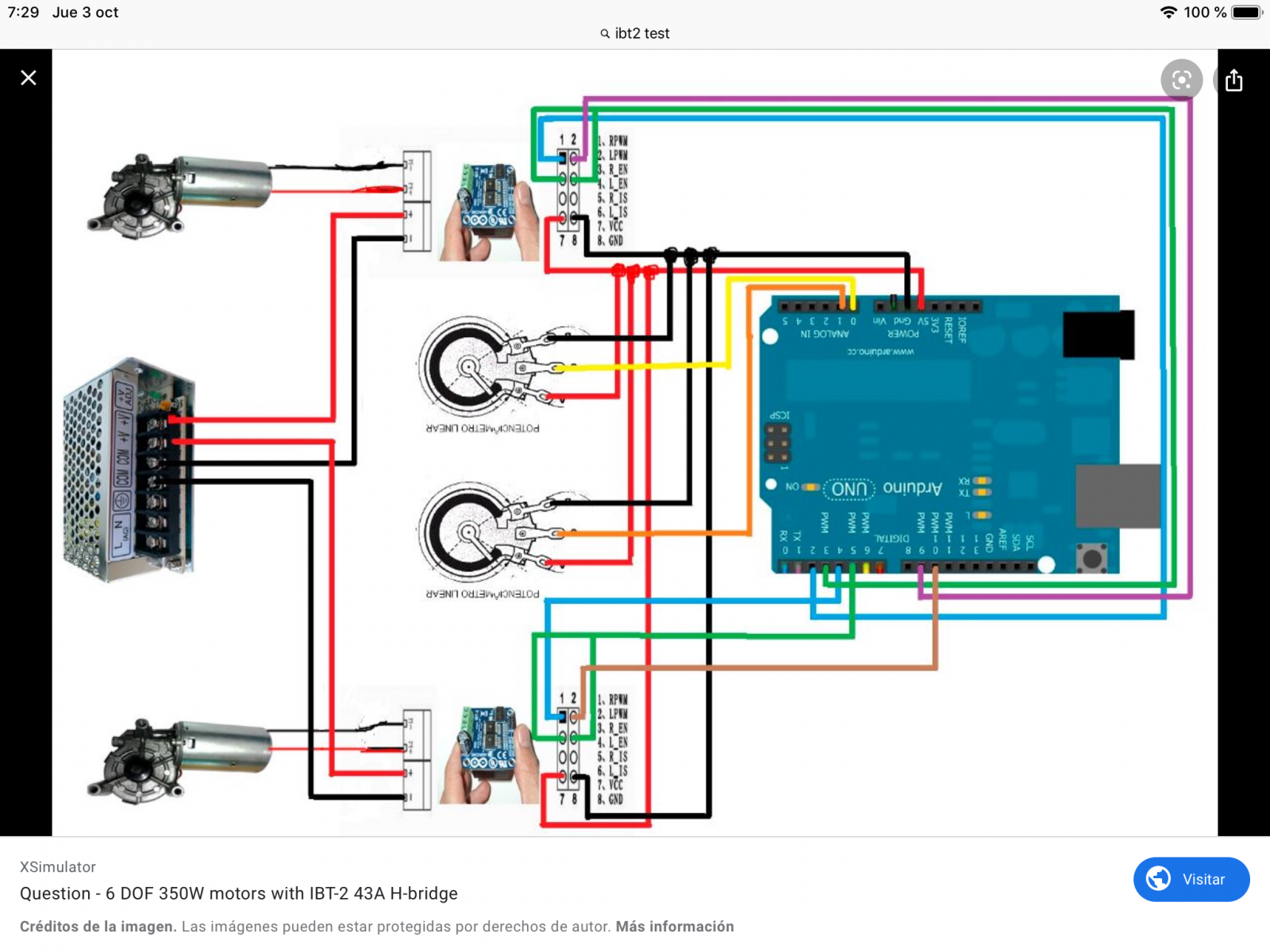

  5. sbdtoni
    sbdtoni Member
    Jun 5, 2019
    42
    207Coins
    +13 / 0 / -0
    Ni i Made this circuit changing in the Arduino sketch mode1 to mode2 pots are installed like picture

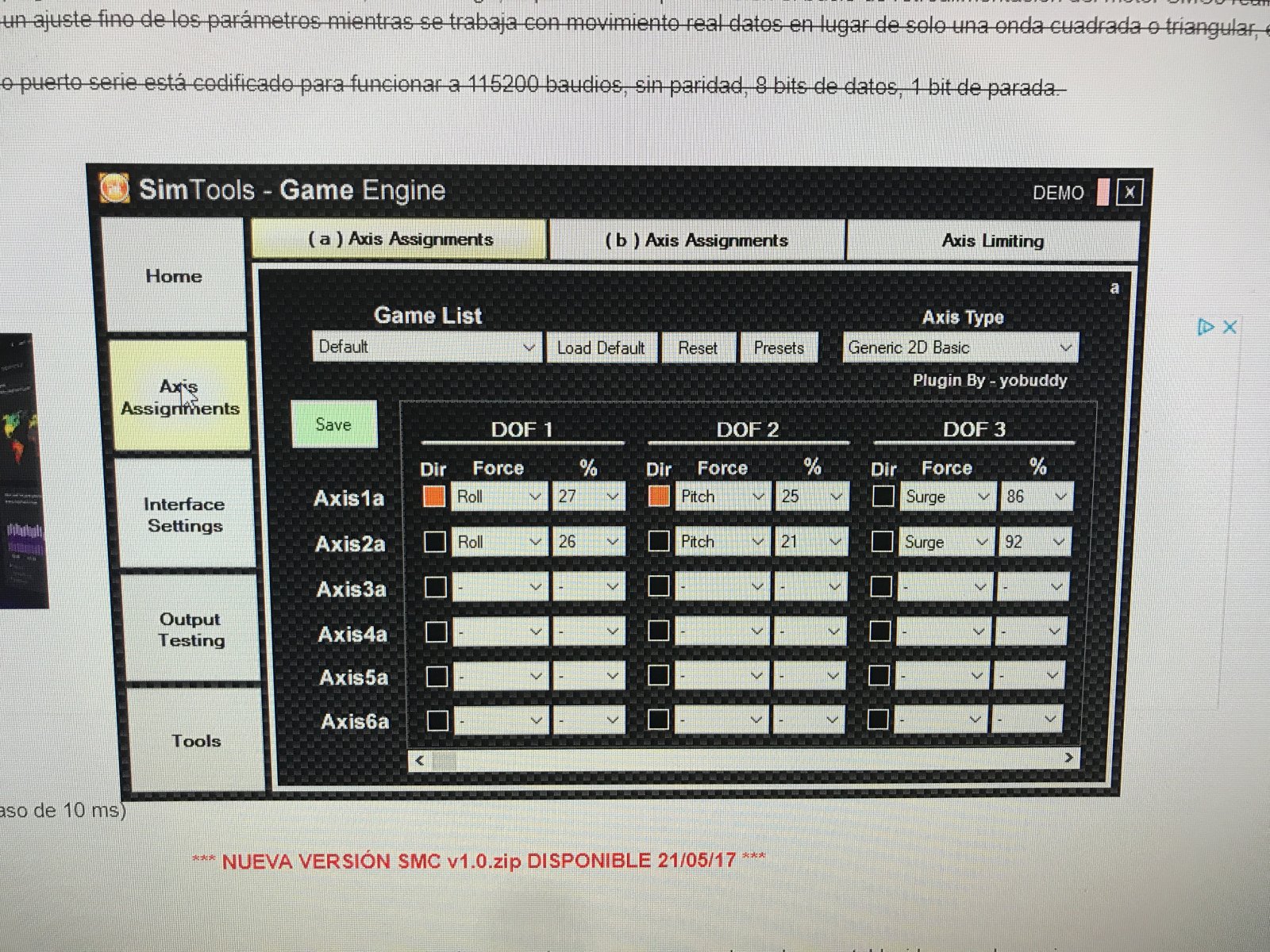

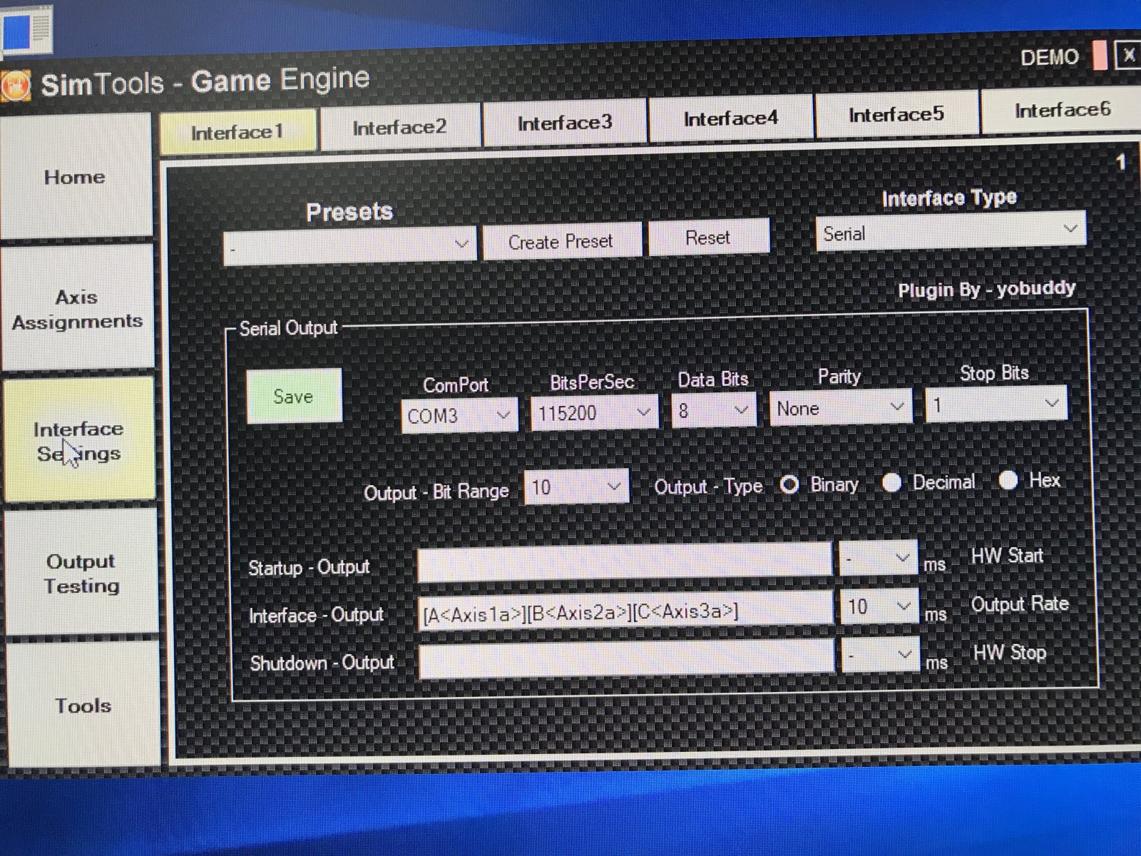

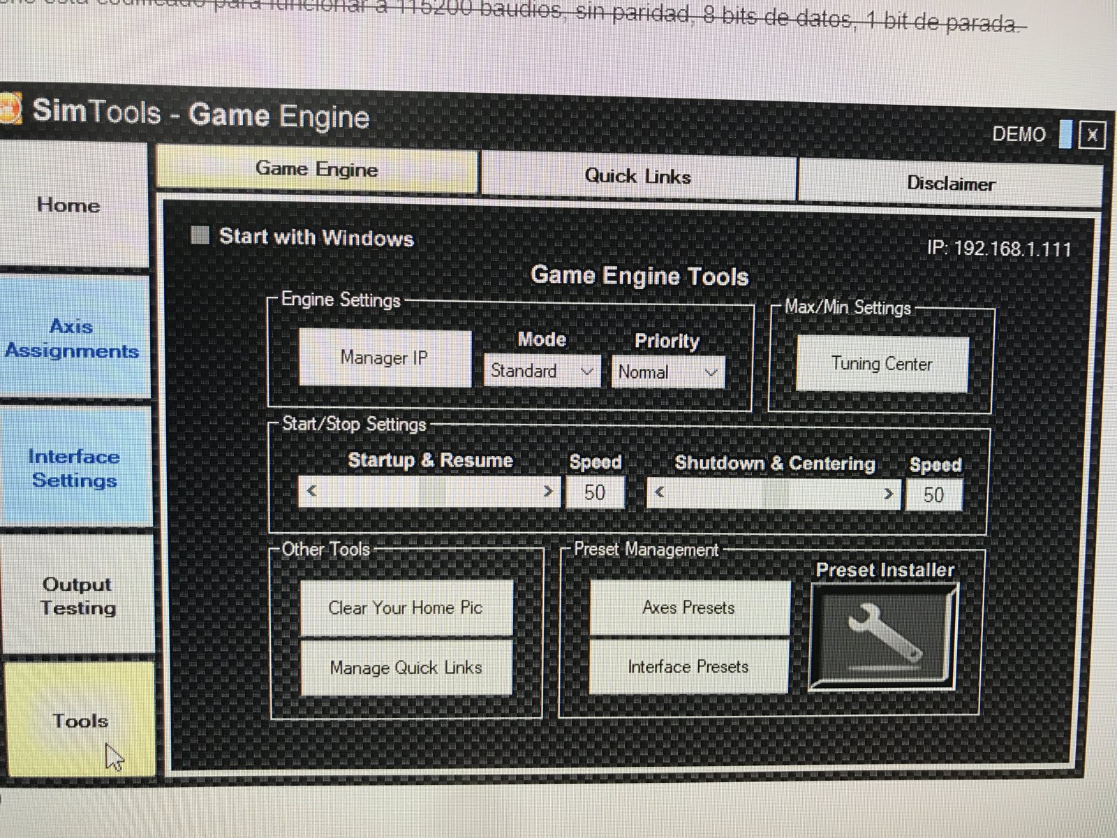

  15. sbdtoni
    sbdtoni Member
    Jun 5, 2019
    42
    207Coins
    +13 / 0 / -0
    Hi thanks for your help enclose photos of my configurations
  16. noorbeast
    21,724
    152,057Coins
    +11,064 / 56 / -2
    Try 500000 BitsPerSec in your Interface Settings.
