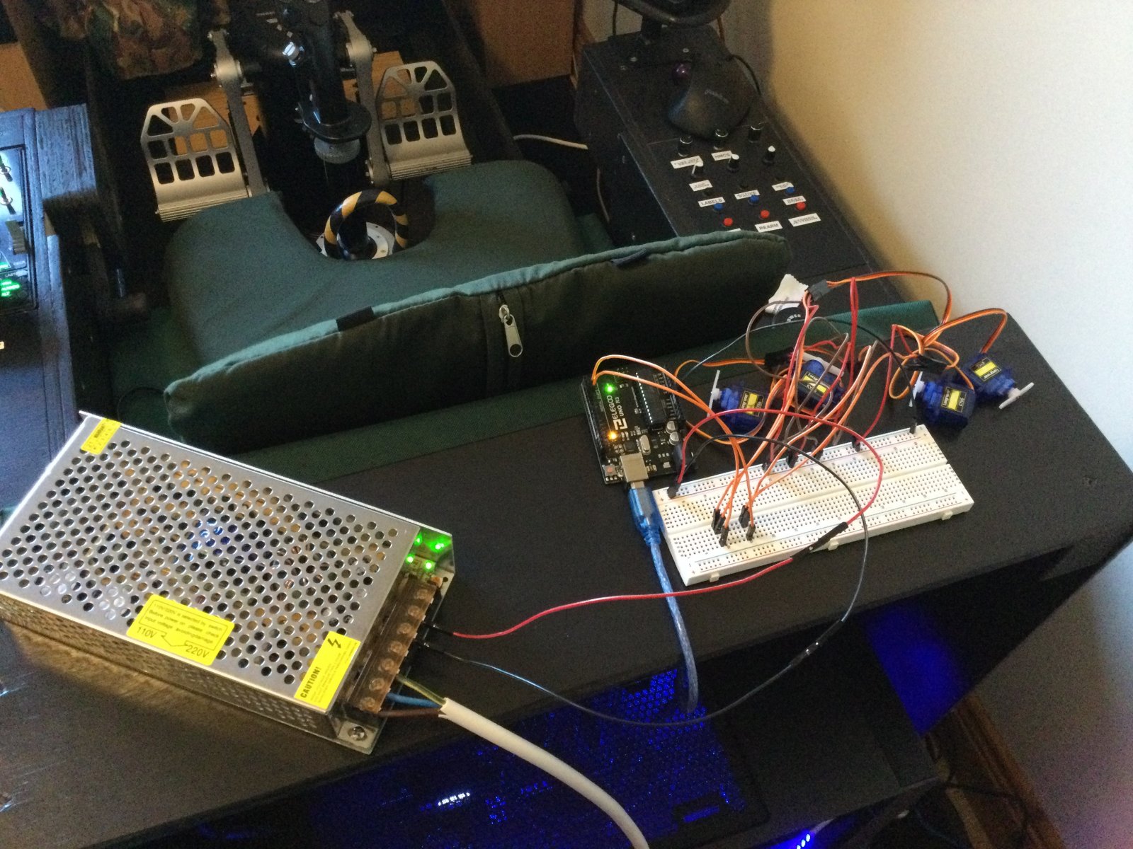

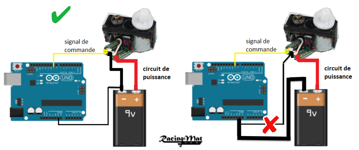

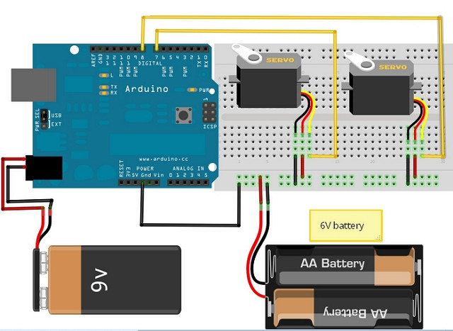

    Quick question guys. Arduino, power supply and a 35 kg servo have arrived. I am going to connect the positive and ground from the servo straight to the power supply. Then tie the ground from the power supply to the arduino. Then the signal wire from the servo goes to the arduino board. Am I correct that the power supply does not go through the Arduino uno power socket. Thanks in advance would hate to blow something up on day one!

    Hi @Turbo Tim ,
    the ground connection of the servo power supply needs to be connected to the Arduino ground, but the positive power cable only goes to the servo and not to the Arduino.
    The following picture (taken from here: https://forum.arduino.cc/t/servo-external-power/468635/2) shows the wiring.
    On my previous rig, I controlled up to 10 servos with a single Arduino, some of them supplied with 6V and others with 24V.

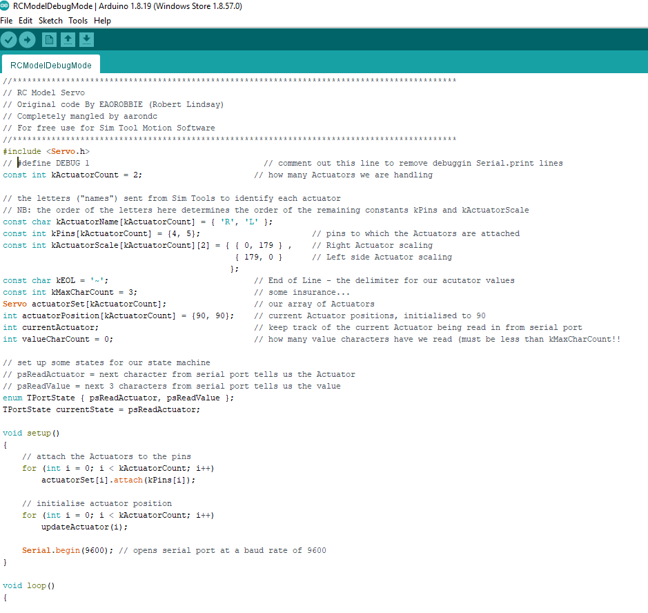

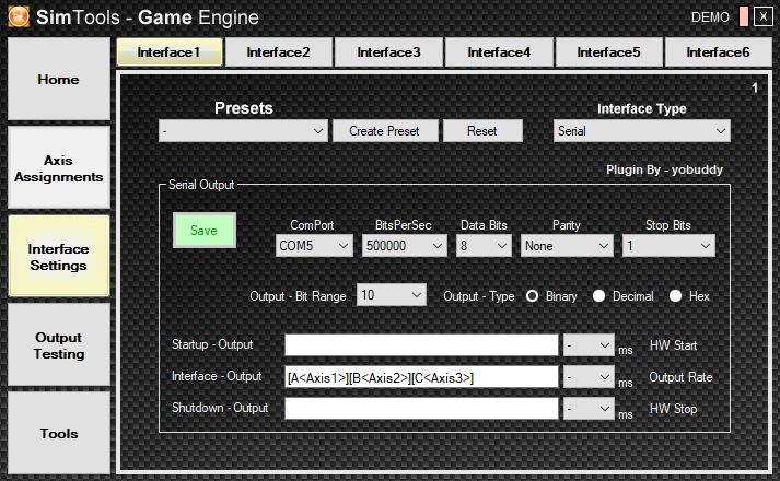

    I have mocked up what am trying to do with micro servos. The next stage is to try and test if I can get some movement using simtools. Am i correct in assuming i should be able to move the servos from the output testing screen in the game engine? I will attach some screen shots of EAOROBBIE arduino code I am using plus settings in simtools. Cheers guys

    I know the code is for 2 servos and i am using 4 however they connected to 2 pins. I assume this should be OK.

    Interface settings for @eaorobbie's code should be like this, with your Com Port set:

    yes here are a good wiring and a bad one ;)
  18. Turbo Tim

    Thanks Racing Mat for confirming my wiring is correct. Result noorbeast, that fixed it. Never been so happy to see a servo move. I had read through the simtools user guide but had not understood how to relate the code to the settings in simtools. Very happy to be moving forward. Thanks again guys. Legends
