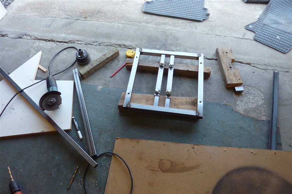

    Hi!

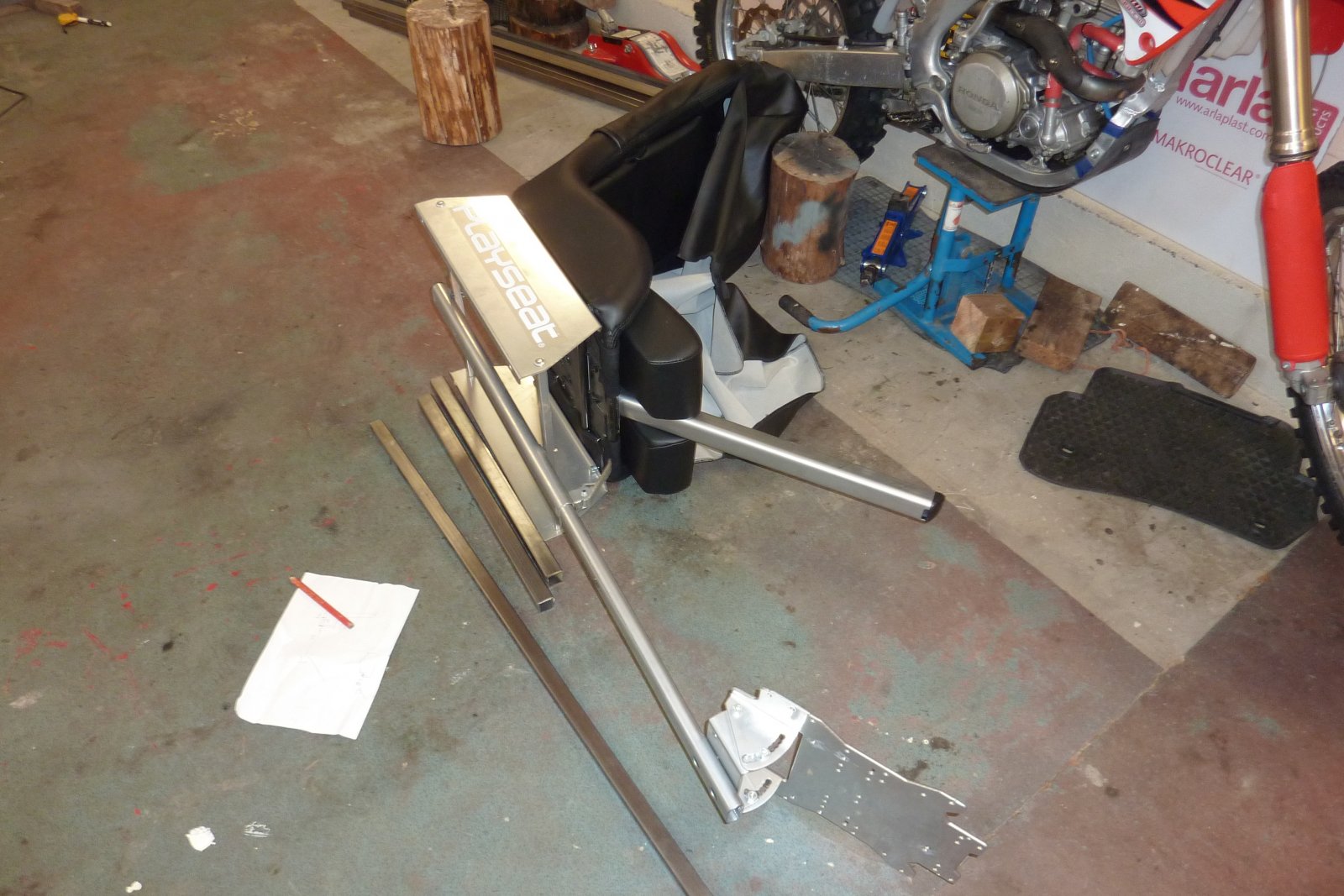

    I got cheap playseat and decided to make it rumble. First idea was to only add some strength and needed supports, but it was too weak to keep nothing but adjustable pedal base and the seat itself (it is light in my opinion).
    First I thought that full frame with monitors in it will be moving, but I got wiser while reading this forum :)
    So I will be full frame w/o monitors.
    List of components I have:

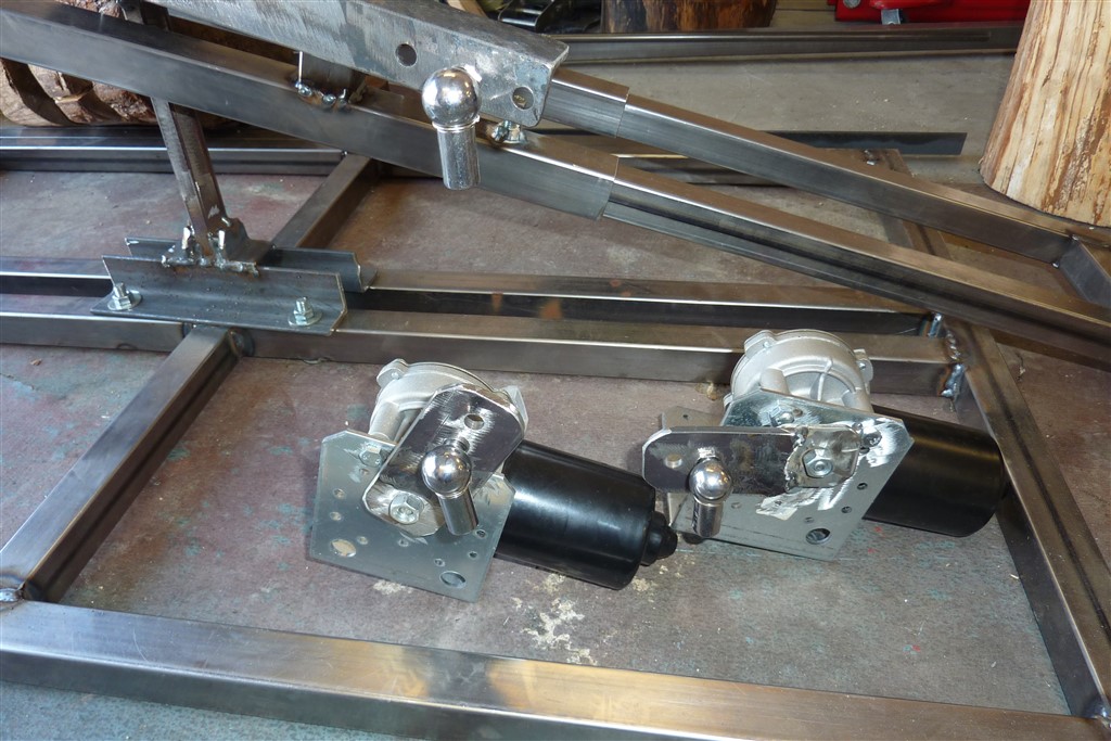

    - 2 cheapest wiper motors from local autopartsdealer, power only 30w (to make POC)
    - arduino mega
    - cv-joint from vw
    - small ball-joint to actuators
    - gaming pc
    - Logitech G25-wheel
    - PlaystationVR, IF THIS WORKS..... or to be changed to 3 x 24 inc monitors (I got already 2 of them)
    Parts ordered:
    - 4 monster moto shields to drive motors
    - 10k pots

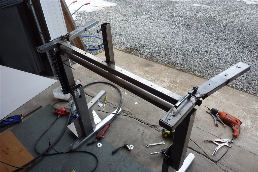

    I am doing metal works mostly from 30x30mm square tube and add some adjustability with 25x25mm tube inside bigger one.
    Some pictures to come...
  2. dr.feelgood
    dr.feelgood Member Gold Contributor
    Apr 17, 2017
    87
    FINLAND
    477Coins
    +43 / 0 / -0
    the beginning...

    Are you planning to adjust the pedals or the seat? Adjusting the seat moves the balance point too much which in not recommended. Move the pedals if needing adjustability.
  4. dr.feelgood
    Apr 17, 2017
    87
    FINLAND
    477Coins
    +43 / 0 / -0

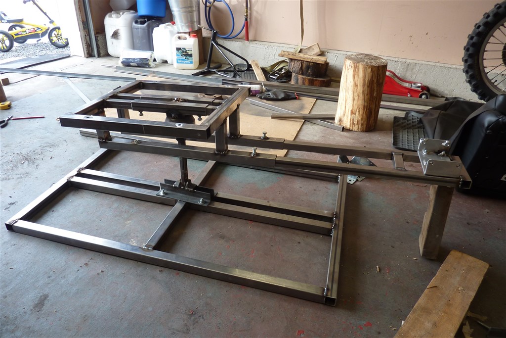

    I'm doing both, in picture you see balancer under seat and pedals length is also adjustable. Just in case...
    I'm considering to use about 30cm distance from joint to actuator point.
    Are you guys using same length to both x-a and y-axel ? Should one or the other movement to be 'bigger' ?

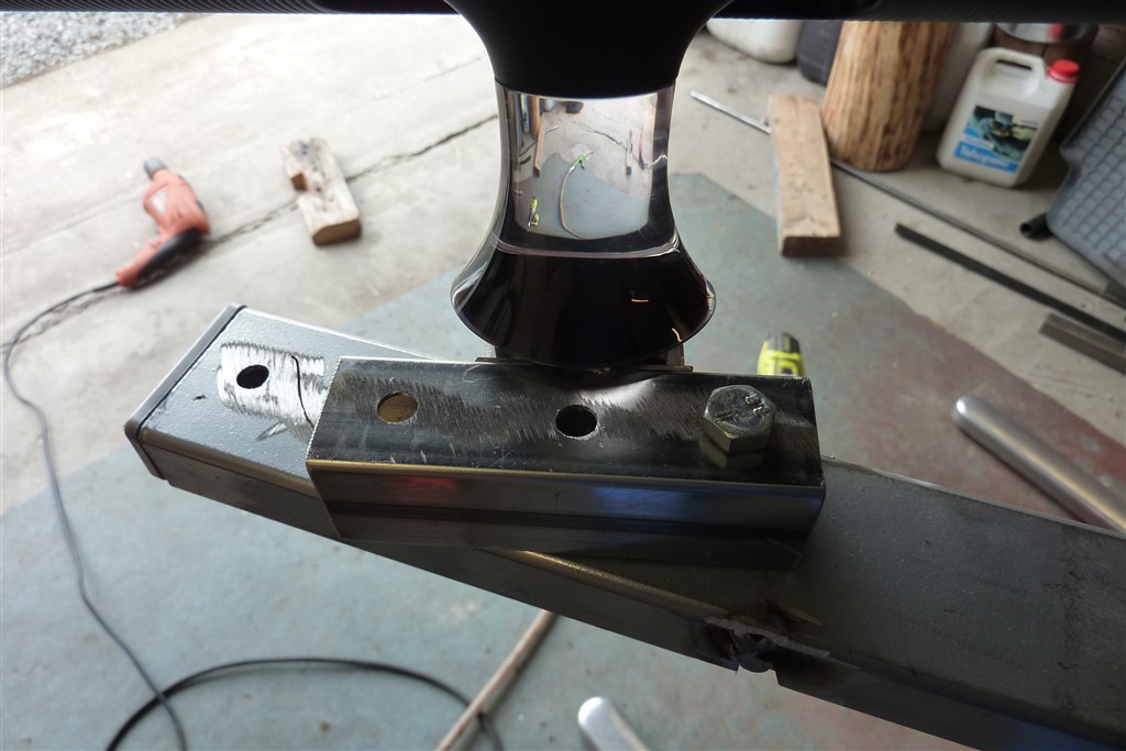

  5. dr.feelgood
    Apr 17, 2017
    87
    FINLAND
    477Coins
    +43 / 0 / -0
    I'm trying to put joint as up to a** as possible :) Actuators is going to be front side of the seat to minimise bending ie. loss of movement.

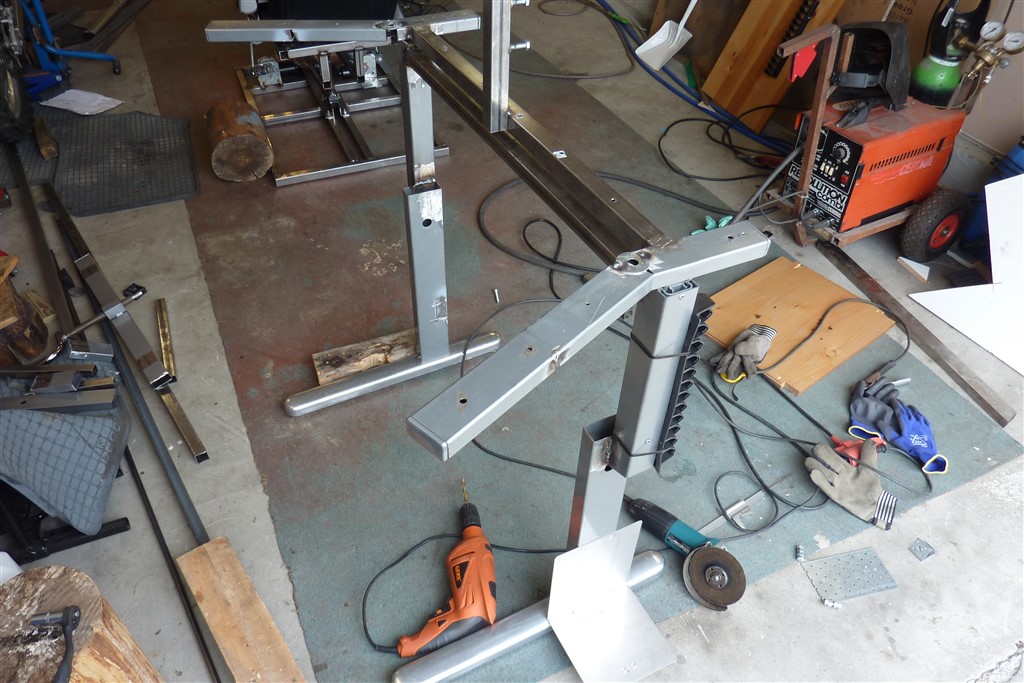

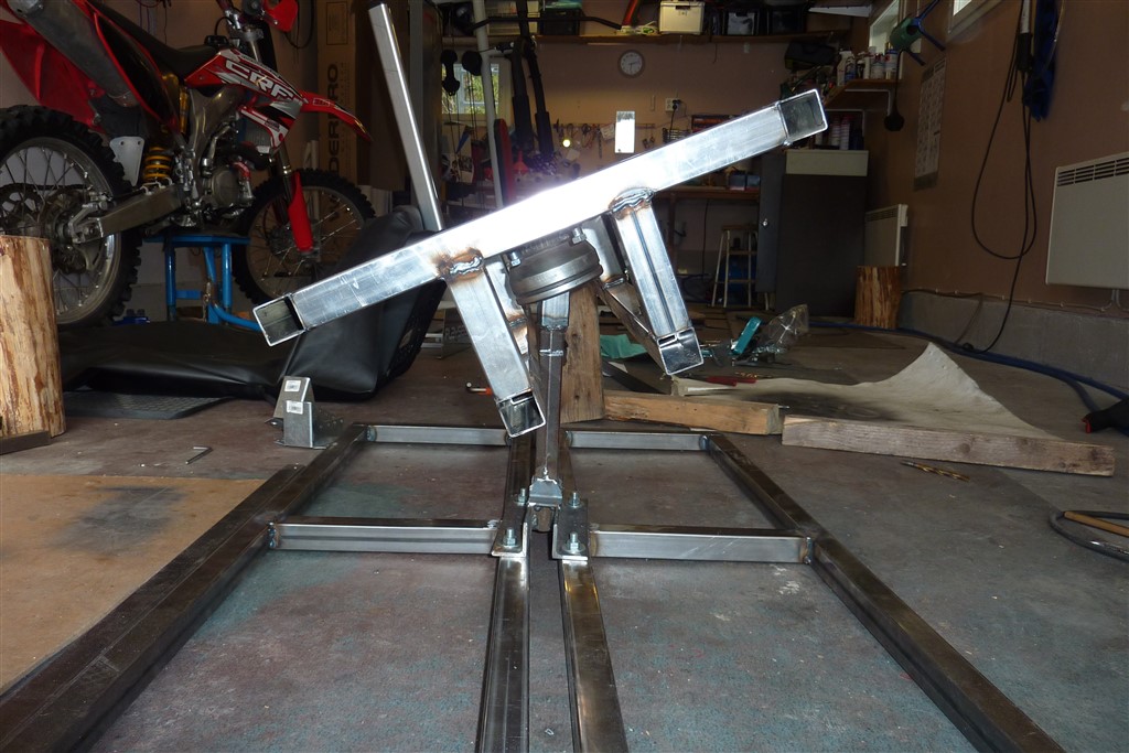

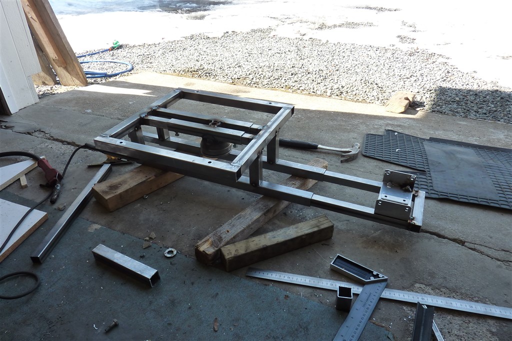

    Hi again, today:
    Base and pivot
    Max tilt
    Doing motor mount and lever thing...
    Nearly there...
    ... and ready for movement tests

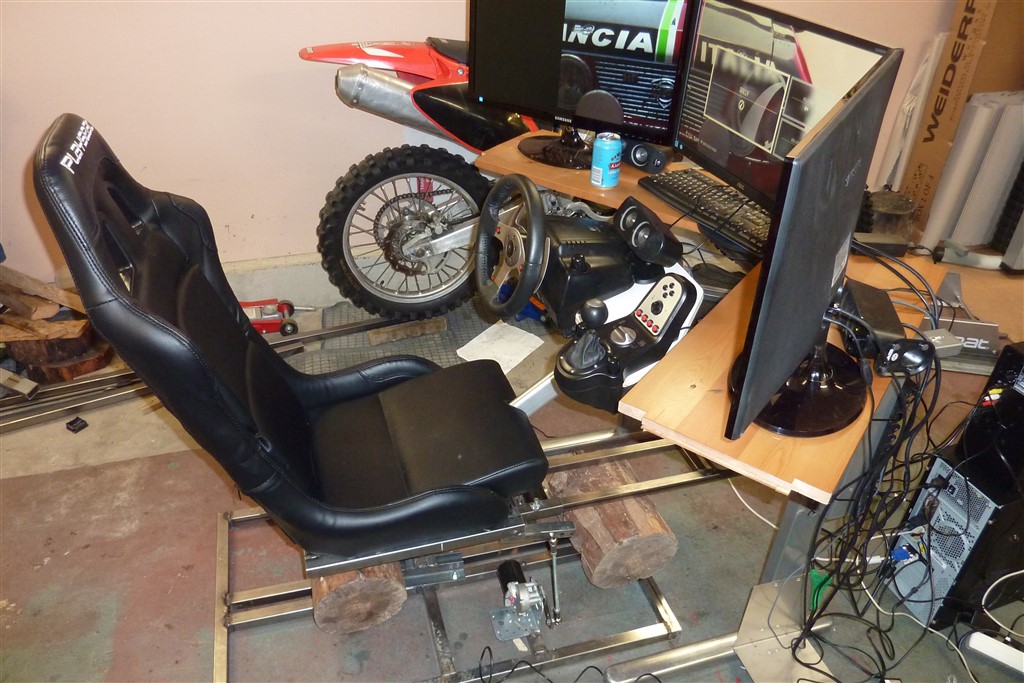

    I screwed my rig together... Made a stand for my monitors and adjusted them about reasonable distance from my eyes...
    Drove a few rally races and everything seemed to be ok.
    But.... The only thing i watched while making the monitor-stand was that my pedals has enough play, so it was kind of okay... wheel space is not okay! Movements are limited because wheel stand clips on sides.
    Solution would be to raise monitor-stand -> that don't want to do, they should be even lower for better feeling. Scrub the stand and make monitors in 'hanging position'... not very pleasing. I'll have to rethink this.. :(
    I wish i had started making only moving seat, not pedals and wheel...

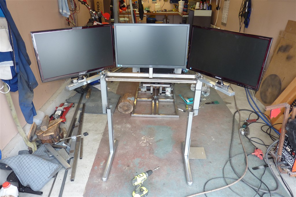

    Hmm, there are two problems. First my legs goes behind monitors a lot and i don't want to fix this set anywhere. Actually i'm going to add small wheels which can be lowered and lifted to move the rig...
  13. dr.feelgood
    Apr 17, 2017
    87
    FINLAND
    477Coins
    +43 / 0 / -0

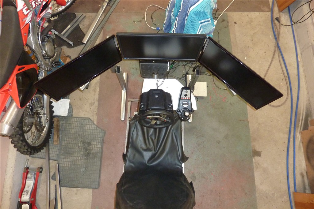

    Today I took monitor-stand partly apart and did some measurements. I figured that those monitors can be applied without their own legs. Side monitors don't have vesa-standard mounts, but it's doable... Middle monitor is the easy one with 100x100mm holes on back of it.
    --> Quick & Dirty DIY
    From straight to angled base:
    Then i did hinges so there is some adjustability:
    Side monitor fixing:
    Result:
    And in the front of my Playseat from birds eye view:
    ... got to go driving again! Where the heck is my order of MM-drivers, sigh...

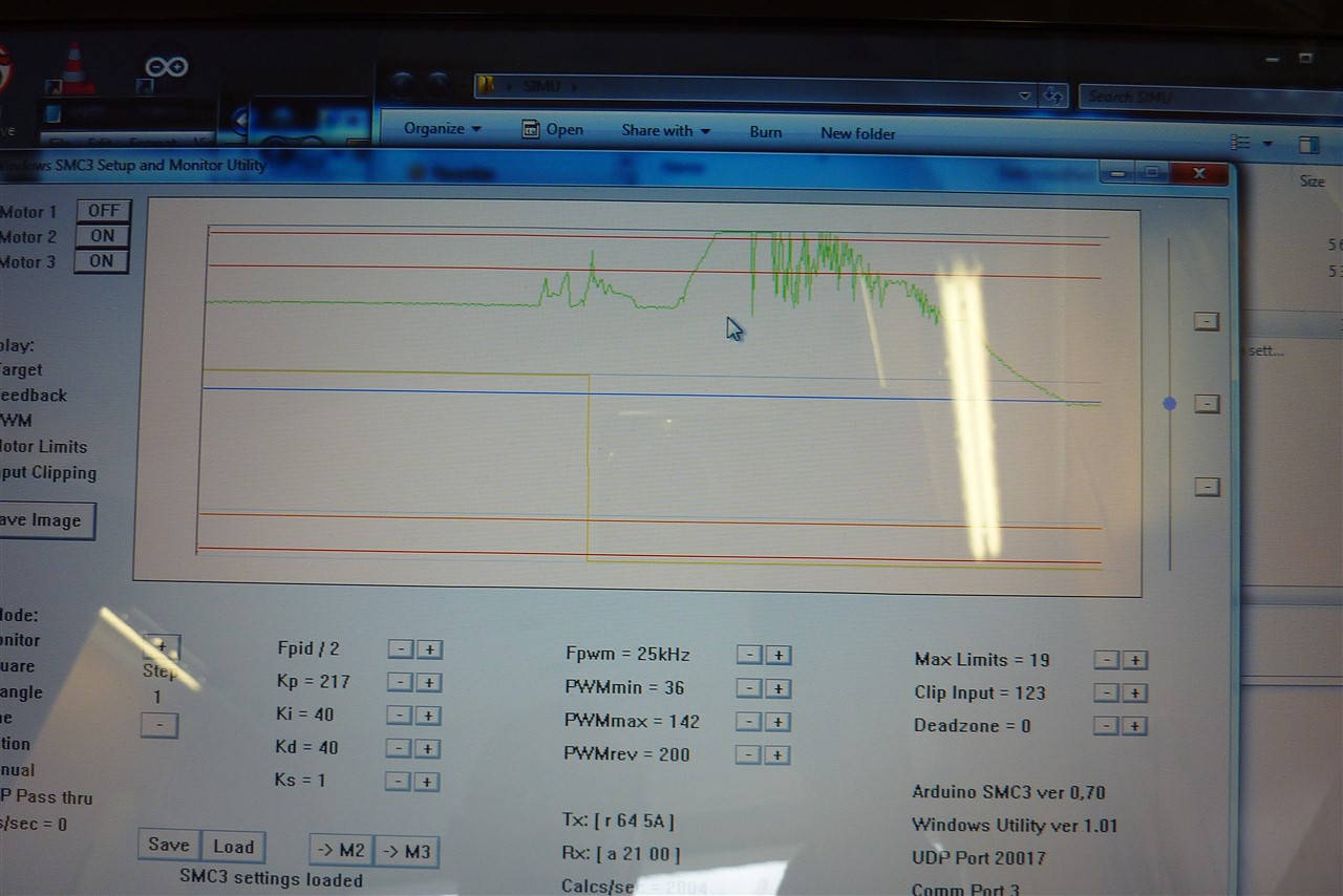

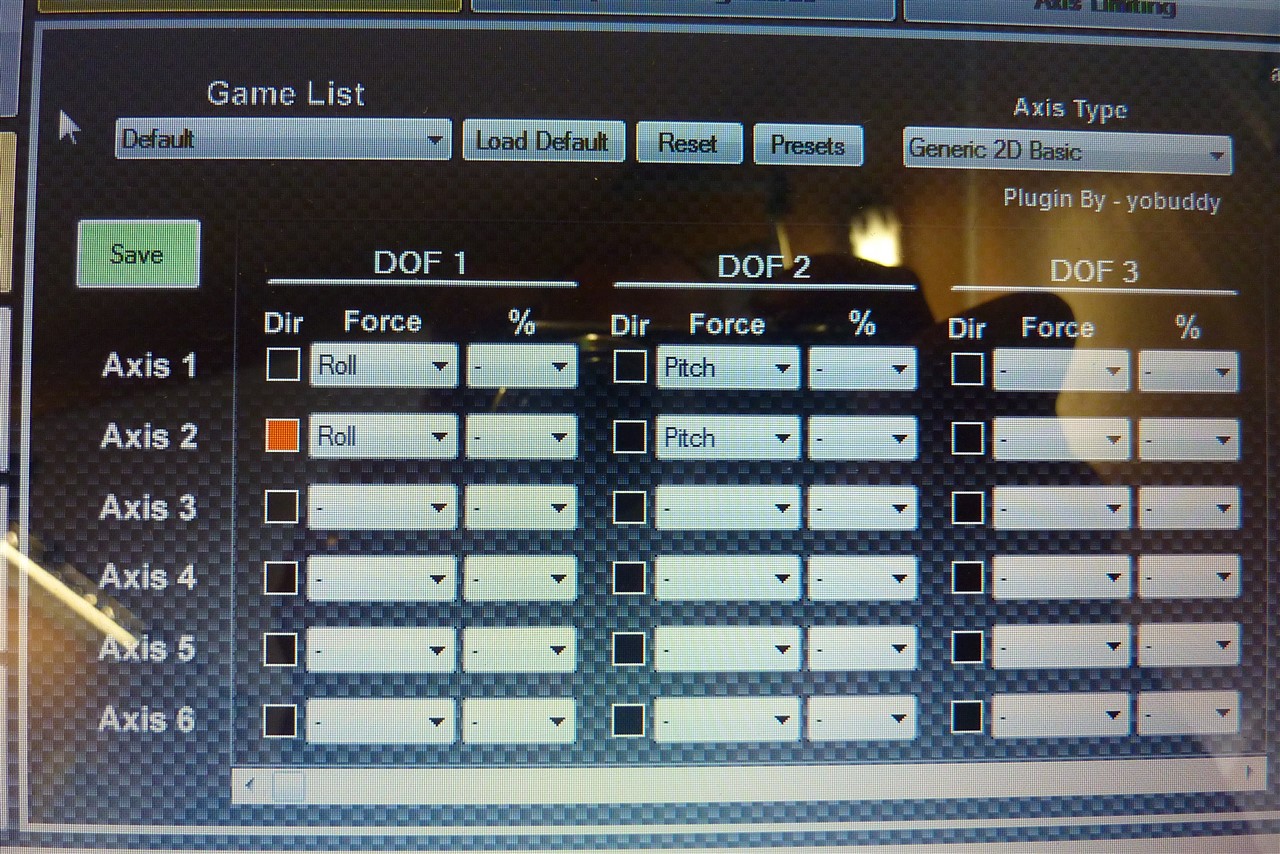

    After testing with temporary pots i don't get any movement on motors... I already tested with 2 different MM's (they were powered on, led was lid). Is this picture of connections still valid with SMC3 v0.7 ?
    https://www.xsimulator.net/community/attachments/motomonstersetup-jpg.10992
    And is the only thing that needs to change on configuration Simtools 2 with axis: Axis1 -> Axis1a ?
    I really don't get what to do with axis-b tab on Simtools, does it need any config?
    I see on Arduino side that pot's do work, i see it on some window that i don't remember just now :)
    Oh well, back to garage to scratch my head...

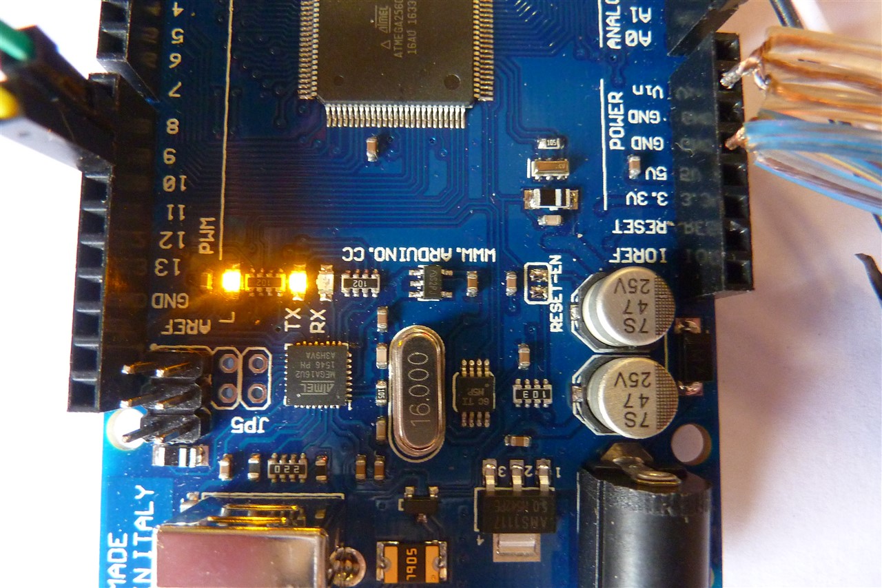

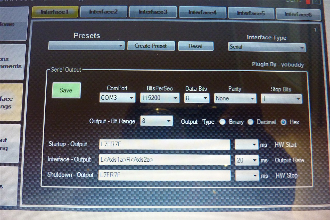

    Yes i have red documentation and faq and all the stuff i found :)

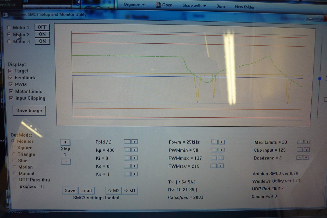

    But i made some progress that i know my hardware works, i tried racingmat's arduino code and it can move motors with pot's. There is only one problem, because i have 2nd motors pot only 1k.
    So i think problem has to be software related ?!
    Few pictures here, interface (com3 works):
    SMC3-util, when i turn pots, i noticed that it did cut 1. motor, but it never turned either motor...
    P1000737.jpg 2.
    tx-rx blinks on Arduino-board:
    How to debug this further ?

    Hmmm, that is not at all what documentation says when working with MM? I'm totally lost here :)
    But changing % at Axis setup does nothing new (i had values there earlier, not when taking pic). I took predefined profiles also with no luck.
    When i start Output test, only RX-led blinks on Arduino, no TX at all (visible to eyes). No movement on motors.
    Should i be able to move motors with SMC3 Util ?
