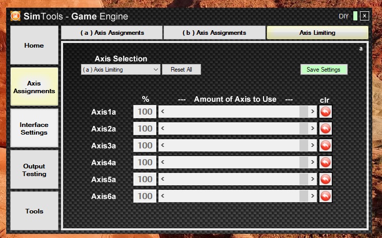

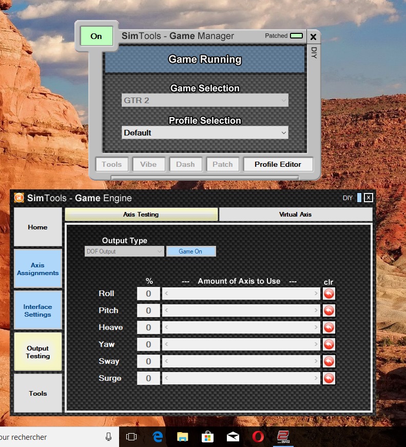

    Hello all, pb wit GTR2, GameEngine do not send data, COULD YOU HELP ME... THANK YOU IN ADVANCE...
    1) I am currently writing arduino code for my Xdof simulator ( https://www.xsimulator.net/community/threads/launching-of-my-6dof-low-cost-dynamic-simulator.11594/ )

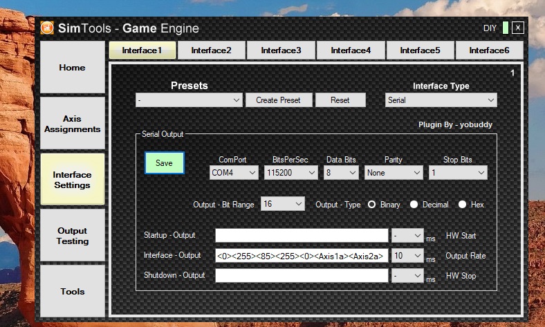

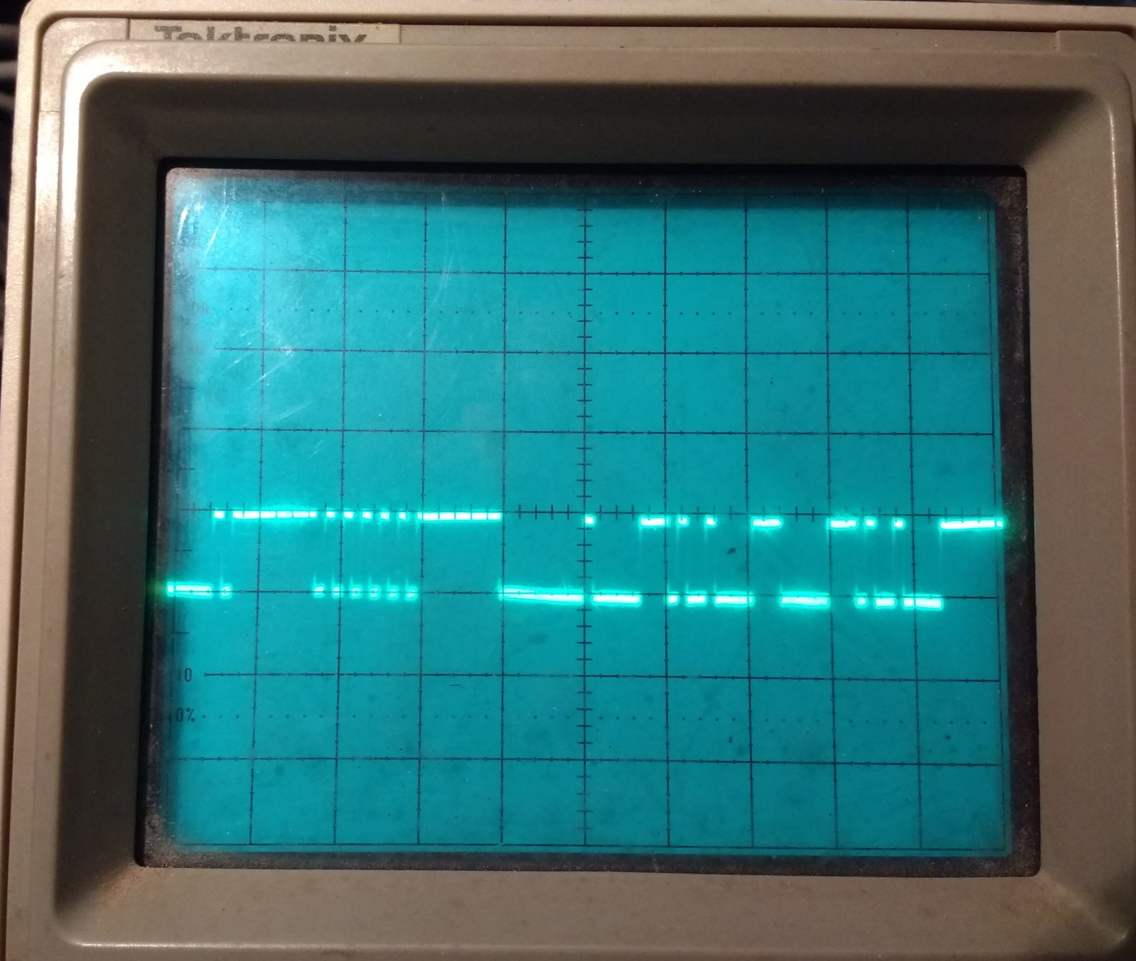

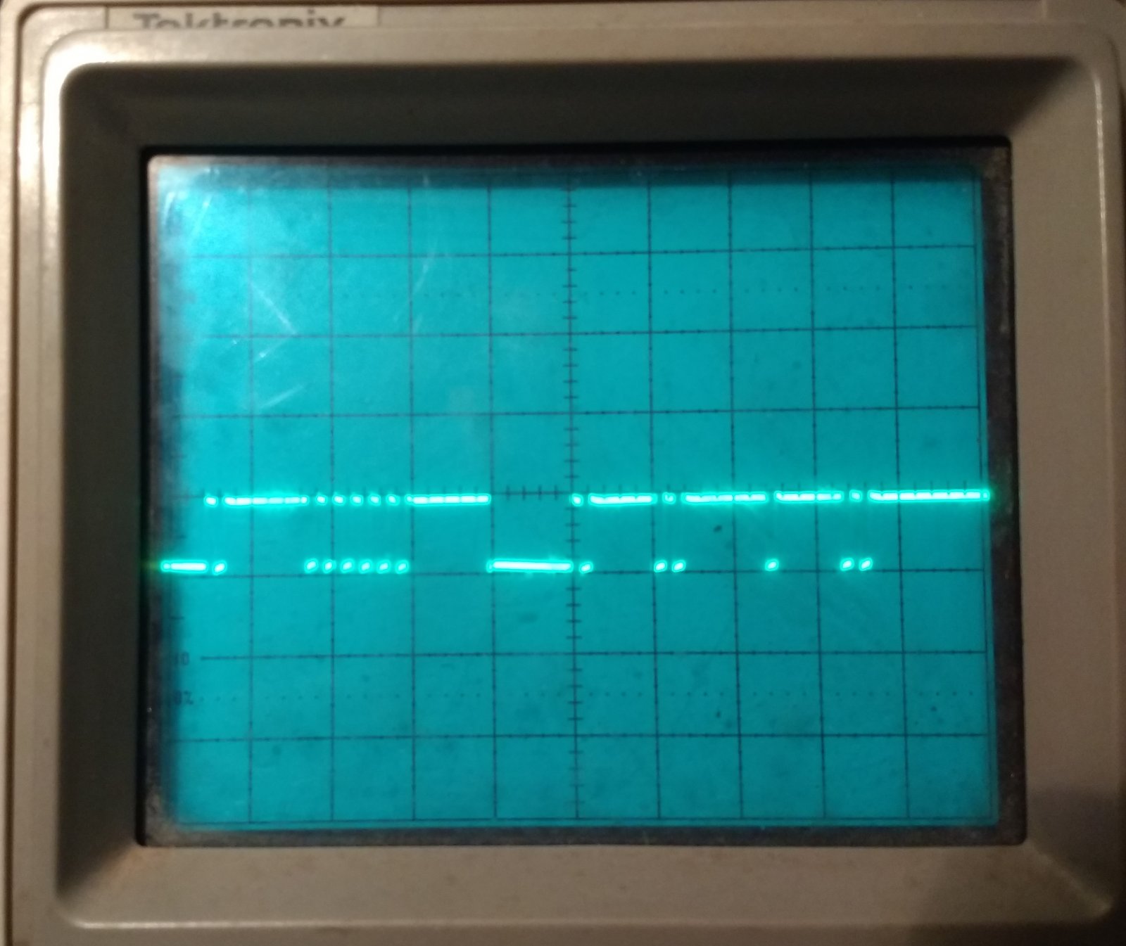

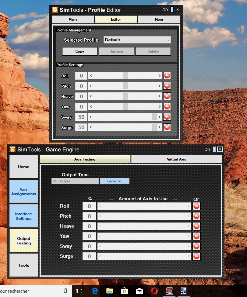

    2) As the code is not finished, I check the data sent by GameEngine with an oscilloscope connected to the pin 0 of arduino board = RX (for information I synchronize the packets with specific 5 bytes: 000,FF,85,FF,00, following by the 2 16 bits axis).

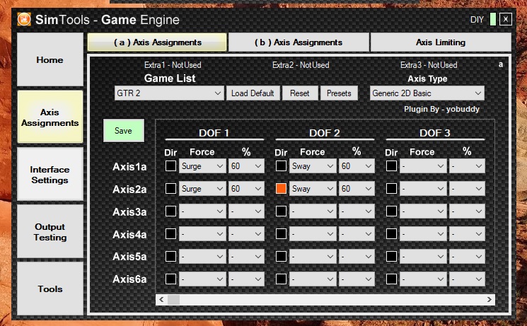

    3) When I test the output with the GameEngine, I can see the 4 last bytes change (see the 2 oscilloscope photos, with surge at 0% then surge at 20%), so game engine configuration seems good (see the 3 screen shots: axis assignement, limiting, and interface setting).

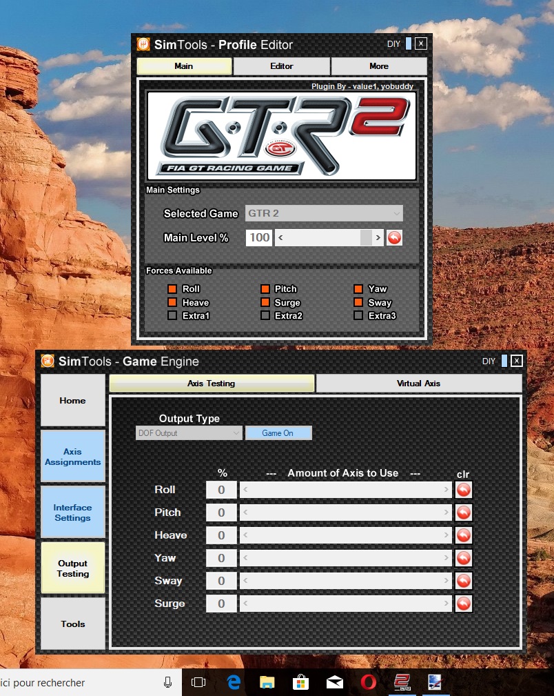

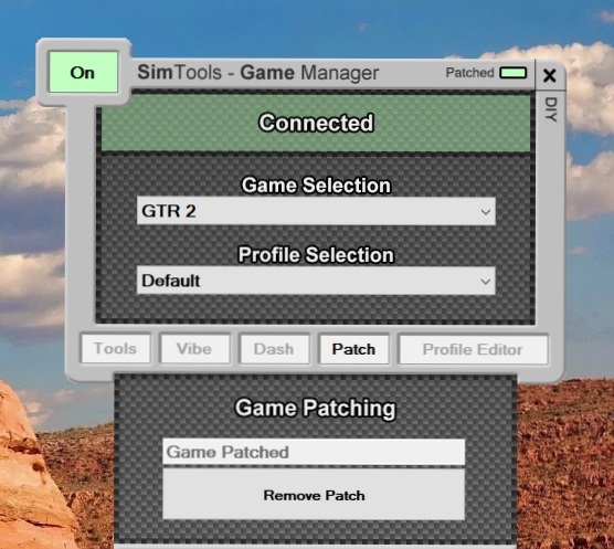

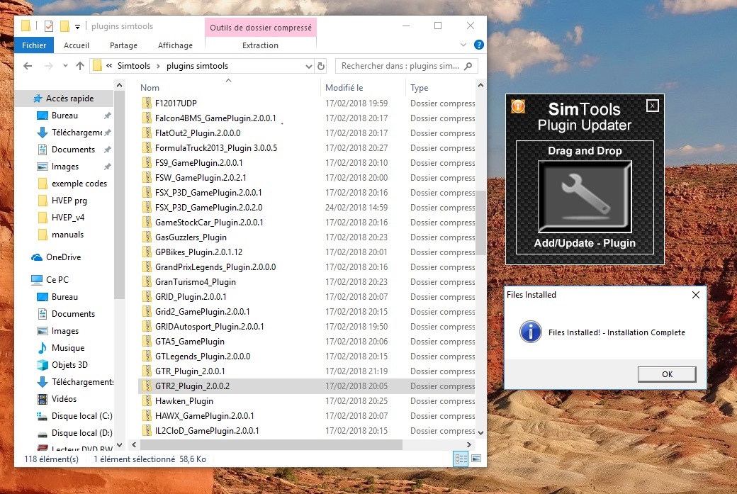

    4) Then I have patched GameManager with GTR2 (GTR2_Plugin_2.0.0.2) doing a drag and drop in the PluginAdapter (no error),
    5) But when I play GTR2, GameEngine seems to send nothing (I can see it with the oscilloscope, the 2 axis surge and sway are stucked to 0% !!). Yet all other things seem OK ( "Game running", background blue, written in GameManager, and "Game On", background blue, written in GameEngine... (see the 2 screen shoots)
    What did I forget to configure ??

    Hello Yobuddy and Noorbeast, I have opened the tunining center values -> no datas received, that confirms what I can see on my oscilloscope.
    N.B: I have tried with rFactor, and it is ok with this game, I can see the data received, in the center tuning and also on my oscilloscope.
    So far, do not understand this bug !!

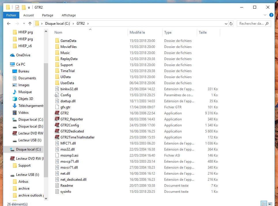

    Well, do you have a line in the file
    …\Steam\SteamApps\common\GTR 2 - FIA GT Racing Game\UserData\<yourname>\<yourname>.PLR reading
    Write Shared Memory="1" // Write game data to shared memory area

    I am using a dvd game

    but I have found my name.plr, i will try

    Well, then check in the fiel C:\GTR2\UserData\<yourname>\<yourname>.PLR
  13. Oms
    Oms known as "Doc6dof"
    May 30, 2017
    93
    France Colomiers
    - 177Coins
    +37 / 0 / -0
    DC motor, AC motor, Arduino, Motion platform
    You are a champion Nerd, THAT IS RUNNING !!!!! thanks thanks thanks
