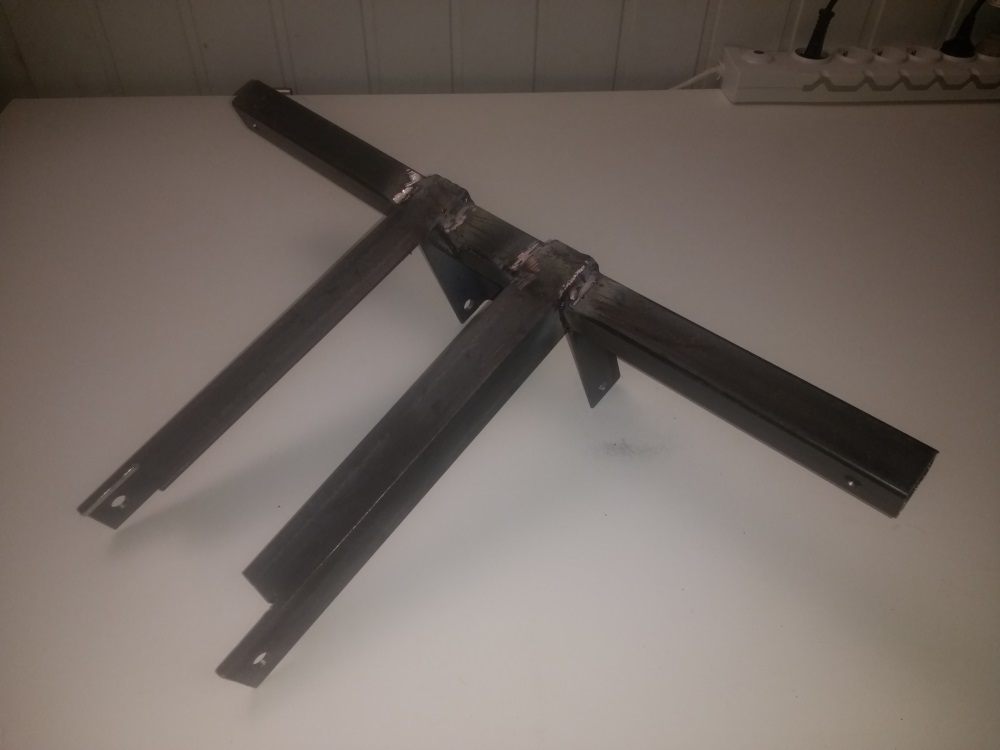

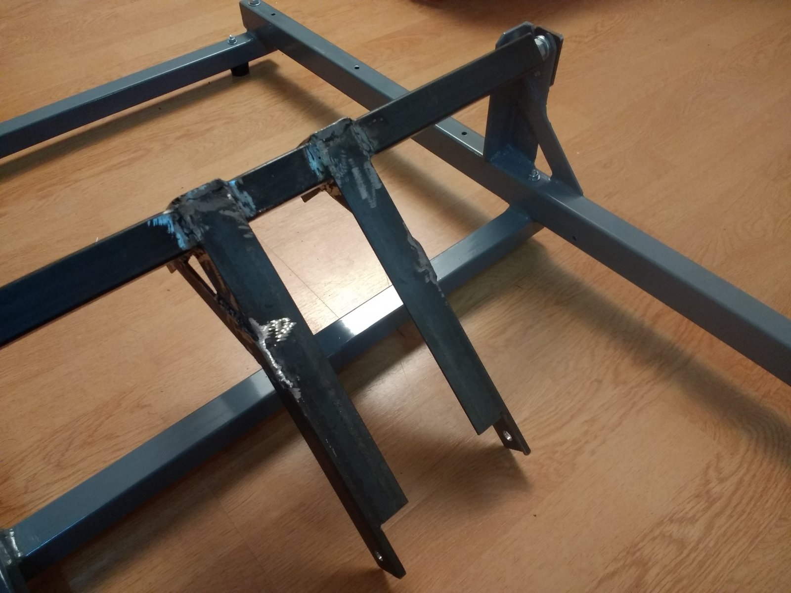

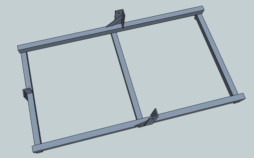

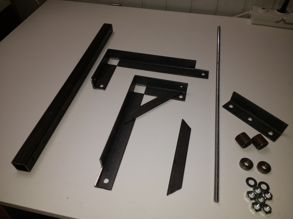

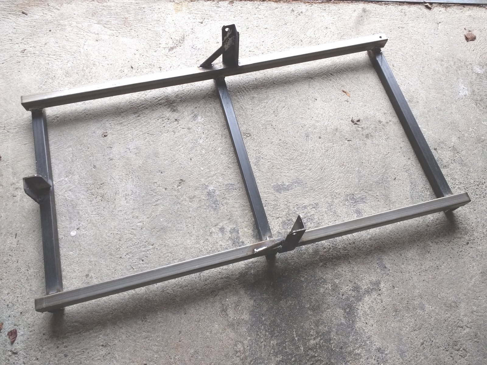

    From drawing to reality: I had some availability this week-end, so here after a first component (base of the cockpit)...

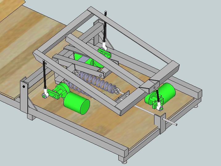

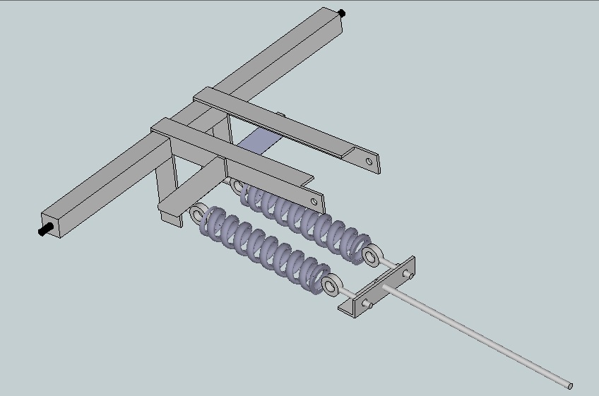

    Hello all,
    I am available this afternoon, so I will make the seat pivot, which is a part of the seat mechanism, then I will send you photos by this evening...

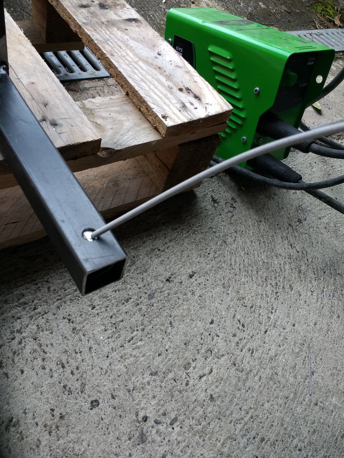

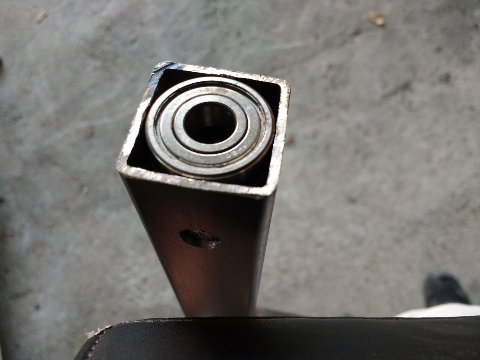

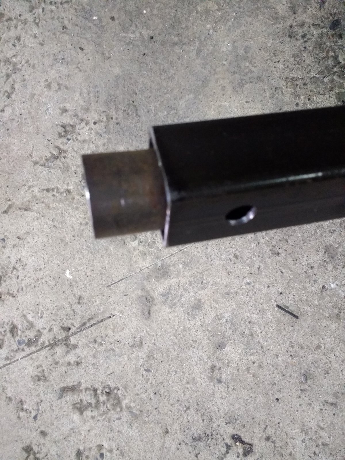

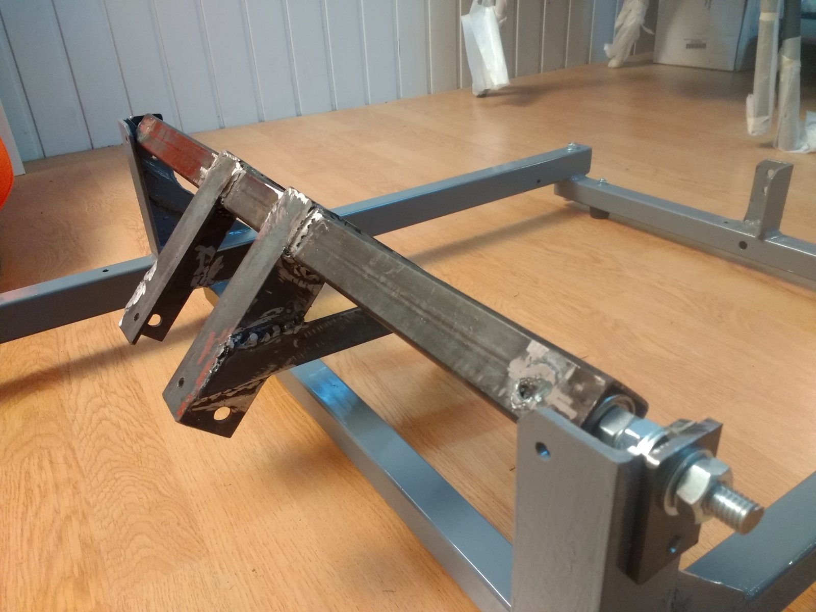

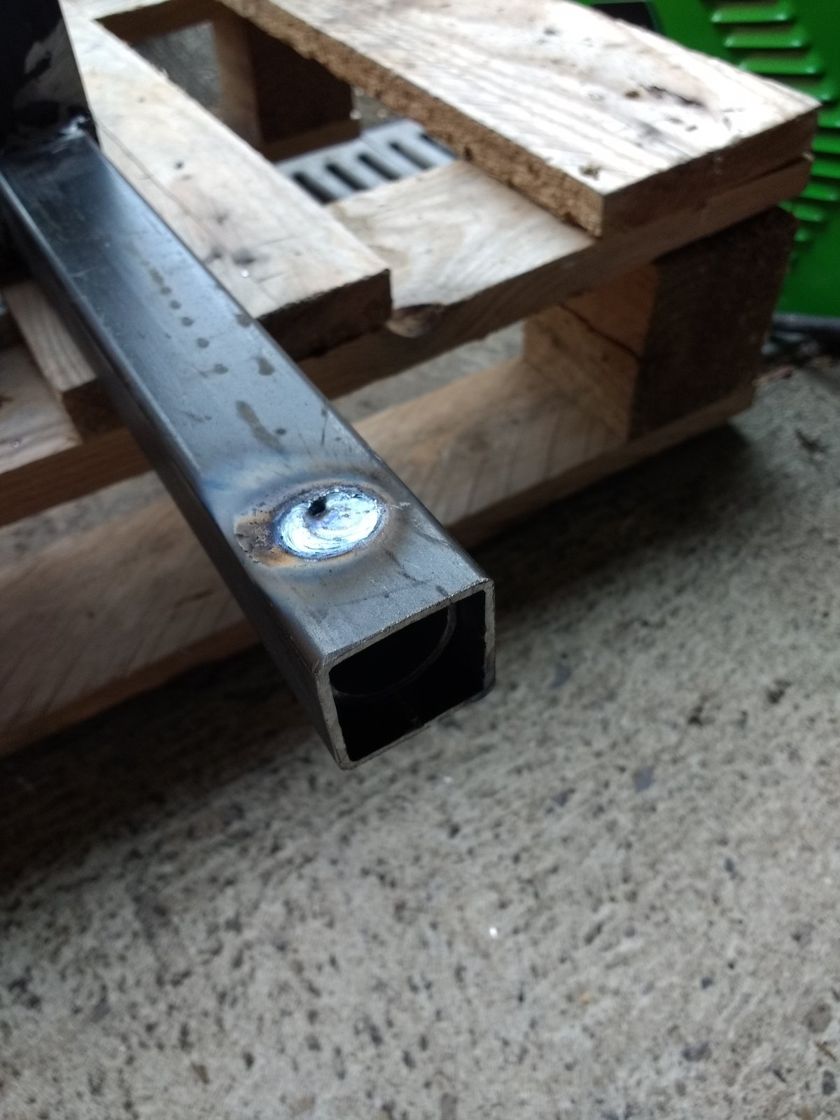

    Hi, I have well progressed on the seat pivot, but no finished...

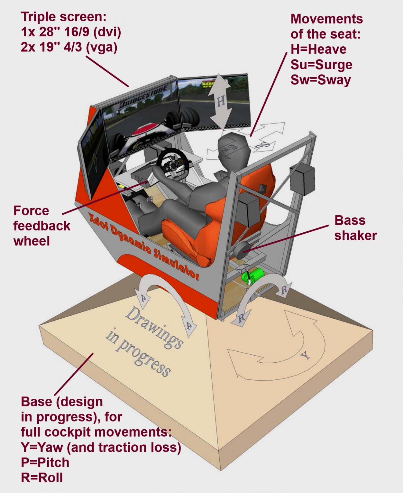

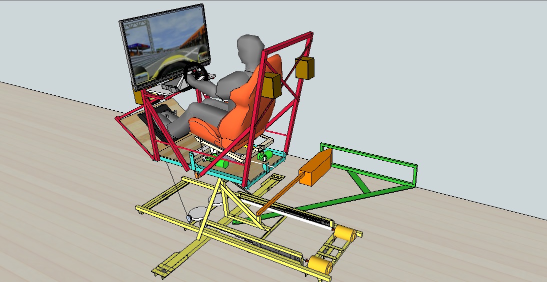

    Hello all,
    some news, the design is changing (version 2 ). Mainly the base (to provide large movements pitch, roll, yaw-traction loss) is rethinking : use of 220v monophasis hoist (my concern is how to control the speed of asynchronus motors). I have also decided to implement a triple head. The first test with a gt1060 6g overclocked and rfactor are very good (I paid the 2 19'' 4/3 screens 25 euros each one...),
    see you...

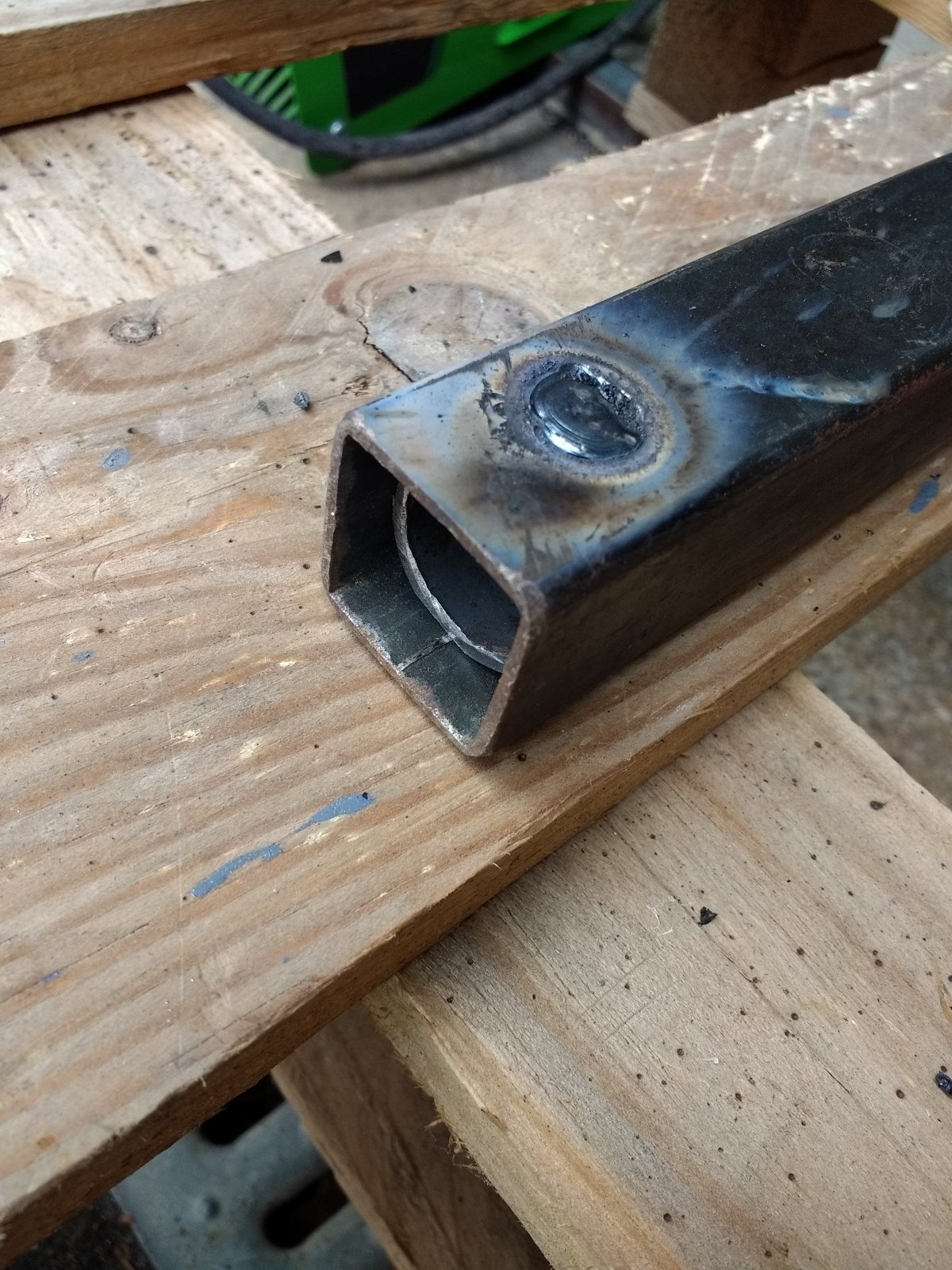

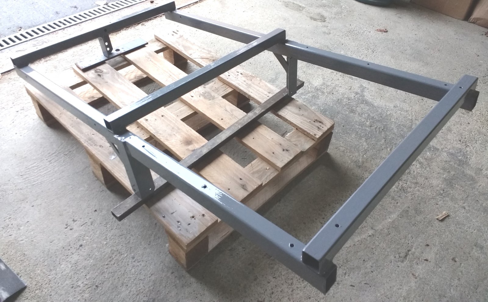

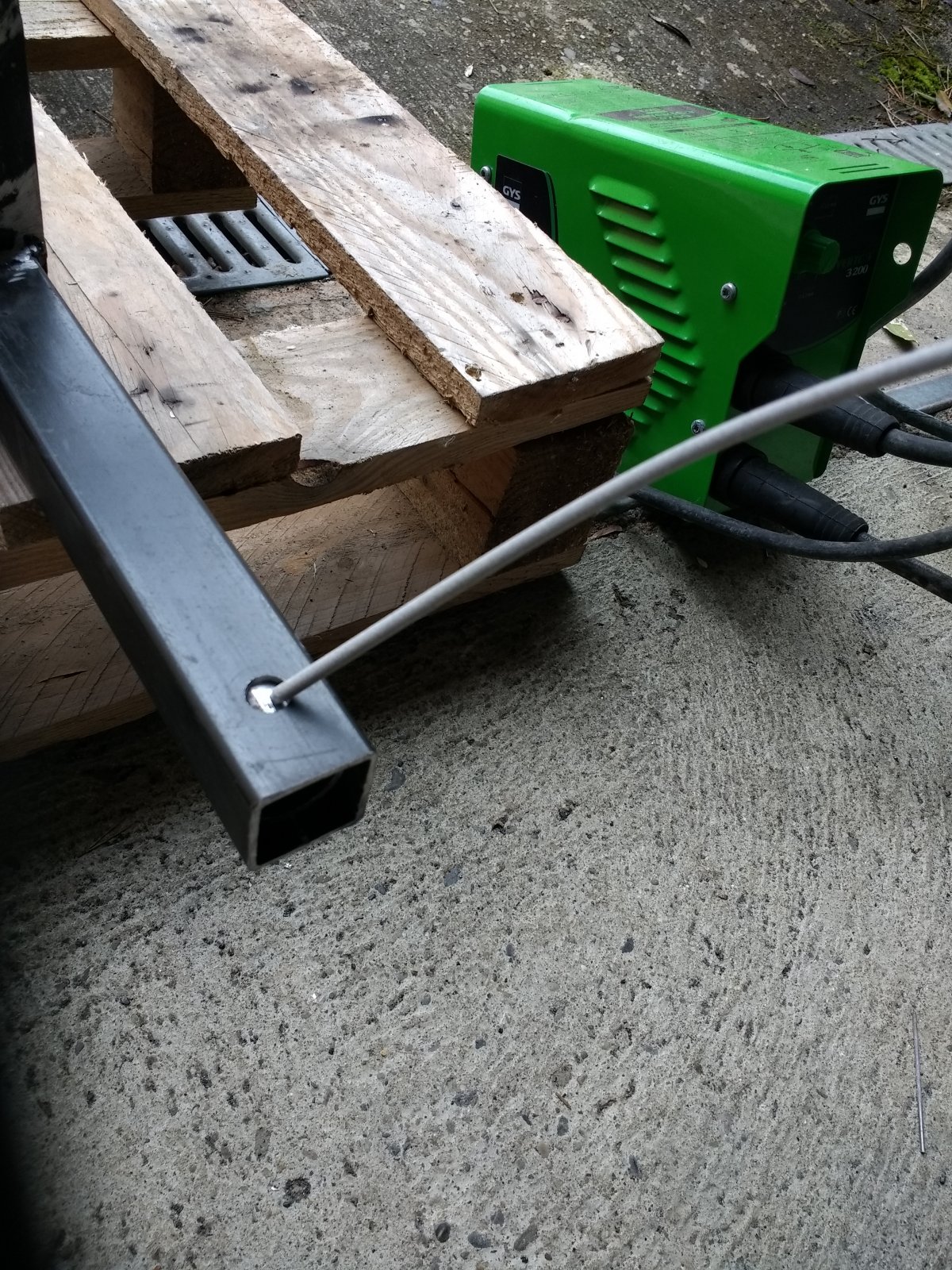

    Hello DYI men/women,
    little by little my Xdof dynamic simulator takes shape, here after the last photos ...
