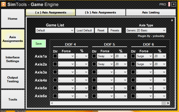

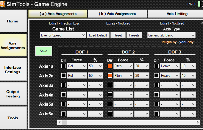

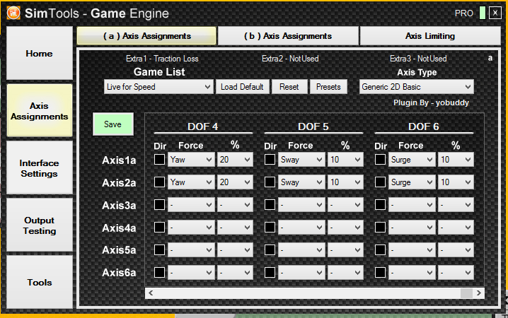

    It works with Live for Speed demo, my seat dynamics is responding. Thanks Noorbeast, for your suggestion. Pls. find the screenshot of axis assignments. Further any suggestions, pls. tell me.
    22,032
    153,788Coins
    +11,150 / 57 / -2
    You don't need yaw for a race sim @Prabin Kumar Jha and deleting that brings your total allocations to what they should be, around 100% total: https://www.xsimulator.net/community/faq/axis-assignment-percentage-totals.120/
    Your DIR settings in Axis Assignments look a bit odd and likely the value for sway should be increased and the value for roll decreased but it is hard to be sure unless there is a video of the rig moving that also shows the game screen at the same time.

    Thanks Noorbeast for suggestion, I will share video with you, once I fix steering wheel setting with this game and also change the value in axis allocations as suggested.
    It was first trail just to run the seat dynamics, now it will be fine tune needed.

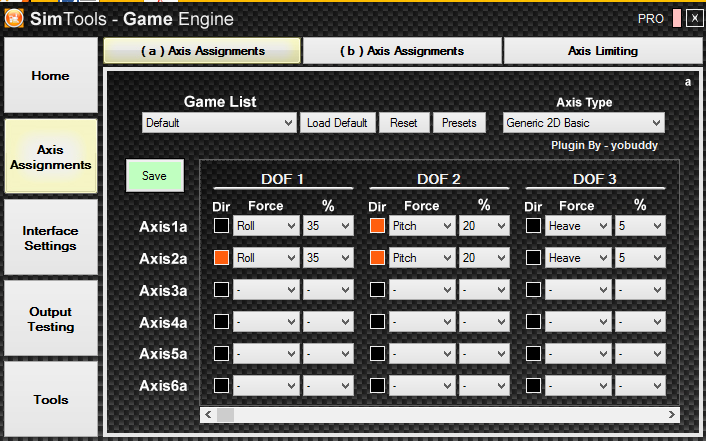

    Shaft of one of motors was broken down. Now it is repaired and tried to send the video but due to size limit of file, I could not upload it. Is there any other way to send it to you? please inform me.
    Axis allocation of current settings:
    I have quarries:
    1. I want to log the date of roll, pitch, yaw, heave, sway and surge during the game running. Is this possible? What I have to do?
    2. I wish to interface the game model with Matlab/Simulink to check the dynamic performances.
    3. Instead of code, I want a model in simulink to run the motor as it was done in smc3, is this possible?
    Please reply on these quarries.
