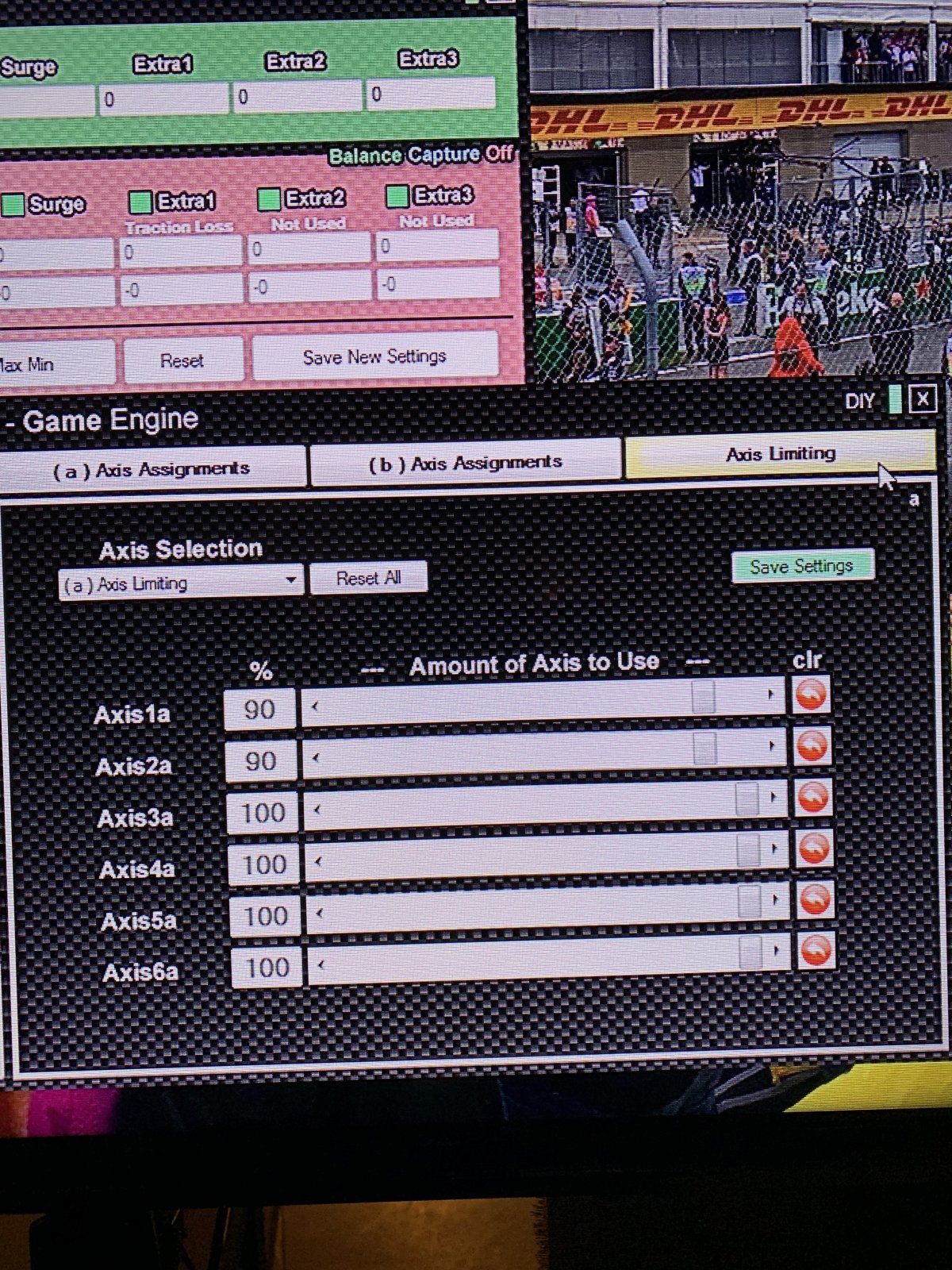

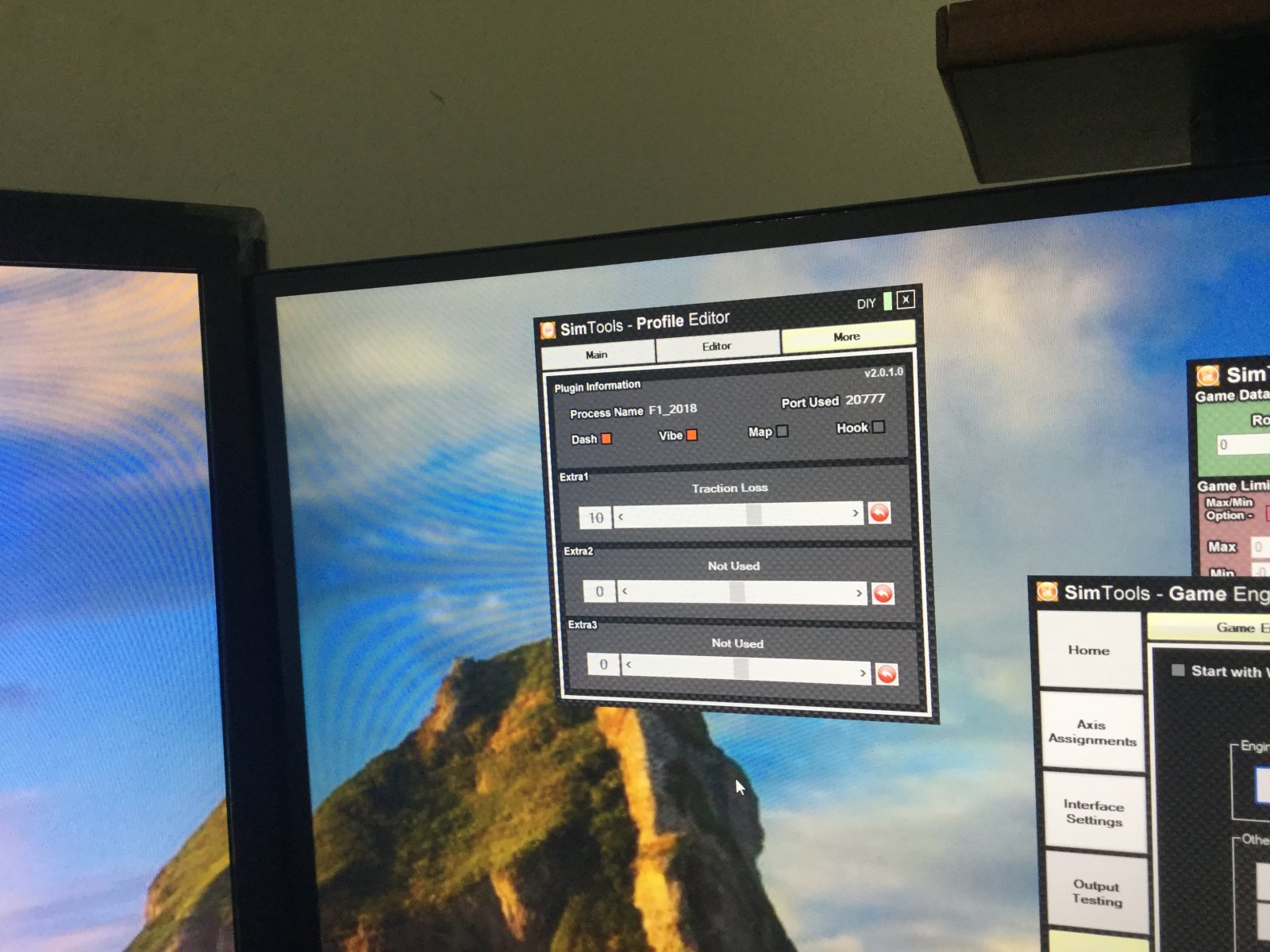

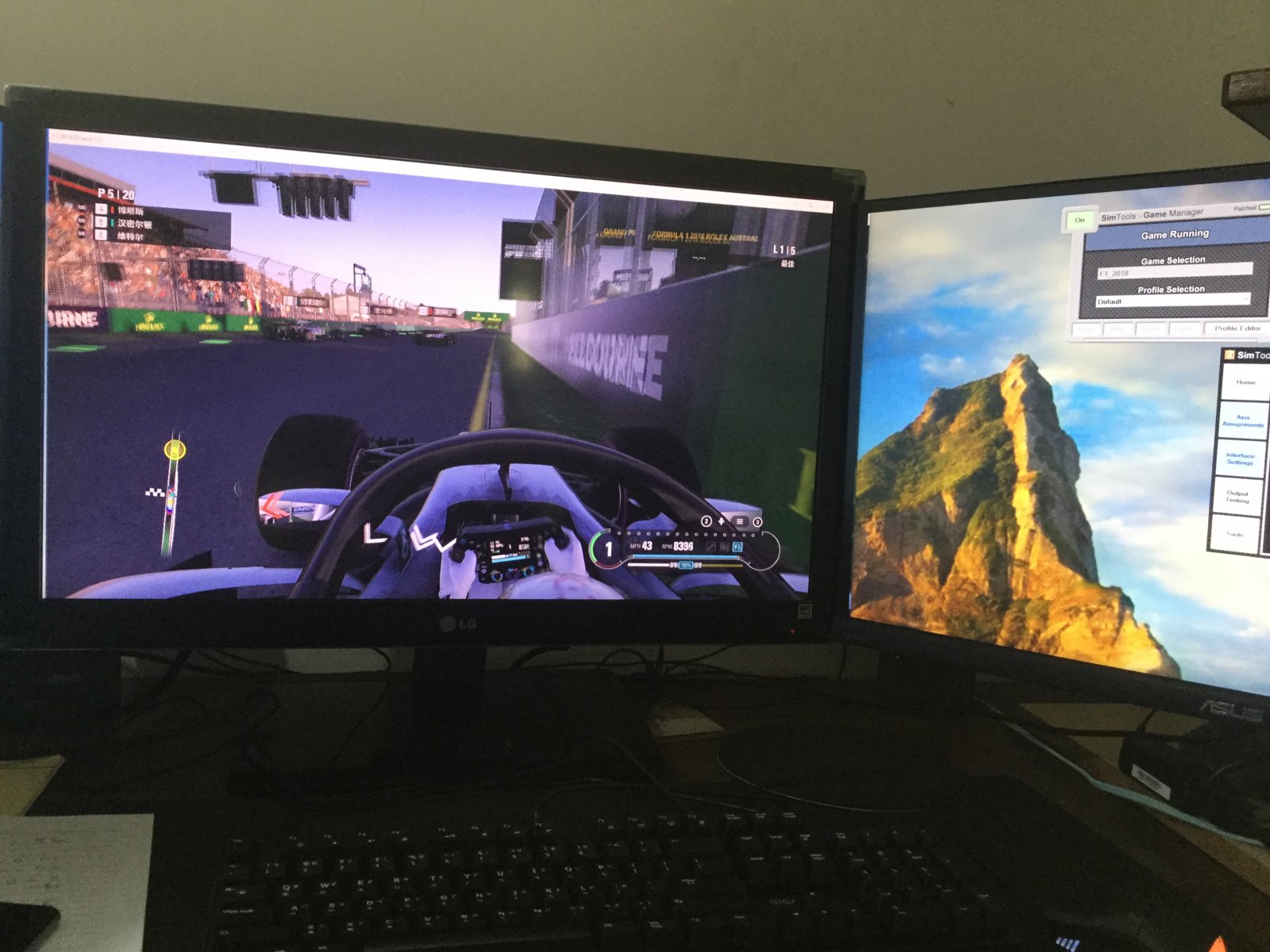

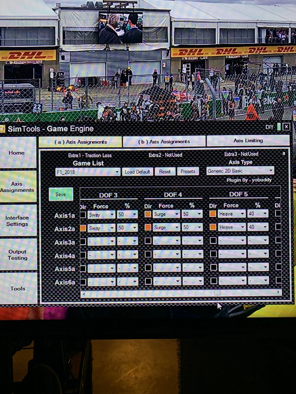

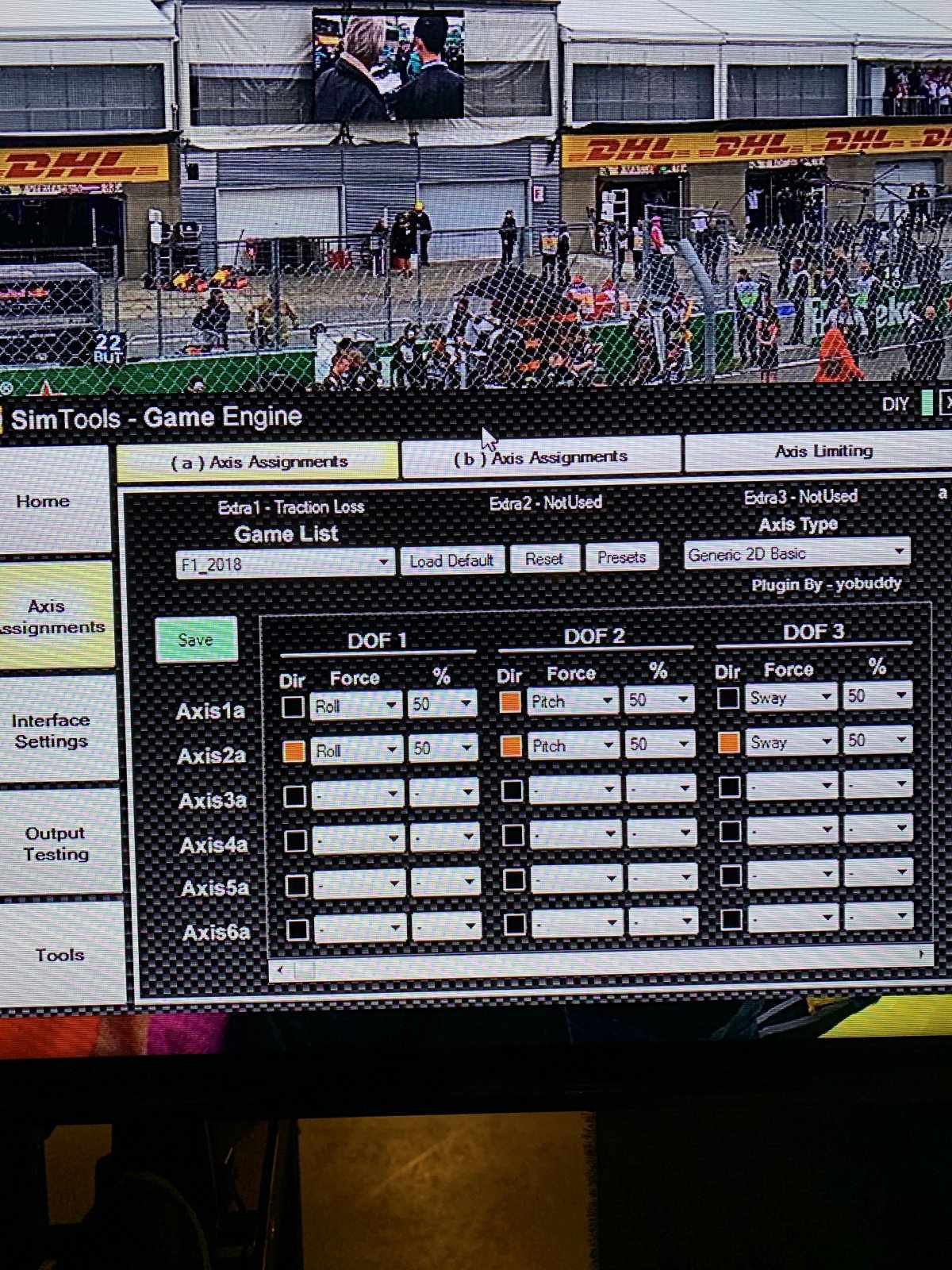

    Hello all,
    I’m new to Simtools after running F1 2016 on X-Sim problem-free for the past 2 years. When I just bought F1 2018 last week, I could not produce motion with the X-Sim software. My friend who built my simulator recommended I get Simtools, as it is a better and more user-friendly software.
    Unfortunately I have not yet been able to produce movements with the Simtools software yet either, in either 2016 or 2018.
    My friend has been trying to help me troubleshoot via TeamViewer for a few days to no avail. With the same settings on each of our Simtools engines and essentially the same rig, he can play F1 2018 just fine on his end. Mine produces no movement. ** It should be noted that Assetto Corsa produced movement with Simtools the very first time I fired it up. ** However, the only reason I have a simulator is to play F1 games, so no other game matters to me.

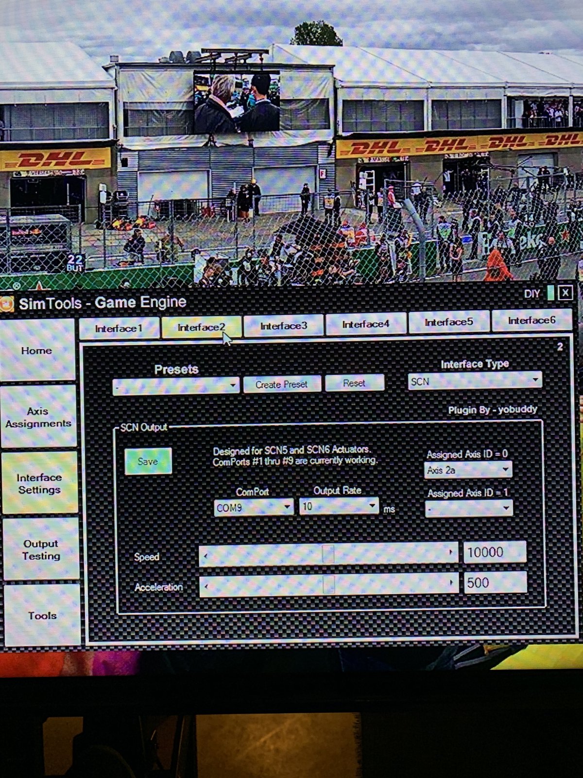

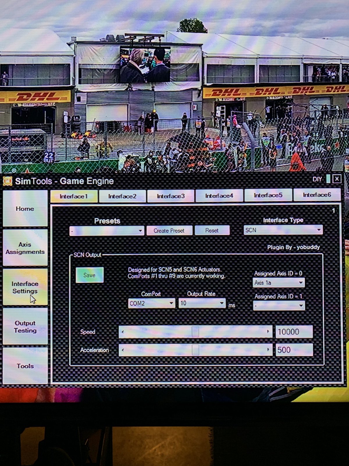

    When I run the Output Test, all the axes produce proper motion, so there is communication between the software and hardware, as also evidenced by Assetto Corsa functioning properly.
    I am running on Windows 7 professional. We have tried turning off the Windows firewall and allowing all Simtools and F1 programs through the Avast anti-virus, to no avail.

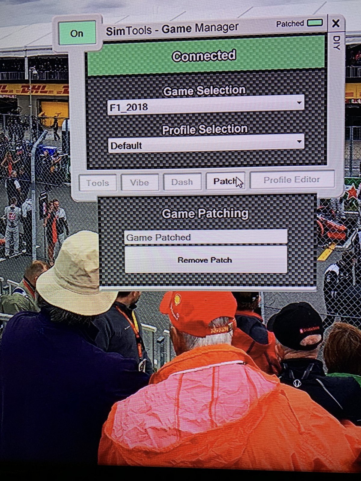

    As suggested elsewhere, I have also tried unpatching the game, completing a short race, and repatching. Still nothing.

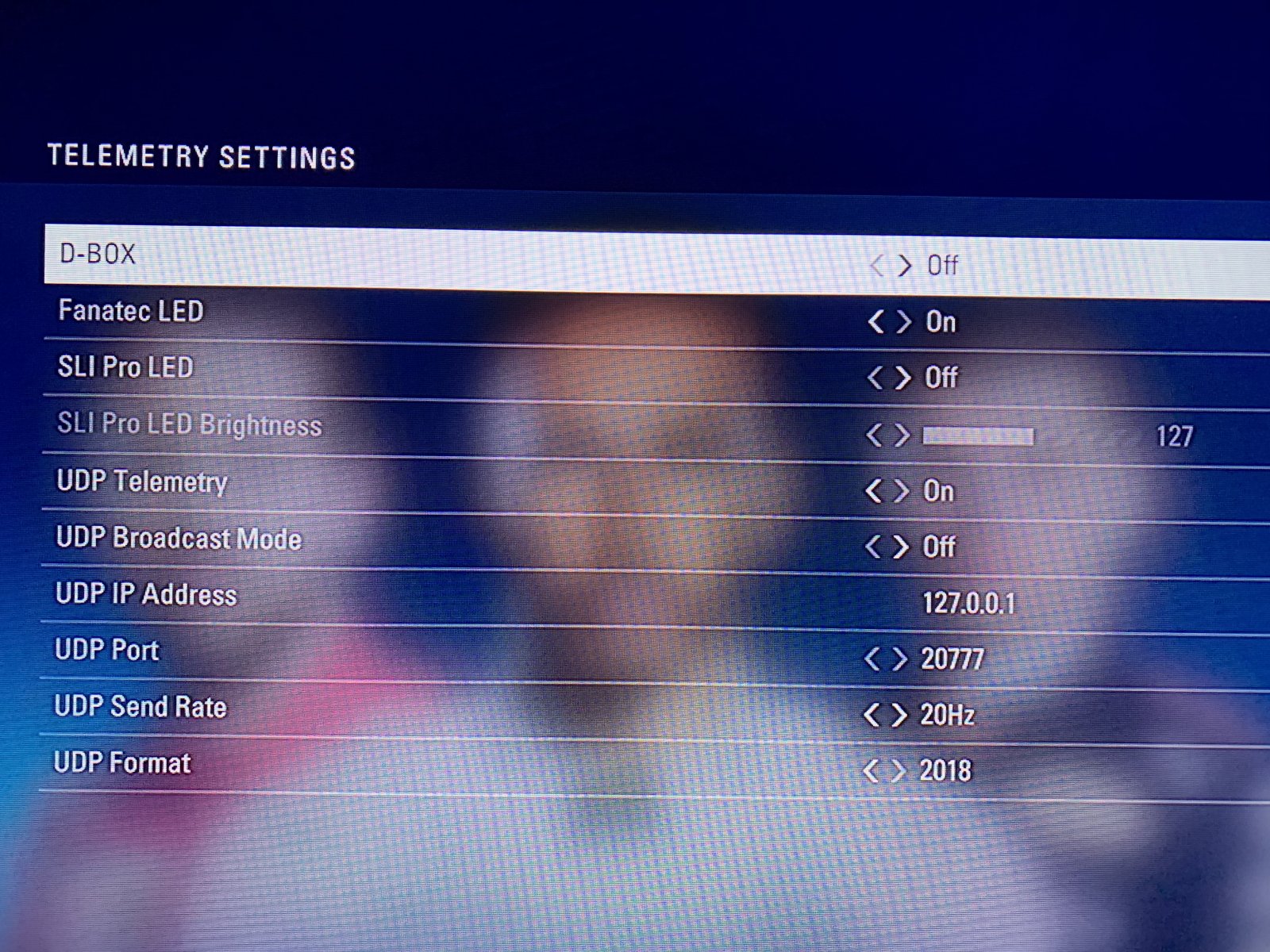

    UPD Telemetry is ON in both 2018 and 2016. I had tried both D-Box on and off, as well and UDP Broadast mode both on and off. Nothing changes.
    Very frustrating, needless to say.
    I’ve included pics of the axes assignments, Interface settings, game telemetry settings, etc.
    Any other info that could be helpful to assist in troubleshooting, feel free to ask! I’m not very tech savvy, but I’m learning as I go!
    Thank you,
    Jeremy

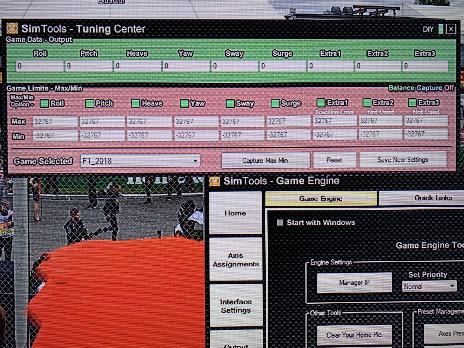

    In the pic I can see that you have no Max/Min settings for F1 2018.
    Without them, you will get no motion.
    How did you install the plugin?
    Also, please goto axis assignments and load the Simforce GT preset.
    (It should be a good setup for you system.)
    Here is the current manual, it will help you capture min/max settings for the game.
    https://www.xsimulator.net/community/threads/official-simtools-user-manual.12424/

    If you see in one of the pictures above that, there are indeed min/max values captured for F1 2018. They are all 32767/-32767 across the board. The other picture that shows zeros was taken out of sequence. So if those values are indeed set, where do I look next?
    I installed the plugin by drag n’ dropping the file from the download folder to the Simtools plugin tool.
    Thoughts?

    The proper sequence to capture Max/Min is click capture max/min, reset all, drive for a while at about 80% race pace, without hitting anything, then back in Tuning Center Save then finally stop capture.
  5. yobuddy
    5,374
    50,288Coins
    +5,148 / 18 / -0
    The values 32767/-32767 are the defaults when a game has no settings.
    These values are so high that I would expect little to no output when the game it running.
    The sequence Noorbeast mentions above must be completed for you to get output.

    The game has no default Max / Min file installed.
    So one gets created for it with very high values so the game is ready for tuning.

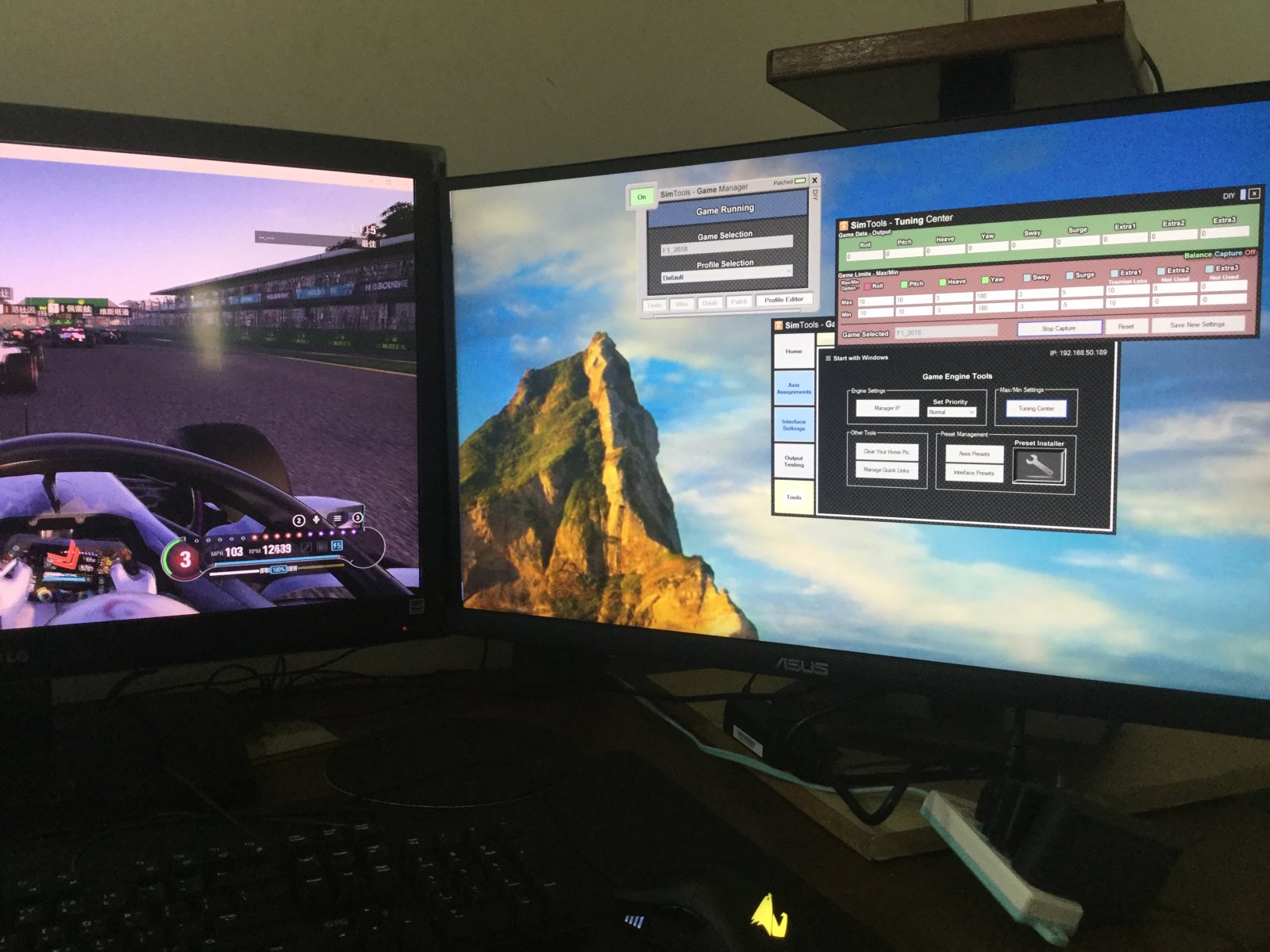

    E84F58E5-1095-4F27-B5EC-E42426173641.jpeg 2B373DEA-4DF7-4284-AAC8-ACD3E1B5645B.jpeg
    As you can see, there is no motion as I run F1 2018. Tuning Center can’t capture ay max or min data.

    Un-Patch the game.
    Then launch the game and complete a race.
    Then Re-Patch the game and try again buddy.
    All codemaster games (and LFS too) require us to complete a race before patching.
    Take care,
  16. Fu Chuanhsun
    Fu Chuanhsun New Member Gold Contributor
    Jan 1, 2019
    20
    - 205Coins
    Thanks, it works. It is moving now. I just wonder why not mentioning this message in the plugin.

    Forget one thing, if I don’t set the telemetry setting 『on 』in the option, there will be no motion.
  18. yobuddy
    5,374
    50,288Coins
    +5,148 / 18 / -0
    Yes, this is by design.
