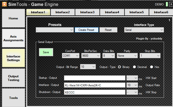

    Hi
    I've installed SIM TOOLS without license and LFS for testing.
    I've read already lot of informations and I believe it's enough to make first tries... but not sure.
    For now, the SIMUKIT arduino is connected and when I do "output testing" the both 2DOF motors do always the same move. There is something I do bad....

    Perhaps from these screenshot somebody could find a bug in the setup... :)

    Whatever I put in the "output testing", the two motors always do the same move... even if I put no entries at all.
    And it apply when I click from 'turn on' to 'turn off', but I suppose it's the normal behavior of this button...

    Also I had to dis-engage the potentiometers from the motors and turn them a bit. Without that nothing was moving... well still a bit lost but not say my last word :)

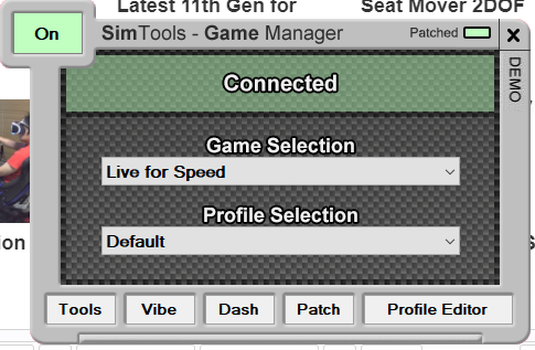

    I did a run in practice mode (first person = cockpit view I presume?), but didn't see I had to patch.... I do a try... (but do I need to download the patch? I beleived it was free for testing..?)

    Perfect with Axis1a setting I've finally the two motors working fine ! Thanks a lot.

    Ahaaaah It's now working with LFS ! Great!
    Need now to play with the strenght of the settings... happy :D

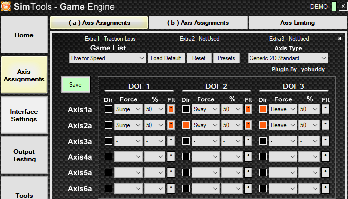

    It's slowly improving...

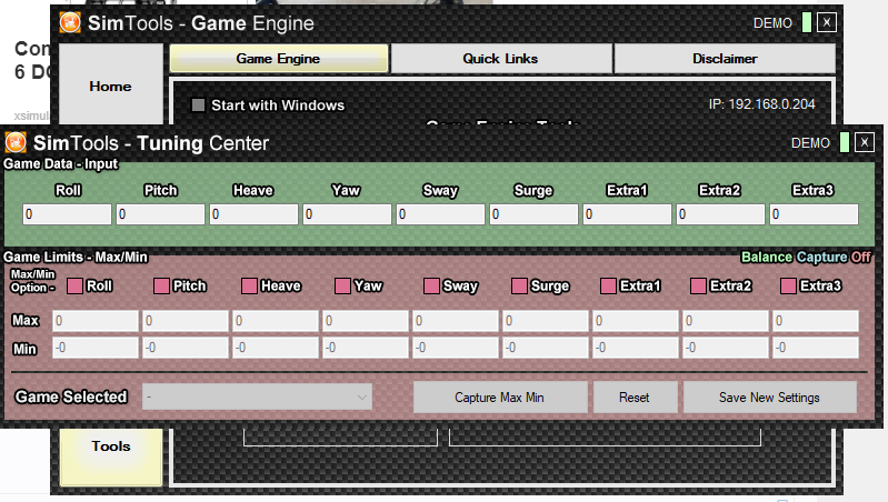

    If I feel the acceleration is too hard versus the deceleration. As I only can up/down the %surge for these 2 effect together, how could I push just the braking but not acceleration?
    21,914
    153,095Coins
    +11,117 / 56 / -2
    In the Tuning Center you can manually set Max and Min with different values, which will give a sharper response in the direction of the smaller value, over a shorter range, and a gentler response for the larger value over a bigger range. Differentiating the Min and Max values is often used to also simulate gear changes: https://www.xsimulator.net/community/faq/snappy-gear-change-motion.121/

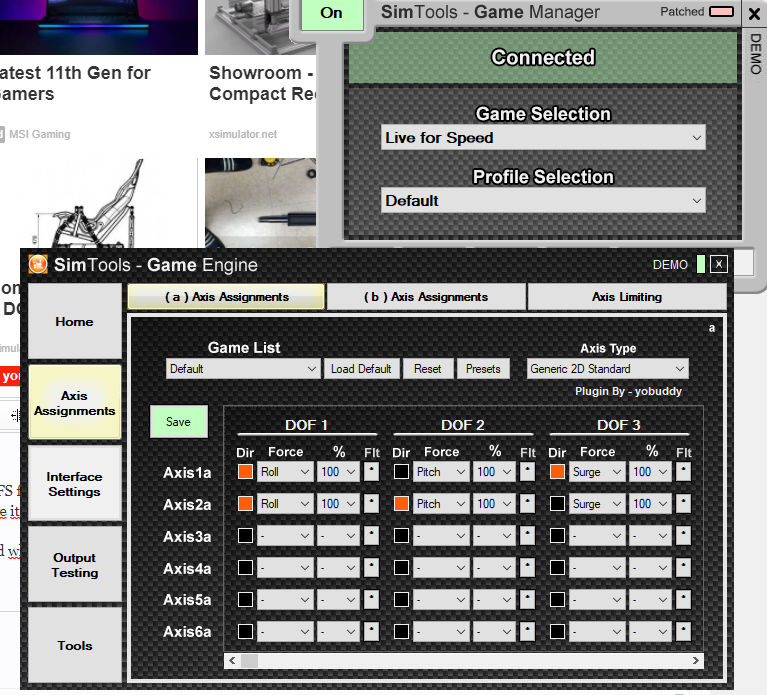

    And for the overall balance between for example surge/sway/heave, will I have the same behavior if I put 50%/50%/50% VS 30%/30%/30%? I presume but to be sure to well understand the system...

    I talk about the % in axis assignment like on the screenshot..

    See both the SimTools Manual and the FAQs, for a 2DOF the total of all allocations should add up to around 100%, in practice you can go a little over as all axis are unlikely to be at their extreme except in a crash: https://www.xsimulator.net/community/faq/axis-assignment-percentage-totals.120/
    Use the motion profile tuning tips in the FAQ to help determine how much % you add for each axis, initially refining each individually: https://www.xsimulator.net/community/faq/steps-to-create-a-motion-profile.228/
