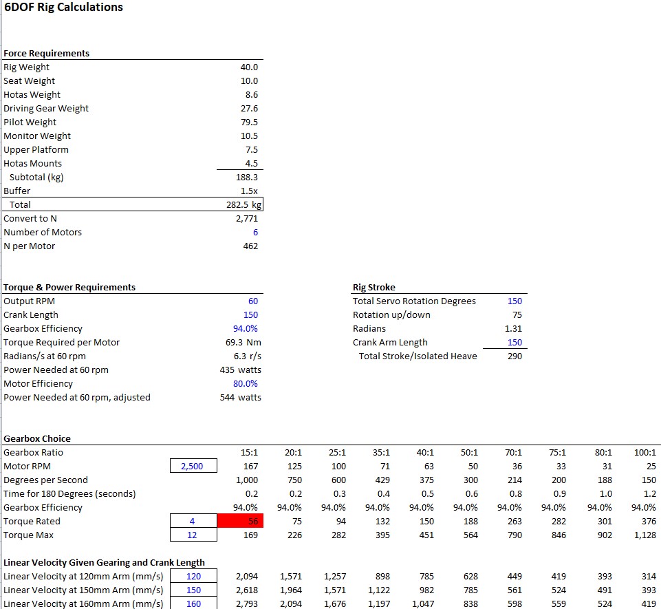

    A bit of an update.
    Spent the last couple of weeks researching and trying to learn how to use CAD software.
    I think I have settled on some of my basic design parameters. I am going to build a radiating, crank arm 6DOF platform with a steel base similar to the Grigory build but with extending support legs.
    The rig will be built with 80/20 or similar t-slot extruded aluminum. Likely using 40mm x 40mm profiles. I also looked into 1.5”x1.5” profile, would be a bit cheaper and about 4-5kg lighter than the 40mm profiles, at the expense of stiffness.
    Motor: LiCHUAN 90ST-M04025. 1kw, 4Nm, 2500RPM.
    Gearing: LiCHUAN PLF90. Ratio undecided, see below.
    Controller: Thanos AMC-AASD15A
    Open questions:
    - The upper platform diameter is to be determined, but I am going to size it so that I can achieve pitch/roll in the 20-25 degree range.
    - How much linear velocity should I be targeting? I have seen some posts that mention 250-300mm/s as ideal. Want to confirm that linear velocity is taken at the end of the crank arm? As mentioned, I will be using this rig for dynamic flight sim and driving sims.
    - Gearbox choice. My calculations are below, but I think that given the motor choice and rig weight, I have a lot of leeway in gearing choice. The gearbox specs show 94% efficiency, is that realistic? Curios what the folks who have completed a build would choose for gearing in this case.
    - Assuming my calculations on linear velocity are correct (they seem high) and the setup is not torque constrained, is there a preference for choosing torque or velocity? Will I be able to use firmware/software to slow down a rig that is too fast or jerky while maintaining torque? Or is it preferable to have less velocity and more torque? I will have several bolt holes in the crank arms, so I should be able to make additional adjustments there.
    Is there any reason that I should not bolt the supporting rods directly to the rig chassis? I was thinking of adding two side “wings” to the rig chassis to complete a virtual or inline upper platform anchored at the base. The alternative is to attach the chassis to a steel upper platform, similar to the Nisch build.
    Overall, having fun with this. Pretty sure the motors are overkill at this point, but want to build in some extra margin, as I can see this thing evolving over time...those G-Seats look pretty cool ;)
    Thanks again for the help

  8. Thanos
    Jul 6, 2017
    1,371
    Electronics Engineer
    United States
    2,854Coins
    +1,071 / 9 / -0
    50:1 gearbox will provide a good balance between speed and load ability. You can always slow down the max speed (max RPM parameters in the AASD-15A servo drives).
    This 6dof has 50:1 gearboxes for example:

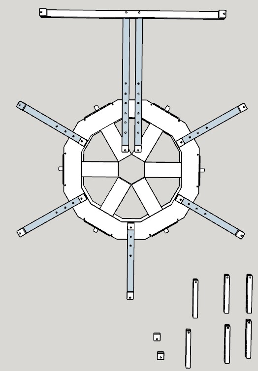

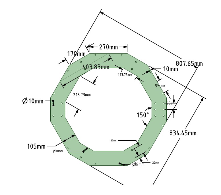

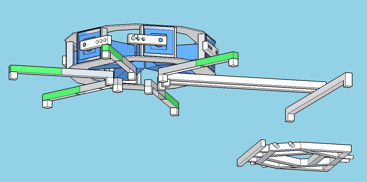

    Think I am getting close to finalizing my upper platform design. I am probably going to use a steel upper platform with some 8020 extruded aluminum for the steering wheel mount and monitor mount using this build as a model:
    I have a question about mounting points and how they impact the performance of the 6DOF rig. The ideal mounting points for the upper rods straddle points A1, A2 and A3. However, given space constraints with the main rails, I won’t have enough room straddle A2 and A3. If I mount at A1, B2 and B3, (non-equilateral triangle) will that cause motion/calculation issues? I am guessing that B2 and B3 will be offset about 1” (25.4mm) from A2 and A3. Alternatively, I can build a little tail and mount on the equilateral triangle B1,B2,B3.

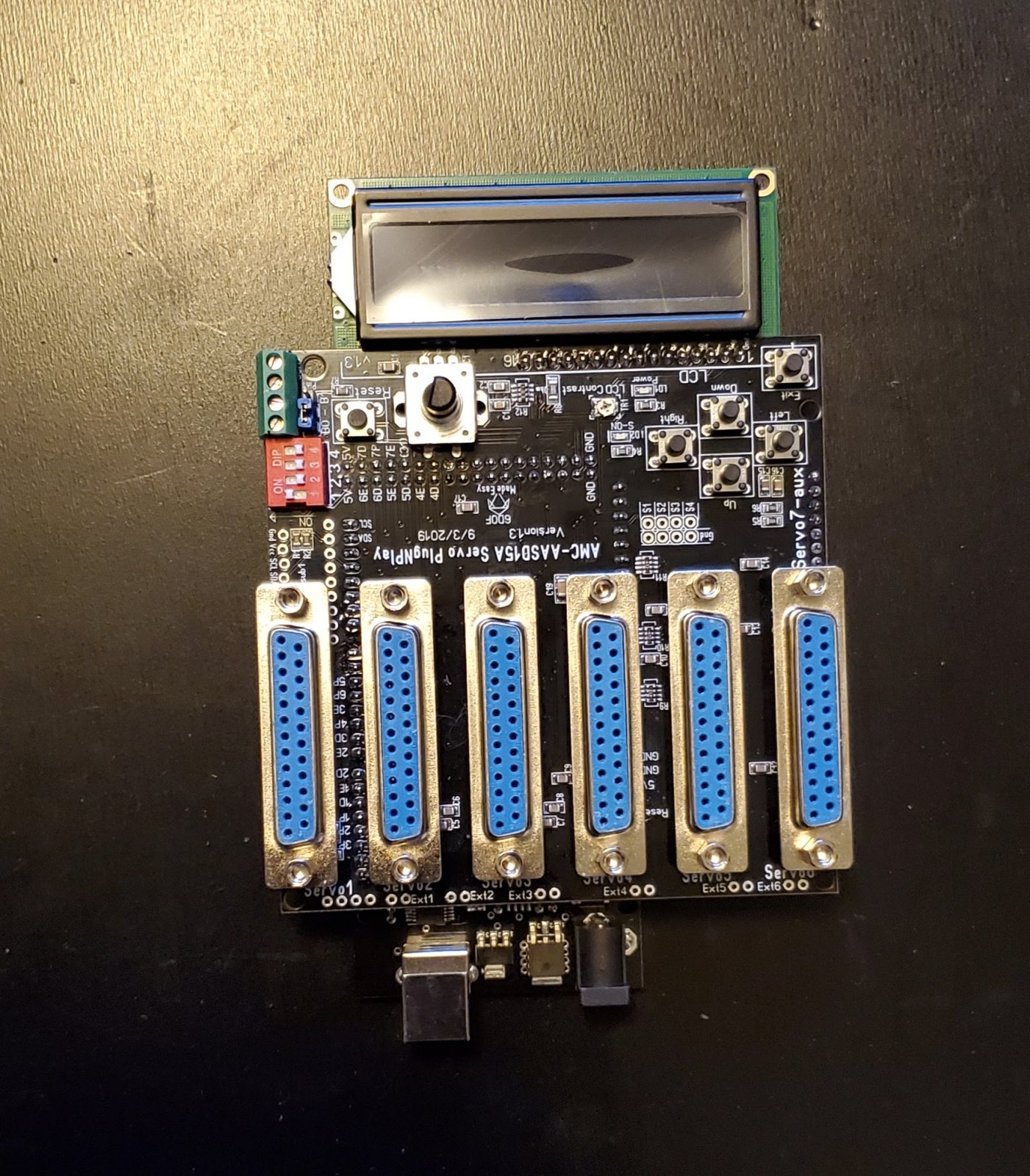

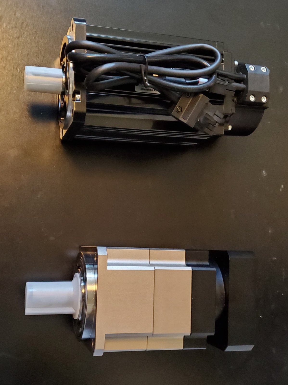

    Received the Thanos controller in the mail this week (Thanks again, Thanos).
    Servos and gearboxes are inbound.
    Controller case is being printed as we speak: https://www.twitch.tv/twitchtvleech (FYI, the guy printing my case can give advice on printing, settings, etc., but his print queue is full and he cannot accept any additional work).
    Still have a lot of decisions to make, but at least the parts are moving.

    Even more goodies showed up on the doorstep today.

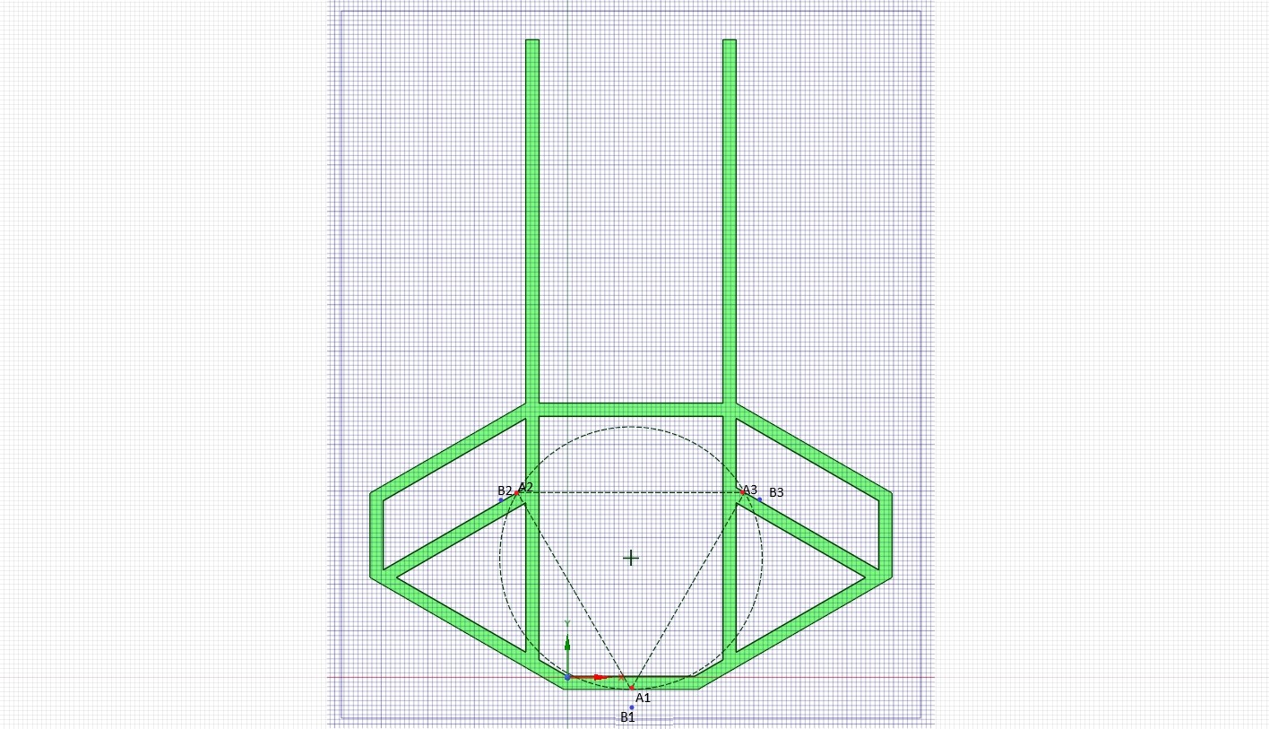

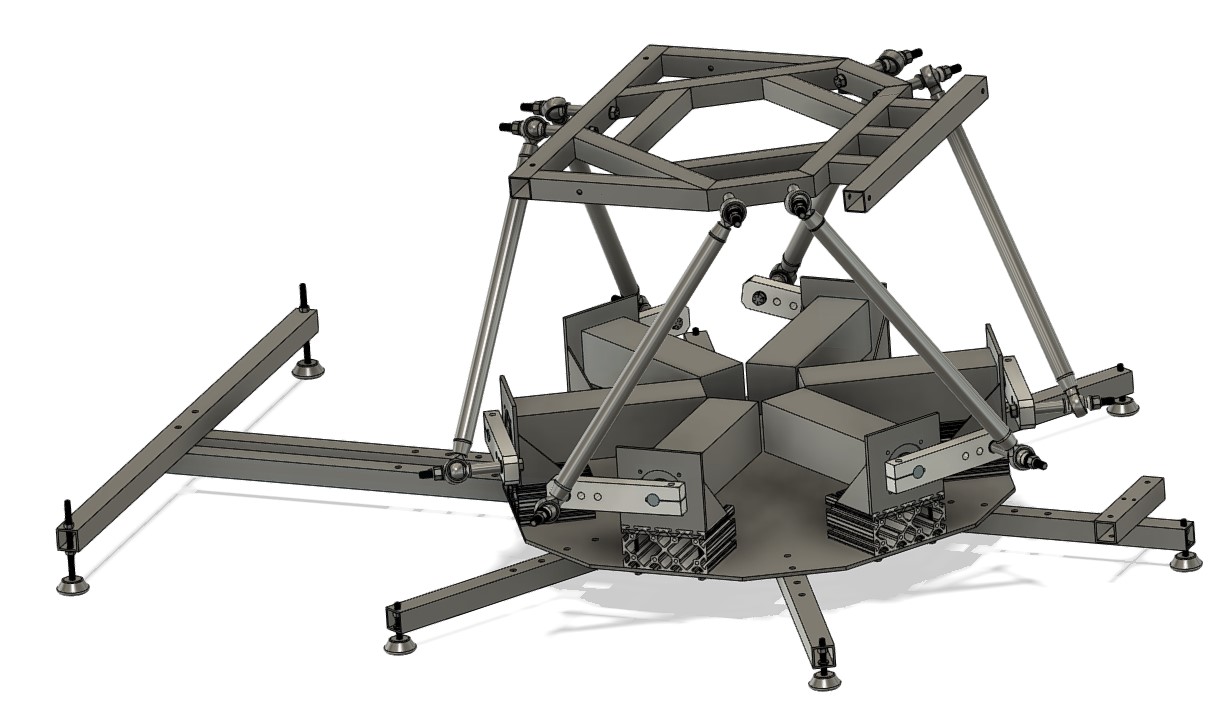

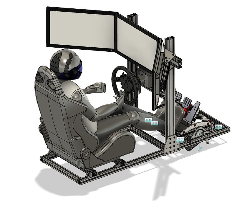

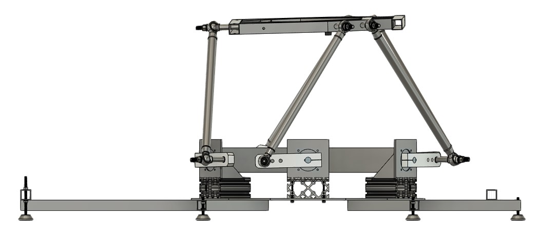

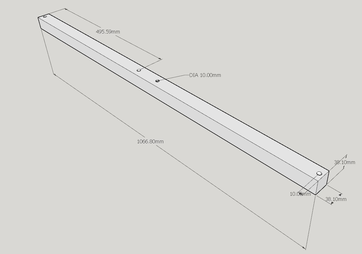

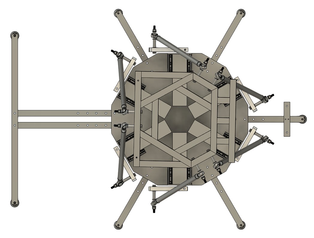

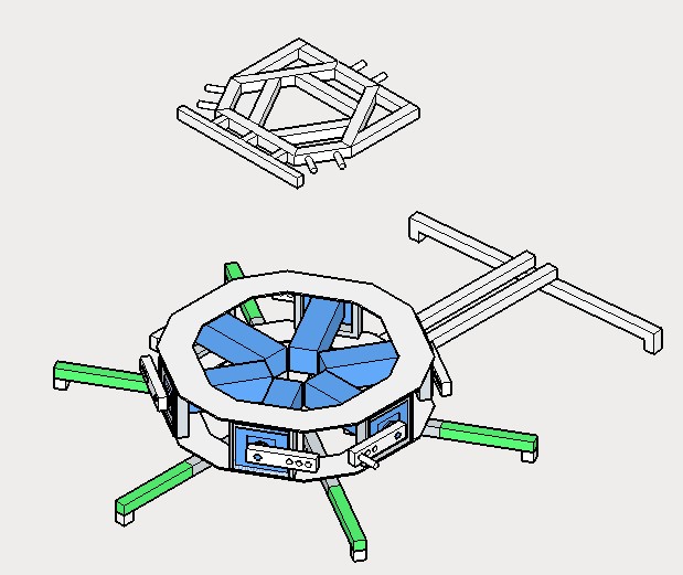

    Getting closer to pulling the trigger on a build. Existing draft attached. I ended up going back to a traditional upper platform that will support an extruded aluminum rig. The extra rails should help me to mount the rig and adjust the fore/aft to find an optimal balance for the servos. Made a small modification to the Grigory build with extendable feet in green, I want to keep the smallest footprint possible.
    The lower platform radius to the crank arm extensions is 442mm, the upper platform radius to the mounting extensions is 318mm.
    I just saw kaitila's new build (https://www.xsimulator.net/community/threads/6dof-project-750w-ac-motors-1000w-servo-motors.14477/), which is a great mod to Grigory's build. The support feet might be a simpler and better solution than the route I am going. I need to stop browsing this site and get on with it, lol!
  13. duckdown
    duckdown New Member
    Jan 25, 2020
    19
    135Coins
    +19 / 0 / -0

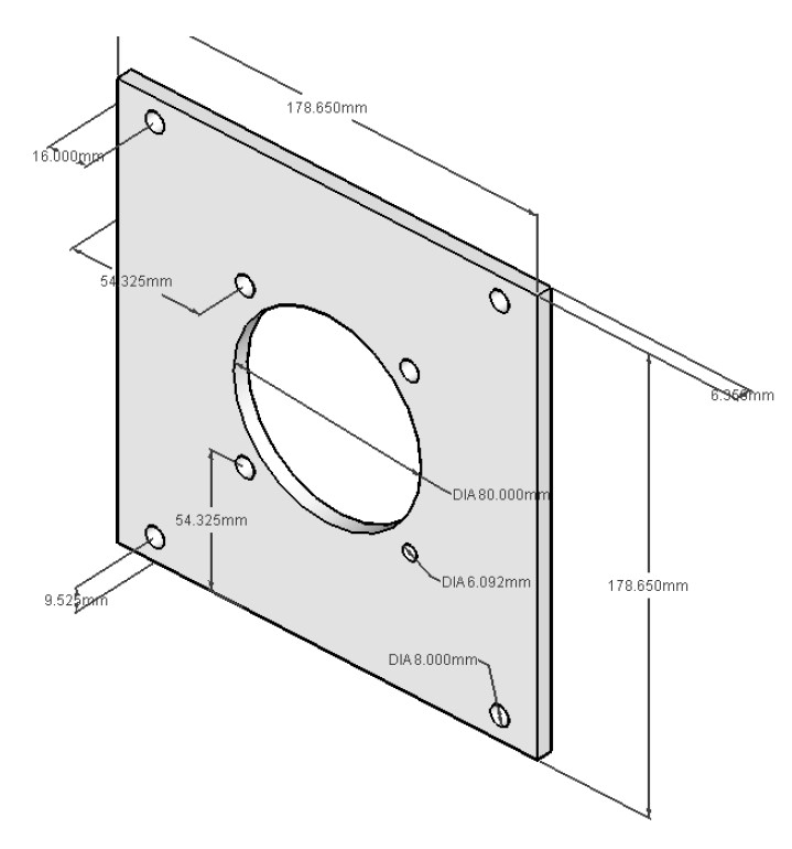

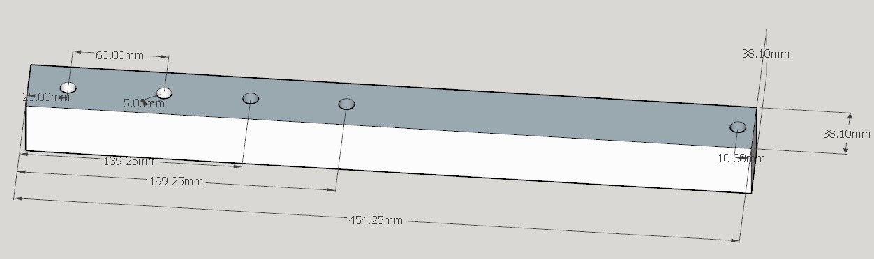

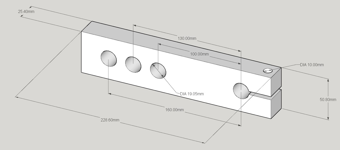

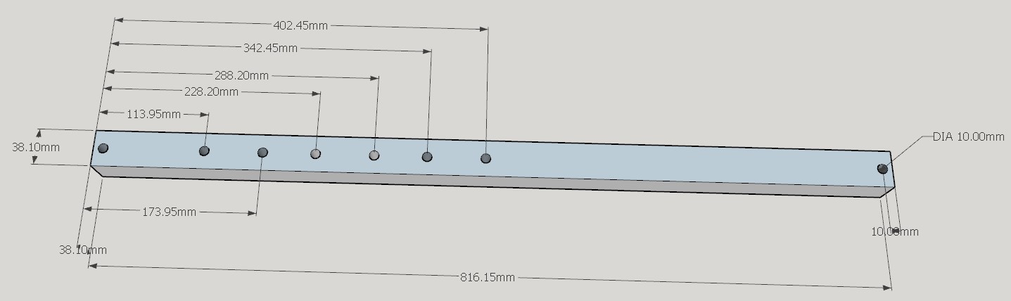

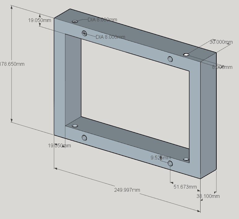

    Made some adjustments and simplified the support feet. Rather than having extendable feet, I added extra mounting holes so that I can have a wider or narrower stance, depending on rig stability.
    The original plan was to do the fabrication with a friend, but the Covid-19 situation has changed that. Now likely going to send the plans to a local maker, with one of my gearboxes so that precision measurements can be made for the crank arms and motor mounts.
    I would take the attached motor mount and crank arm diagrams as guidelines, they will be slightly different based on the gearbox spindle and mounting hole measurements. The gearbox key spline measures is 1.25", but I am trying to figure out whether I can make the crank out of a standard 1" billet or if I need something wider.
    Any suggestions or improvements would be appreciated before I push the button.

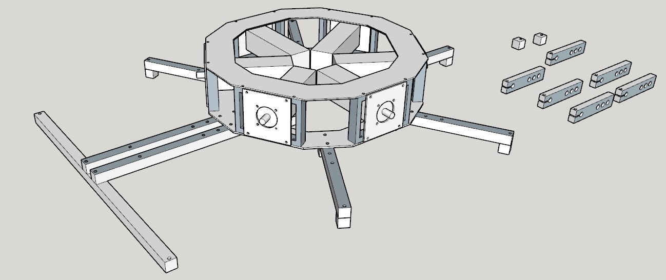

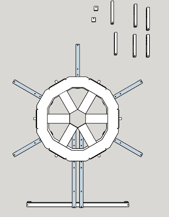

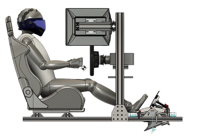

    Some sketches of the rig. These are pretty close to the final spec, though I made a few simple changes during assembly for fitment that I haven't documented yet.
    The main change is that I cut the down the vertical portion of the motor mounts so that they are almost flush with the top of the gearbox. I also added stops for the servo calibration, but those were simple t-slot attachments to the six extruded aluminum pieces that I used to hold the servos and gearboxes. Lastly, there are support feet under the base of the bottom platform.
    The only major changes I would make would be:
    1. To use a 1/2" steel plate for the bottom platform rather than 1/4"
    2. I would reduce the overhang on the rear of the crank arms. It is not necessary, and increases the likelihood of contact with the support arms. I ended up cutting off most of the overhang.
    3. I wouldn't drill the extra holes for the support legs, the widest setting, which I used, is the best for stability.
