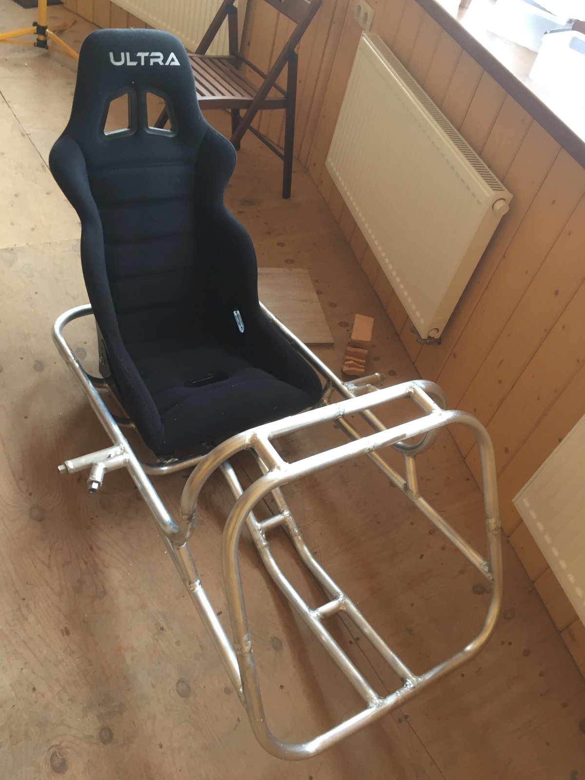

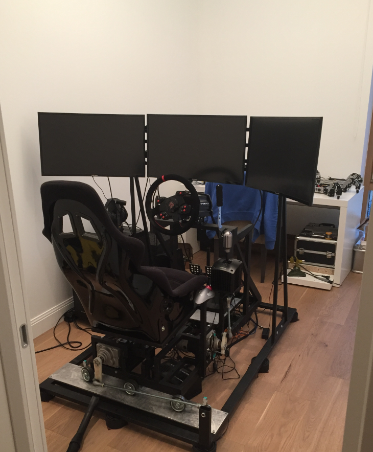

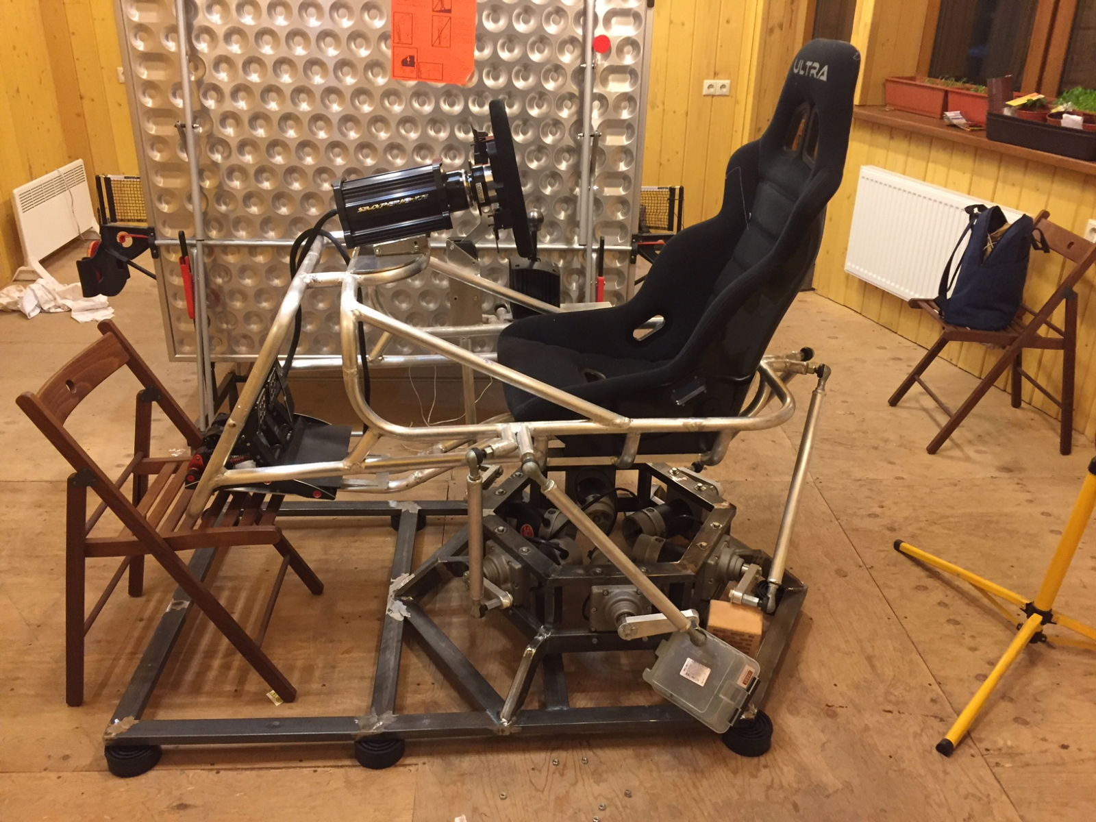

    The second attempt was this seat mover with a traction loss: seat mover.png
    I actually liked it very much. To me, the pressure on the hands and legs that is felt when the seat moves against stationary wheel and pedals is maybe even more immersive than full 6dof movement (especially with the four buttkickers). This sim was also compact enough to put it in the urban man cave :)
    The drawbacks were only the lack of heave and not so good compatibility with flight sims. I almost exclusively drive, but there is some flying once in a while.

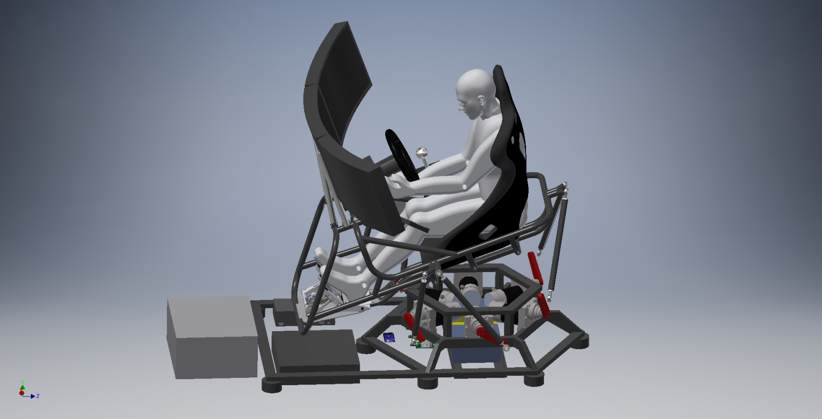

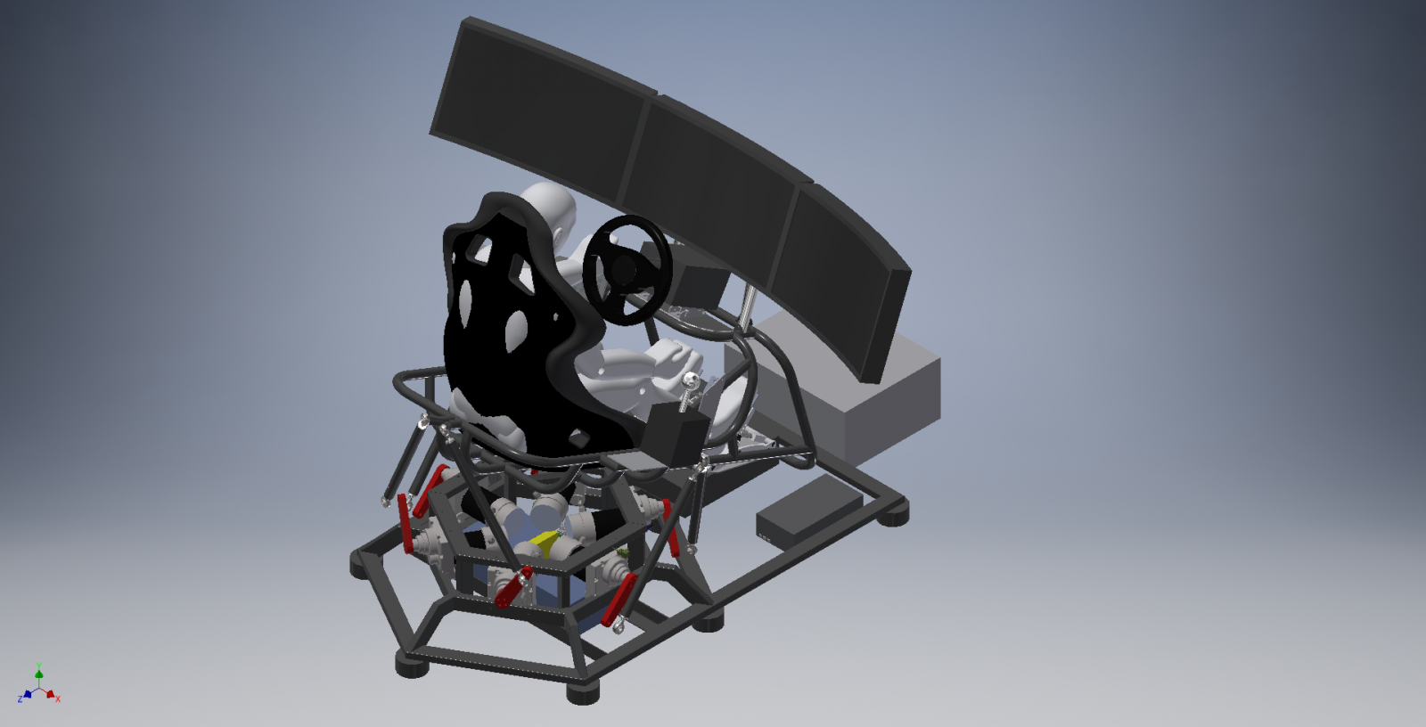

    So, this time I decided to build a third simulator version that would be 6dof, but considerably smaller than the initial one.
    My general thoughts on this new project are as follows:
    1) I was not able to figure out how to make a linear acuator-based design materially smaller than my first rig, so I would be giving up linear actuators and going to lever+rod solution
    2) the reason I used linear acutators in the initial 6dof was the extreme backlash in my wormdrive gearboxes, so using the same motors is not an option
    3) the motors that I used for the seat mover were NPC-64T, which I had available after some other earlier project. These motors are very powerful and have gearboxes with very little backlash.
    They are widely used for robot combat, so they should be quite reliable.
    For my new 6dof, I plan to use NPC-74T, the sligtly more powerful version of this motor with the same gearbox: http://www.robotmarketplace.com/products/0-t74.html
    4) the cockpit of the first 6dof was made of steel and it was definitely way too heavy. Since I now have a TIG welder, the new cockpit will be made of aluminum tubing.

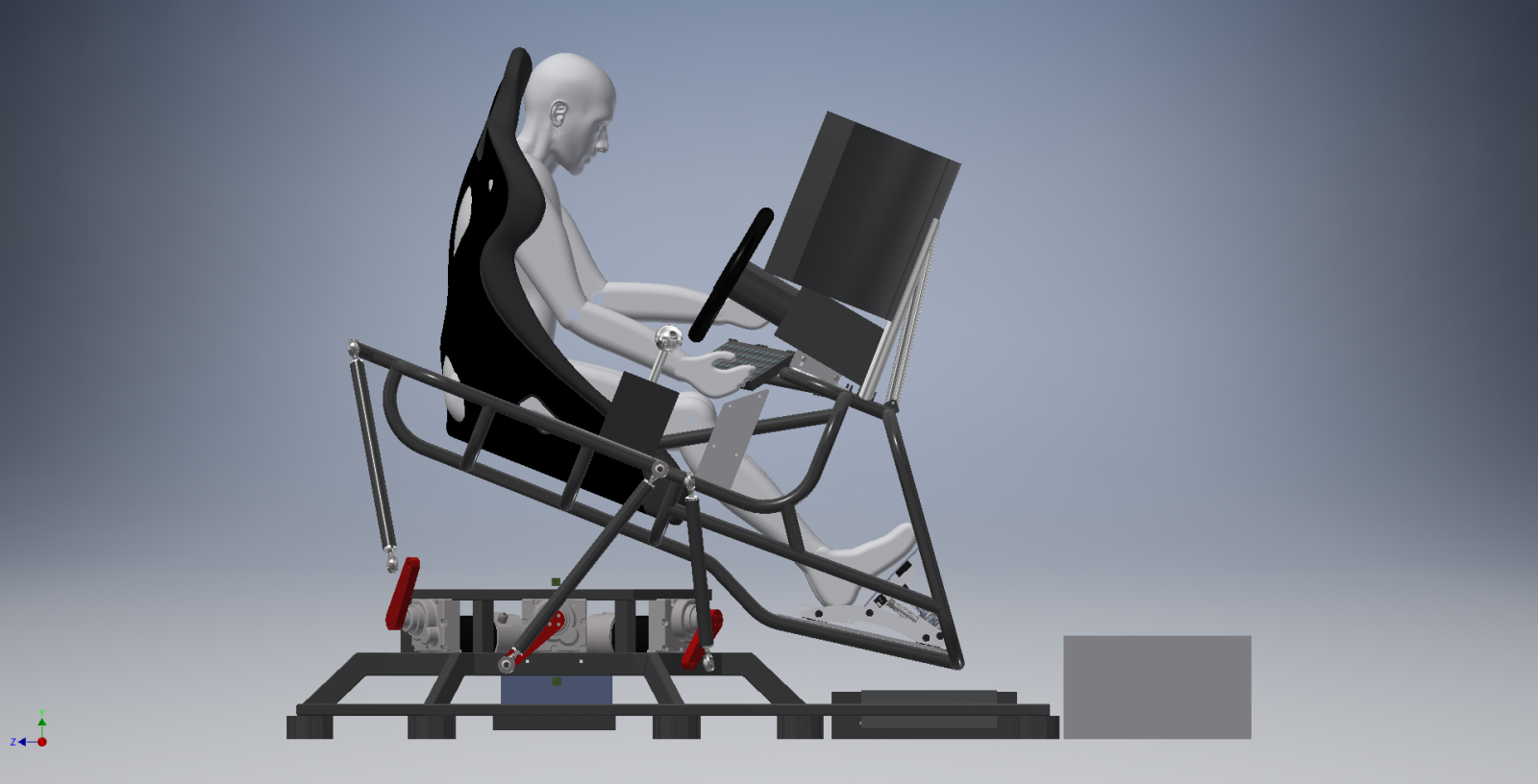

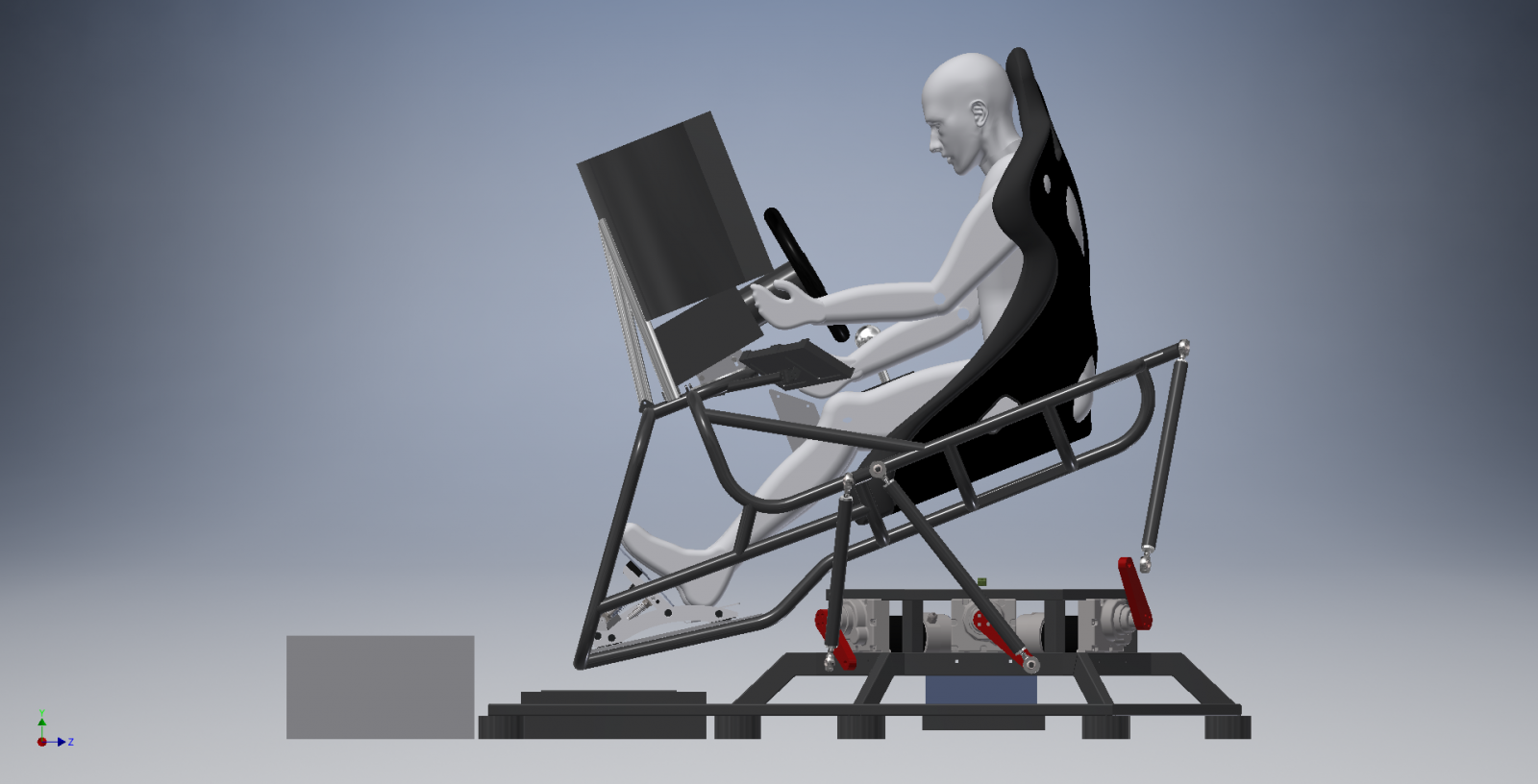

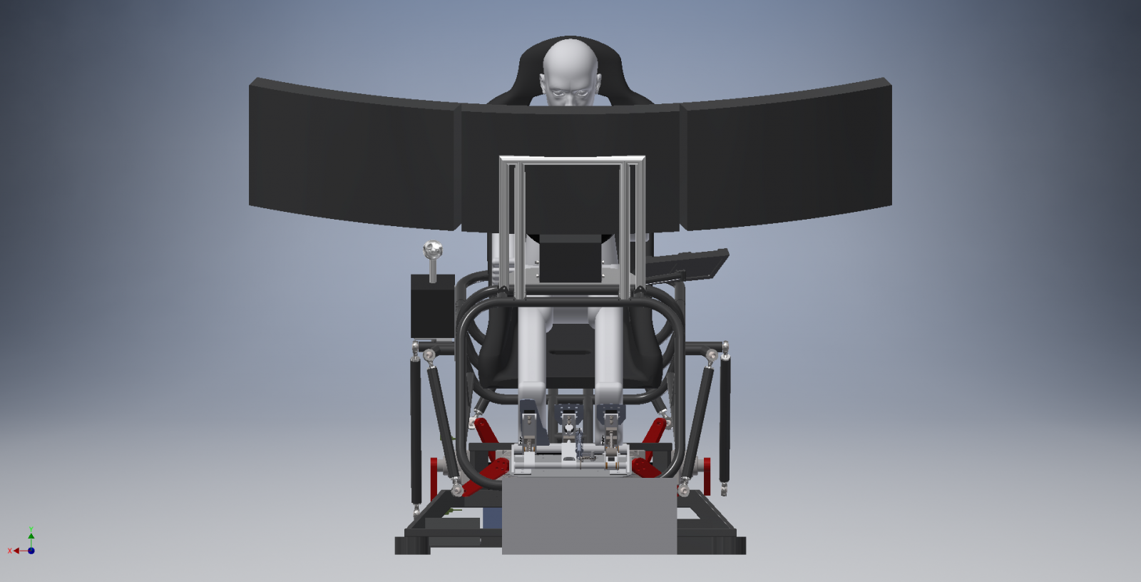

    Here's the design that I have in mind:
    The moving platform together with three monitors, accuforce wheel, fanatec pedals, shifter and a seat with a 70 kg driver will weigh about 130 kg.
    Levers will be 150mm. If my calculations are correct, each motor will be delivering around 30 kg of force at the end of the lever when using the maximum continious current of Sabertooth 60x2 and about 70 kg of force when taking Sabertooths peak maximum of 120A. The smaller texture will be handled by the buttckickers, so these forces should be enough, I hope.

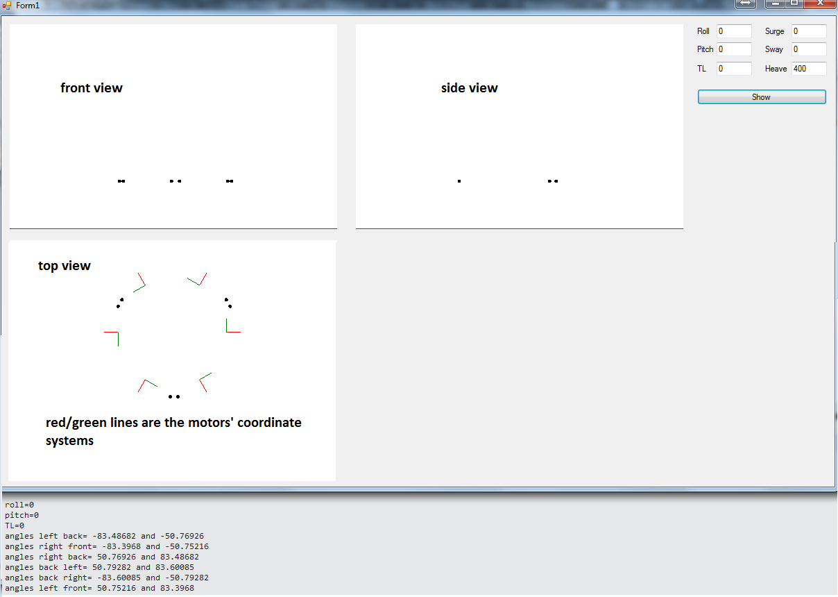

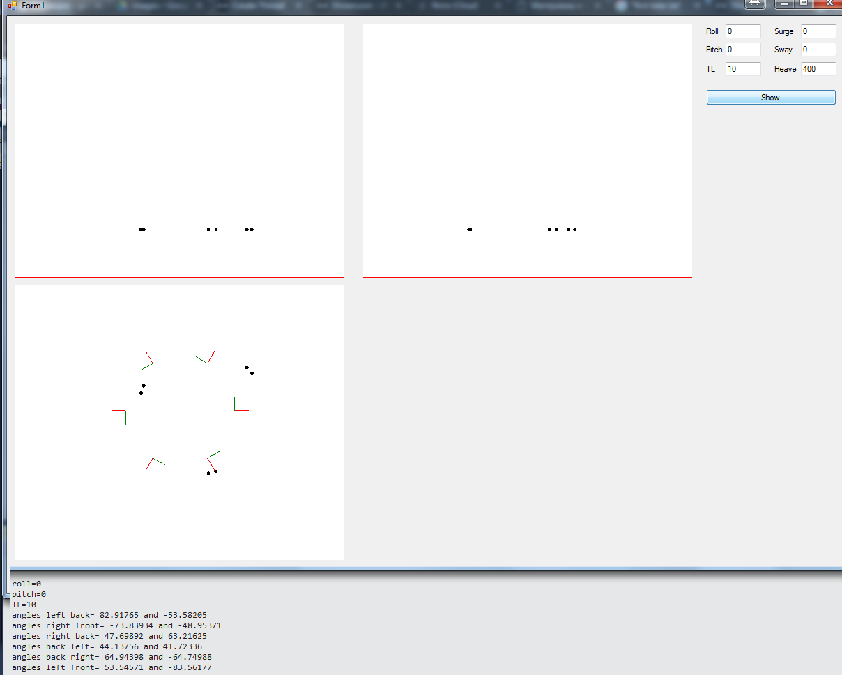

    I also plan to use my own 6DOF software between Simtools and the simulator itself -- to allow adjustment of rotation centers for each DOF.
    I already made the prototype in VB.Net, using this logic: Grigory’s 6DOF 24V DC
    This prototype accepts the required pose, calculates the lever angles and shows positions of the attachment points on the moving platform in relation to the motors. Here is an example showing effects of traction loss angle.
    Neutral position:
    10° traction loss -- it is seen that rotation is happening around the axis that is somehwere close to the feet, not around the center of the moving frame.

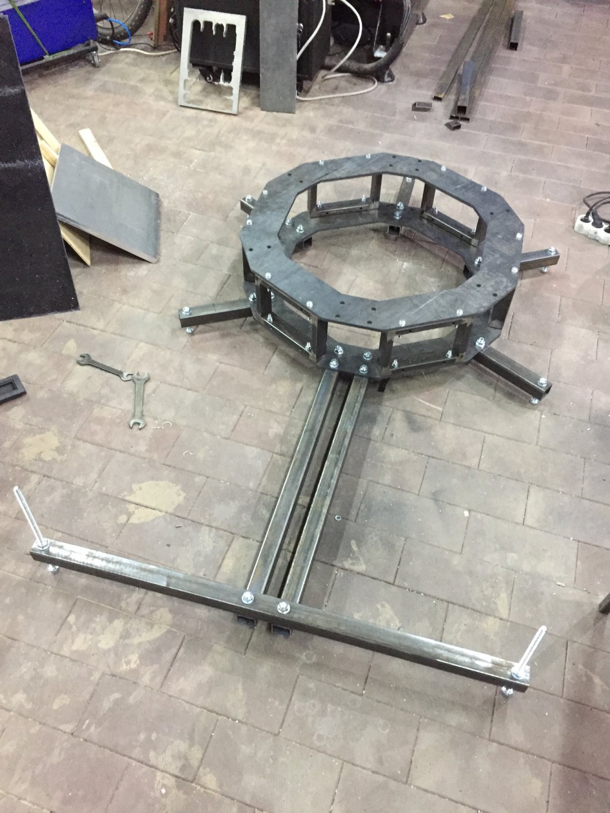

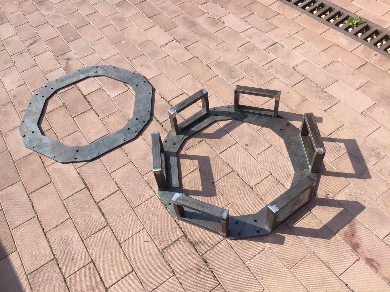

    Some mechanical works are already completed as well. I'll put that in the next post

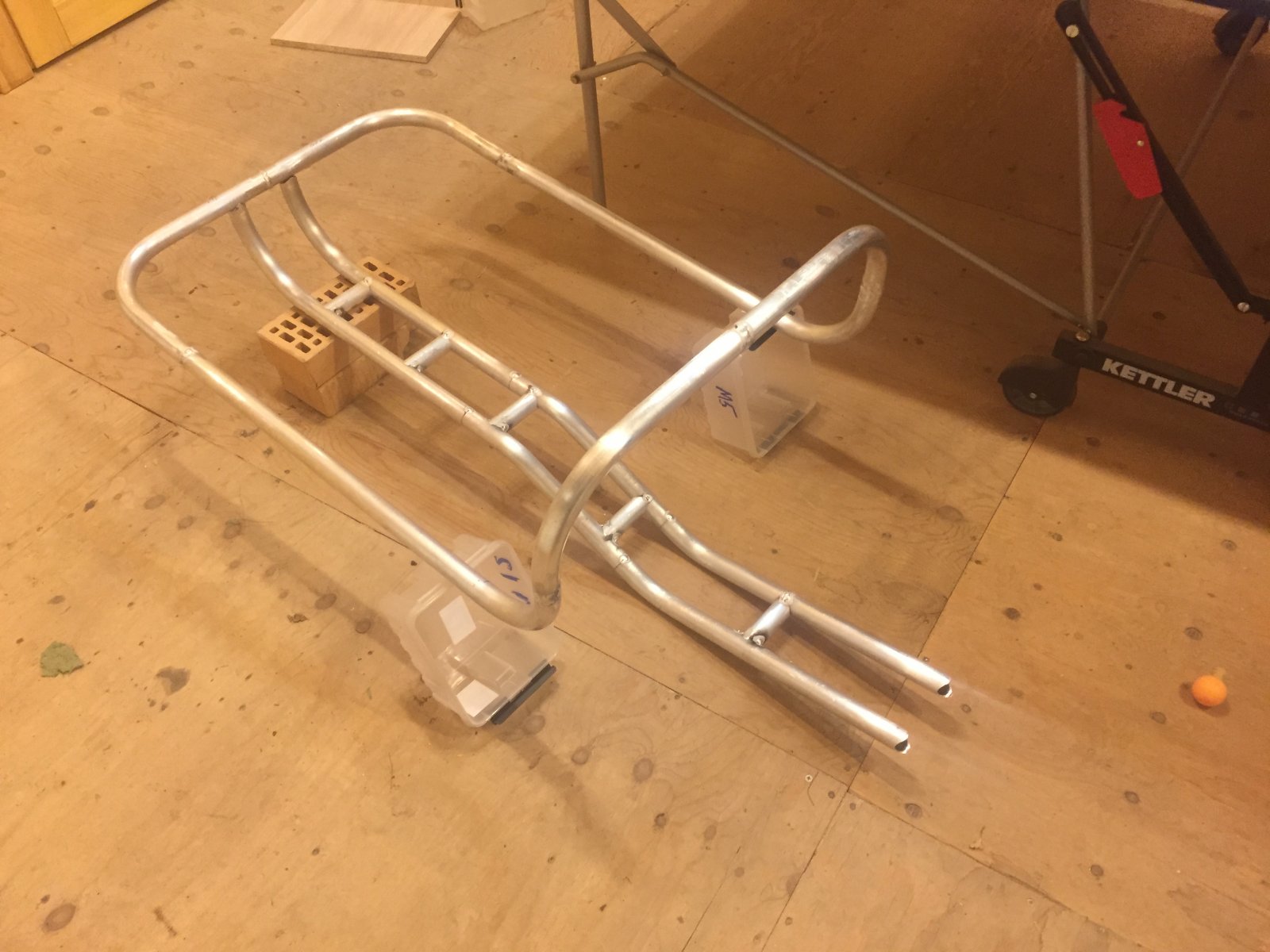

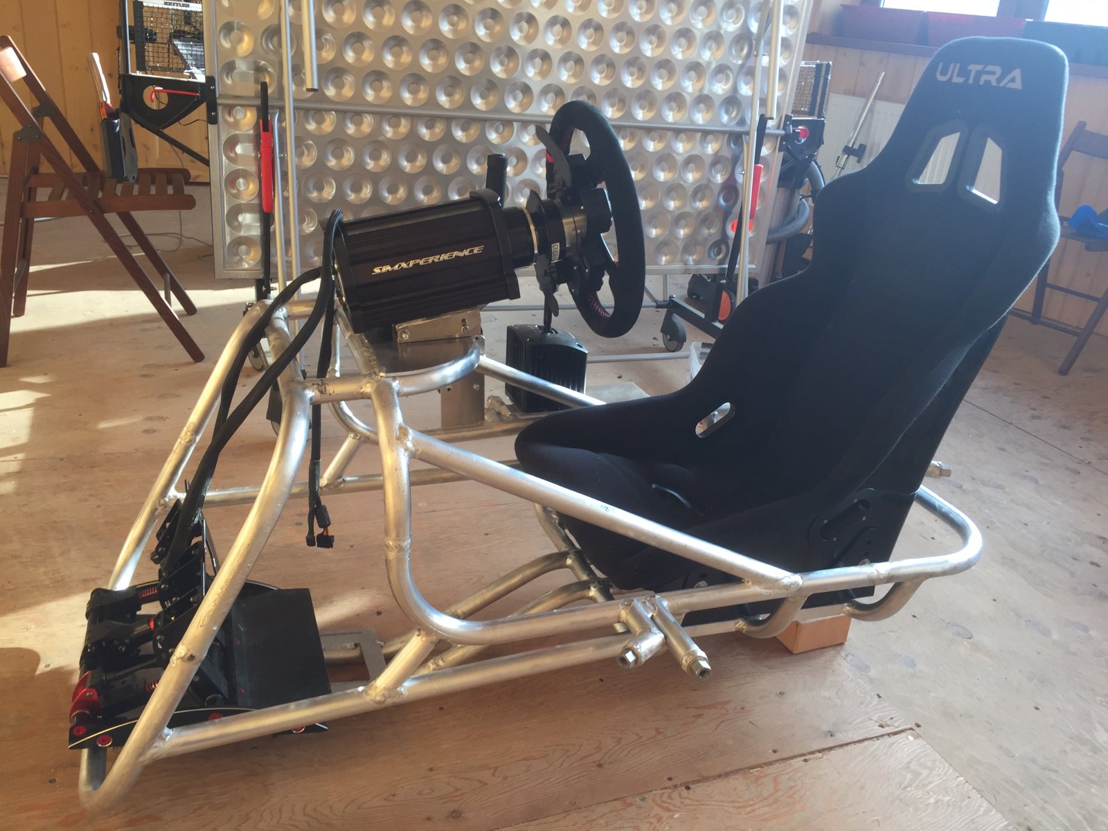

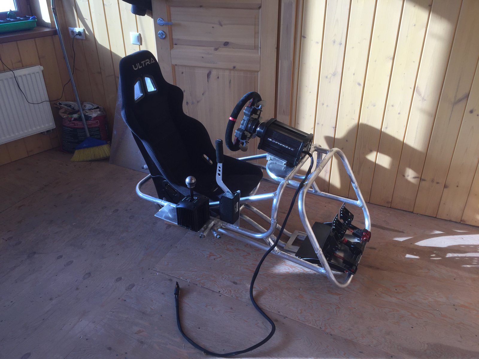

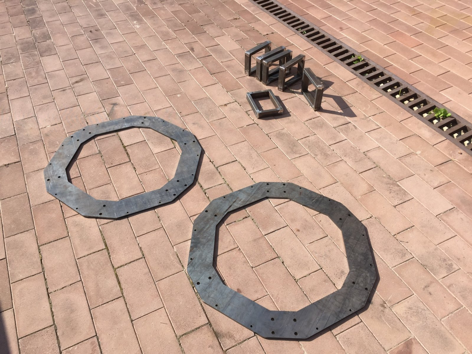

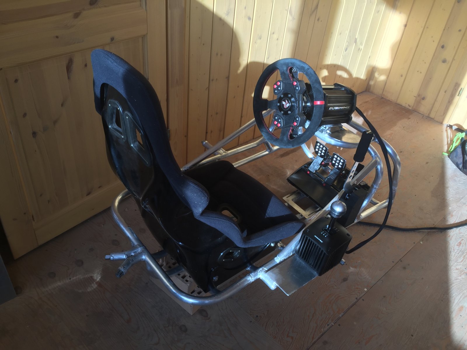

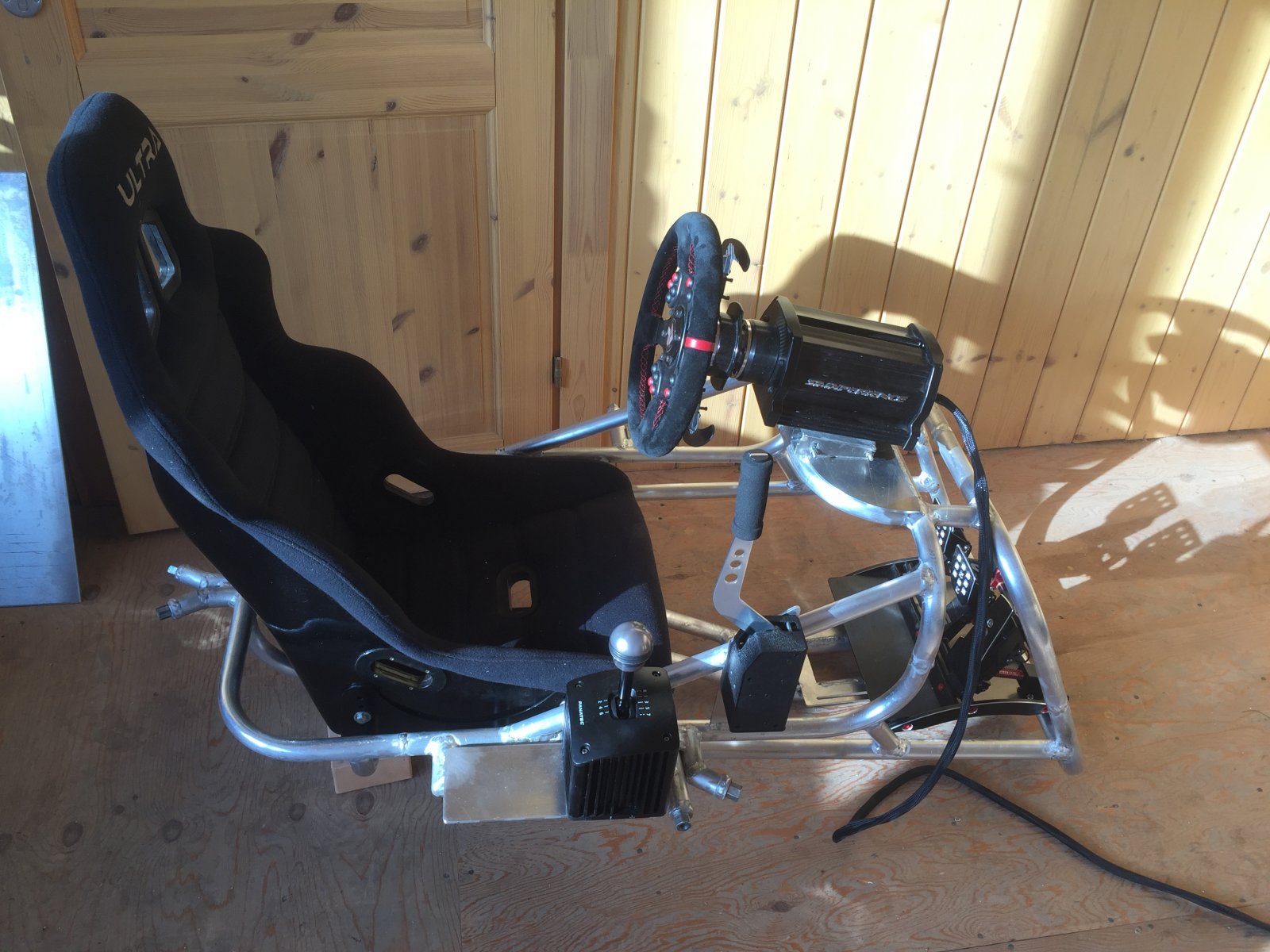

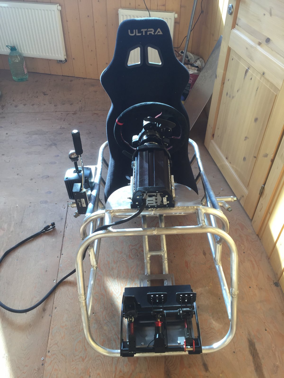

    IMG_7527.JPG IMG_7555.JPG IMG_7579.JPG IMG_7587.JPG IMG_7586.JPG IMG_7584.JPG IMG_7582.JPG IMG_7607.JPG IMG_7624.JPG

    No, I did not describe it anywhere, since it was prettty straightforward: steel welded frame,
    unijoint from a Russian 4x4 steering,
    industrial cart wheels attached to the back of the traction loss platform and rolling on the aluminum plates
    the front traction loss joint is again an industrial cart caster wheel with the wheel itself removed.
    The monitors are stationary, not mounted to any of the moving parts.
    All three motors are NPC-64T, but that is probably way excessive. I just happened to have these.
    I am using sabertooth 60x2 with kangaroos, 1024ppr encoders and contact limit switches.
    The power comes from two SDR-960-24 units and two small 12v batteries in series.
    There are four buttkickers with Emotiva A500 amplifier and the Accuforce steering wheel — running with simcommander/simvibe

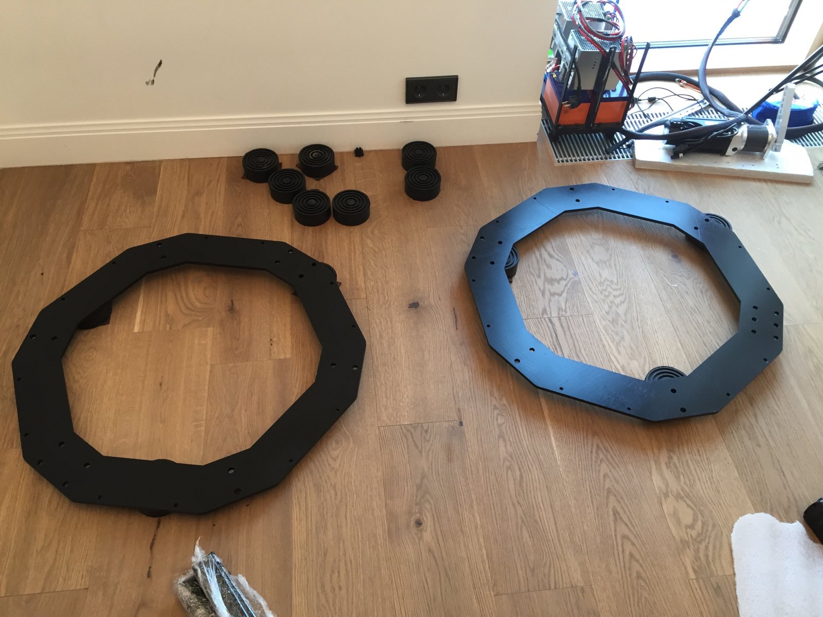

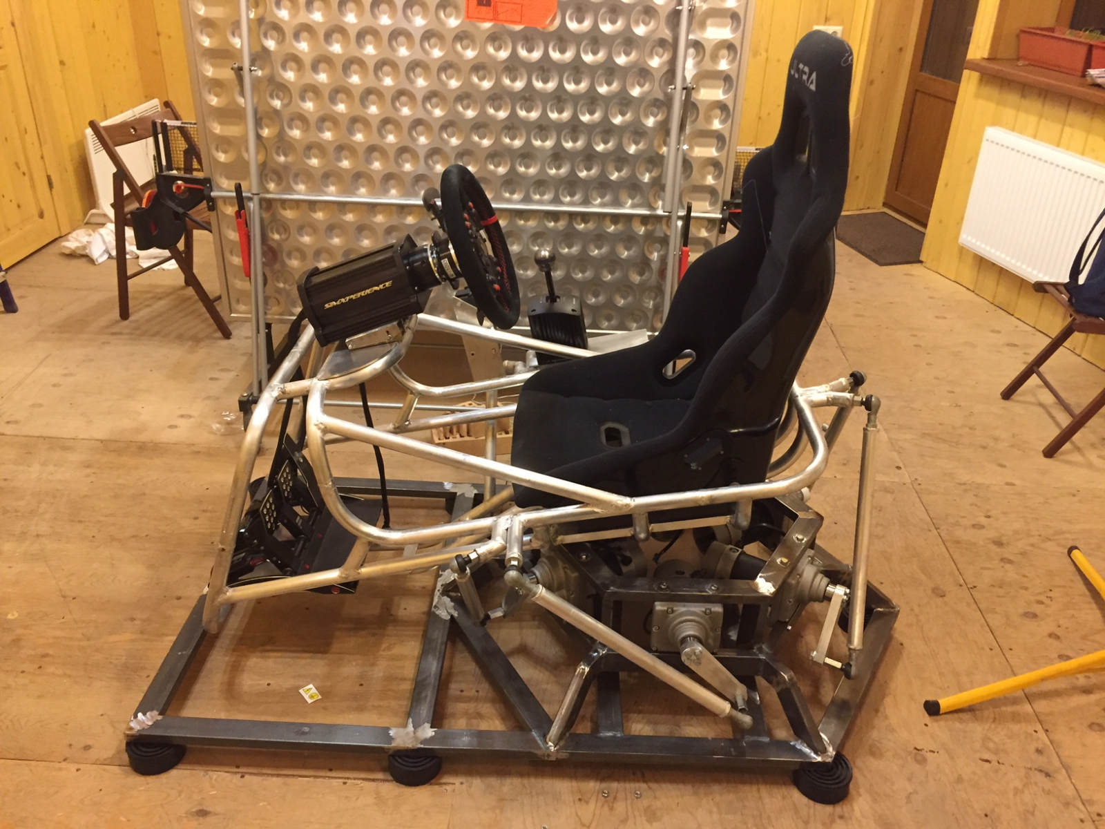

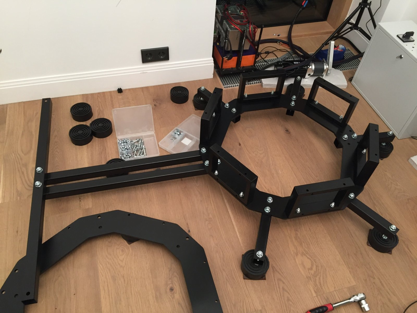

    Here is some further progress.
    Mechanical part is mostly ready, all painted and relocated to the city appartment for final assembly.
    I hope to finish wiring in the next couple of days.

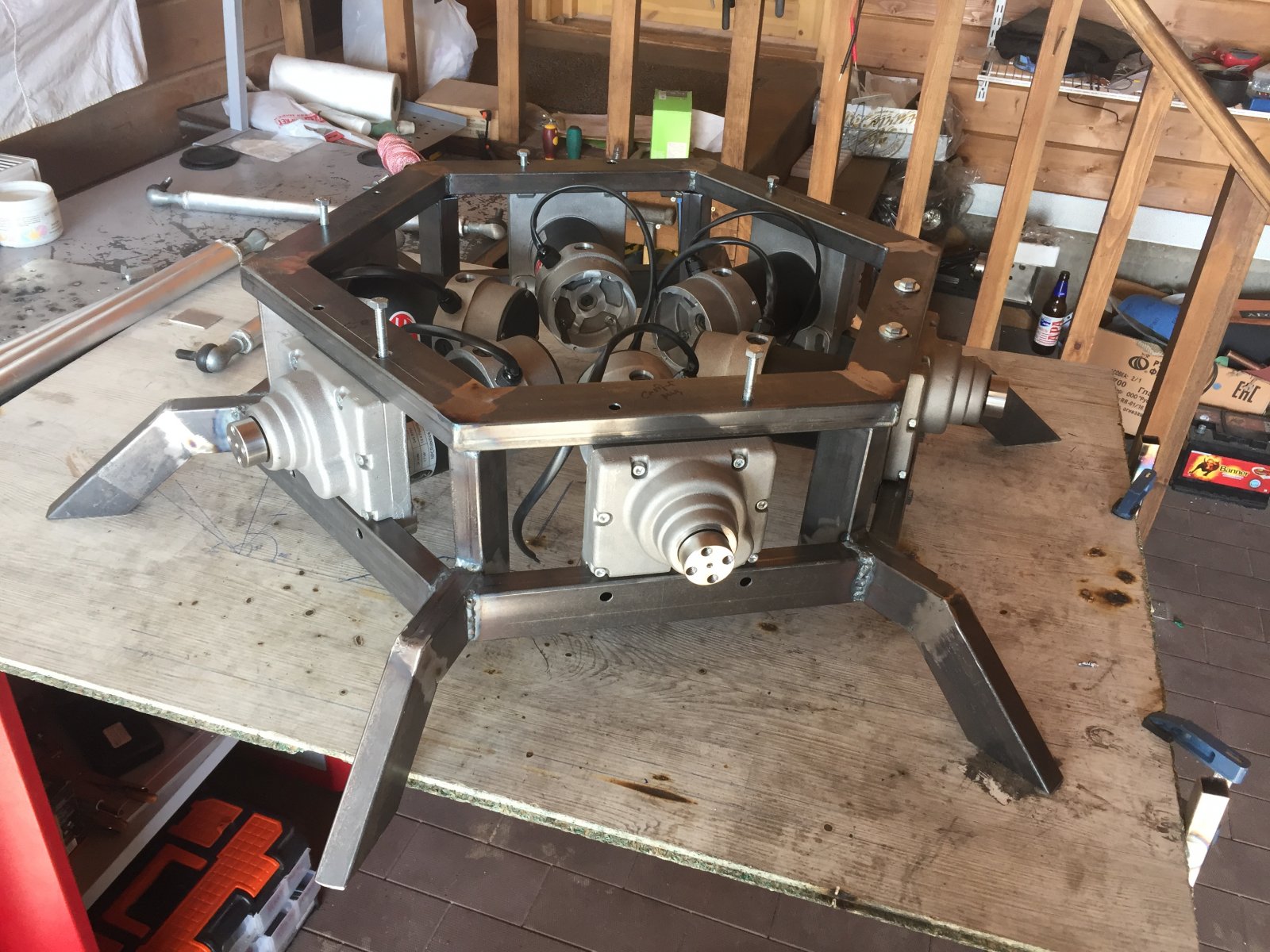

    Change of plans: I had several problems with my initial idea of using NPC-74T, so I decided to make a radical move and experiment with using 220V servo motors and planetary gearboxes. On paper, this would allow a speed of about 1600 mm/s, nominal 50 kg force at the end of 150mm lever with short peaks of 150 kg of force. Should be plenty for my platform having 35 kg without the driver.
    The motors arrived today, the gearboxes should be here by the first week of September, so I hope to start testing in 2-3 weeks from now.

    Actually, I think that the initial 24V design could work and the problems were not that unsolvable.
    The first problem was with the temperature. These motors are really powerful, they had absolutely no problem moving the rig even with these 150mm levers. The other side of this power is, however, the huge current requirement and, hence, tendency to quickly get very hot. Also, the wires initially installed on these motors are not thick enough. Making the levers shorter helped to decrease the temperature and I believe that the issue could have been totally removed if I replaced the motor wires and added some fans to cool the motors.
    The second problem was with control tuning. I was using Kangaroo x2's as PID controllers and for some reason they just refused to properly auto-tune. The tuning process completed without issues, but then bad ocscilations occured at some parts of the lever travel. I tried setting the coefficients manually, which helped a little, but could not fully solve the problem. I spent couple of weeks trying to fix that -- without success. Probably, I would have eventually found the cause of the problem or maybe I could have switched to SMC3.
    The reason why I decided to switch to 220V servos is simply that I have recently re-fitted my lathe's spindle with such 220V servo motor and I really liked its power and convenience of control. In addition, I've found nice planetary gearboxes with less than 0.1° backlash.

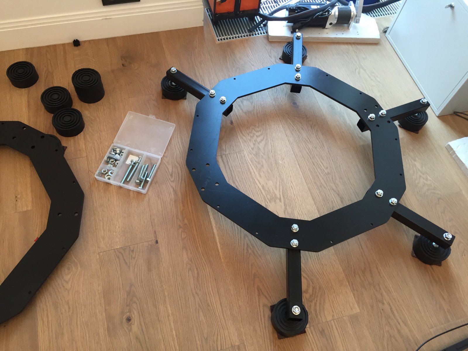

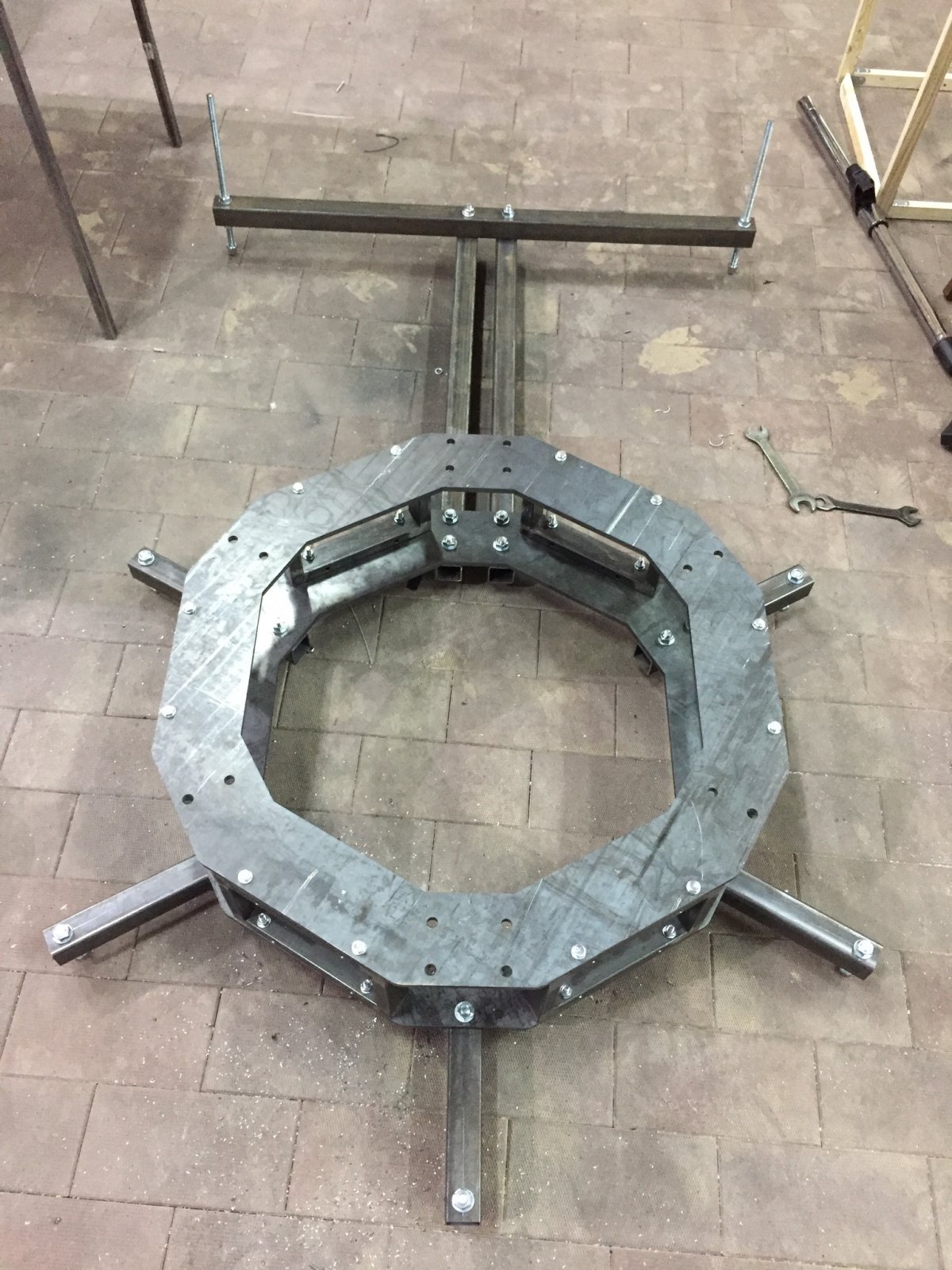

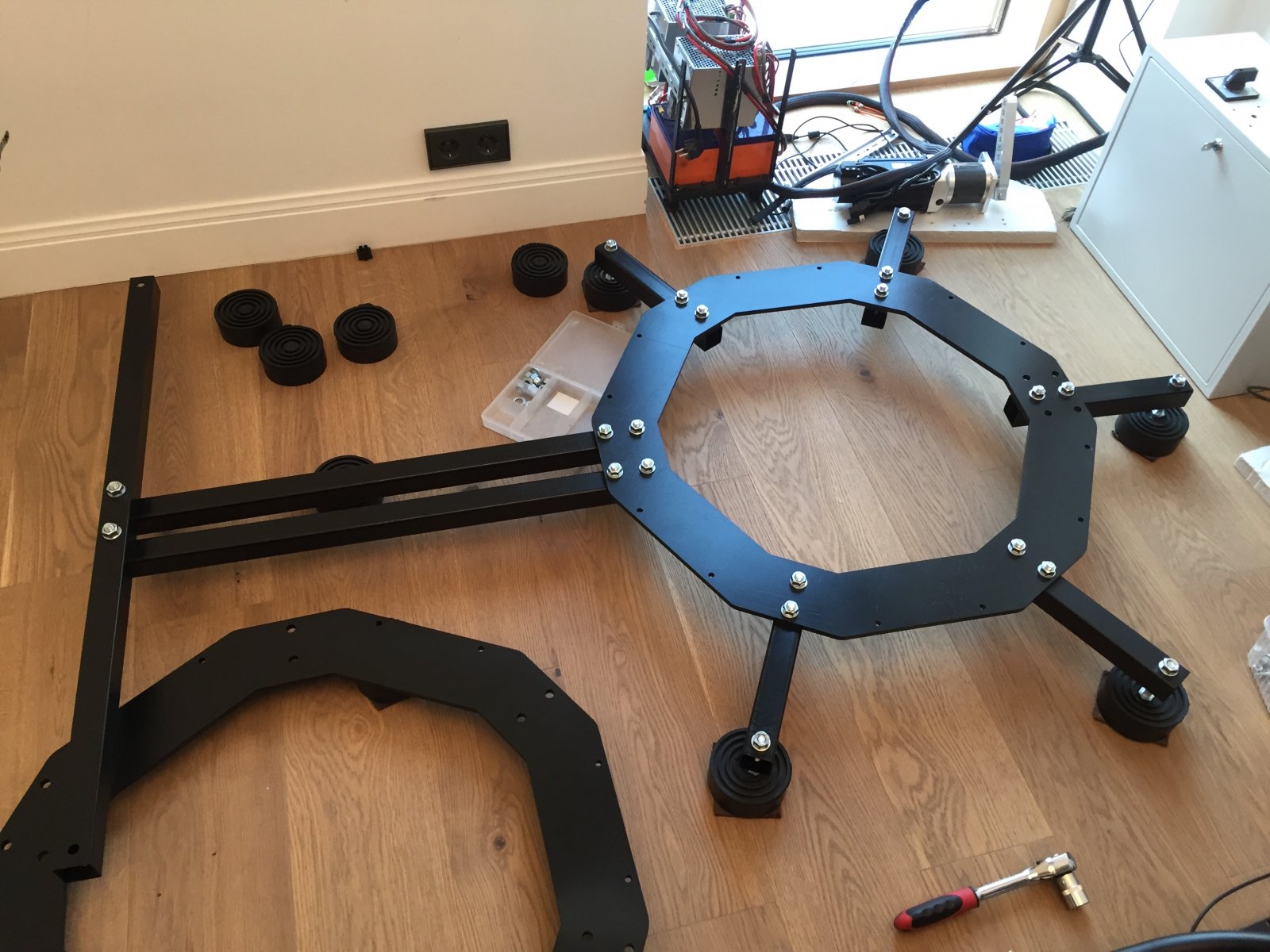

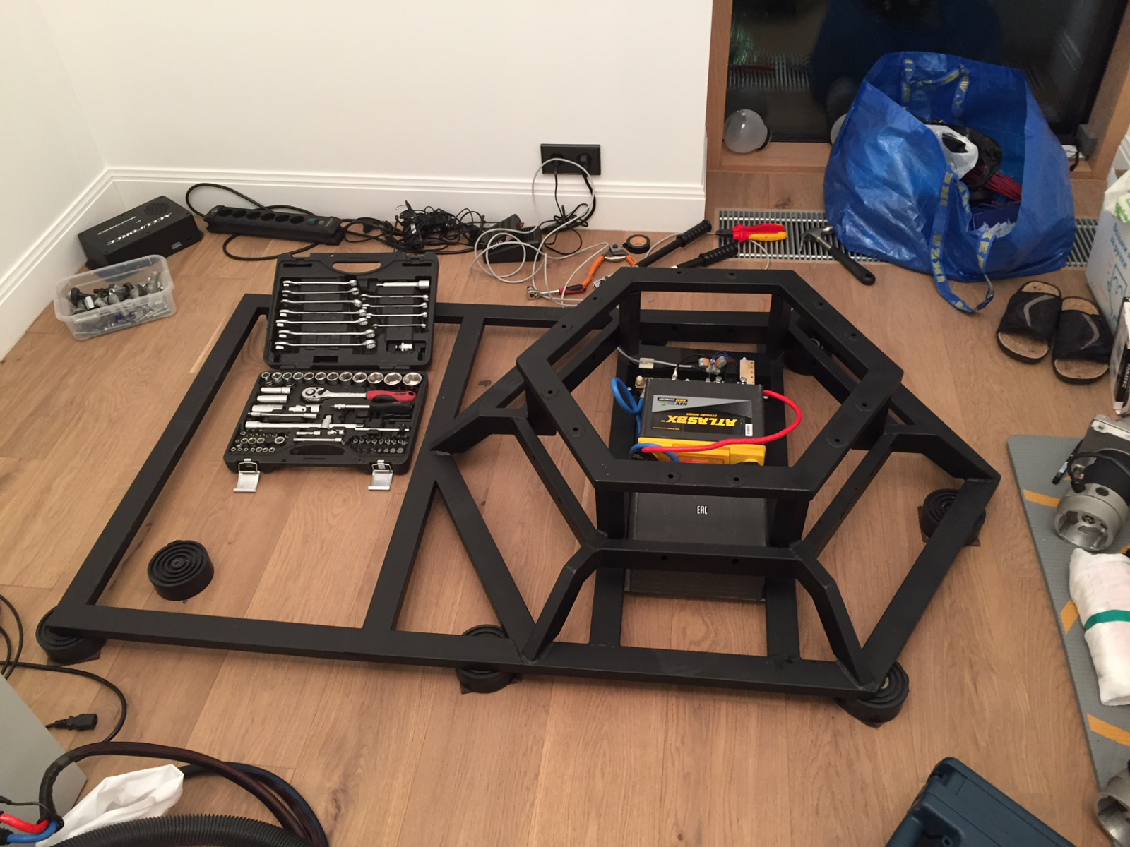

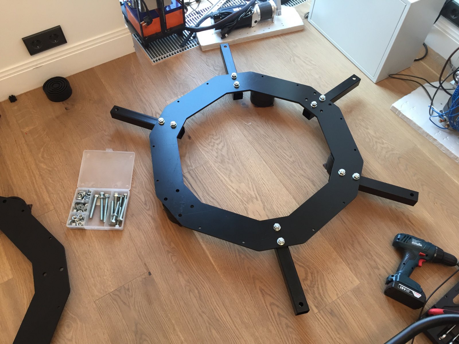

    My servos do not fit in the base that I previously made for the 24v motors, so I need to build a new one:
    5FE6D95E-A1F3-4FB2-8095-59F7EDE7C089.jpeg 75A2463F-E0BF-4801-AA98-2BC8ABA5740E.jpeg 32CC7CB8-6C76-4570-B177-5F9ED4B355AD.jpeg CBB53497-4A1C-437C-B622-0DEA891DAEC4.jpeg
  20. Grigory
    Grigory Active Member Gold Contributor
    Jul 6, 2016
    202
    Moscow
    220Coins
    +305 / 1 / -0
    3DOF, 6DOF

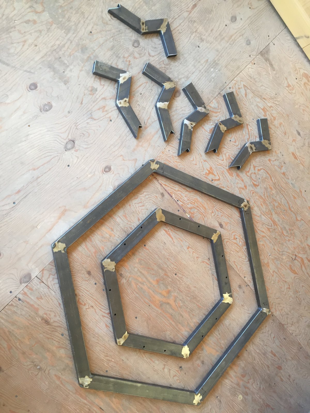

    Now my rig is disassembled and I am starting to put together the new base for 220v servos:
    B67B4B48-224A-447D-A6C5-4C22104F7D94.jpeg 74F10927-EA4E-464B-819A-4D592AD4B2E5.jpeg 4E77F17D-1218-48EE-8D9D-FCEE0F584C81.jpeg 70C106CA-78DB-4797-90E4-34DD387CE28A.jpeg 86D86BC2-9D8C-4743-ACF7-FDCEDAF210FE.jpeg
