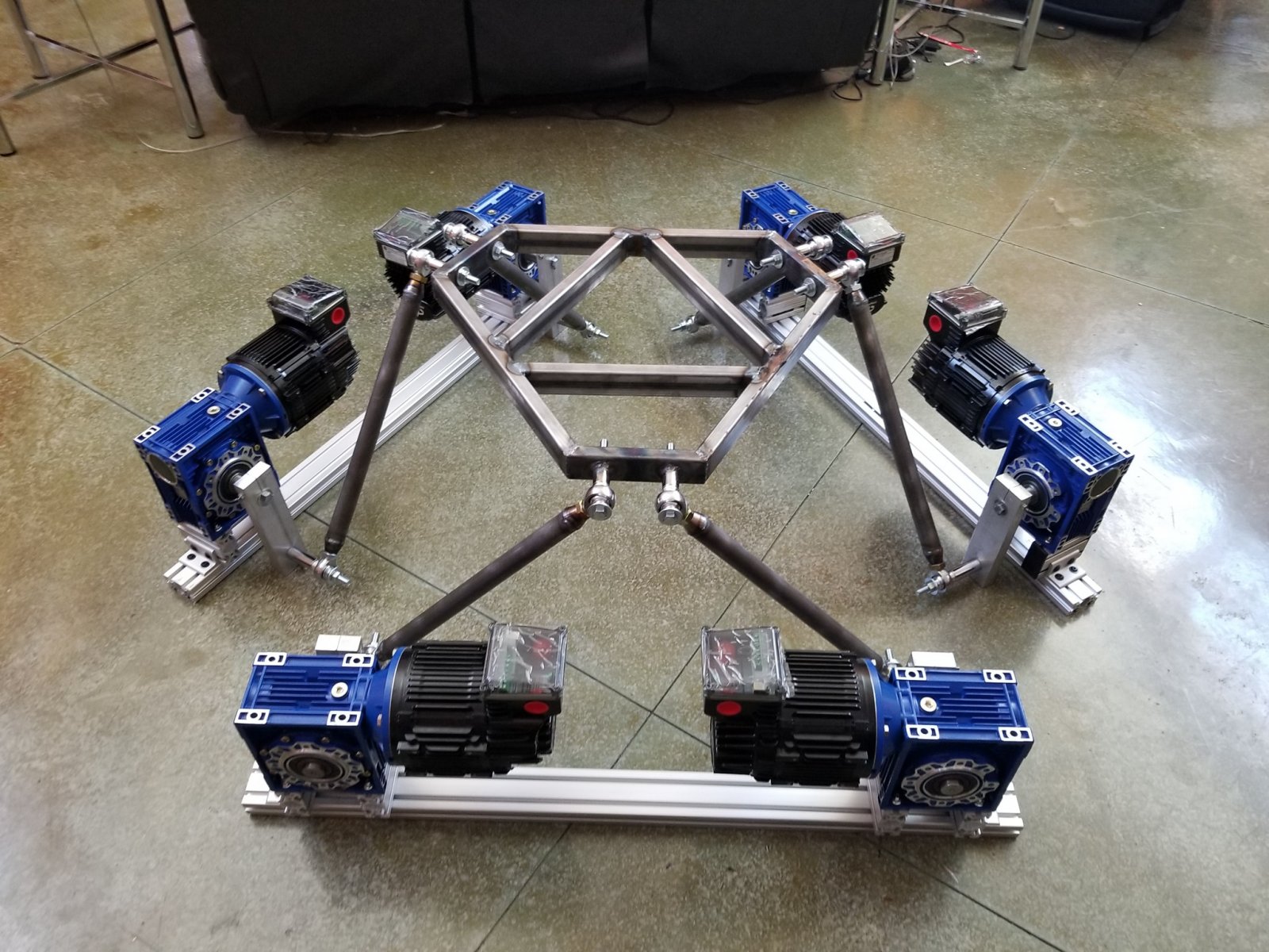

    So I purchased my AMC1280USB 2 years ago with the intent to build a platform, but wrestled with whether to build a linear actuator setup or the lever setup. I knew I did not want to go with the potentiometer feedback style system, so the idea of servos became an interesting option for me.
    Through lots of stalking various threads here and on the motionsim forum, I noticed Teknic put out a new operating mode for their MCPV servo models. I purchased a NEMA 34 size and a 56c-size motor along with an 80:1 wormdrive gearbox as well as some ballscrews for the linear setup. I liked the 34 for the smaller size (more for linear actuators), but I really liked the idea of the straight AC hookup on the 56c size motor. Unfortunately the 34 size servo did not work when I received it and sent it back to Teknic for repair. Upon talking to one of the engineers at Teknic, I tried the "Follow Digital Position" setup for the larger motor, testing it here:
    Then hooked it up to the 80:1, 75mm CD gearbox and tried it out hooked up to only 110V, resulting in a max of around 1000rpm. That's obviously too slow for the final setup, but with 220V attached, you have a max RPM of 2830, which reduces to ~35RPM, which I've read should be suitable for motion platforms.
    Here it is testing with the gearbox attached, connected to Thanos' AMC and using the Hexpod software:
    Once I decided that was going to work, I ordered the remaining motors:
    https://www.teknic.com/model-info/CPM-MCPV-N0561P-RLN/
    Following the design from this thread:
    http://motionsim.freeforums.net/thread/176/dof-step-diy-project-blueprints

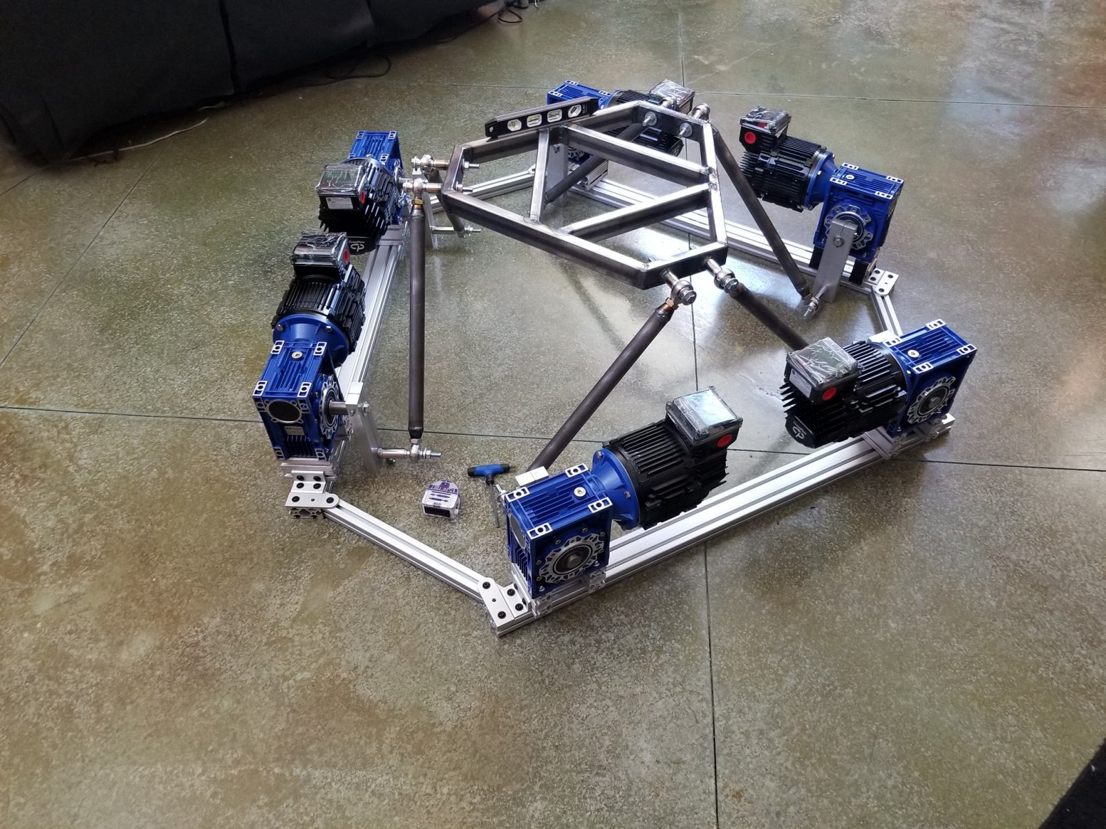

    I started gathering the pieces I needed, welding together the top frame (albeit poorly as my welding skills are horrible) and the 6 connecting rods. I went back and forth on what I wanted to do for the base, but since I had a reasonable amount of 80/20 extrusion laying around, I decided to see what I could throw together with what I had:
    I don't have all the brackets yet, but put it together (from a dimensions standpoint) and added some cross braces (don't have the right ones yet, but just used what I had) and decided on using the 80/20 for the base. I ordered wider pieces for the main legs of the triangle (1545, 4.5" wide pieces, 48" long), and have tested cross feet to stabilize the base (not pictured).
    Since I'm waiting for the rest of the metal/brackets/bolts to show up, I hooked it up again to 110V and did a range of motion test with just one leg moving:
    I spent a whole weekend putting in a new subpanel in my basement, allowing me to run 6 dedicated 220v, 20amp circuits to my computer area. Once I get all of the layout for the base figured out, I'll dismantle it and move it to the basement for assembly in my computer area.

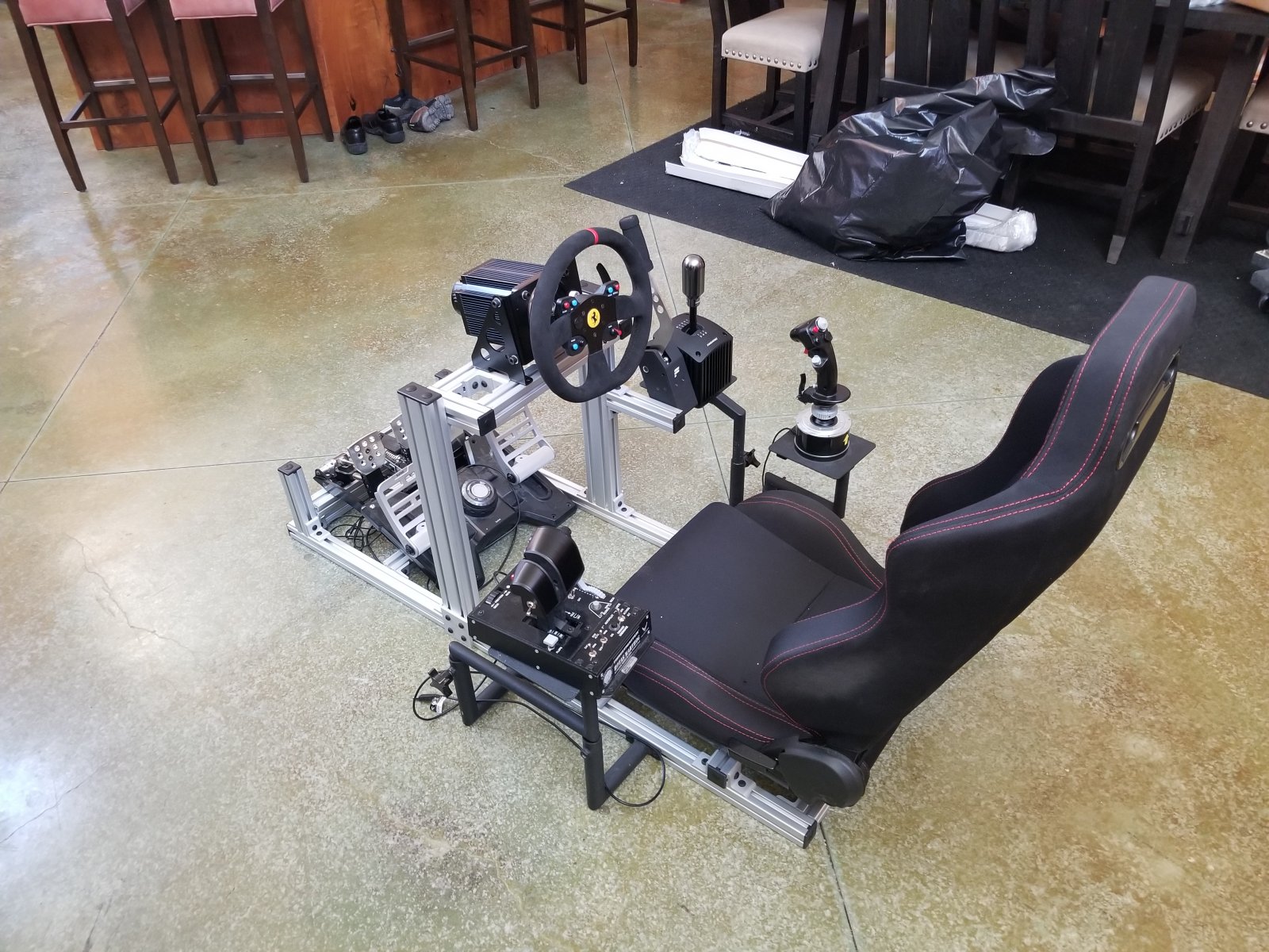

    I currently have an Obutto R3volution cockpit, but have since ordered a mess of 80/20 extrusion to create a new cockpit to put atop the platform once it's built. I have several shipments showing up this week.
    That's what I have so far. Once I get the rest of the metal pieces, I should be able to progress and hopefully have more pictures for you guys.
    Thanks to everyone for posting their projects and providing the motivation for building one of these.
    Dan

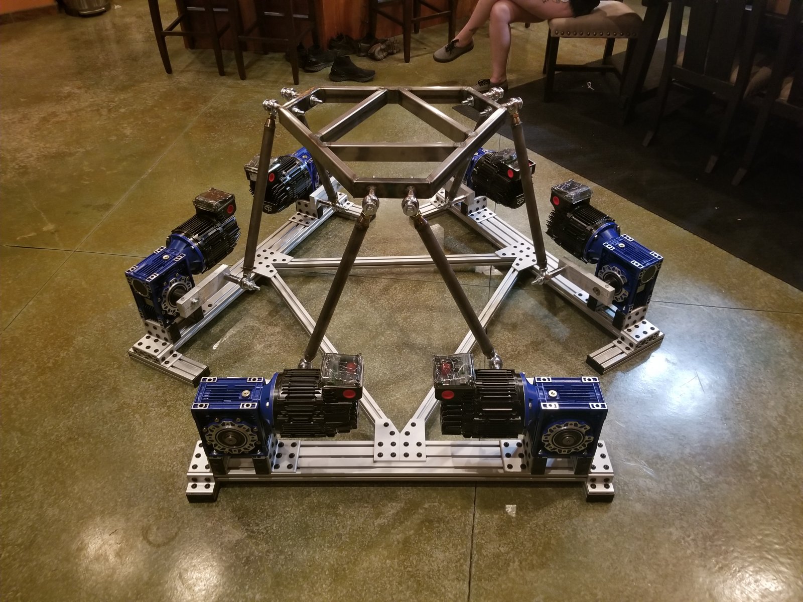

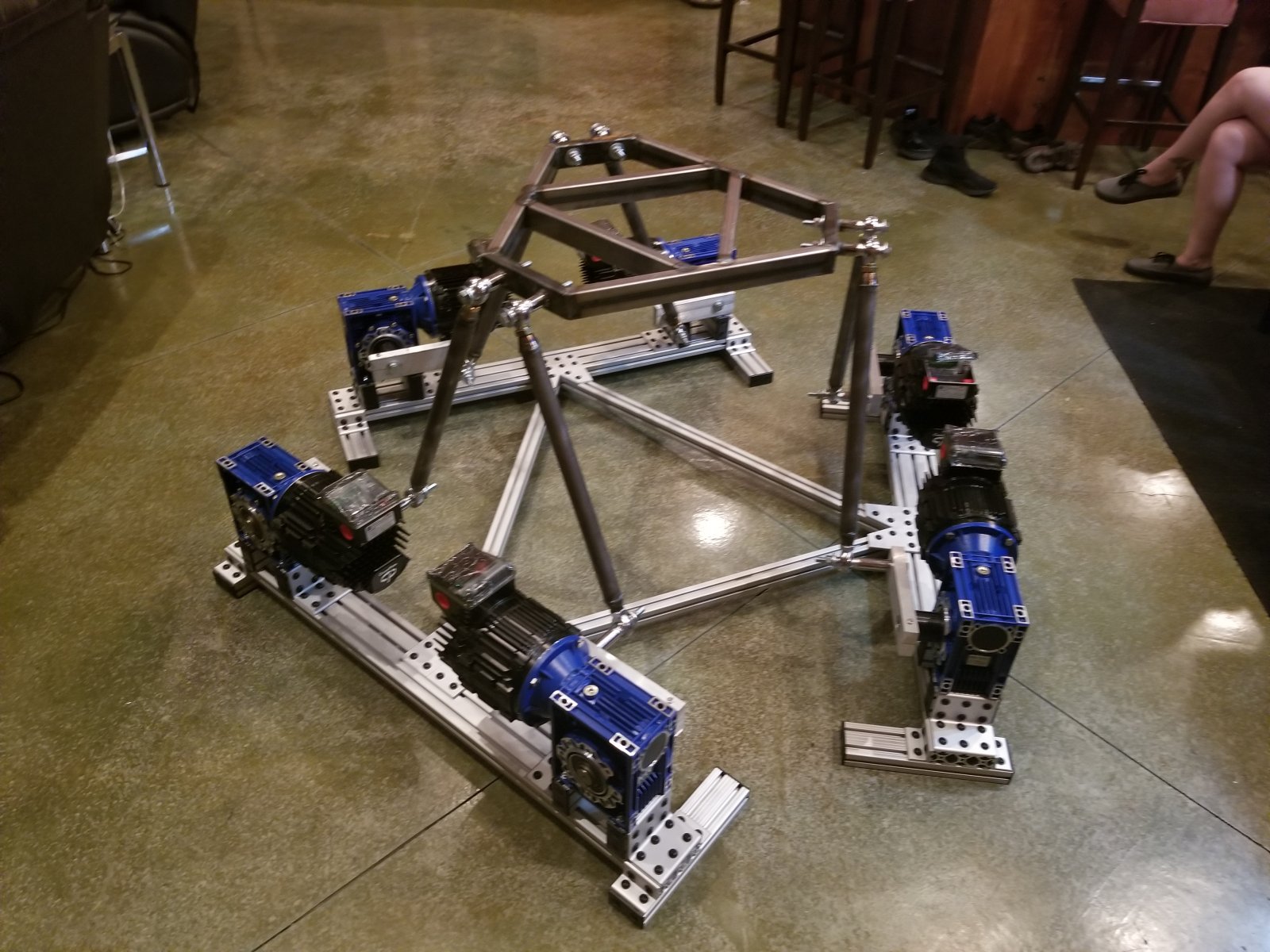

    So I beefed up the base a bit with some wider pieces and got the basic assembly figured out. About ready to move it to the basement and get it hooked up for some testing.
    Figured I'd post a few pics

    In regards to the profile used, for the base, I'm using 15 series. 1545 for the main base components (1.5" x 4.5"). I chose this because the gearboxes are approx. 4.5" wide. Then I used 1530 for the "T-legs" underneath (1.5" x 3") and then 1515 for the inner triangle brace (1.5" x 1.5"). I refer to it as 80/20 because I use aluminum profile from 8020.net, but I'm using the fractional extrusions, not the metric.
    For the 1545 pieces (the main outer triangle under the motors), those are 48" long. Taking into account the brackets holding the gearboxes on, it puts the motors at 910mm apart from each other, which was exactly what I was going for (basically the shafts are 36" apart from each other). Being a triangle, that was 3 total pieces of 1545 for that component.
    For the "t-legs" underneath, those are 12" pieces I just had laying around I want to increase the length of these to increase the stability a bit, but they're 1530 pieces, 12" long, 6 total.
    for the inner triangle brace, I'm using (3) 40" long pieces of 1515, With that length, it puts my spacing between the output shafts at 500mm.
    In regards to the profile used for the cockpit, I followed the plans here (the top "Low and Light" design, low isn't an option since it's 3 feet in the air and light was the goal):
    https://i.imgur.com/AsxPuja.jpg
    I played for a couple hours last night and did not experience any screws coming loose. I do have to add some bracing to the base to minimize the slight flexing it is experiencing. I just am going to add braces between the tops of the gearboxes and that will solve that problem, for the most part.
    I also have thread locking compound that I will be putting in everything once I settle on the design and don't intend on changing it anymore. I'm about 235lbs and it feels quite solid with me in it and I will be able to achieve only so much rigidity because I cannot bolt it to the concrete (like many people do, such as @Trip Rodriguez does). My basement has in-floor heating, so I can't run the risk of damaging the heating lines in the concrete. So my option is to build it wider with the t-legs underneath each main portion of the triangles and add bracing to the tops of the motors (which it would appear everyone does anyhow).
