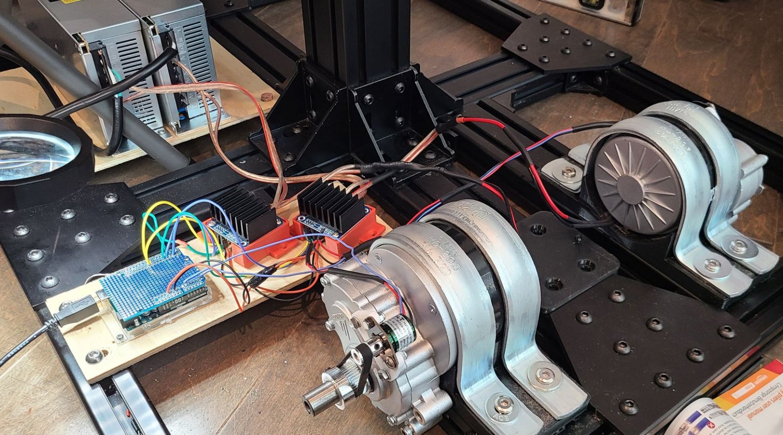

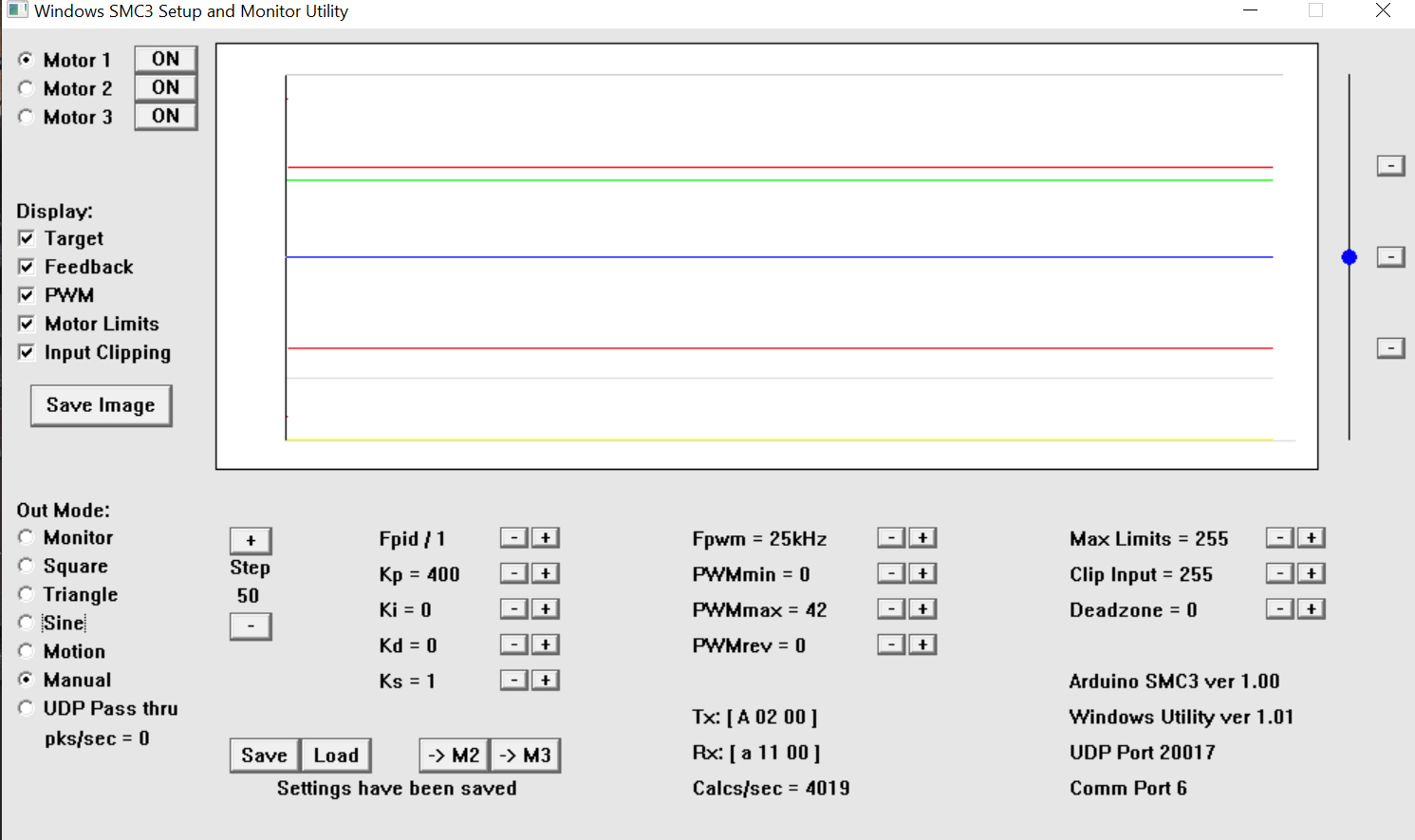

    I'm trying to get my motors to respond but I don't really understand how to use SMC3. I have 2x 24v PSU's; 2x IBT2's 24v; 2x 75rpm, 24v, 250w motors; ard uno r3. Pots are 360 hall.
    I've followed these steps as best I can For #6, I don't see a "Clip" or a "Limit". I have "Max Limits" and "Clip Input" so I set those to 255.
    8. Set Kp to about 400
    10. Do the above for each motor
    My motors do nothing. They were initially "twitching" back and forth when I plugged in the uno but when I loaded up SMC3, they stopped. How do I proceed? Thanks so much.

    Sorry, I set Mode 2 already.
    I've read through those parameters several times, but I'm still not sure how to use them to get the motors to spin. It's not written for someone who isn't experienced in this stuff. For example, what is PID? Are my settings in the above ss correct?

    Thanks Noor, I included those initial steps in the OP to indicate I had already done them. I apologize if that wasn't clear.
    On a hunch, I disconnected the pot belts and sure enough, it's responsive now... I can make the green line move around by rotating the pot by hand and the motor goes one way or the other depending on which side of the neutral I'm on. So that's good news. Tomorrow I'll have more time to dive into the above info if needed.

    I've got both motors and pots centered and they're responding as expected. I'm assuming SMC3 is writing these parameters to the ard? I can't find anywhere a description of what it actually does other than control the motors. The reason I need to know this is because I don't want the limits I've set to disappear if I'm not running SMC3 and put a hole in my floor and break off the pots.
    So does SMC3 actually make changes to the ard or is it just to make sure the motors are moving correctly before going into SimTools?

    Yes the SMC3 utility purpose is to set the values in the SMC3 code on the Arduino.
    You can't run SMC3 and SimTools and the same time, as that would create a port conflict.

    Thanks, someone before told me SMC3 doesn't change the code which is what caused my confusion. Everything is working now, just doing lots of tweaking.
