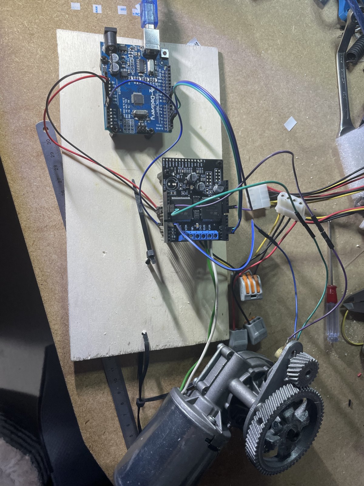

    thanks for helping, yes, i checked with the multimeter. it is a one speed and 2 wire only for testing purpose.
    btween ground and each wire there is no "bip" ^^'
    i took some picture. maybe it will help.

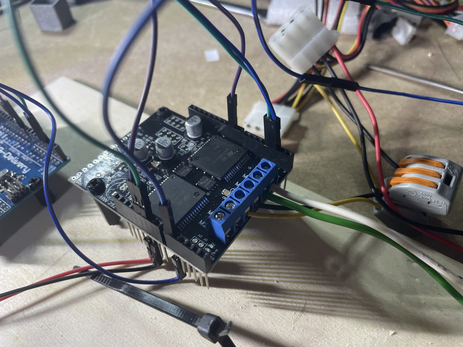

    sooo. i rechecked :p
    no issue on the motor. I expected it was the pot because when it should go backward, the led should light up but it was not the case. replaced and same happen... now i'm thinking maybe it is the Vnh5019. So i ordered another one.
    I'll change the arduino and cable to see if something change...
    I'll keep you posted ^^

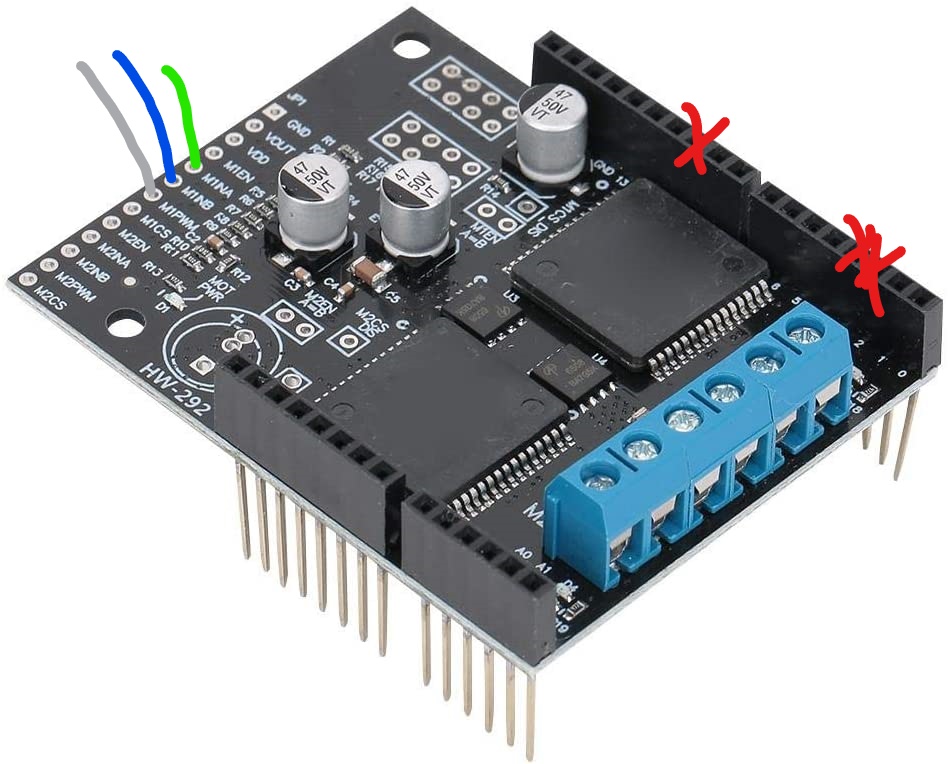

    hum...
    it seems that the black connector are not connected the driver... I fixed the cable as shown on the picture (instead of where it should be at the red cross) and it works !!!
    what a s..t it was supposed to be directly connected on an Arduino without any cable and it is even worth...

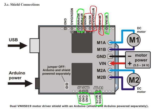

    Everything works. is it possible to update the 1st post warning that the pin numbering of the SMC3 is not fully matching the internal trace of the VNH5019 so it is not stackable.
    I don't know if only changing the Pin numbering at the beggining of the .ino file is good enought
    in attachement the pin matching in green / not matching in red
