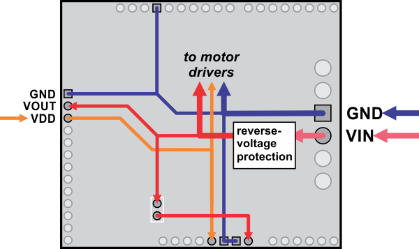

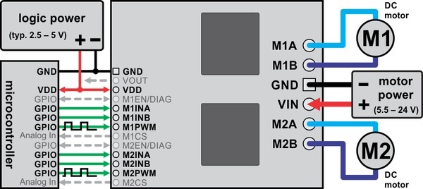

    On Pololu I found the hint, that the motor driver shield and Arduino are powered separately. When used this way, the Arduino must be powered via USB, its power jack, or its VIN pin, and the shield must be supplied with 5.5 to 24 V through the large VIN and GND pads on the right side of the board. Attempting to power the shield through other means, such as from the Arduino or through the small VOUT pin, can permanently damage both the Arduino and the shield (only the large power traces on the right side of the shield are designed to handle the high currents involved in powering motors).
    I translate this as each board has its own power source and they have not to be connected on the 5V line.
    https://www.pololu.com/docs/0J49/3.c

    I agree motor power must be from other source, because some motors make spikes on PSU. I have bad experience with one source.

    If you dont power the vnh 55019 through the large vin and gnd pads then you dont have reverse voltage protection...
    Thats your major issue.
    And as you said this can permanently damage both the Arduino and the shield.

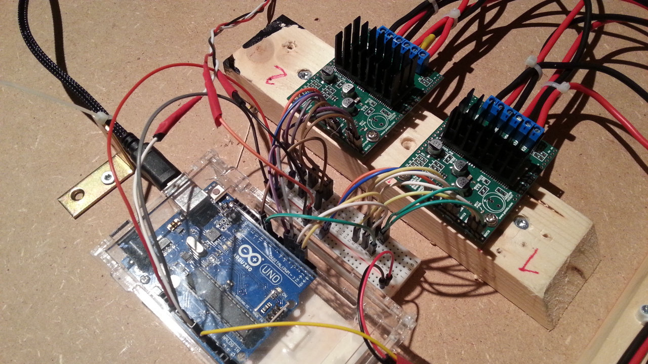

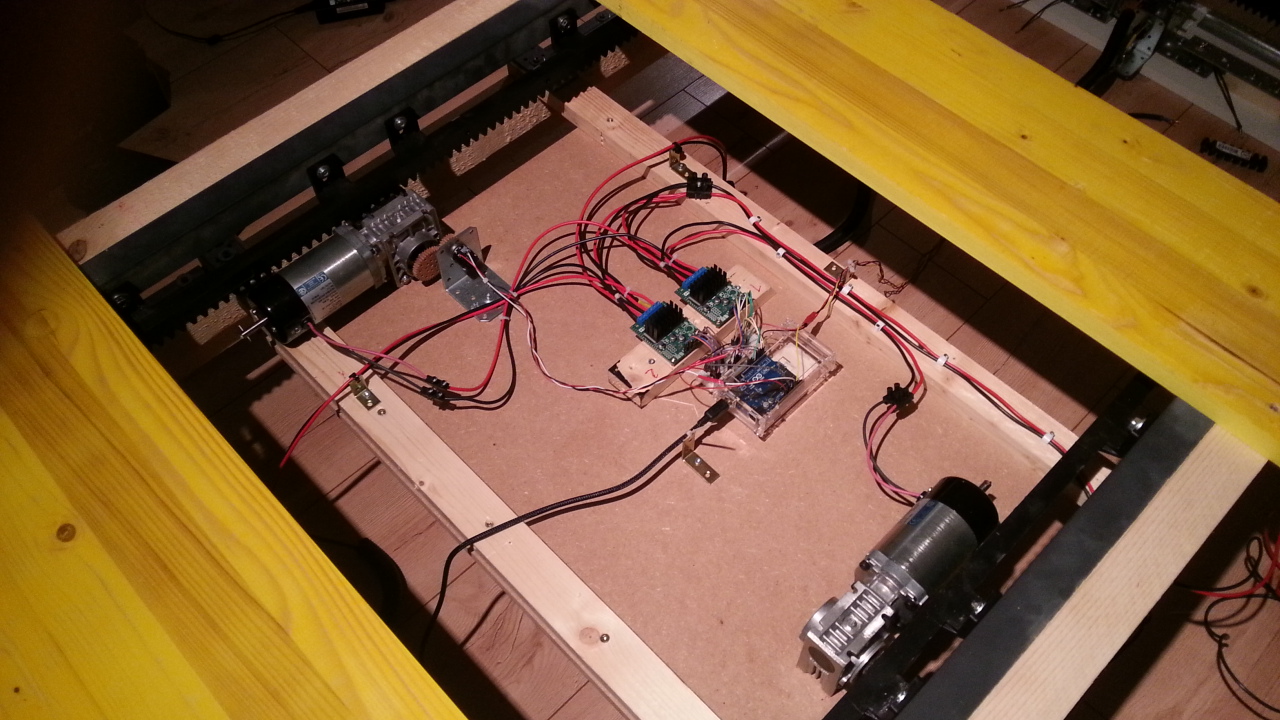

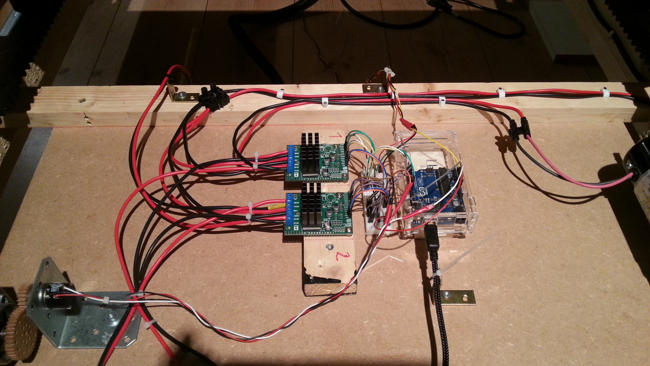

    Hey Pit, I was pointed to your post by Noorbeast. I am going to be using a VNH5019 on my setup, and will be connecting it to an Arduino Uno that I already have loaded with the SMC3 code. I was wondering if you happen to have a connection diagram for how things translate to an UNO board, as I do not fully understand how to translate what you have shown to my board. Perhaps I am just looking at it wrong. Thanks!
  5. Pit
    3,013
    30,417Coins
    +3,088 / 31 / -0

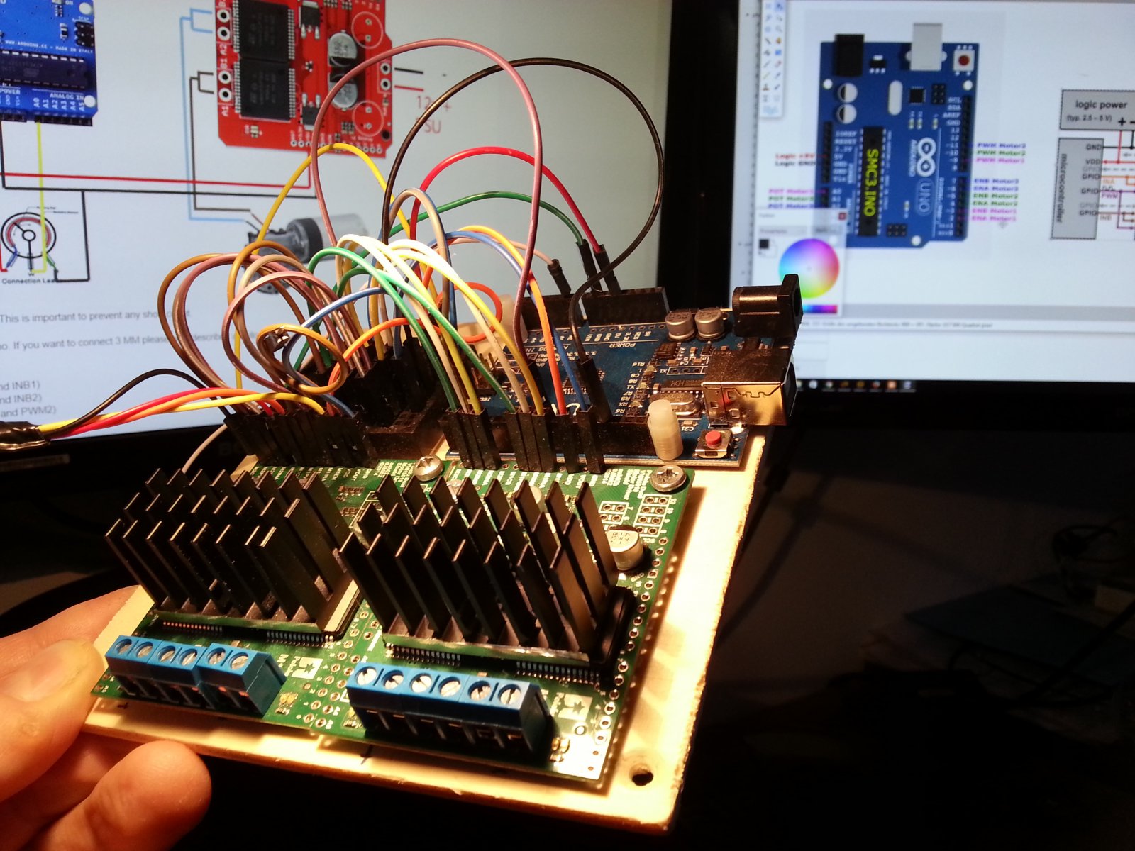

    Hi Scotty, the VNH is pretty the same like the MM, NTL I can upload a photo taken from a combo.
  6. Pit
    3,013
    30,417Coins
    +3,088 / 31 / -0

    So that didn't go as planned. I must have had an issue with the wiring between the Uno and the Pololu. When I connected the PSU to the Pololu it popped the Uno. I'll try again wednesday and see where I went wrong...hopefully I didn't knock them both out!

    You can destroy the vnh if it was wrongly connected to the pole of the PSU. If you read carefully the SMC manual you will determine all pinouts of the MM and the vnh have identical or similar labels.

    The psu connection was good. I determined that the problem was a jumper in the wrong plug of the arduino. It was bound to happen eventually, as good as my luck has been so far :)

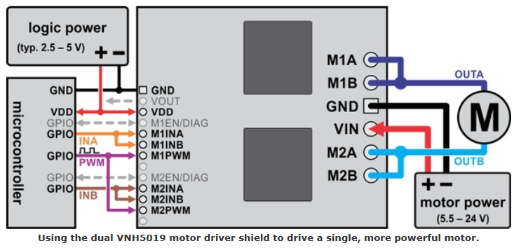

    Trying out spaghetti syndrome, vnh5019 as a double combo single driver...waiting for burning things :)
  15. SeatTime
    28,370Coins
    +2,844 / 39 / -0
    You should be fine - I have already done this in the past when I was testing 24V motors.

  19. Pit
    3,013
    30,417Coins
    +3,088 / 31 / -0
    theoretically yes, but practically I don't think so. The vnh5019 was my first 24V driver and I had serious troubles to get them working as a single driver on high demand currents or peak currents. Now testing as a dual single driver but with less powerful motors (24V, 160W)
  20. RacingMat
    2,234
    20,895Coins
    +2,084 / 21 / -2
    at 7 amp, the driver should be fine
