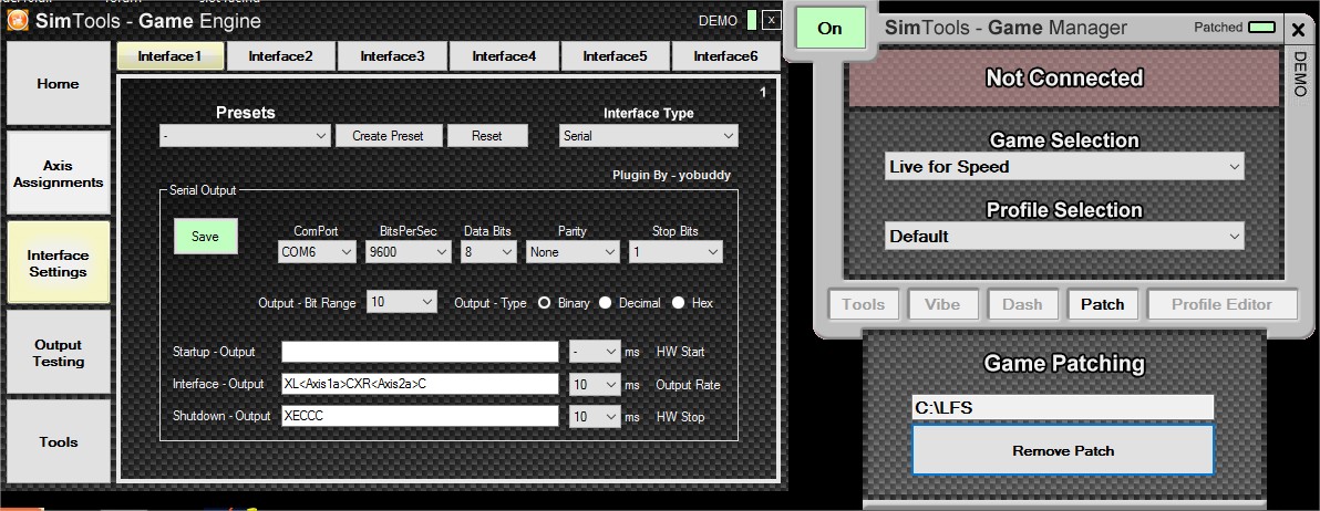

    Please post picture of all your Interface and Axis settings.
    One person had a similar issue with a borked .NET install.

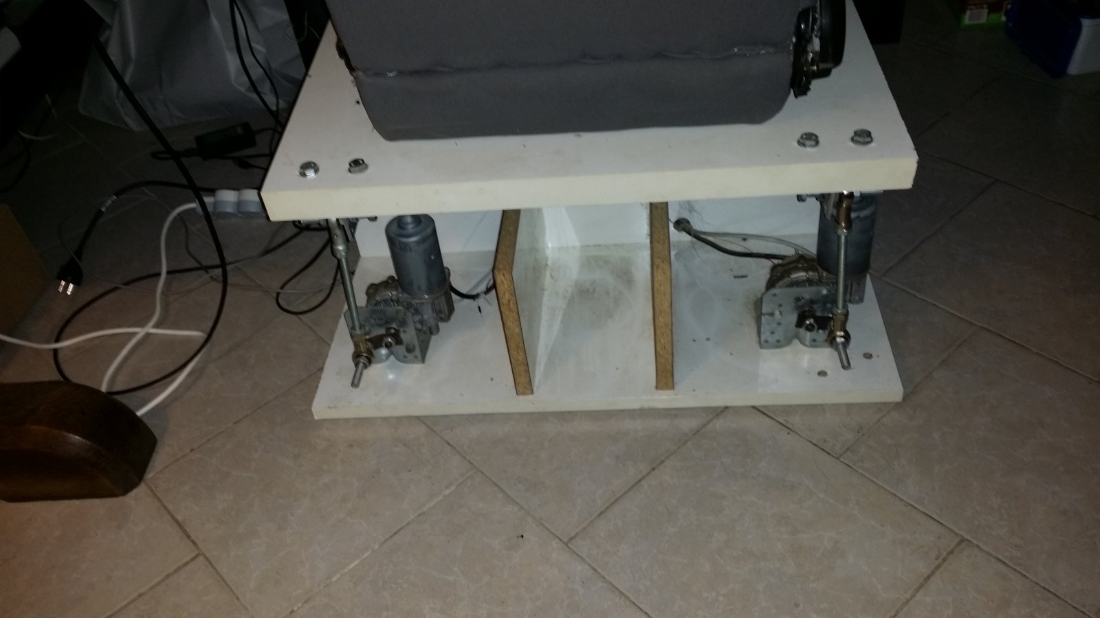

    Are your motor mounts bending yet? Im not sure those flashing l brackets are going to support those motors once you are under heavy movement. May want to use some thicker l brackets on the opposite side to add stability. Maybe not but I would imagine you will see flex over time and this can cause issues depending on how you mount your POTS.

    You have not said what code you are running on the Arduino.
    In the settings you have not specified the ComPort.

    Yes I put the port on the picture there is not it was a test

    I just noticed that my picture was bad sorry thank you

    I still install simtools v2 and on output testing engines run and gamemanager stays on not connected i understand more

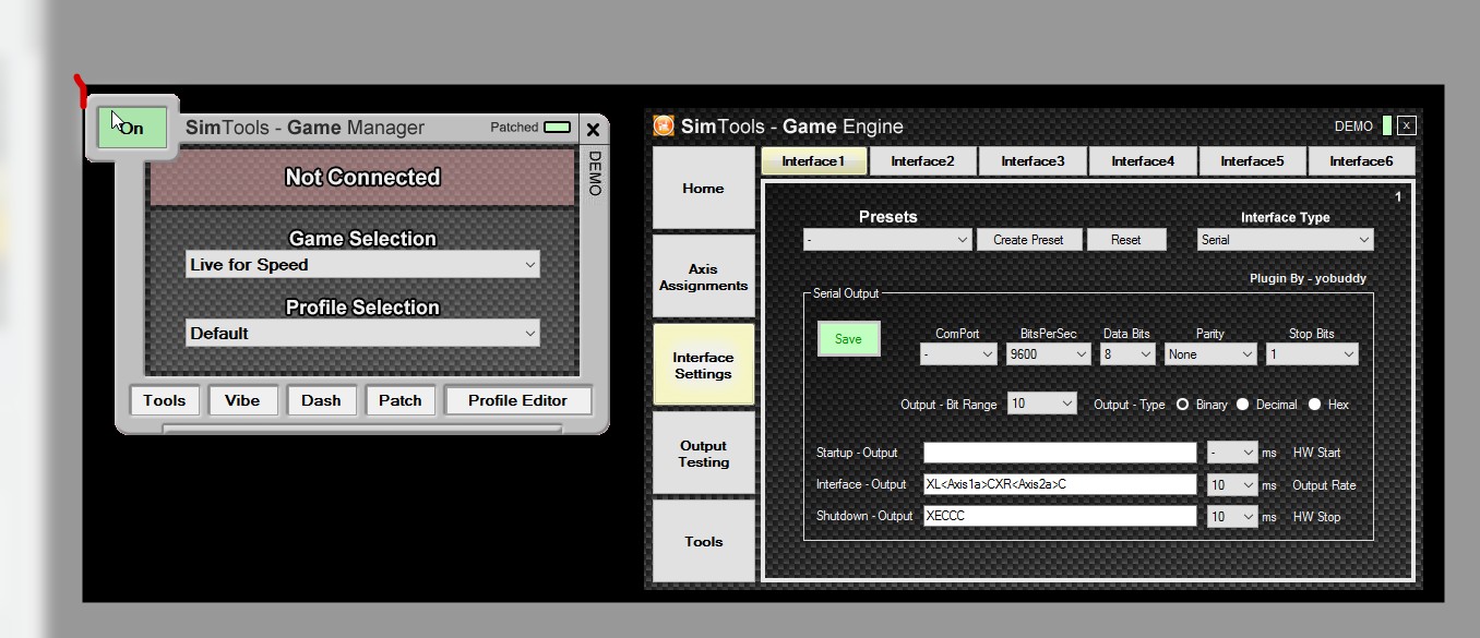

    Simtool does not keep the settings in interface settings

    I tried and it does not work I do not know what to do :(

    @MWB ended up reinstalling Windows as it was the problem, not SimTools.

    With @MWB it looked to be something that confused Windows into mixing localhost with its IP.
    So if it is the same issue start looking at network configuration and anything that may be affecting it.

    I did a network reset and the problem remains the same I disabled the firewall too and the same
    I just put another pc for the game engine is it works my gamemanager is connected, it does not help me because I would like a single computer
