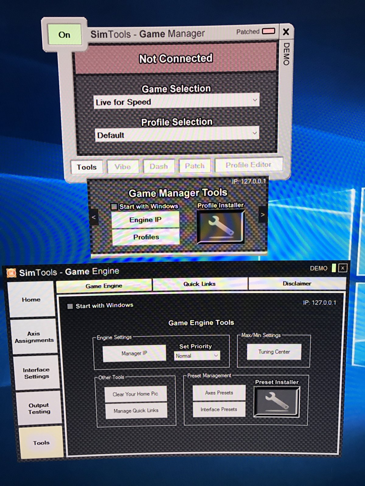

    Just checking that in Game Engine under Tools the Manager IP is 127.0.0.1?
    I suspect something in your network configuration is messing with what is called localhost, which is 127.0.0.1.
    What specifically are you using for network connectivity, a dongle was mentioned, so what brand and model number.
    What happens if in your menu you search for cmd, open a command prompt and type this in it:
    ping localhost
    ping 127.0.0.1
    You could try this, but keep in mind we are asking you to modify your machine settings as SimTools is not really the issue, it just needs 127.0.0.1 properly defined:
    Go to %systemroot%\System32\drivers\etc
    Backup the hosts file
    Then open notepad with administrator rights.
    Navigate to the same folder and open the hosts file
    Make sure the first line after the # lines (comments) is 127.0.0.1 localhost and the second is ::1 localhost
    Then open cmd and run the command ipconfig /flushdns
    Restart SimTools.

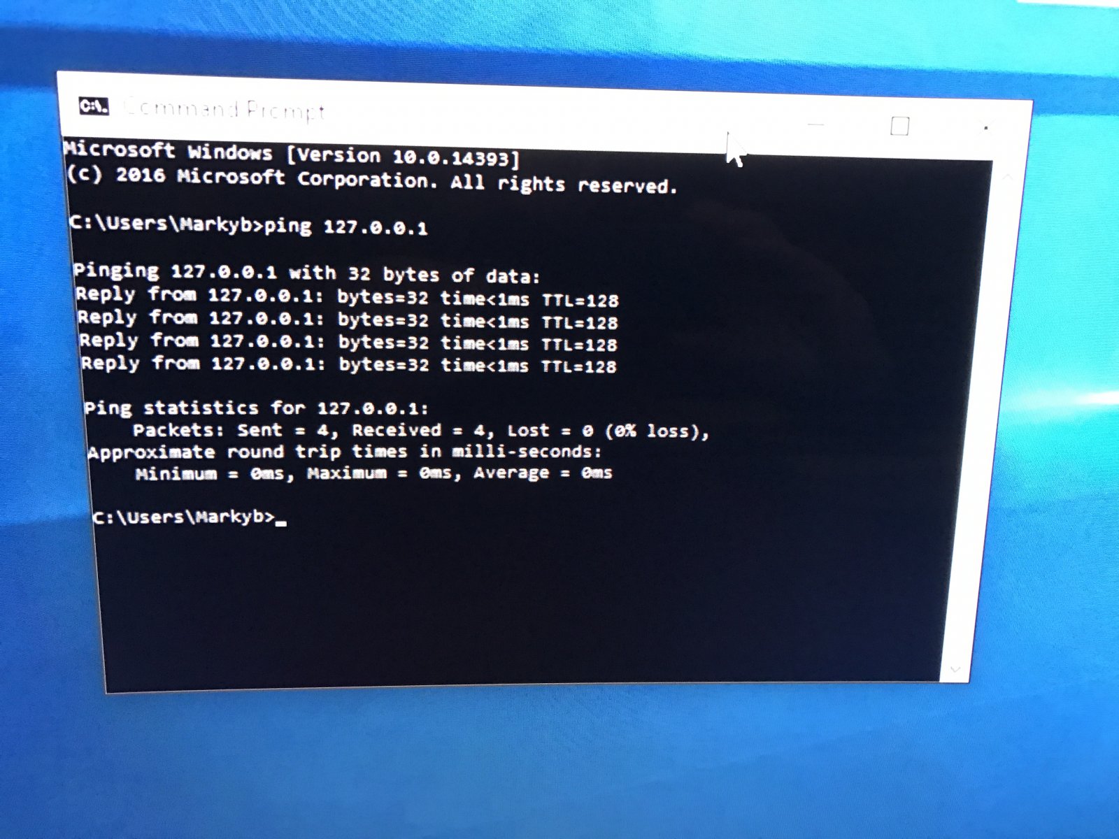

  7. yobuddy
    51,736Coins
    +5,205 / 19 / -0
    Hi MWB,
    Will you open a command prompt and type "Ping 127.0.0.1" and see what you get?
    thx man.
  8. MWB

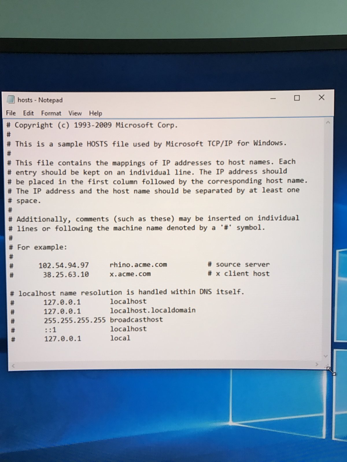

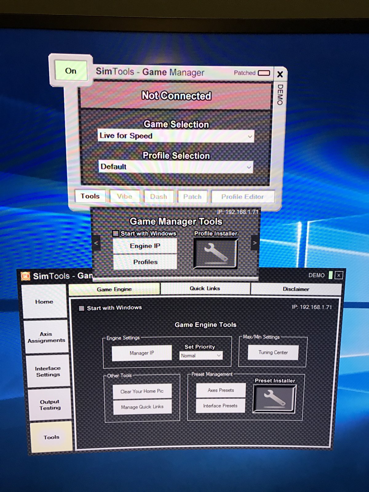

    And this is what's in the host file
    But for some reason I can't change the IP in Manager or Engine, The IP is stuck on 192.168.1.71

  12. noorbeast
    22,199
    154,657Coins
    +11,207 / 57 / -2
    What is the next bit in the host file, it should be something like this:
    127.0.0.1 localhost
    127.0.0.1 localhost.localdomain
    255.255.255.255 broadcasthost
    ::1 localhost
    127.0.0.1 local

    Hi @noorbeast, I removed the dongle, no difference, I removed the cat cable, and after I rebooted, the correct IP is on both programs, but still no connection, can't modify the hosts file, because it says I don't have a administrator rights to do so!! Can't work out the to get round this!

    You need to run notepad as Admin to modify the hosts file.
    Search for notepad in your menu, right click on the menu and select Run As Administrator.
    Add the details supplied earlier and save the hosts file.

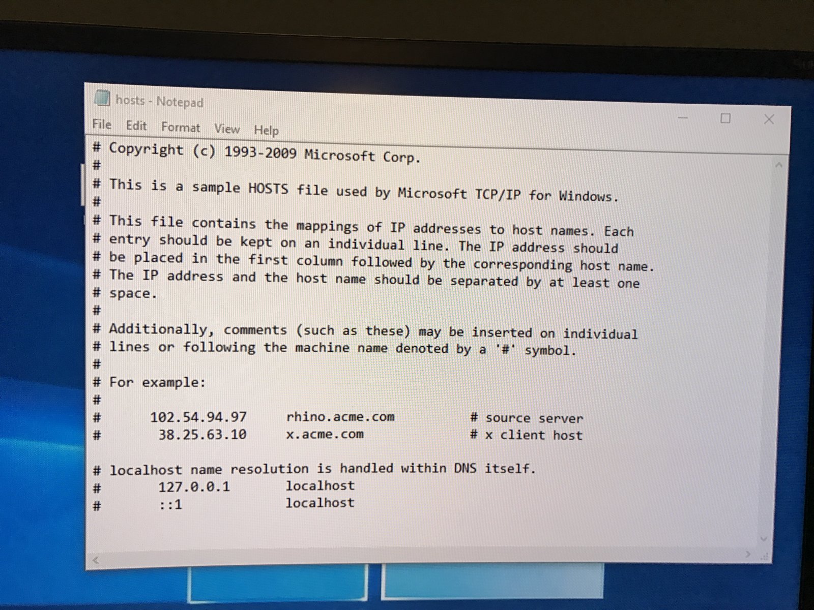

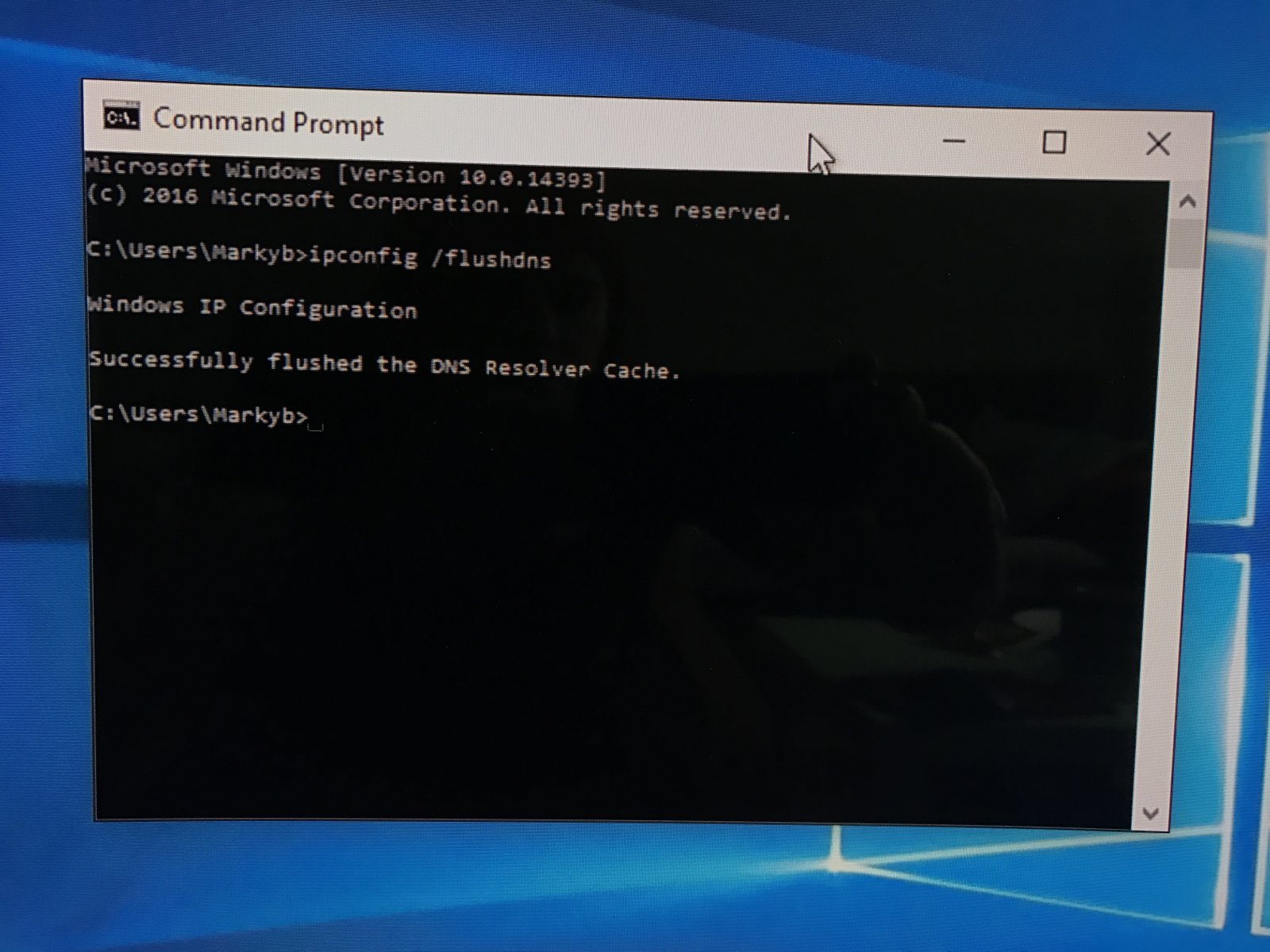

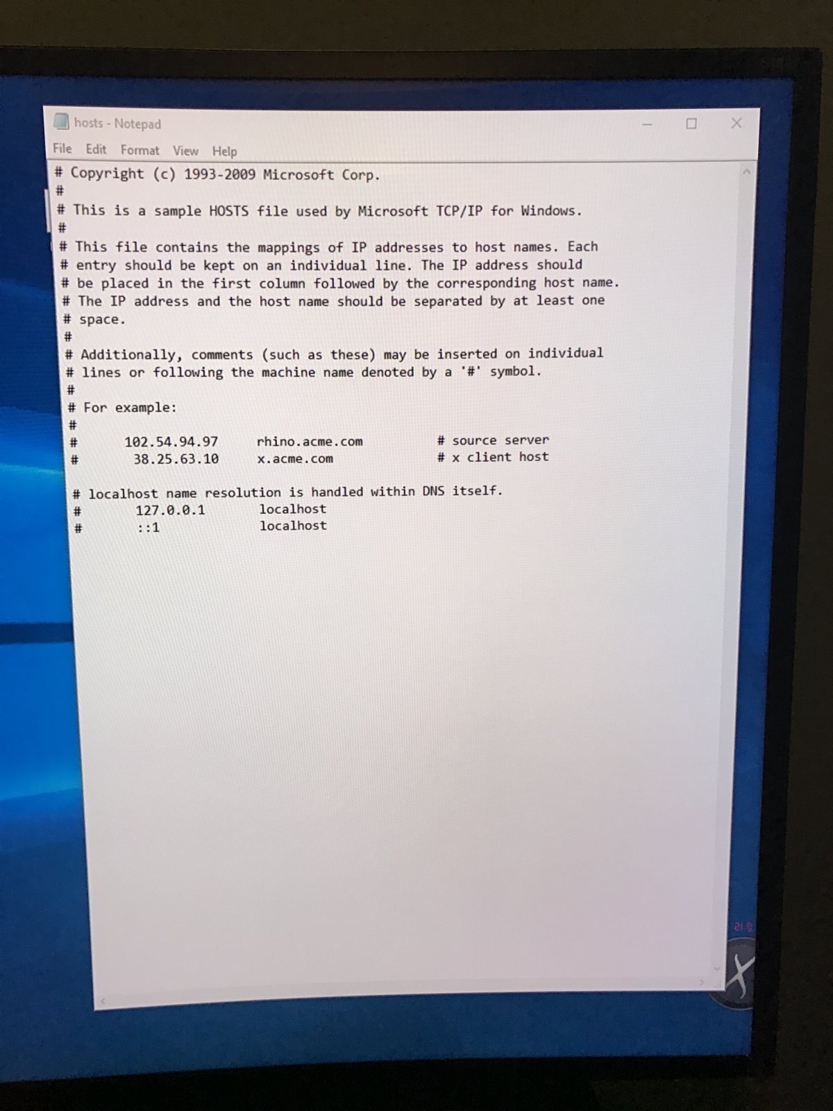

    Hi @noorbeast
    I modified the host file, hope this is correct?
    Then run the IP config in cmd
    Tried Simtools as administrator and normally, didn't connect.
    Rebooted PC and tried again. Didn't connect :confused: And I've disabled all Firewalls and anti virus software!
  20. noorbeast
    22,199
    154,657Coins
    +11,207 / 57 / -2
    Don't use the # that makes it a comment, mod the file with just these:
    127.0.0.1 localhost
    ::1 localhost
    127.0.0.1 local
    Then run the cmd again.
