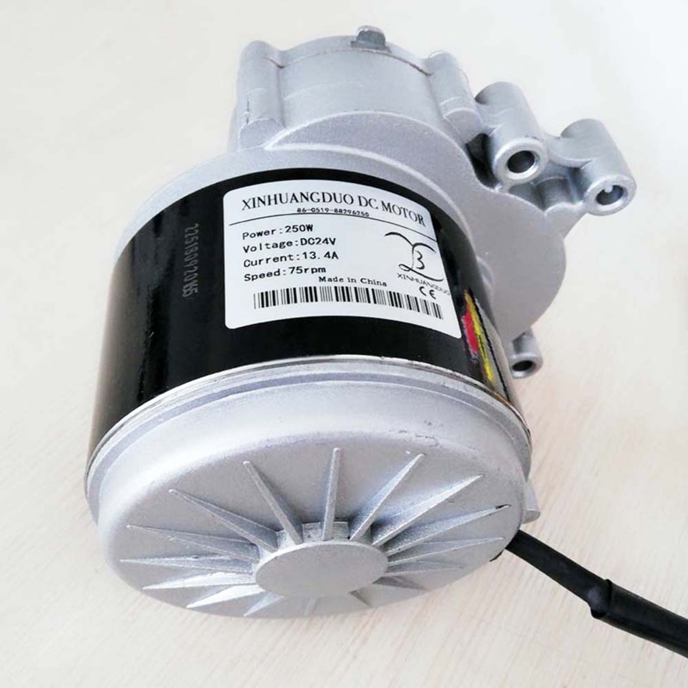

    Ok...you know from where can i get good motor? I mean from recycle? Like old car like scoter motor maybe?
    21,555
    150,950Coins
    +11,025 / 56 / -2
    An electric wheelchair is likely your best bet.

    For a compact design ideally you want something around 200-250w, preferably with 60:1, which should give about 35-40nm torque, those linked have too little torque for a compact design.

    But it must be stronger than the one i already installed

    I will check tomowro the car scrap and check the motors value....i must get more than 75rpm right?
    21,555
    150,950Coins
    +11,025 / 56 / -2
    It is not so much the rpm but the torque the motor puts out that is important.
    From @Kieth's build the motors he used can at least drive a knee mount design, though it is not clear what the torque output actually is.

    but if i put a spring in the back of the seat to help polling up will be better .. i want to know is this motor better then 12v wiper moter ?
    the motor i use its moving but hard to move and i think this motor will make diffrent
  12. noorbeast
    21,555
    150,950Coins
    +11,025 / 56 / -2
    The best advice I can give is that if you want to use weak motors then go for a design that has a lot of inherent leverage, like a shoulder mount, or if you want a compact design look for a motor of 50+rpm and more importantly 35+nm torque.

    The good news that my motor now work great and can carry the weight.
    The bad one is the motor goes very hot.
    How can i reduce hot temp? Is it normal?
  16. noorbeast
    21,555
    150,950Coins
    +11,025 / 56 / -2
    The motor is hot because it is being overloaded.
    Reduce the load on the motor or find some way to cool it.
    To reduce the load you can shorted the lever Center To Center (CTC) distance, or move the motor further from pivot point to provide more inherent design leverage, or you may need to do both to reduce the load to a sensible level.
