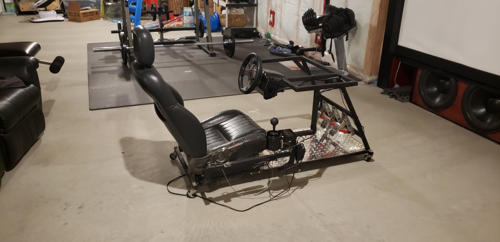

    Hi all. I built my race cockpit years ago and have been thinking of adding motion to it ever since. I finally built up the courage to start ordering parts and piecing together. My build is largely inspired by Arielnac's build.
    I have been using a 120" 1080p projector as my monitor but I just recently got the Rift S. Im hoping I can make the Rift S work with motion. Please let me know If you have any experience with this.

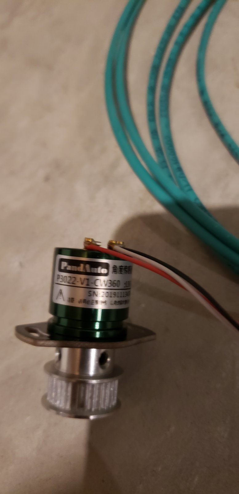

    #Aliexpress C$ 23.05 25%OFF | DC 5V Hall Angle Sensor Non contact Industrial 0-360 Degree Rotation Angular displacement Sensor https://a.aliexpress.com/_d88FkWF

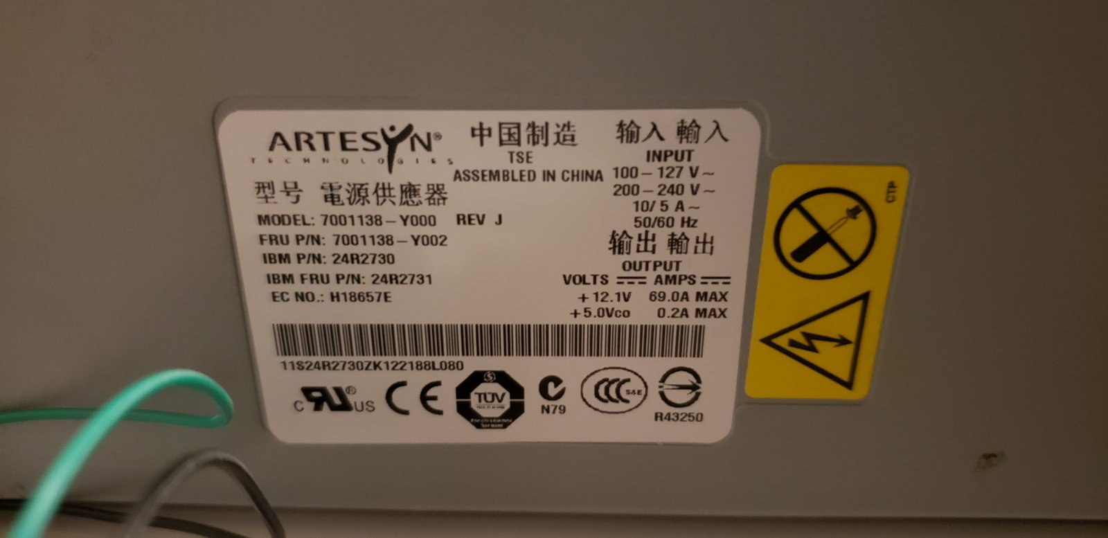

    Power supplies
    Artesyn 7001138-y000
    Just a heads up. You need to modify these a bit before using.

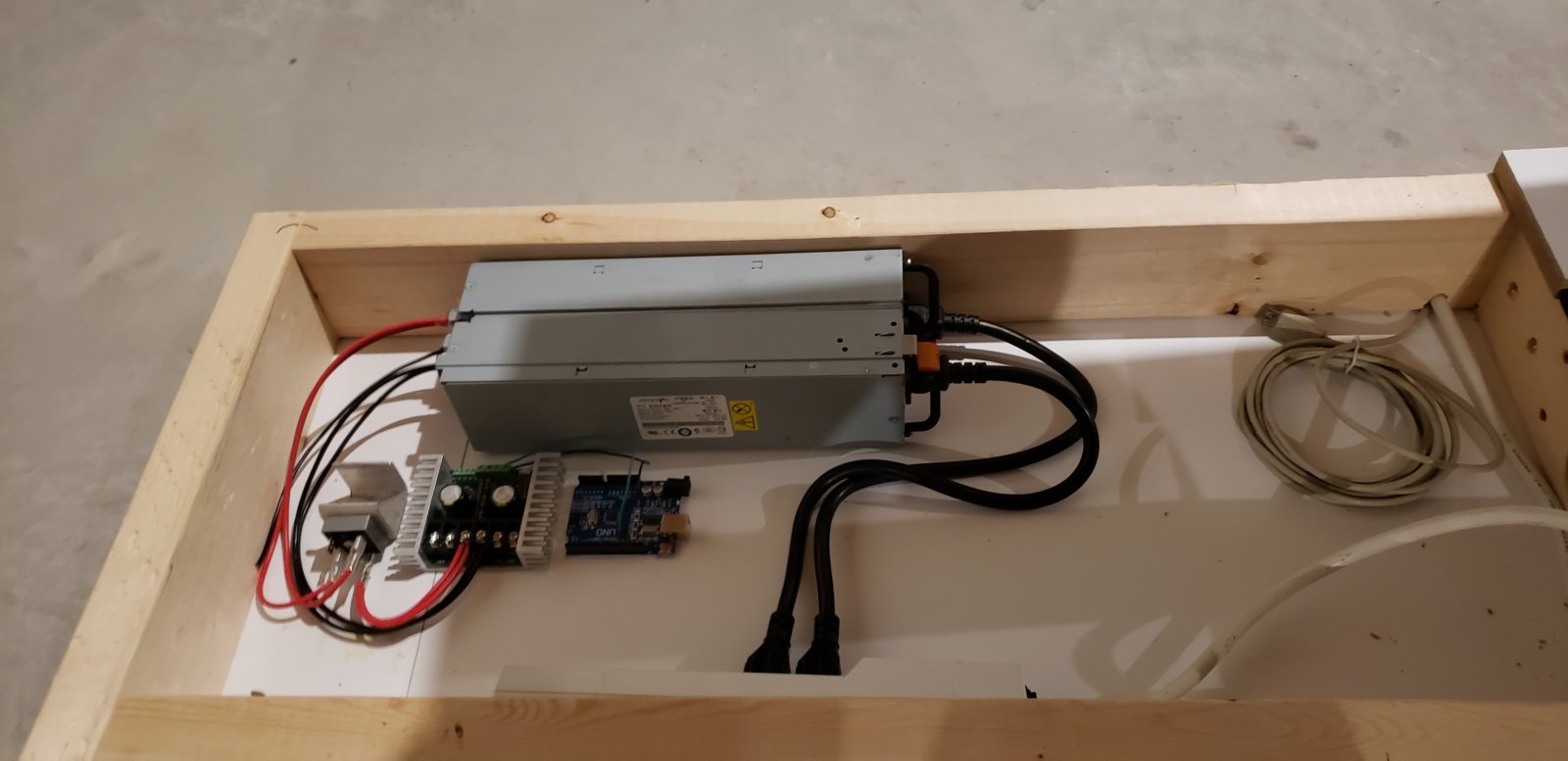

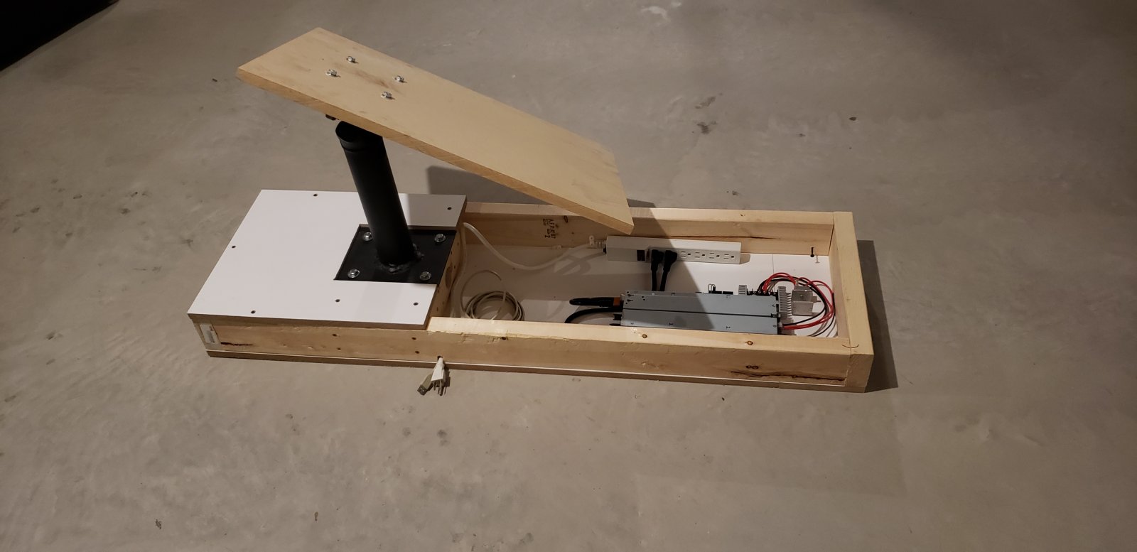

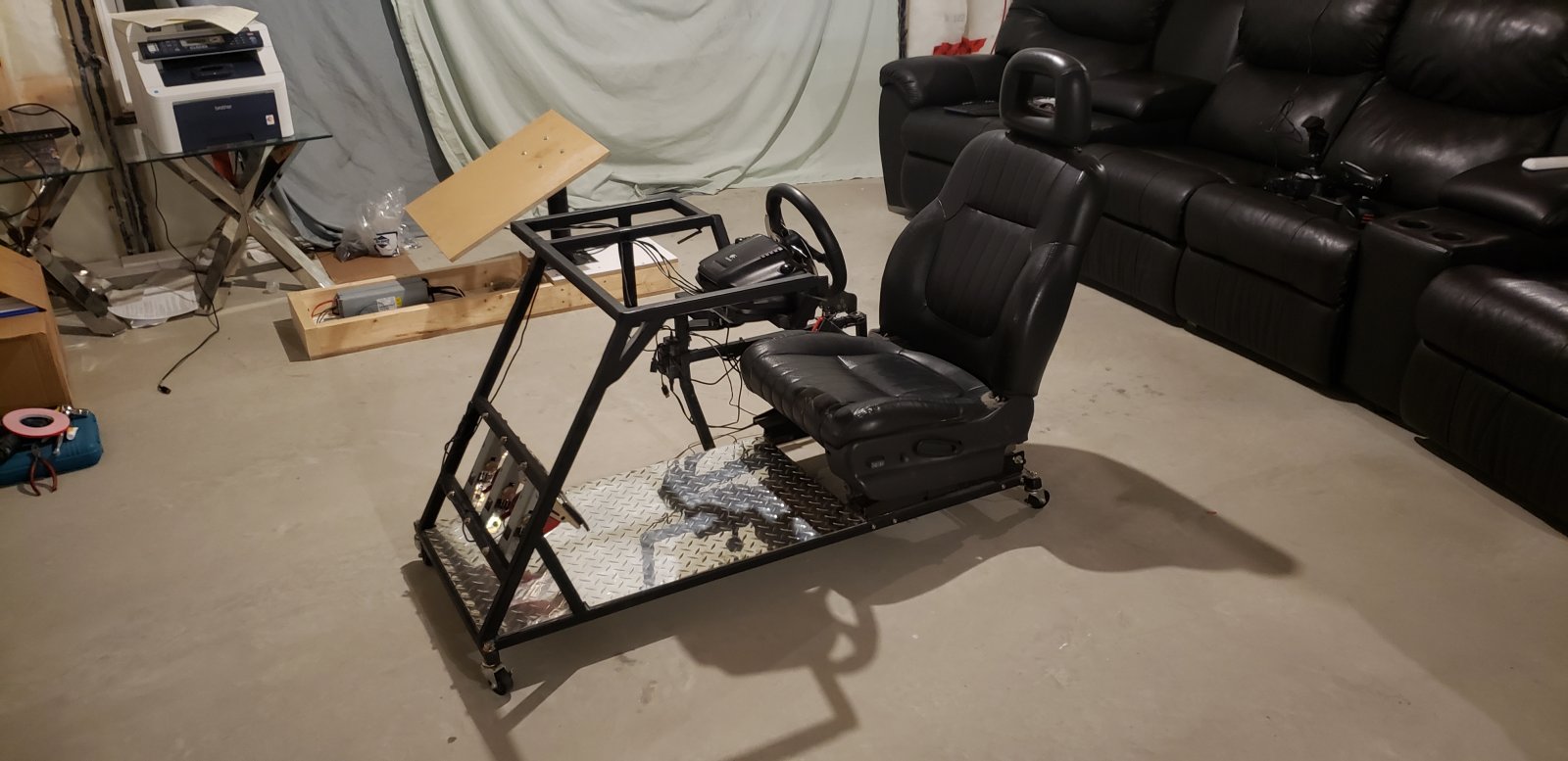

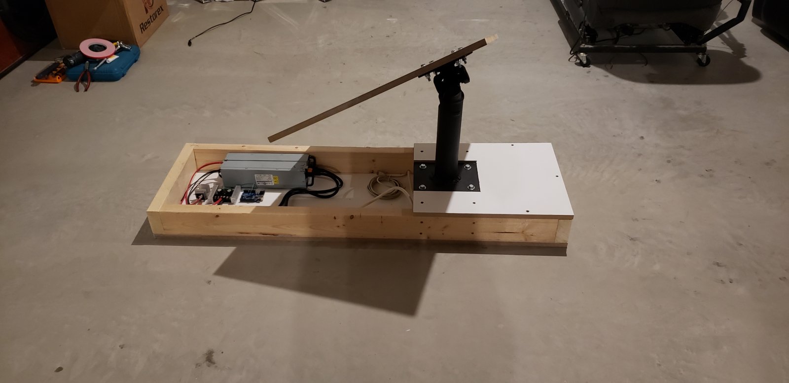

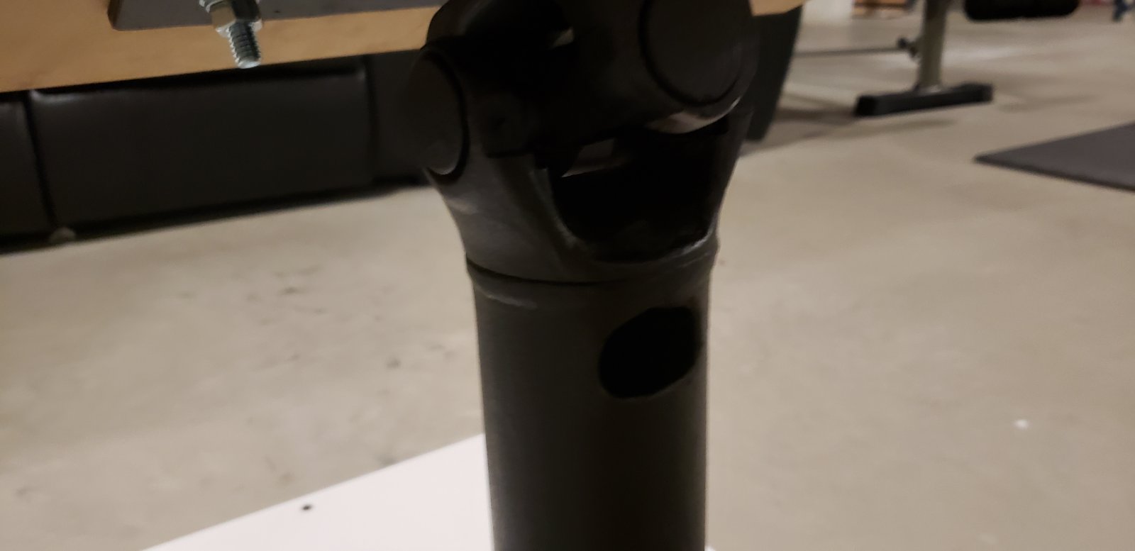

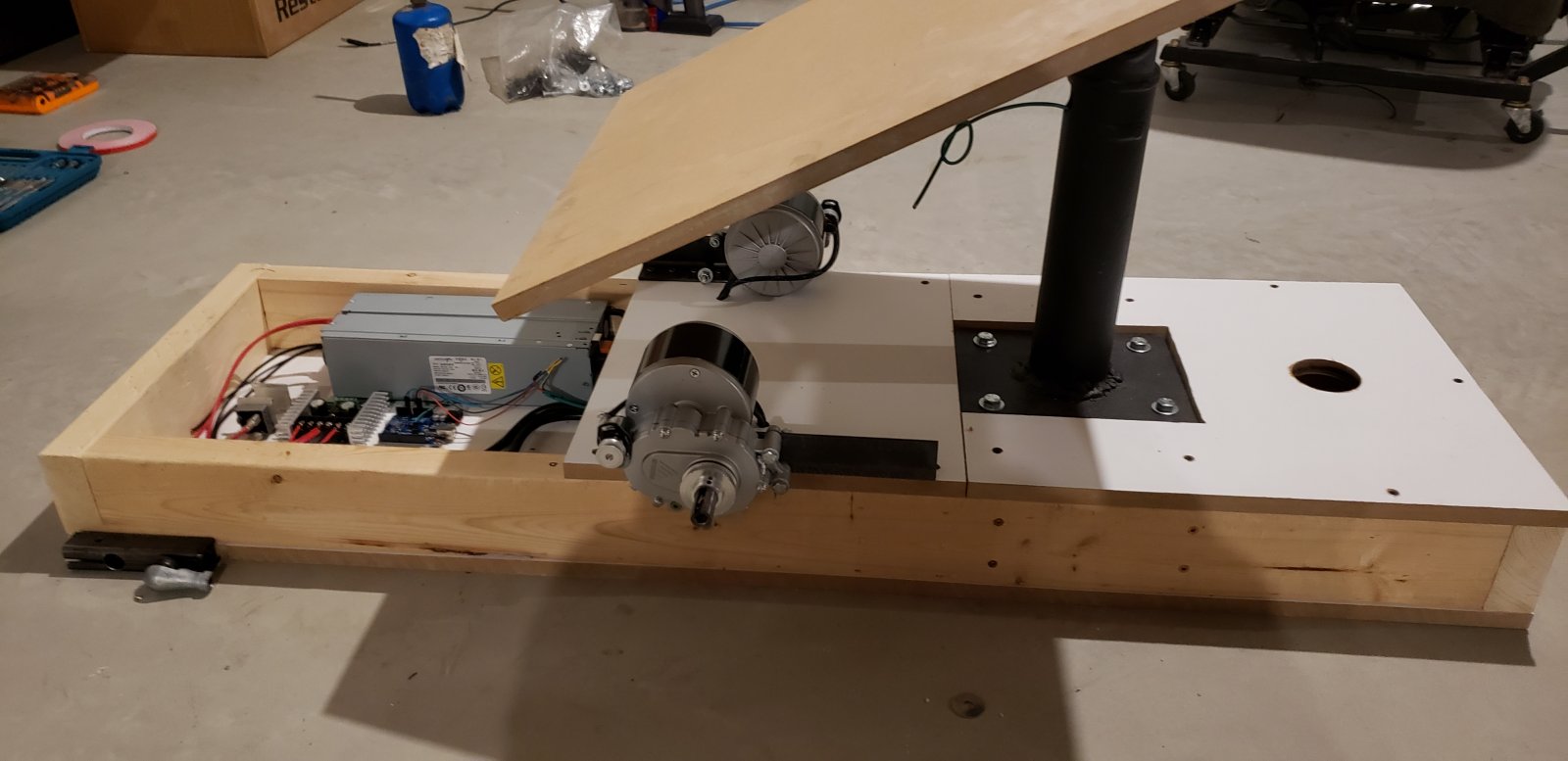

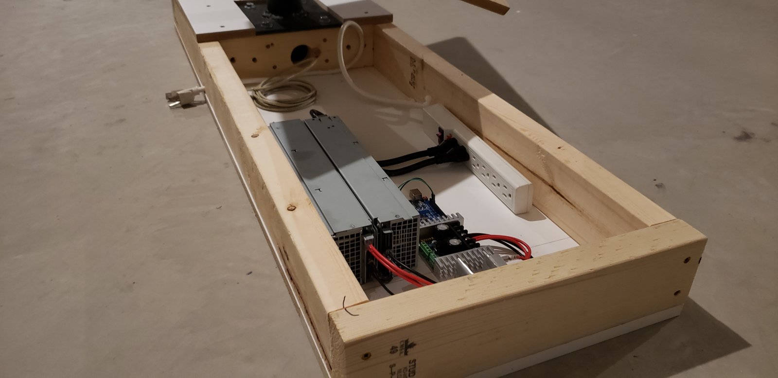

    This is what I have so far. I am still waiting for the motors.
    20200304_055341.jpg 20200304_055356.jpg 20200304_055437.jpg 20200304_060221.jpg 20200304_060247.jpg 20200304_060313.jpg 20200304_060348.jpg 20200304_060416.jpg 20200304_063316.jpg 20200304_063426.jpg

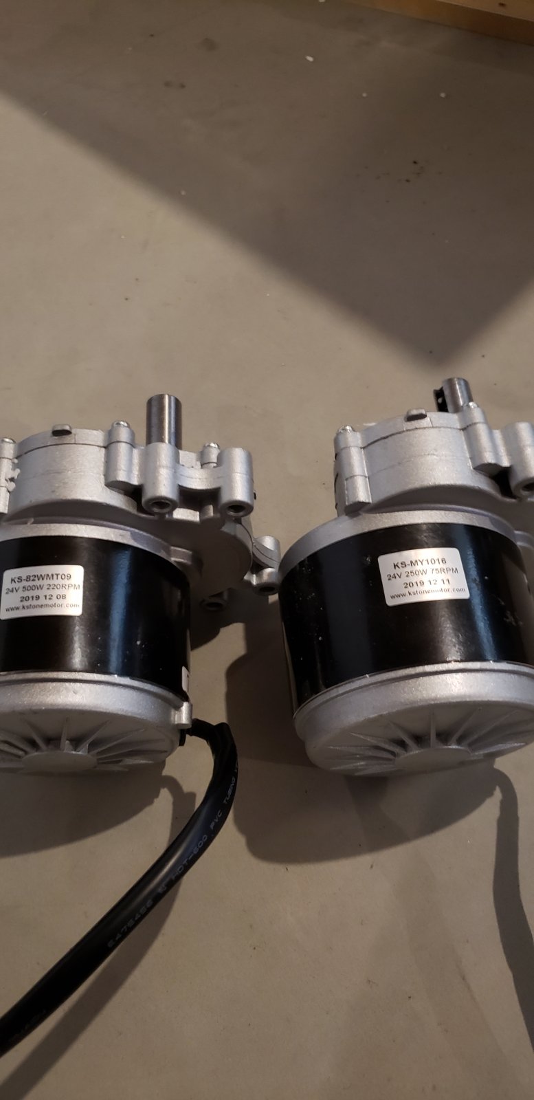

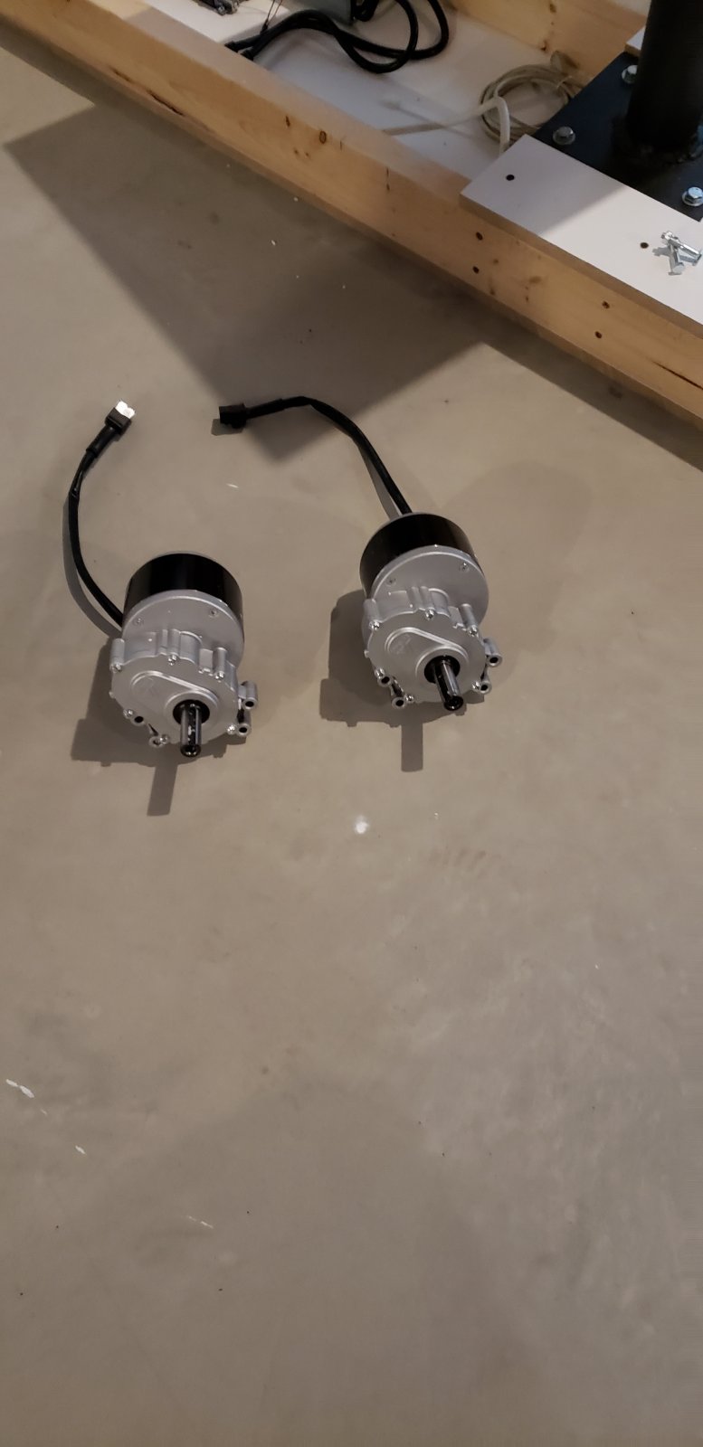

    My motors arrived yesterday. The one motor is labeled 500w 220rpm instead of 250w 75rpm. The seller told me it is just mislabeled. We will see.

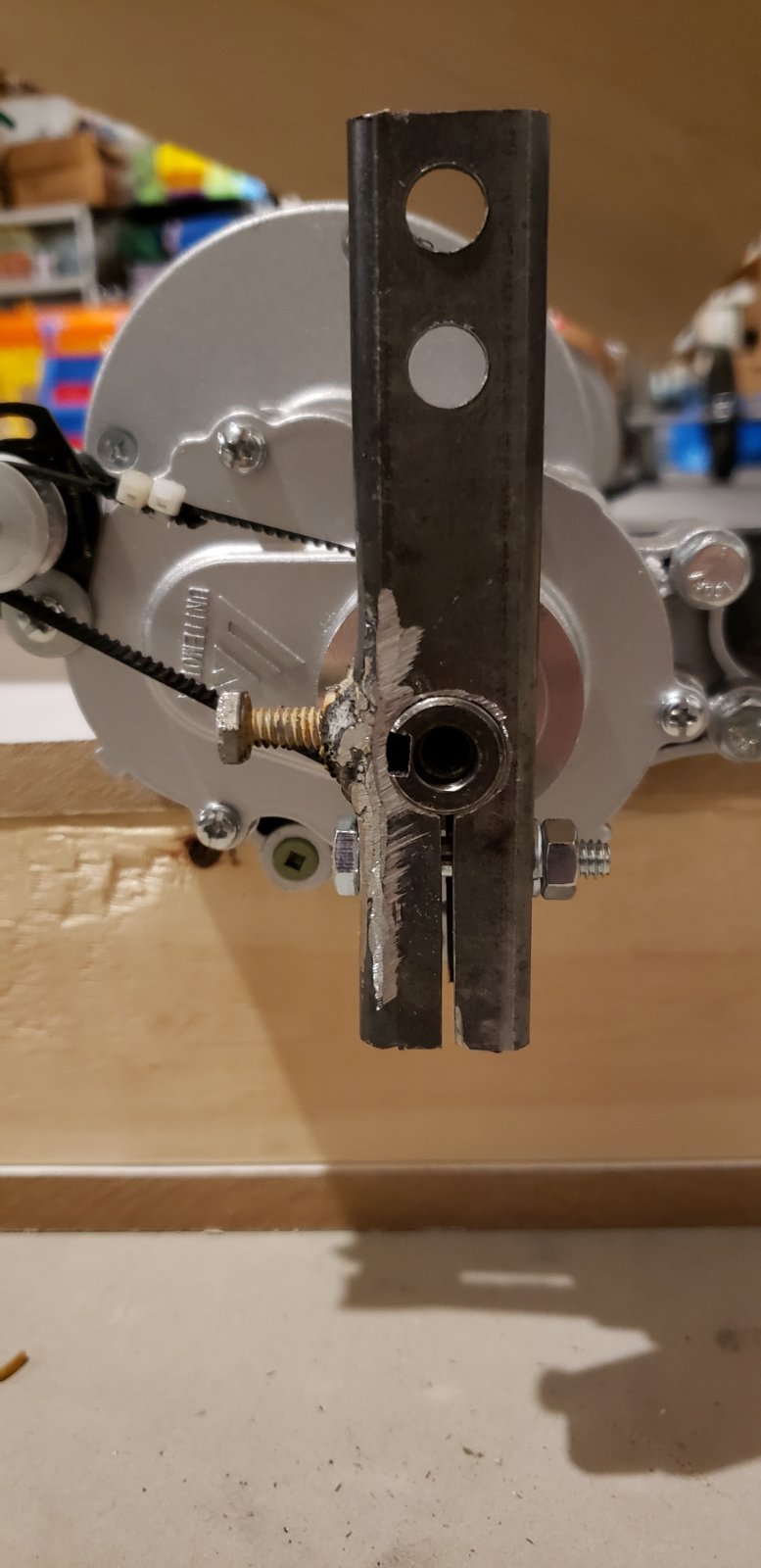

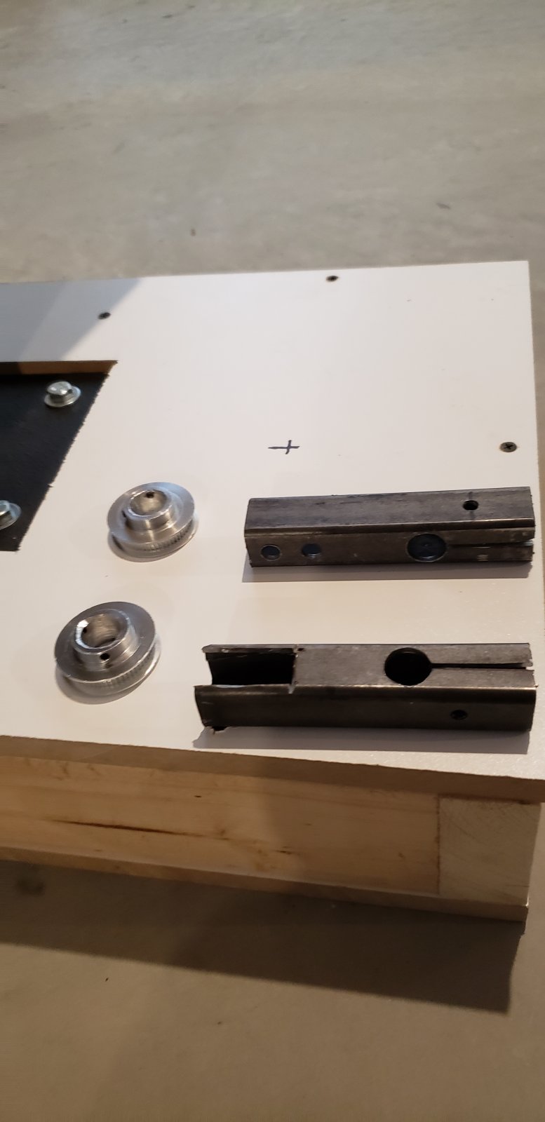

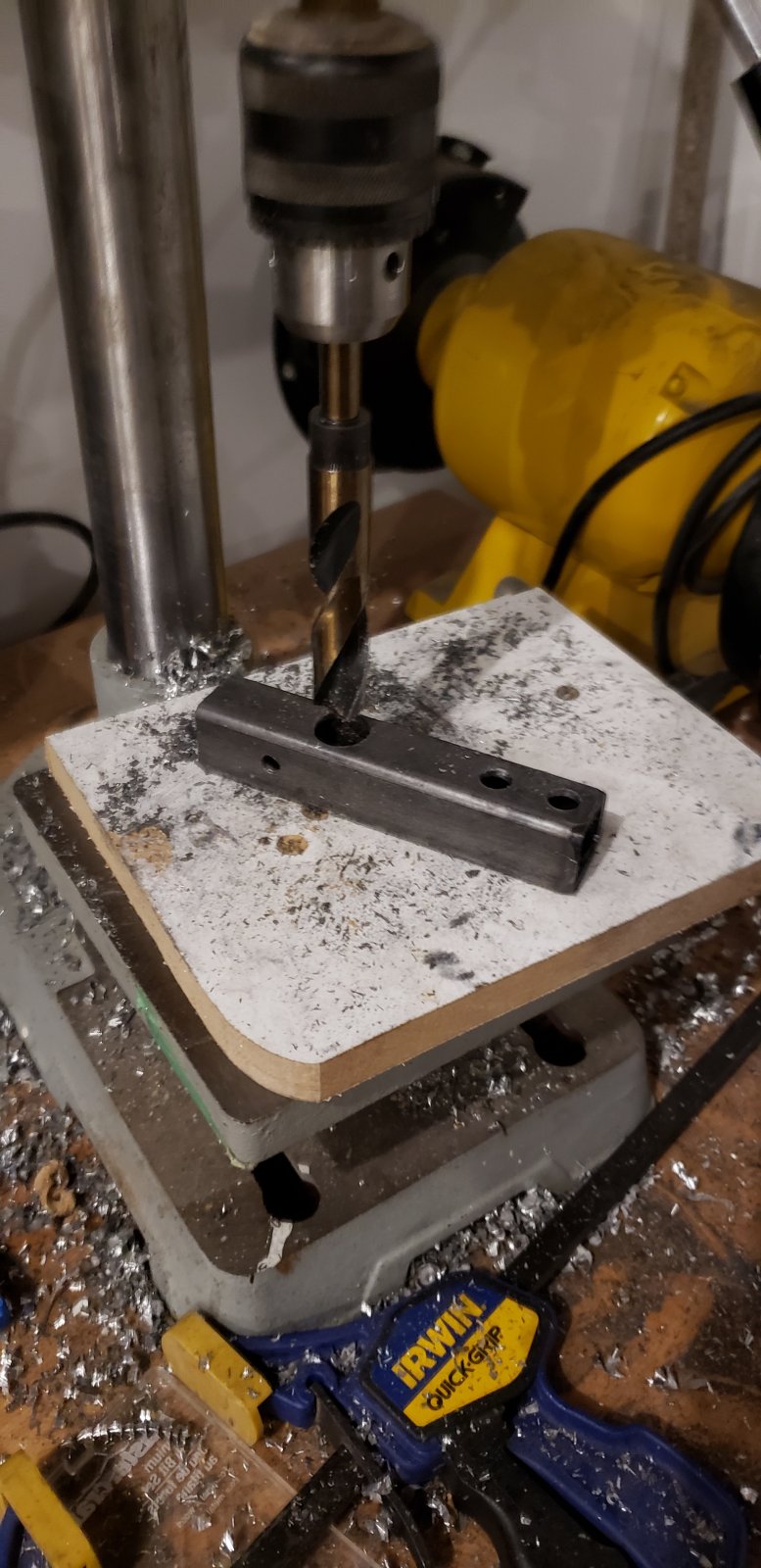

    Here are my levers. CTC holes at around 50mm and 70mm. I also drilled out the gt2 pulleys to fit over the motor shafts(17mm)

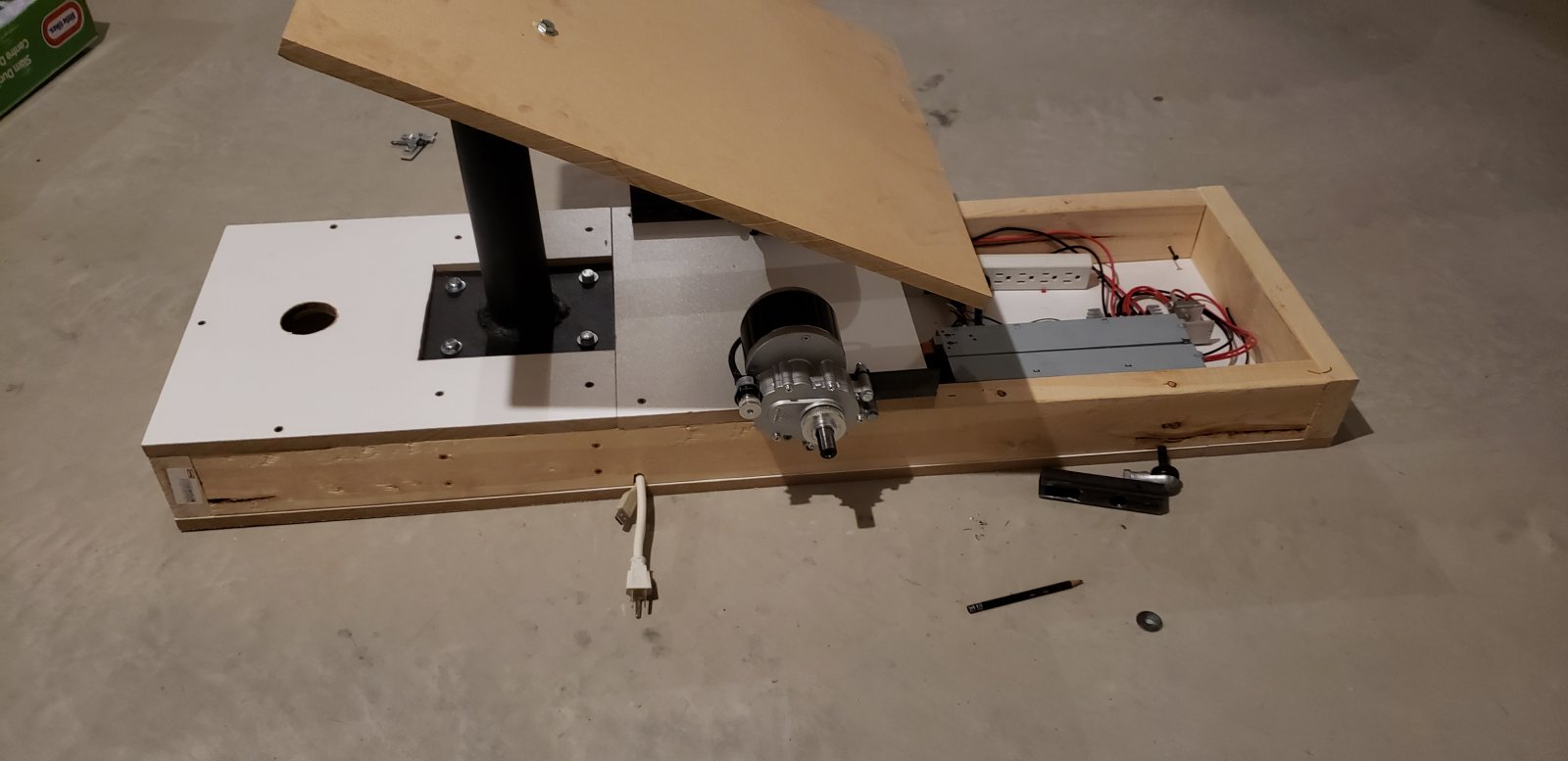

    I added a set screw to the levers. The screw fits perfectly into the notch on the motor shafts.

    Testing the motors. Should I change the polarity on one of these motors? One is going up and the other is going down.

    Anybody know? Im moving the 2 axis sliders upwards. One lever is going up and the over is going down. Do I need to change the polarity on one motor?
  12. noorbeast
    21,603
    151,275Coins
    +11,033 / 56 / -2
    I don't know which axis you have configured in the video, the movement would be OK for sway but not for pitch.
    The DIR check boxes in Axis Assignments being checked green or not determines which way and axis moves and this is how SimTools expects a rig to be configured: https://www.xsimulator.net/community/faq/which-way-to-set-simtool-axis-movements.230/
    You can have DIR boxes in a non-standard format but I think it better to switch the polarity and configure the DIR to reflect what SimTools expects.
  13. BlazinH
    BlazinH Well-Known Member
    Oct 19, 2013
    2,145
    Oklahoma City, USA
    16,659Coins
    +1,839 / 32 / -1
    I didn't know there's a standard format thus the need for dir boxes. Game plugins themselves aren't always standardized either.
    In any case since the motors are following the pots and they're hall pots where you can't reverse polaity you can only use the dir boxes to change directions.

  14. Keith
    Keith Active Member
    Jan 21, 2020
    179
    Electrician
    Canada, Saskatchewan
    148Coins
    +83 / 0 / -0
    Ok. Thanks for the responses Noorbeast and Blazin.

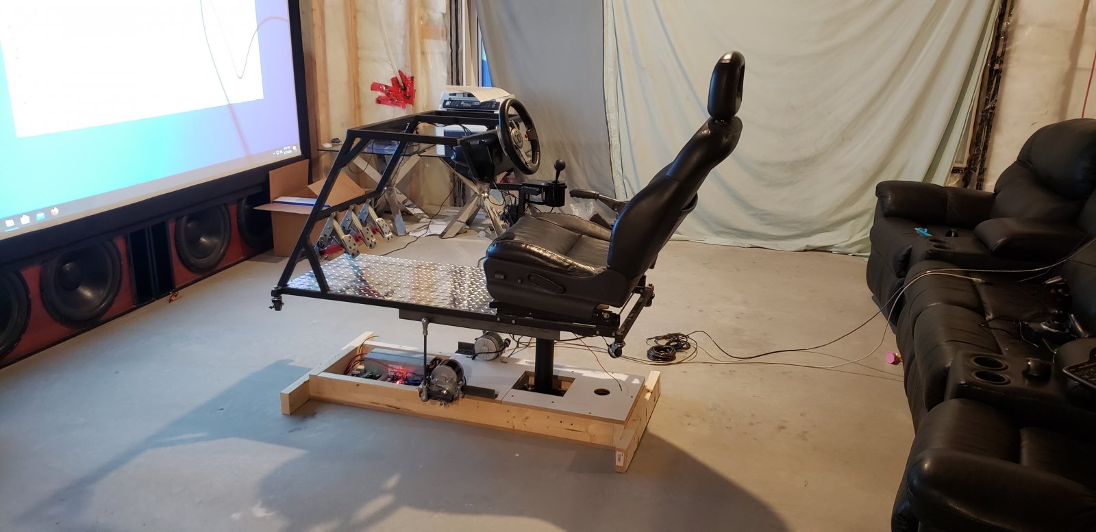

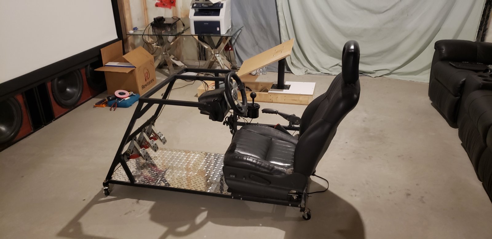

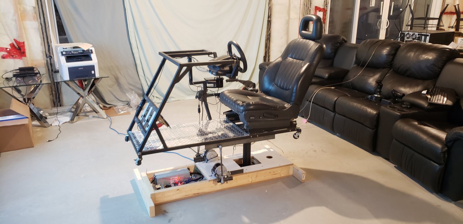

    I got my 150lbs cockpit mounted to the motion platform

    Doing some testing with live for speed. Not too much movement here. Maybe I need to crank things up a bit

    Thanks Noorbeast. Here is another video with more testing. I changed the CTC lever to 70cm
