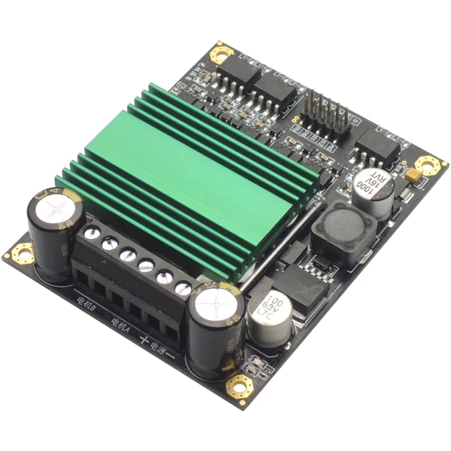

    could anyone help me please?, i stuck on wiring and i cant continue until i know how to wire exactly, like pin (A1) to arduino number (number)

    100a dual channel h-bridge
    22,057
    153,938Coins
    +11,158 / 57 / -2
    I don't know how that board works so you are going to need to dig into the spec sheet or ask the manufacturer, unless some member here recognizes it.

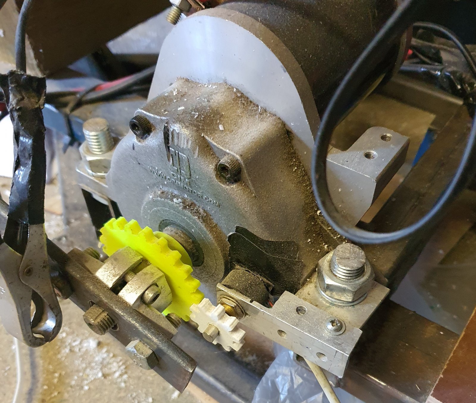

    Hi, my potentiometer changed center when there is high movement because the attachment to the motor not that good, so any suggestion to attach it to the motor note that the lever size is 20mm so its hard to make a holder because the pot is too small to it, so any other suggestion to replace it with hall effect?
    22,057
    153,938Coins
    +11,158 / 57 / -2
    See the FAQs re various ways to attach pots or Hall sensors: https://www.xsimulator.net/community/faq/how-to-connect-protect-a-potentiometer.13/

    The tubing with jubilee clips isn't the most stable of solutions. You might want to look at flexible couplings used to connect motors to lead screws for cnc. They come in a range of sizes and you might find something that fits. Personally, I run my pots (encoders in my case) through gears. If I need to recenter all I do is pull off the gear on the pot, rotate it a little and put it back on. This gives reasonably fine adjustment.

    Hi, any idea for how to connect pot to the motor ? , my motors shaft is 20mm help with idea

    Arguably this is the hardest part of any build (IMO). Because most builds tend to be different from each other, folks use different motors, want their machines to move different amounts & the pots people use have different amounts of rotation etc, mounting the pots becomes a creative challenge. On my build I used cogs which I 3d printed, allowing me to mount the pots next to the motor shaft & kcontrol the amount of rotation I wanted. Others mount them inline with the shaft, creating a little stand off mount and having the rotation match the motor rotation.
    I guess what I'm saying is there is no right way of doing it but also, it's one thing that most people can't directly help you with. You need to look at your specific build, think of all the possible ways it could be done & all their inherent weaknesses & try & pick the most sensible solution that your able to make.
    Here's what I did......

    If it is a solid shaft motor my approach listed in the FAQ section does work:
    @noorbeast :
    [​IMG] manually M8 tapped shaft
