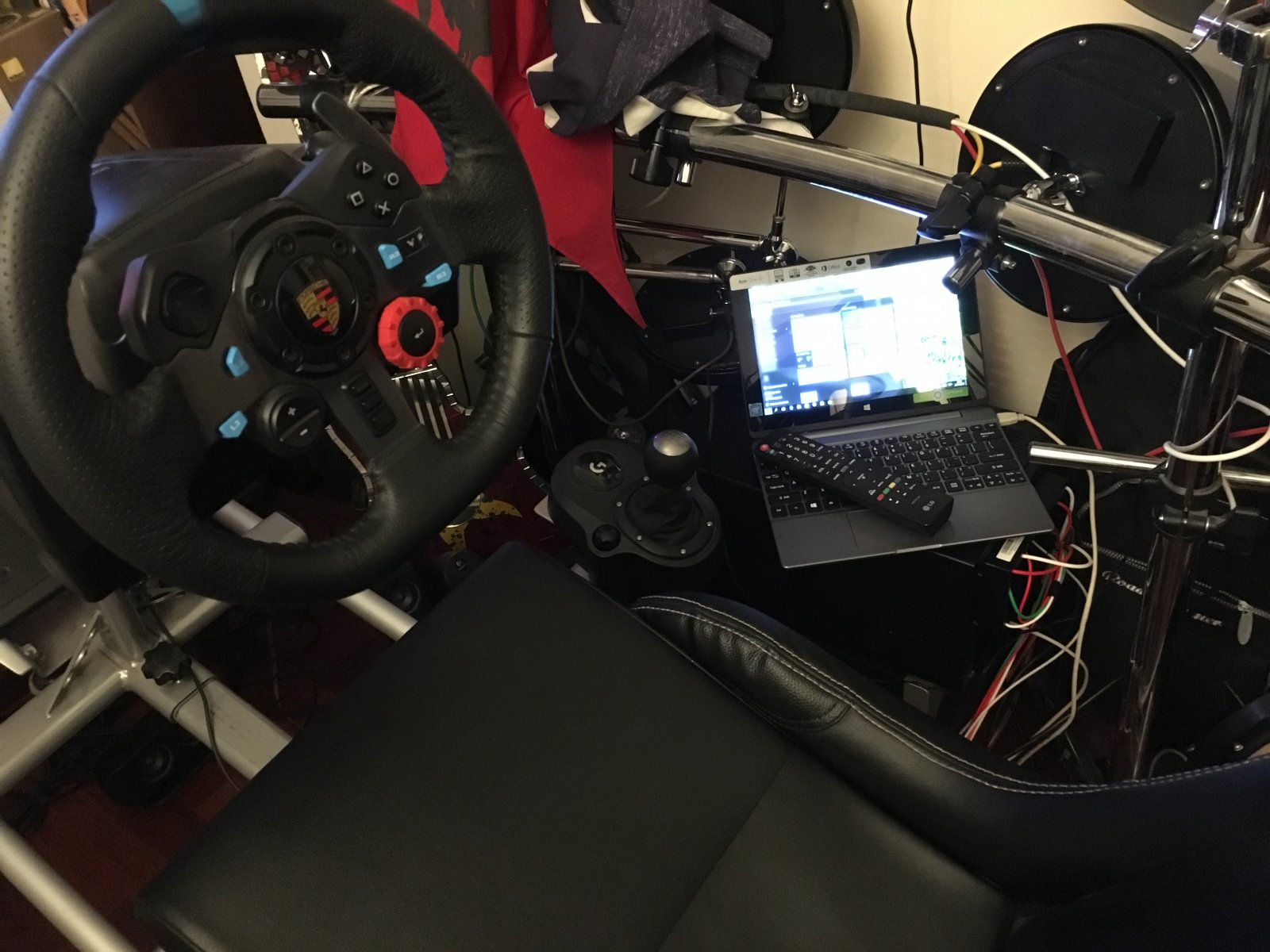

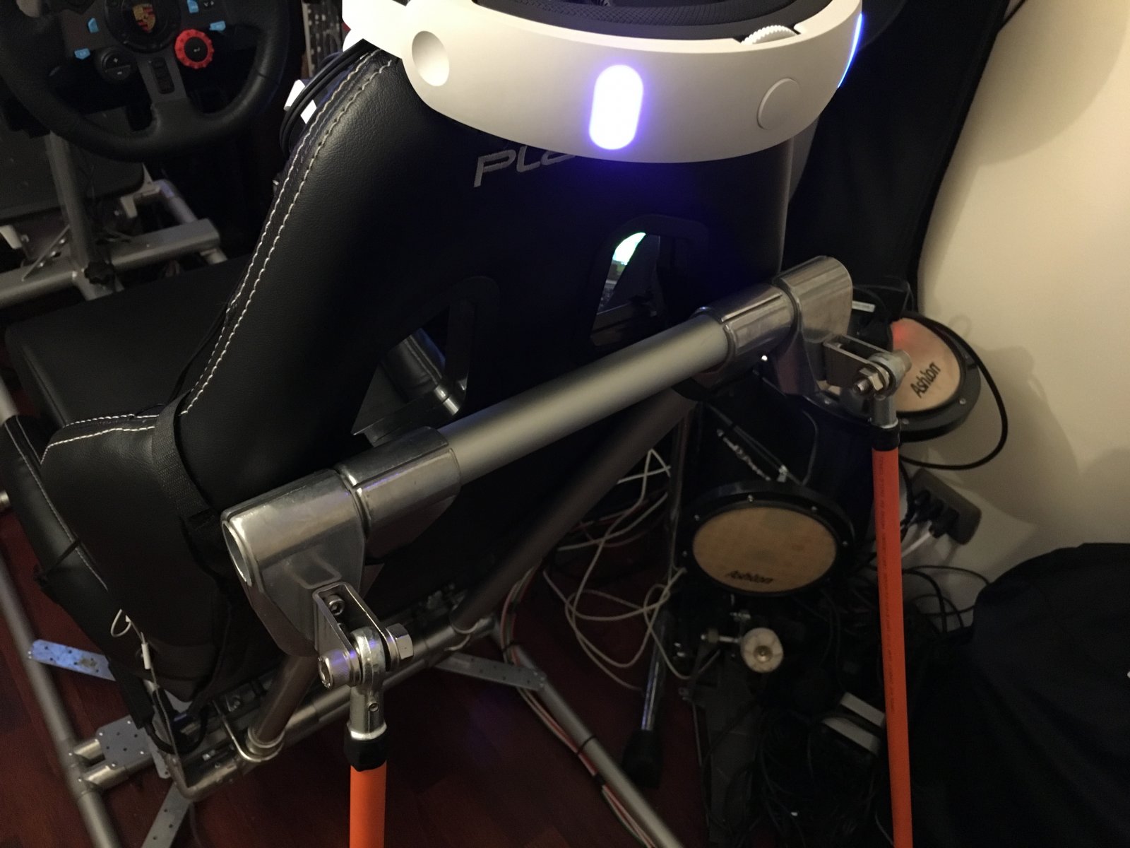

    Final Test in Mexico F1 2017 UDP !! ( Thanks @vthinsel ) with excellent Sway
    https://photos.app.goo.gl/XWwZc5IcuTWNBWYi2
    @noorbeast final photos with reinforced structure
    with my new lap top given by my wife :blush
    Now to burn the motors of the wipers, hopefully it will help me to improve my times in real life ..:(
    Thanks a lot !:p:D:D:D
