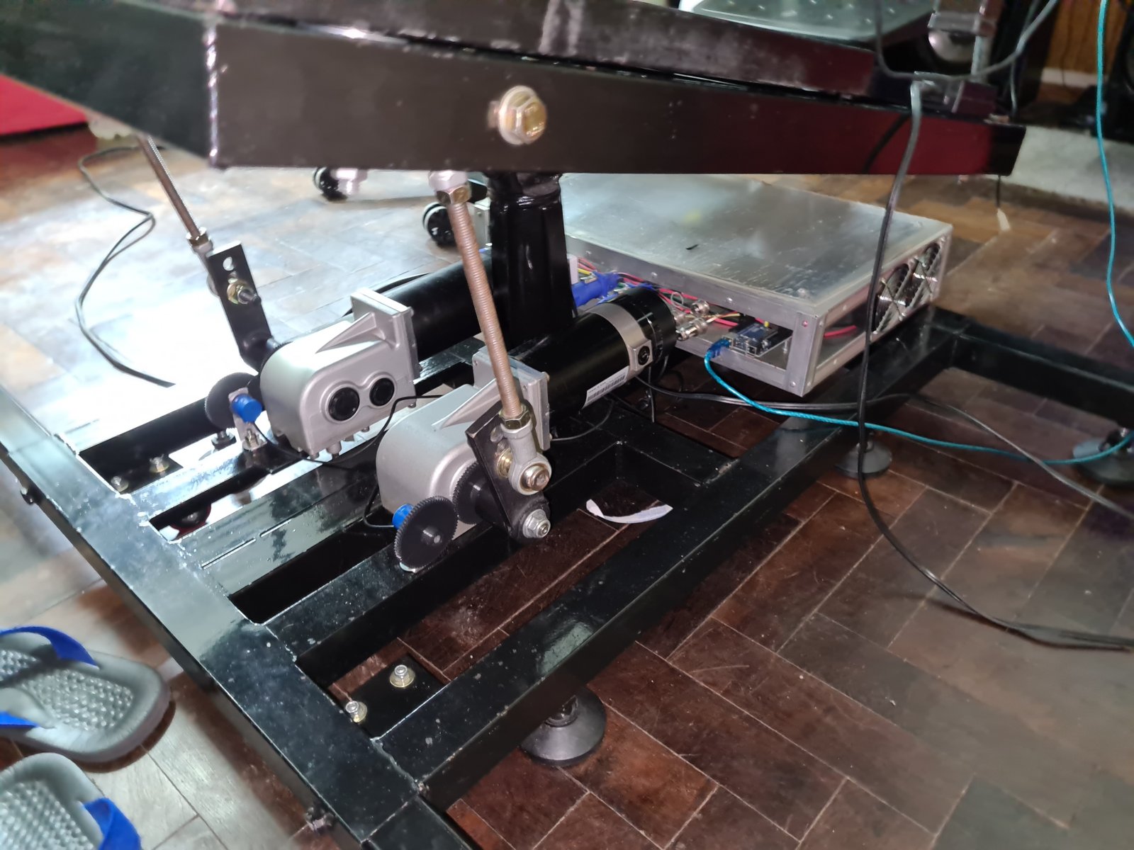

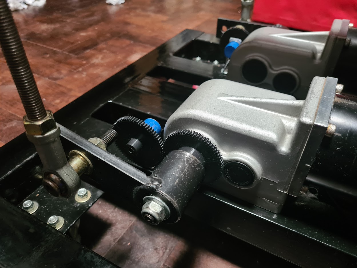

  8. olsayd
    olsayd New Member
    Nov 1, 2016
    6
    Argentina
    22Coins

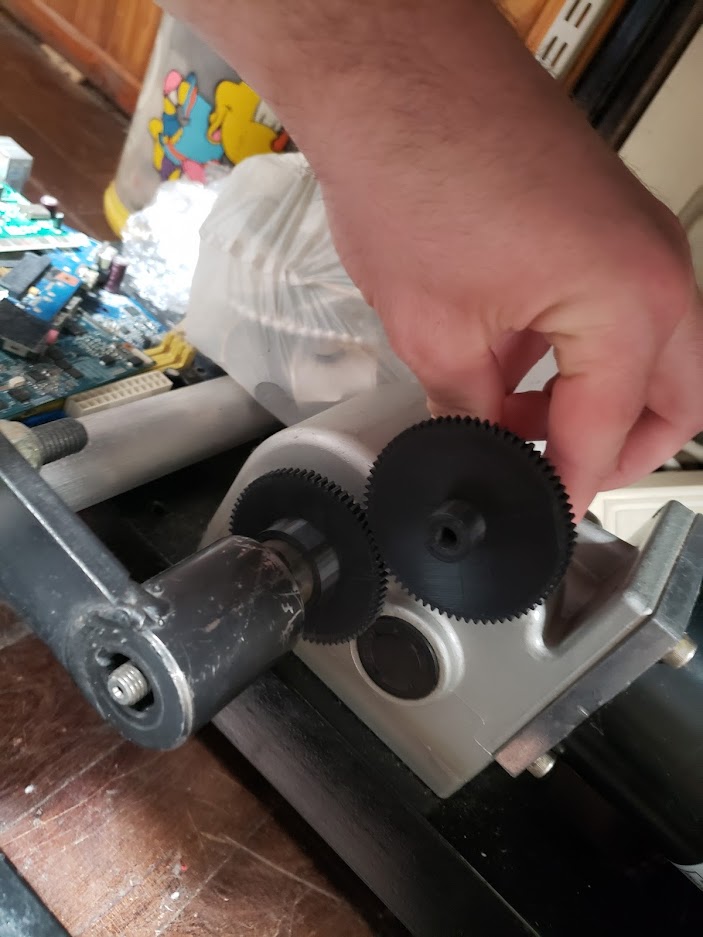

    Hello, I have a question for you that I'm complaining about with the configuration... the sim only works perfectly, but when I get on it, a motor is disconnected... it revives only by reconnecting the arduino or the scm3... any ideas? Doing stress tests, I noticed that if I stand on top of the other motor, it exerts force for a few seconds, turns off and falls due to my weight. They are wheelchair motors, not a worm motor and they suffer from all the weight, is there a way to bypass that protection or why is that happening?
    21,500
    150,620Coins
    +11,018 / 55 / -2
    My guess, in overall design and settings you are likely under estimating the torque requirements for a compact design.
    For example, effective torque utilisation drops off rapidly after about 38 degrees up and down of lever movement, yet this photo shows a lever almost at full extension and parallel with the rod:
  10. olsayd
    olsayd New Member
    Nov 1, 2016
    6
    Argentina
    22Coins
    Thanks for reply, Yes, in the image the sim is turnoff, so, for the weight it falls forward. I uploaded it to see the type of motors and how they are configured, the problem is that when I get on, my weight (66gk) makes the motor turn off at +-10s, whatever the motor that I get on. x seconds the program does not keep the torque and disables. and here in the photo it's unbalanced but when I get on, it balances with my weight... I'm thinking of changing the motors for ones with a worm system but it will take me days or months to get them :'c that's why I wanted to know if I could use the software correct that problem.
    although the best estimate will be to change the box, what ratio do you recommend? 1/50?
    I clarify that the motors move with great force, everything without problems, the problem is that they disconnect when weight is added (my weight) in "x" seconds
    21,500
    150,620Coins
    +11,018 / 55 / -2
    In my experience 60:1 can't be back driven.
    But before you go down that rabbit hole consider moving the motor placement to increase inherent design leverage, at least to the maximum the upper frame allows.
