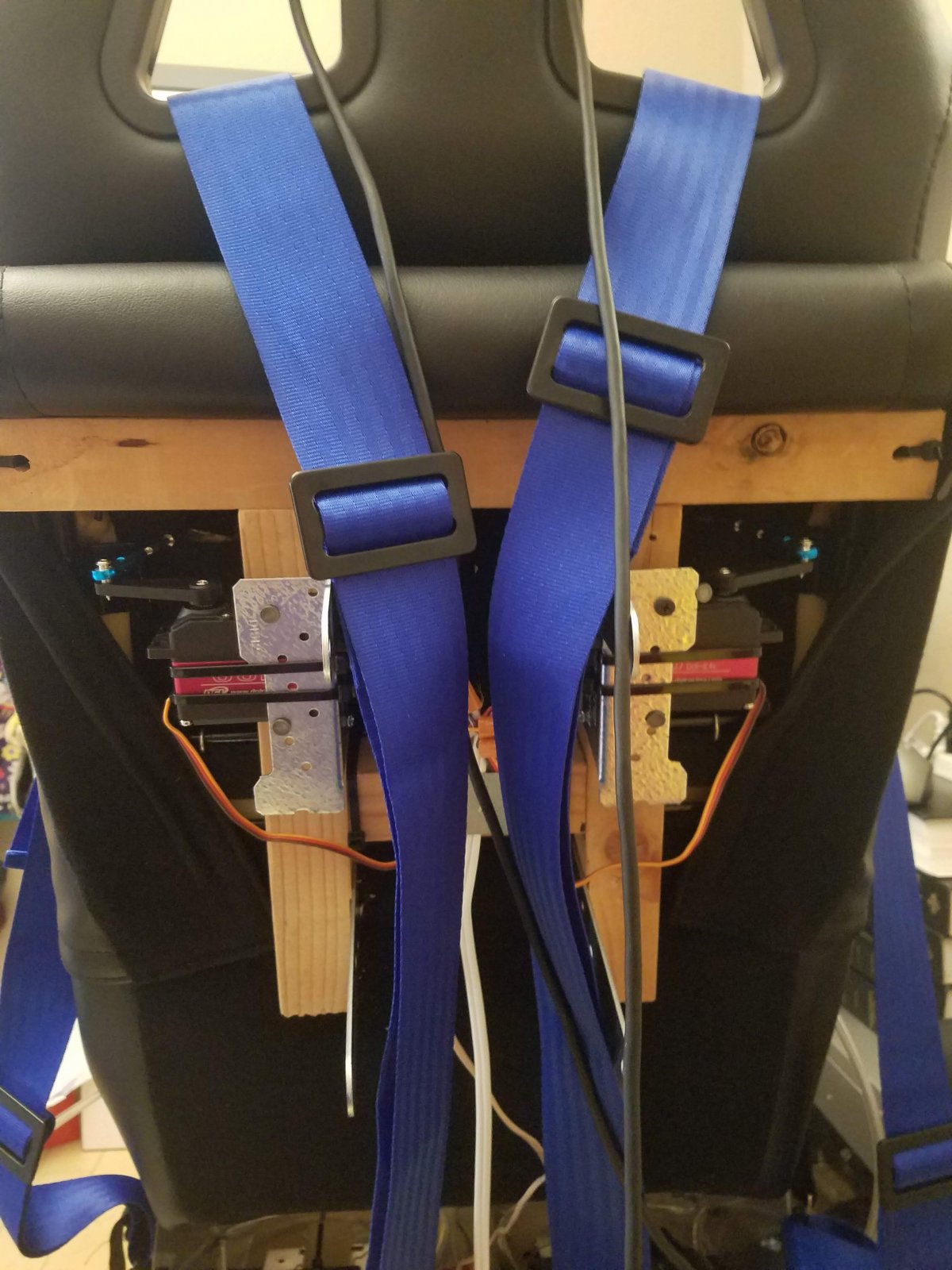

    As you can see from the previous post, I have the G-seat flaps on the seat. I cut home holes in the seat and built a contraption on the backside of the seat where there are 2 60kg servos powering the flaps:

    The total cost of my hybrid G-seat build was a little shy of $200. Some trouble-shooting and difficulties:
    1) How to keep the pressure on my body when the seat-belt pulls from the back. The solution was to use a seat-belt for my chest (so, it looks like an "H"), with a contraption in-between the center of the "H" and the middle of my chest. Because it causes the center of the "H" to be farther forward than my chest, when the seat-belt pulls from the back, most of the force is felt right through that contraption and unto my chest.
    2) The 30kg motors for the bladder and the seat-belts worked without having the ground in the arduino board. Because of this, I probably spent about 3 hours trying to get the 60kg servos to work, not knowing that I had to plug the ground connected to the arduino board. (The solution is obvious now).
    3) I reasoned that a 60kg motor might not be strong enough to handle the flaps. Because of this, I put the hinge near the horizontal middle of each board so that most of my body weight will be pressed right on top of the two hinges (which are secured to the chair frame). It works well, but there are few moments when the flaps are not extended all the way. However, I only notice it when I'm looking for it. Because this is a budget build, this was the solution without having to purchase a stronger motor or multiple ones.
