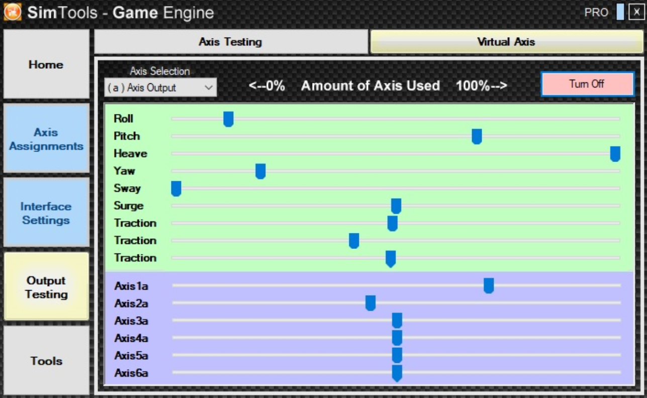

    Simtools 2.4

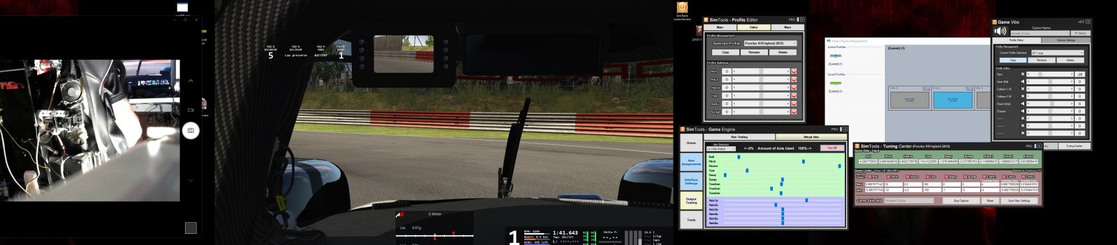

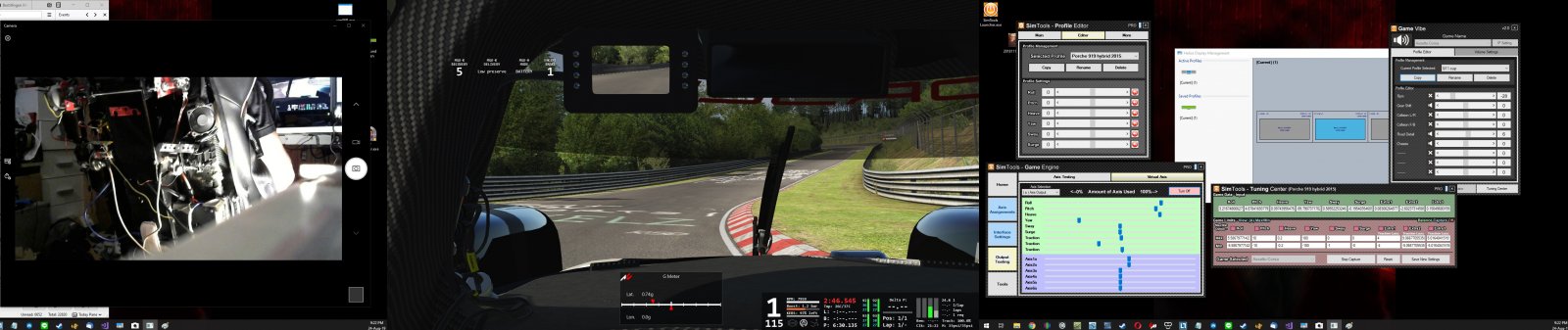

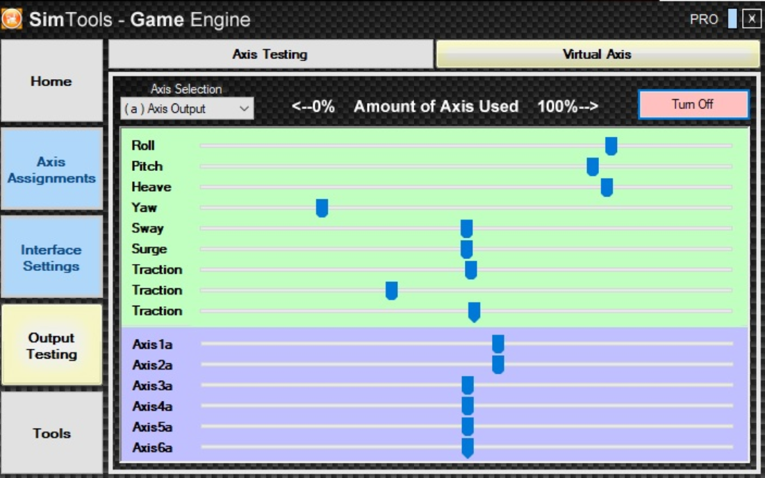

    Ive been doing some testing on this, It just controls each motor
    Max value 1 Min 0: Left motor works, Right off/locked for Sway/roll/traction loss.
    Max value 0 Min 1: Right motor works, Left off/locked for Sway/roll/traction loss
    It's the same for Traction loss and im assuming Roll too but i have not tested for it.
    Its easy to see on the screenshots where i turn left and right with output testing.
    Left Turn:
    Right Turn:

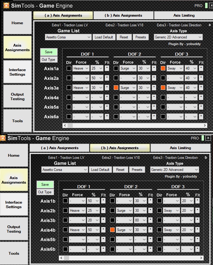

    In the past this would require a sketch mod or a custom Simtools plugin but thanks to an addition in version 2.4 that SeatTime and I strongly advocated for I believe I've procured a Simtools settings only solution for you. I don't think anyone contemplated using it for what your needs are though so this further validates the necessity of this improvement. Thanks yobuddy! :thumbs
    The issue you're having is due to attempting to drive two motors, each with their own feedback, from only one DOF, when each motor accounts for only 1/2 the range of that DOF. Therefore the solution is to set up two sway dof's which is now possible using expert mode in game engine. Save the settings for the first motor to axis assignments 'a' and then save the same settings to axis assignments 'b' for the second motor with one change, that being swapping the sway's min/max settings so that zero and tuning value used are now opposite of 'a'. Now all that's needed I believe is to reflect these changes on the axis assignments and interface settings pages.

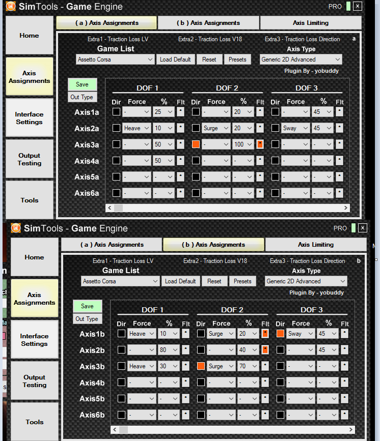

    While this is good in theory and im very happy with the changes it does create a few issues. I will have to abandon this and run with heave and surge only for the seat and Heave surge Sway TR on the back while loosing out on the heave/surge on one side in turns.
    Its relatively minor and i will be able to limit surge negative on the seat so i still get heave on full acceleration and that in itself is great!
    Explanation:
    You have 4 or more motors in the G seat (Back and Seat) I used to control Back with A and Seat with B. Now A controls one side and B the other.
    This means:
    You will be able to get sway/roll to not go negative but you cannot control any forces separate for back and seat that i can see. I may be stupid and not see it as I have severe working memory deficiency and can't hold two things at the same time though so feel free to correct me here
    So:
    No longer able to have opposite forces of surge for the back and seat giving the illusion of deceleration
    Now all axis limits needs to be the same.
    Forces are the same for up and down.
    Tuning center:
    Always save to A or B depending on which you edit or the opposite numbers in Sway will overwrite the other.
    It looks to me like you will have to write your own sketch or plugin to get the G seat to its full potential. Or add a separate C/D Axis assignment with tuning center to solve this. 2.4.2-3 perhaps?
    Interface1 : [A<Axis1b>][B<Axis2a>]
    Interface2: [A<Axis1b>][B<Axis2a>]
    Note i have a 5th motor on I3 amd Axis 3b
  9. BlazinH
    BlazinH Well-Known Member
    Oct 19, 2013
    2,145
    Oklahoma City, USA
    16,659Coins
    +1,839 / 32 / -1
    For someone with the skill set this would probably just be resolved at the sketch level.
    I didn't take my thought process past more than the two motors so I believe you need a 'c' axis assignment now too to solve all your issues when using only Simtools settings if I'm following correctly what you need. I requested consideration of using a multi-windowed approach for the tuning center so someone could just add another assignment when necessary (considering their computer has the processing resources) but getting a second one is already a 100% improvement. Again I don't think anyone considered using it like you are but with at least one more assignment you could then have a third sway dof that uses its full range so you could get both accel and decel motion at the back while not affecting the seat motors.
    I'm confused as to why your surge settings don't work correctly when only sway is being limited?

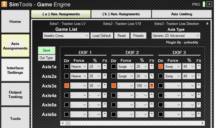

  10. Trigen
    Trigen Active Member
    Nov 25, 2018
    484
    2,872Coins
    +180 / 1 / -0
    2DOF, 3DOF, DC motor, Arduino

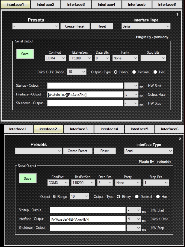

    After a gazillion edits:
    Note, i changed the interface setup to:
    Top motors: 1a, 2b
    Bottom motors: 3a, 4b
    The Surge is set like this.
    Lower motors will extend on brakes. it gets negative surge from the game
    Upper motors will extend on acceleration. It gets positive surge.
    The motors are set so that 1a is top left and 2b is top right. Problem is when i limit the B channel surge so its not allowed positive throw then one of the flaps wont work with acceleration and the same is true for one flap when braking as its not allowed negative. Hence i cant limit this force.
    Limiting also effects my Seatbelt motor. a C channel would be a fantastic addition here for the belt as its on its own motor but im unsure if it would solve the surge?
    Everything else does work and i can live just fine without surge on the lower motors. If i have surge on it goes into clipping as it only has 5mm negative throw
    Here are my 4 motor Gseat settings . Adjust for your setup
    I forgot to adjust the B channel top Sway before the screenshot so ignore that

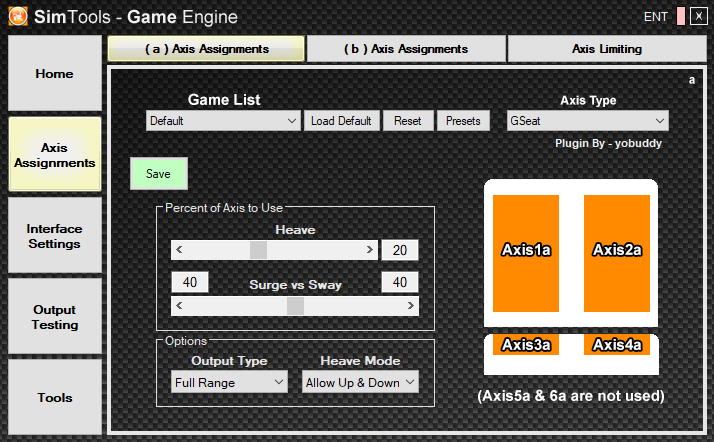

  12. yobuddy
    5,408
    50,690Coins
    +5,166 / 19 / -0

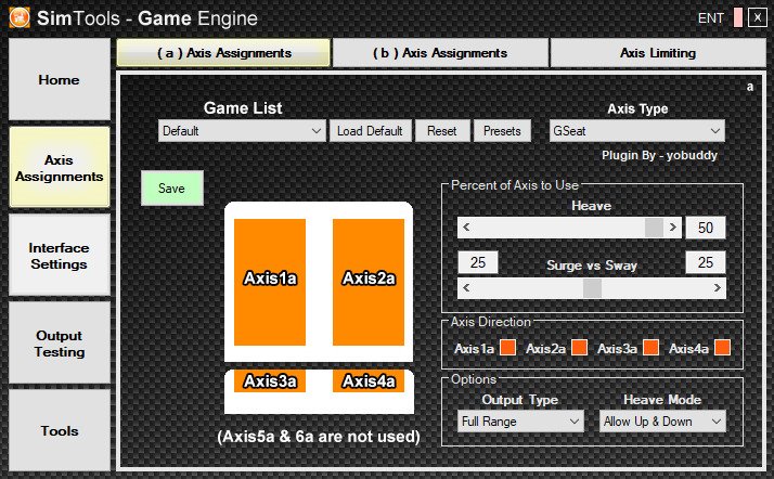

    I think we could probably make a G-Seat axis assignment plugin to make setup easier?
    I would have to think it over some.
    But i believe it should be doable.

  14. yobuddy
    5,408
    50,690Coins
    +5,166 / 19 / -0
    Getting there...

  16. yobuddy
    5,408
    50,690Coins
    +5,166 / 19 / -0
    Got a bit more done...

  20. yobuddy
    5,408
    50,690Coins
    +5,166 / 19 / -0
    @RacingMat,
    I think the G-Seat plugin is mostly done.
    But some asked to be able to configure the Heave, surge, sway inputs.
    So they could test with traction loss, etc..
    Where i was thinking we could just link directly to the Heave Sway and Surge inputs.
    I'm pretty sure that's where we left it.
    We should take a stab at finishing it thou, as it could make setup for a g-seat allot easier i think.
    Either way thou, do to some limitations of running a G-Seat and needing more separate axis assignments to do some fancier things, there will be an 'Axis Assignments (c)' in v3.
    Take care,
